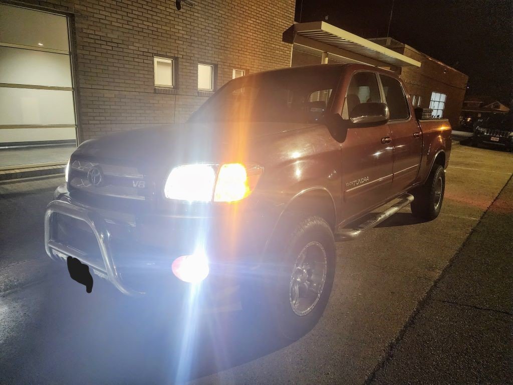

    Got my Nilight lights wired up using the stock wiring. Just added the relay and fog switch in the dash. Works perfectly, thanks guys!
    Ill try to get some pics soon

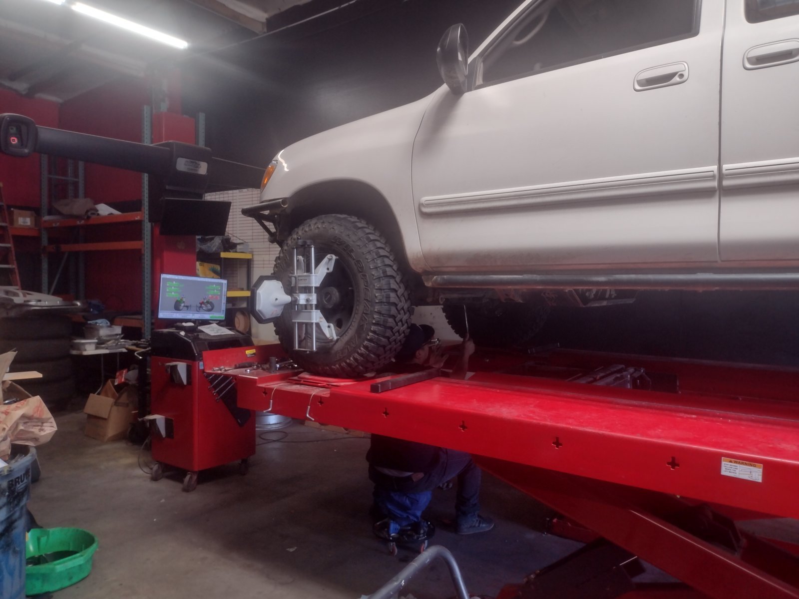

    OEM+, 6+1 bastard pack, 4.08 swapped rear end, custom spring shackles, 3 inch flat lift. This list will grow
    Alignment is underway.

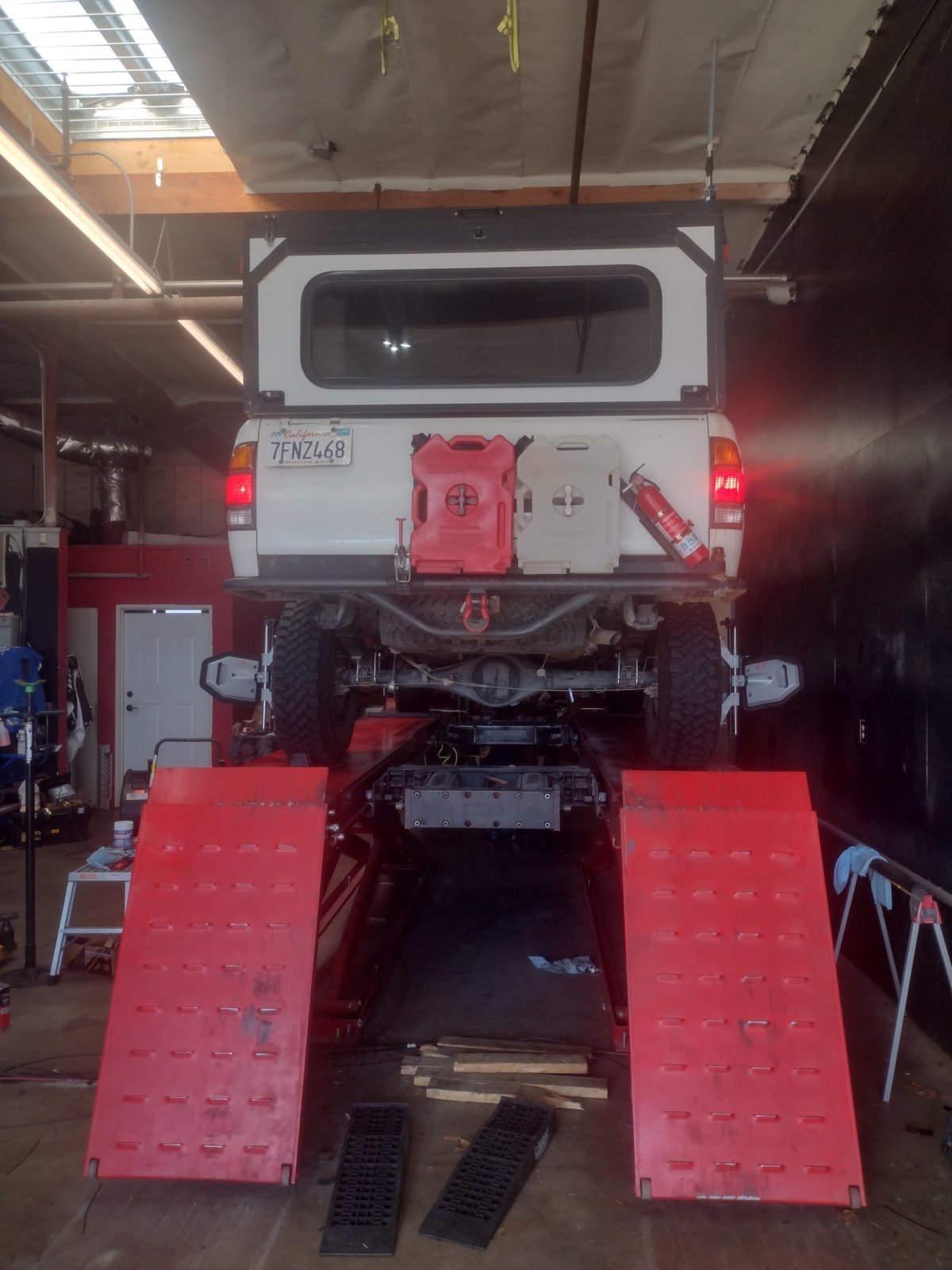

    Alignment Buddies!
    Voss, sportbike37, RUSTYNUTS and 9 others like this.
