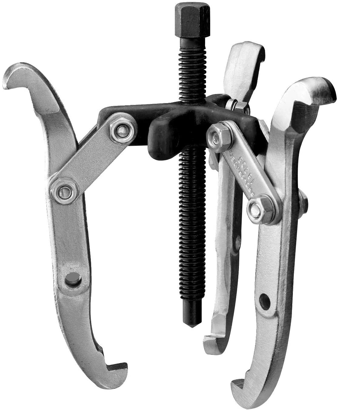

    I went the route of pullers. They work like a goddamn charm.

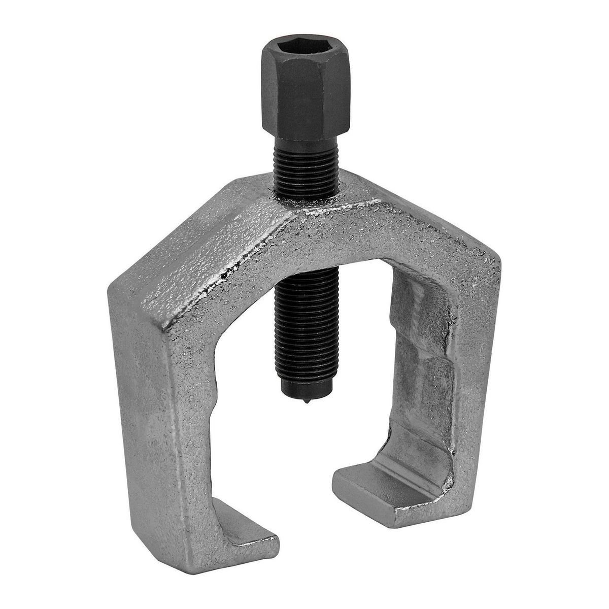

    Ditto, only a two-arm and pitman. And I’d damaged that 2 arm puller pulling something impossible many years ago, so I had to disassemble it and anvil the oval side plates flat again. More time I didn’t have, but it was overdue.
    it was unusually cumbersome to slide the pitman puller on due to the OEM rubber splash shield thing, too. I suspected my old OEM LBJ still had some service life left so wanted to keep them damage free. Were yours similar? I believe we’d have used the same p/n.
