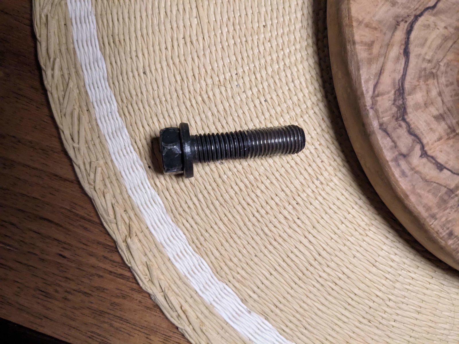

  3. Jan 28, 2024 at 5:29 PM

    Dec 13, 2018

    East TN

    metalpete New Member
    Jun 1, 2022
    #79032

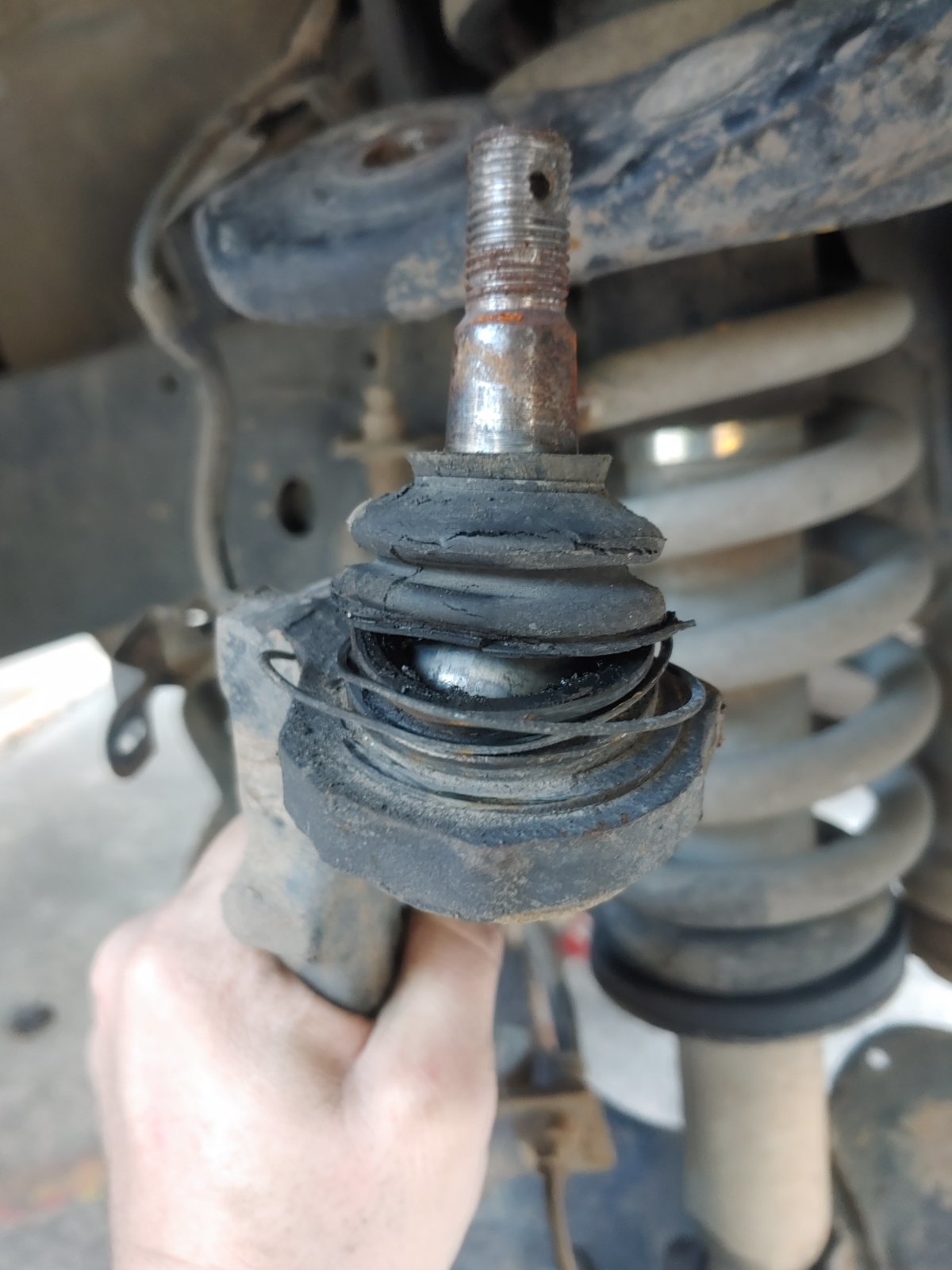

    They only had 2716 miles on them. I did the uppers lowers ball joints and outter tie rods last year in May when I bought it. Along with all the steering and sway arm bushings. All the moog parts have failed. This wasnt preventative thus was rework

    The less than 3000 mille moog shit parts

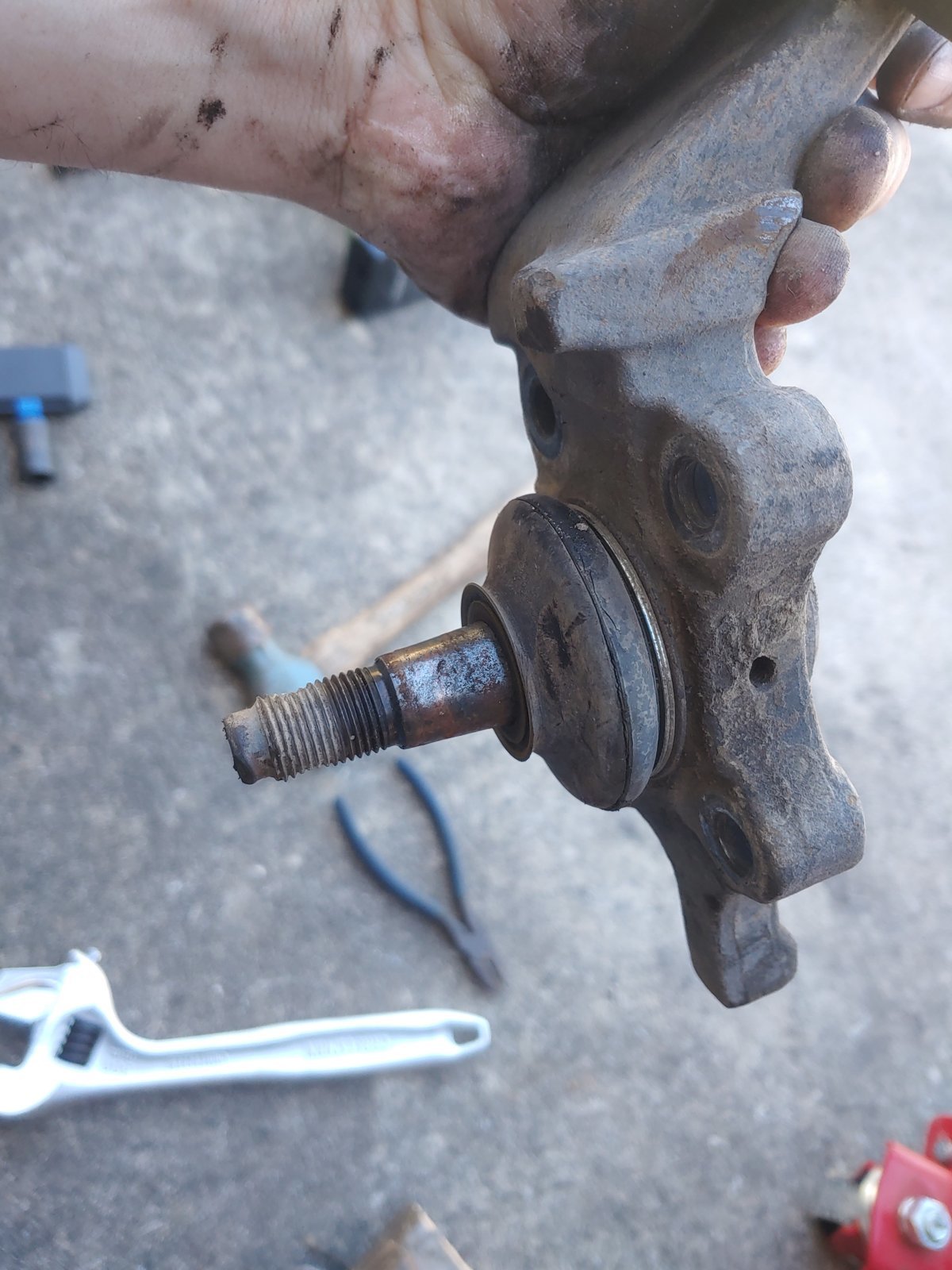

    Replaced my LBJ's with 100K miles on them. The original owner had them replaced at 90K under the recall. Went pretty smooth until one bolt on the left side seemed to be threaded and kept spinning and snapped. I put another one in with some locktite blue and got it to 56 ft lbs (spec is 59). So my question is would you leave it be or take it out and helicoil? The weird thing is the same thing almost happened on the passenger side - started to thread so I stopped this time before it snapped but when I pulled it out you can see it was stretching and would have done the same. I put one of the old ones in as a temp fix and it got to 59 ft lbs no proble. Maybe the additional friction of the rust and corrosion? My second question is, why is this happening?

    I always run a nylon brush on a drill with some break clean on threaded rusty holes. It helps out a lot

    Wait … where’d you get the bolts? And are you sure they’re the right length, since some vary? They didn’t snap because you bottomed out, because they’re too long, did they?
    No clue why it’s happening unless you truly didn’t have the BJ lined up on all four holes or the bolts were too long? On OEM LBJ (you’d hafta be fucking nuts to use anything other than OEM), I believe they all come with one of four holes having an insert, which helps with alignment. I typically (and did so today while replacing my LBJ) hand-thread my first bolt on that one bolt hole 2-3 full turns, then repeat on the bolt hole diagonal from there. Then the final two, then snug ‘til hand tight, then tighten firmly in criss-cross pattern, then torque to spec.
    And Helicoil what exactly? I’m confused. If anything, if you think you cross threaded the LBJ, I’d pull it out and chase the threads starting from the ball side (opposite side the bolt normally enters) with a tap&die set. I would’ve done this immediately after.

    those bolts look like the 'black' bolts i just bought and call for 37 lb.ft.
    https://www.tundras.com/threads/spiker-engineering-lower-ball-joint-bolt-test-1st-gen.111746/

    do the older FGT use the 14mm/washer for the LBJ?? Cause I’m 90% sure mine are 17mm flap bolts. (I just did the bolts like 3 weeks ago and can’t even remember I do know they’re the larger of the 2)
    I may even have a set of OEM 14mm laying around cause I mis-ordered from flea-bay learned my lesson and just went through a dealership/vin#. Let me know if you need them and I’ll scrounge around the garage

    That info is wrong also. @NickB_01TRD has 48ft lb for my year, but the correct torque is 59ft lb. There is a typo in the FSM, one page says 48, all other pages say 59.

    I was just going to say what @FirstGenVol said. The black bolts only need to be torqued to 37ftlbs. They reach the same preload as the silver bolts much sooner.
    Making sure you have clean threads is a must, too. Could have old thread locker and other gunk in there.

    Not 100% sure, but one of the earlier year guys above may be able to confirm. The LBJ thread is a p good resource for that stuff.

    Yeah that may be right for yours, but not for my 02. It's 37 if you're using the black bolts.
