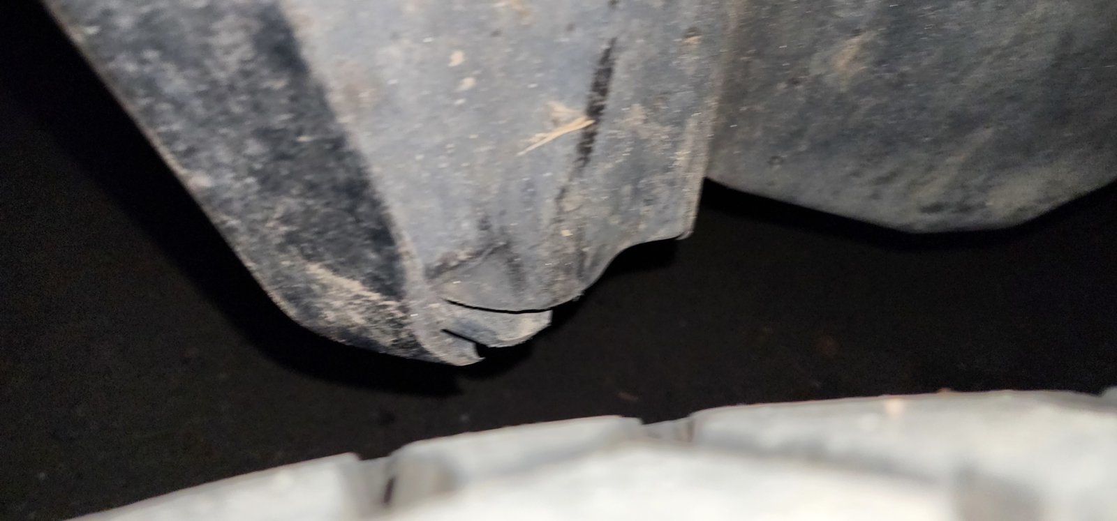

    Ok explain this anecdote then:
    My tires were rubbing the back of the wheel wells. So I cut and hammered the pinch welds. Then I found out my tires were rubbing the frame rails, preventing full lock turns. So I added 1.25" spacers. But that made my tires rub the back of the wheel wells again and I later found I was rubbing the top of the wheel wells. This was happening about 70% of the time off road and while turning and articulating at the same time on pavement.
    So as a hail Mary, I changed the springs from 650lbs to 700lbs, set the preload form 2.5" of lift to 3" lift, and lastly changed the SPC caster from neutral to all but one position toward the front of vehicle.
    Now I rub off road maybe 5% of the time. I didn't do any additional trimming beyond the original cuts made to turn the tires.
    So what fixed the rub?

    Where are you rubbing on the 5% of the time? I believe the caster change is what fixed the pinch and frame rub. Nothing else.
    Position of the tire in the well will absolutely mitigate rubbing if the rubbing is due to the wheel being too far back in the well. It just so happens, in my case, that's not the problem.

    The spacers fixed the frame rub. The caster adjustment fixed the rear wheel well rub. The coilovers work fixed the upper wheel well rub.
    No way to know where it's rubbing now for sure, because it only happens when I'm doing technical obstacles and I'm in the driver seat. But it's at full compression while turning, for sure. The point I'm making is it doesn't bother me at all though because it's a super rare occurrence now.

    The caster change probably helped you off the pinchweld as often. When you are wheeling, how certain are you that you are trully reaching full shock/bumpstop compression? You might not be reaching it as often with the stiffer springs and where your preload is set at now.
    Take ride height measurements, then take your coils off the shocks like the guy in the video I linked did. Then jack the tire up and start turning the steering wheel. That will tell you all the possible places you can hit.

    Yes. This for sure. I'm feeling certain when I come down hard off a rock and it rubs that it's fully compressed. I haven't done the excercise you mentioned to see the geometry in motion. I'll be doing that when I rebuild the front end, probably late this year

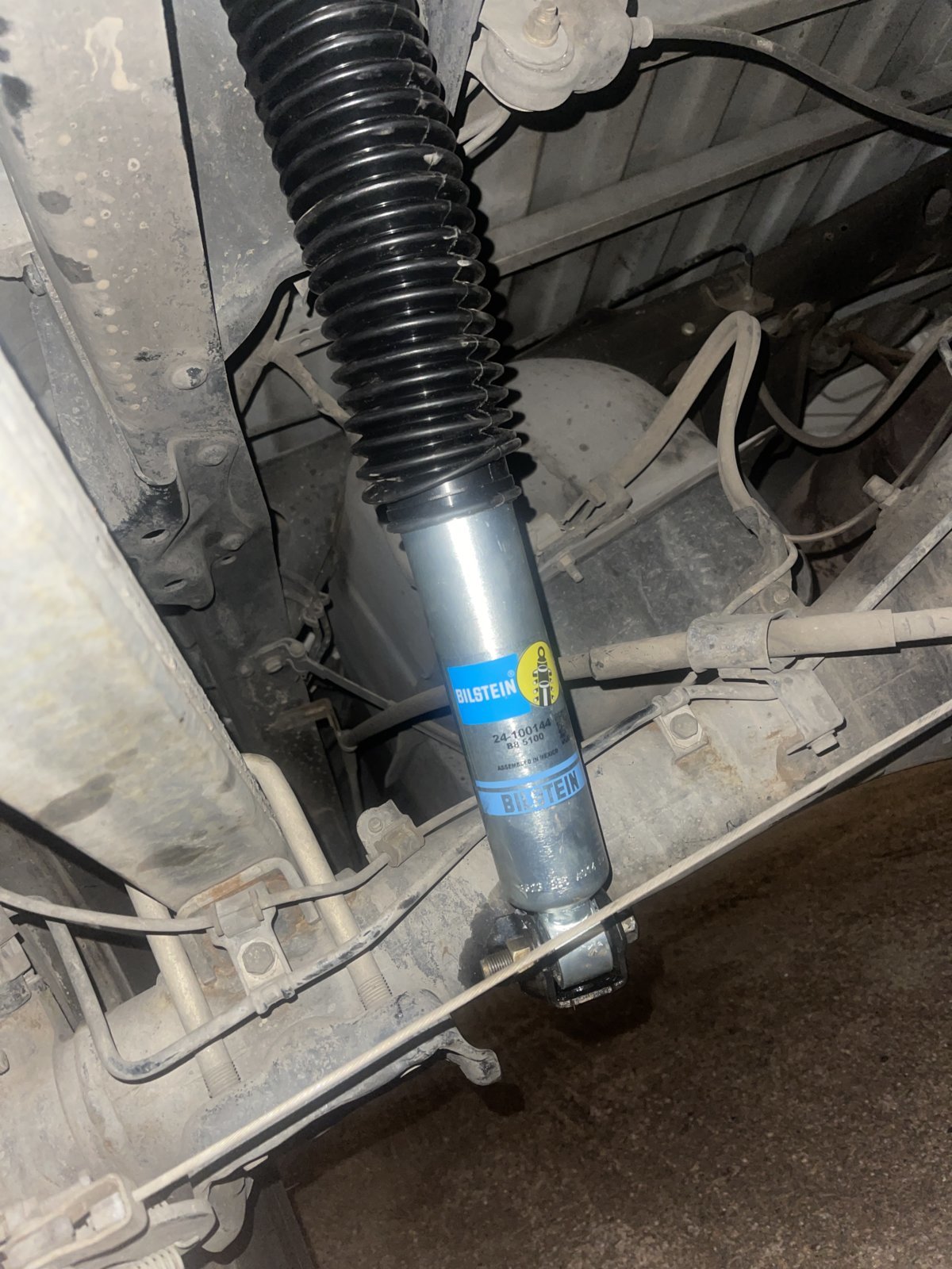

    Had to hold off on the front until next weekend, but got my rear 5100’s installed. Holy smokes, that shouldn’t have been that difficult! Super annoying getting the top bolts off, and then aligning the eyes of the shock with the bracket was a real pain as well.
    Overall pretty simple just super annoying. Took about 2 hours, and the ride is 10x improved already. My OEM shocks were absolutely shot, they barely took any strength to compress them.
    Am very excited to see how she drives with the front all finished next weekend!

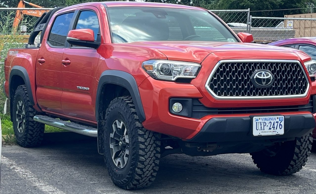

    Think 265/70R17 is a 31.6" and 275/70R17 is 32.2". Ran 285/65R16 (32.6") with about 2.5" up front as DD. Just shaved the front fender slightly at the bottom. Don't think it's very noticeable unless you know to look for it. Swapped after about 100K miles for 275/70R18 (33.2"). Just shaved a tiny bit more.
