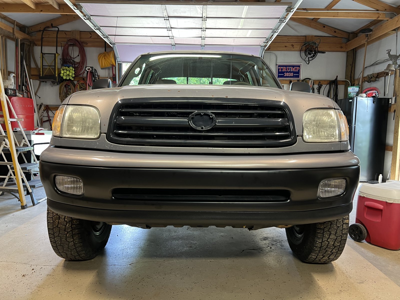

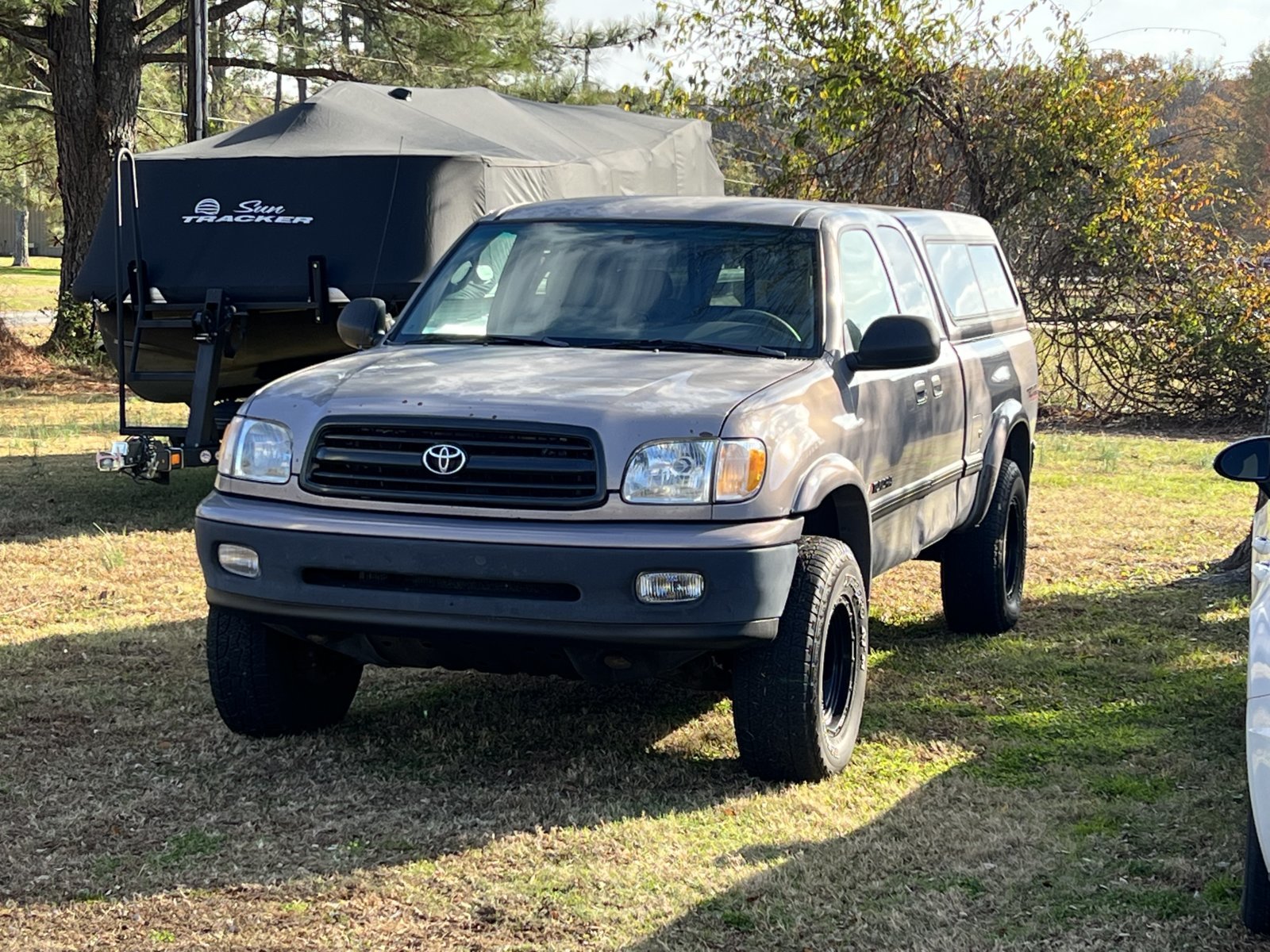

    I replaced my grille, front bumper and fog lights after a run in with a deer. Went with the all-black grille and bumper.

    Headlights polished up and grille emblem replaced. Really need to repaint the hood and roof.

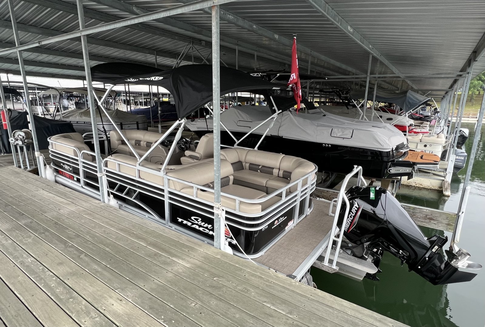

    Yup, it’s a blast in the summer. I put it in storage place at the lake so we can pull the camper up there and just grab it for the weekend. Bring it home during the winter.

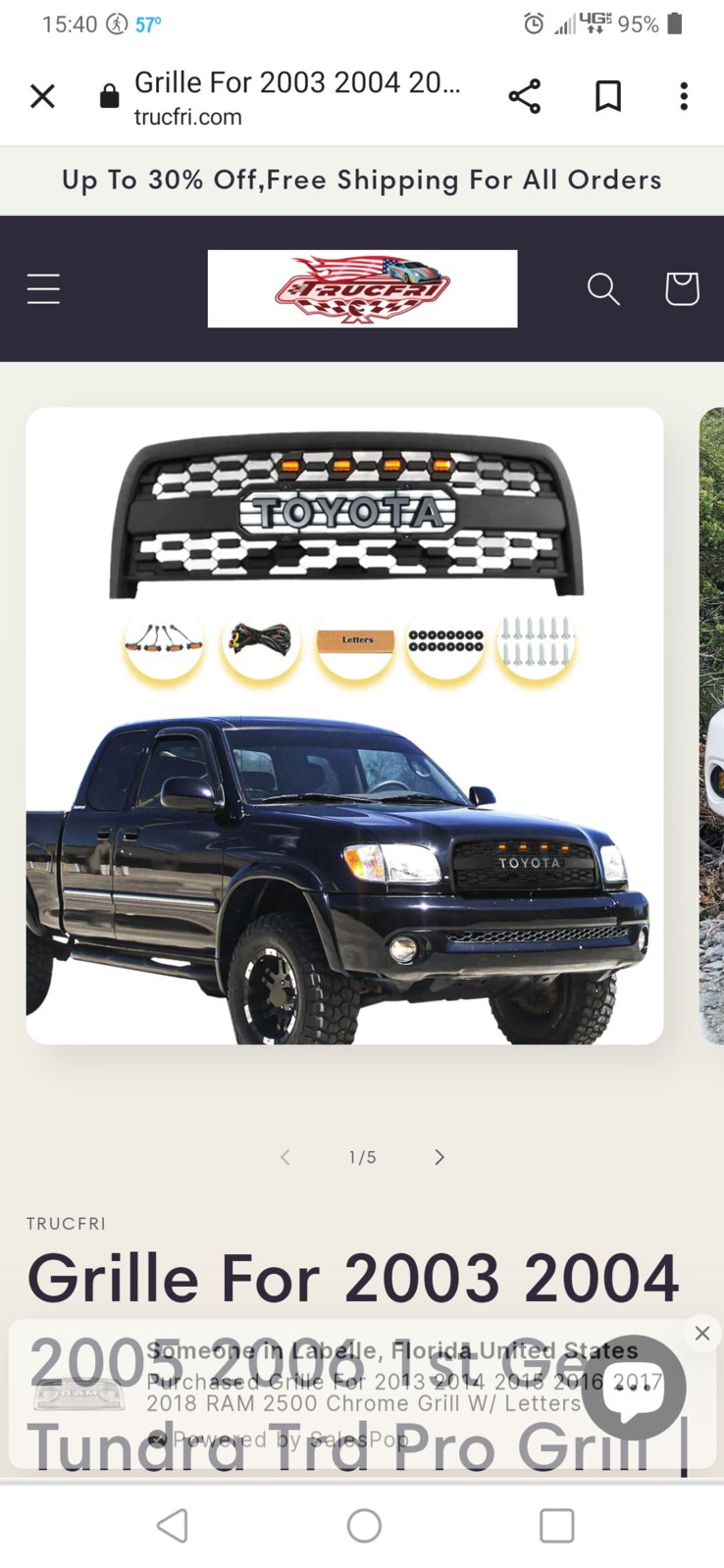

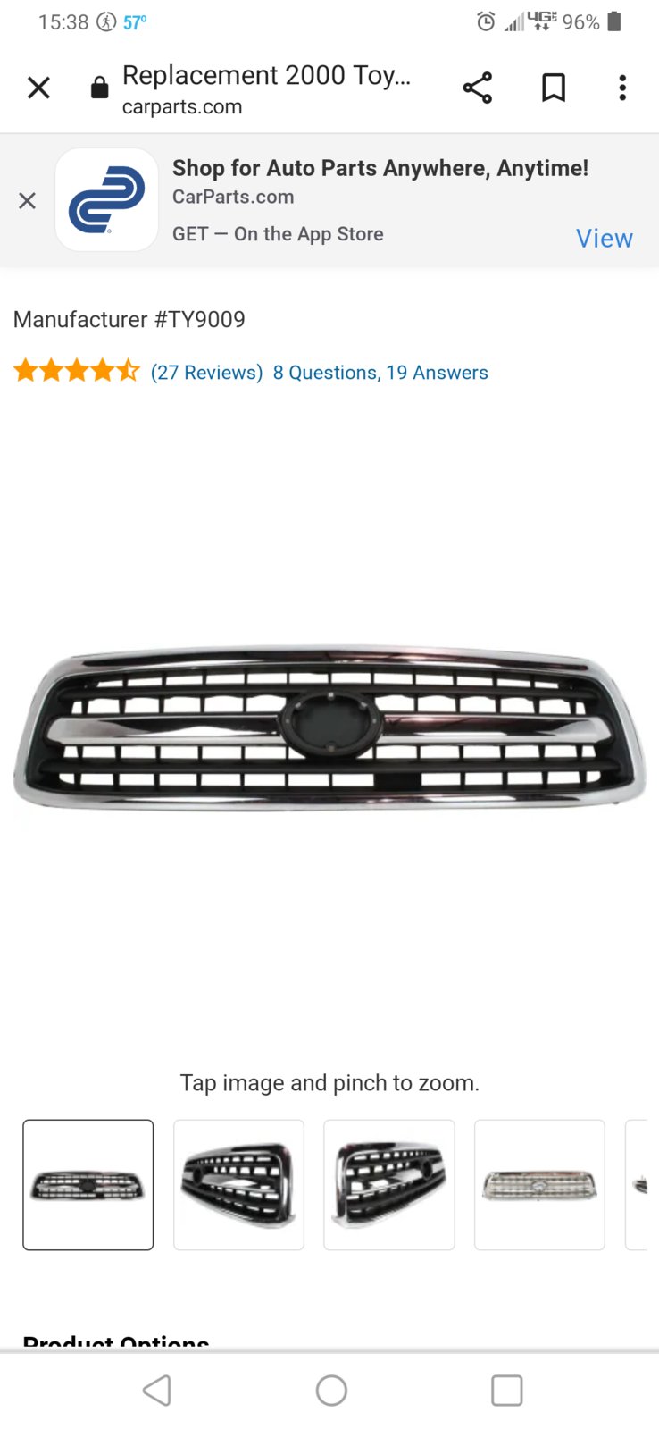

    I really don't like the chrome grill on my 03. Was thinking of black next. Looks like that last grille is only $67 and like $17 shipping right now (although looks like it won't fit an 03).

    If you want that style grill, yes. It would actually be easier/cheaper for you going from 00-02 to 03-06 than 03-06 to 00-02. Reason being that everything is the same, except the grill and the filler trim that goes under the headlights. Since the 00-02 filler trim is one long piece and the 03-06 is two small pieces, in theory, you could just cut yours into two smaller pieces to fit the taller 03-06 grill.
    And of course if you don't want to cut it, just buy the two trim pieces and swap em out.

    appreciate that! I bought one on eBay for $17. See the second pic in front of the boat

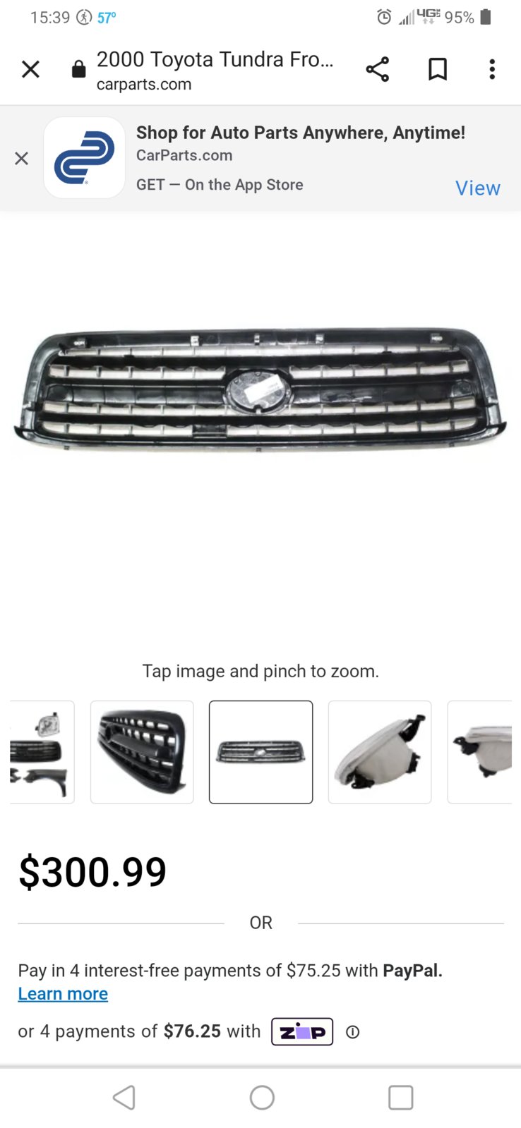

    Yeah, I'd like to do this to my truck, but with a white-out grille, w/chrome Toyota logo. But keep my '06 front bumper. Although I remember seeing one grill that looked different, maybe had two fatter chrome bars thru the center versus one single bar?
    I have a pretty nice white non-limited (i.e. has chrome bars) '06 grille in the closet I never installed. I got it from @wandering_boy a couple years back thinking I was going to install it, but I abruptly changed directions when I finally pulled the trigger on my Methods.

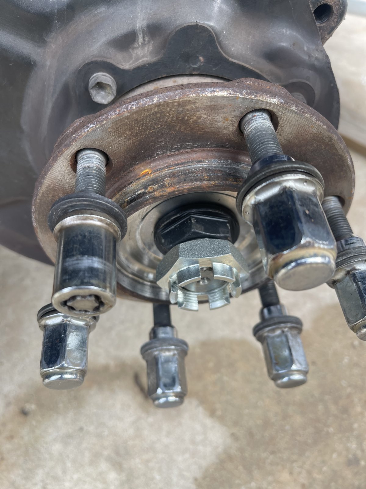

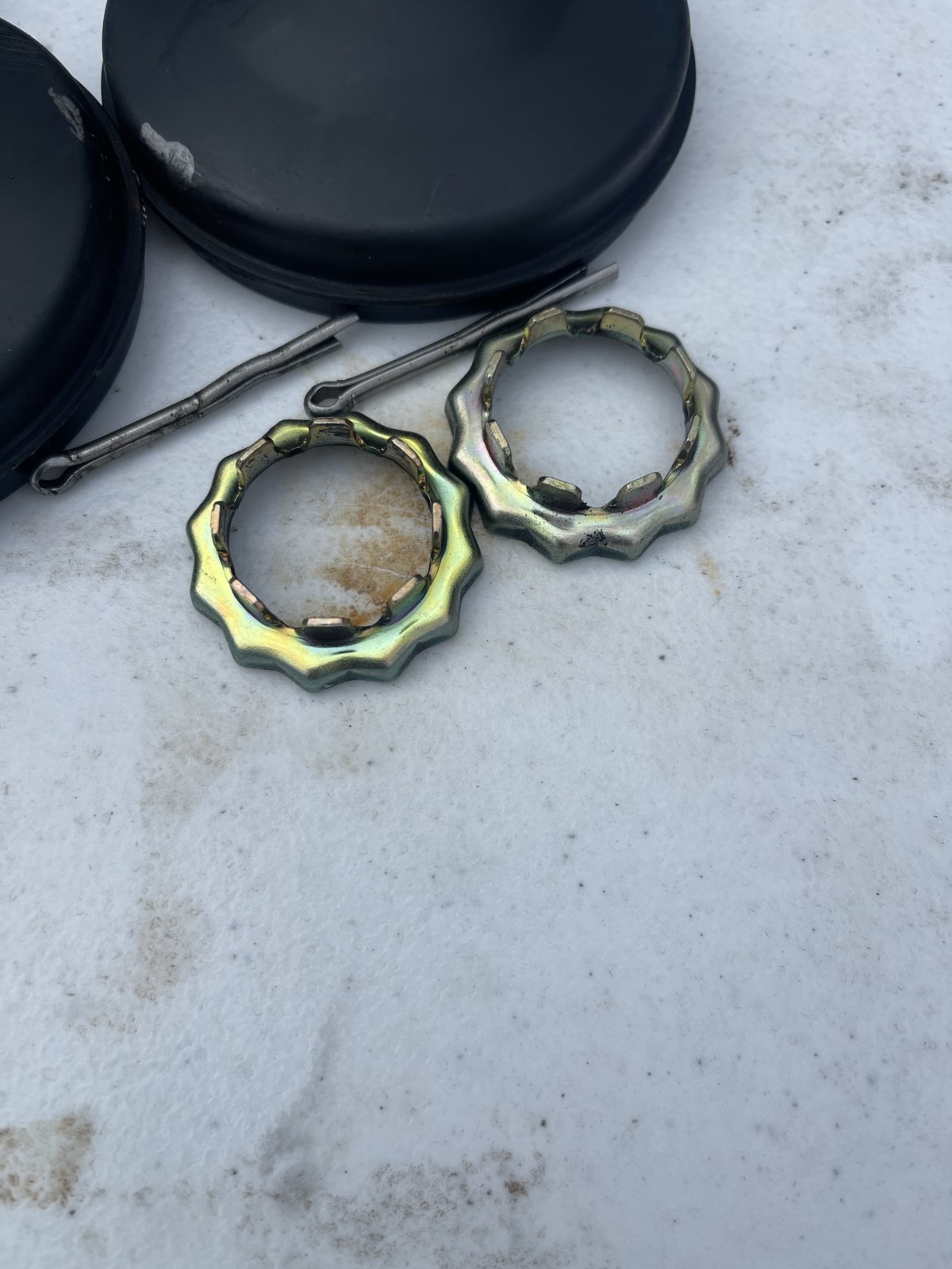

    Whats the consensus on cv nuts? Same threads, rockauto says the trackmotive are 40.8mm and oem are 34mm or whatever, but flanged? We reused bmf's oem nuts, but i'm about to go buy some sockets, so should i get both or just the oem size & reuse the nuts?
    gotta take rockauto's measurements with a grain of salt. They claim 40.8, but they measure 40.64.
    can reuse the oem cage if i reuse the oem nuts.
    bmf4069 and oscardog86 like this.

    Reuse oem

    Reuse it all

    cotter pins are a single use item.

    Debatable

    Says you. My truck begs to differ.

    This is why i dont do mod meets on my junk. If it were my motorcycle, yea, who cares... but i usually have my dog with me in the truck so i've gotta do things right.

    I mean I've put 50k miles on the truck since I changed the CVs, driven it off-road and across the desert. You'll be fine.

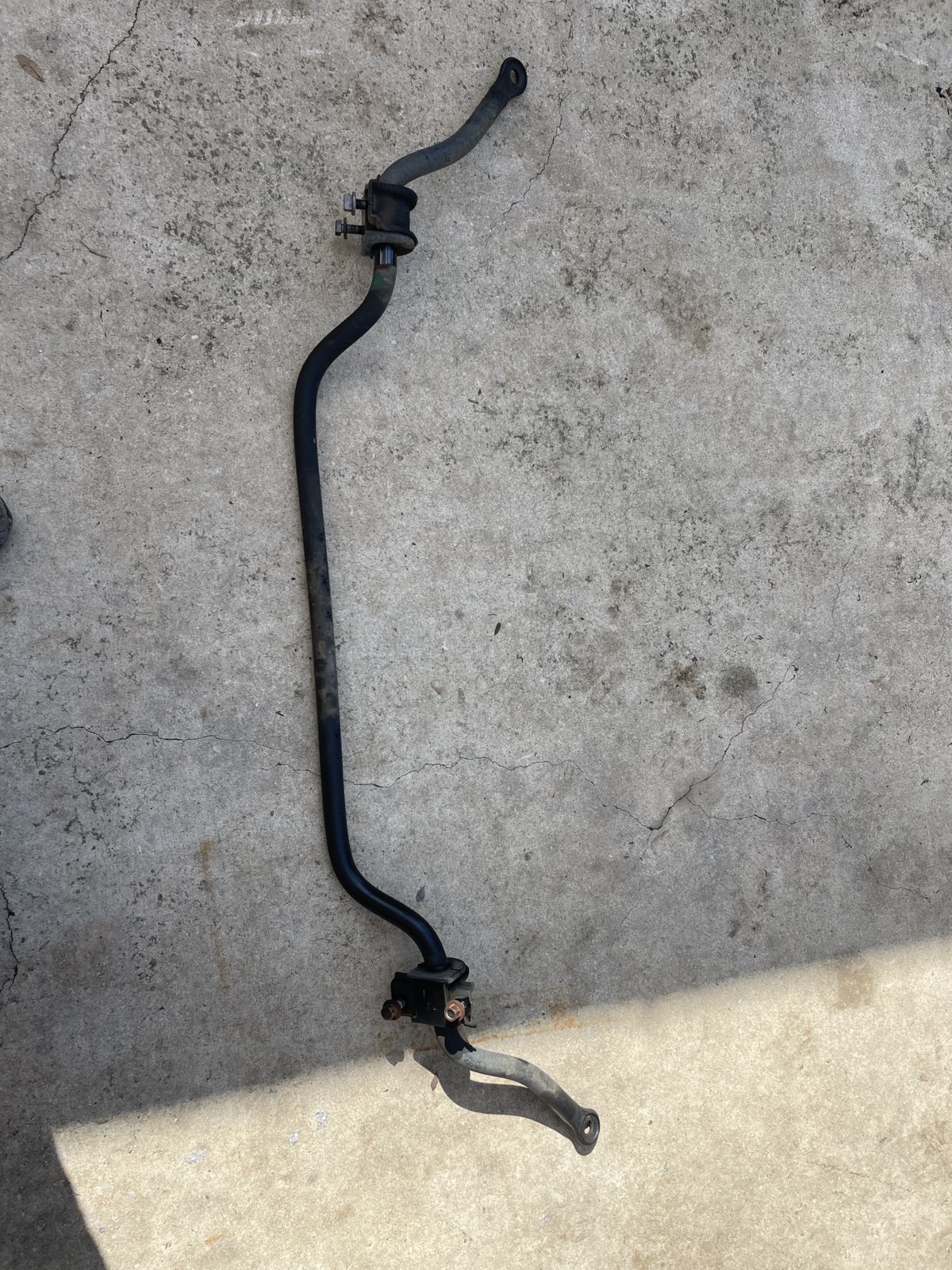

    Do DC & sequoia also have 24mm front sway bars?
    pro tip, pull the axle caps & crack the cv's loose before removing the brakes.

    DCs are 27mm and Sequoia are 28mm

    You don’t need to remove the brakes, just unbolt the lower BJ
