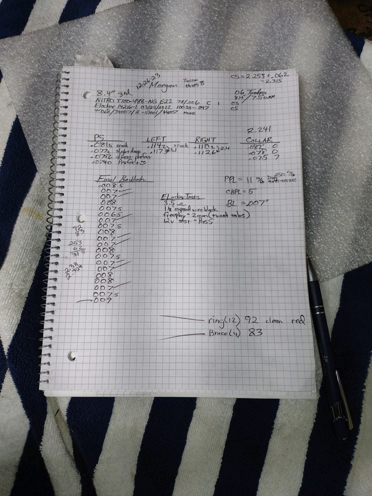

    He blueprints every set he does3B243CE4-A714-48D4-BCFC-6FB72A3D2677.jpghe said he has about 9 notebooks full of these from all the sets he’s done

    Old school notebooks.. Haha

    NGL, that's my personal preference. Writing it down. I hate drafting things on a screen. I mean, maybe you'd never know it looking at half the shit I write on here, it took me a long time to get where I am, have standards for electronic writing. I spent most of my career having to do some level of documentation targeted at more-junior teams or team members, and with that you start to pick up on formatting that works or fails, and how to organize info. But I'm far more organized on a wide open sheet of paper where I can drop words anywhere, box or circle whatever I want, etc.
    I totally respect what Zuk has going on. That's awesome. I have a poor amount of direct experience with that stuff, just know some of the basic DOs and DONTs and shit to look out for. Even something like setting lash would probably leave me floundering for a minute or five.

    Nowadays, I just do markups by hand since my handwriting has gone to shit and it doesn’t take long before my hand hurts doing it.
