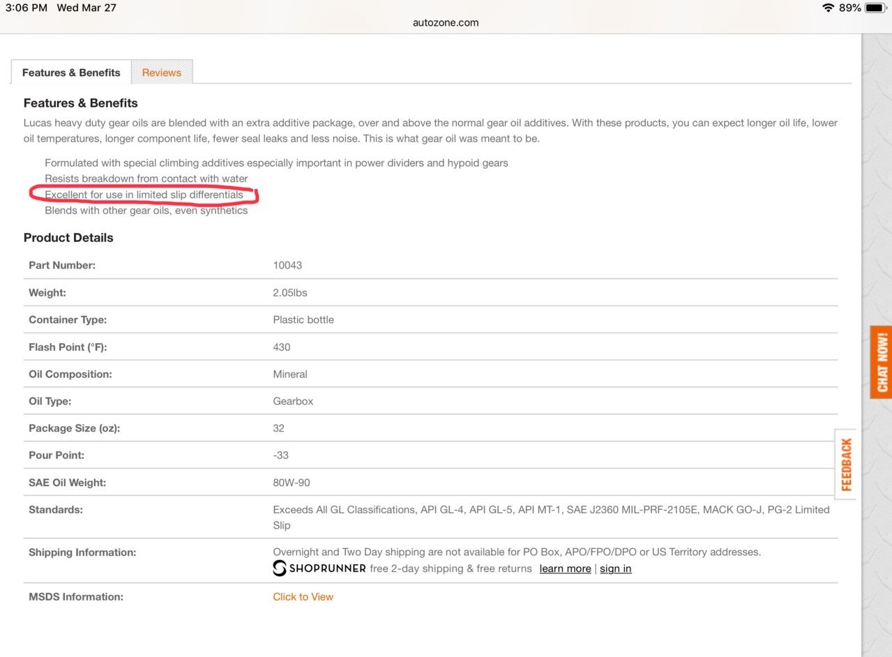

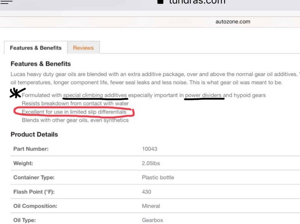

    Dug up this old post from searching. I'm going to give this a shot. You're right that SAE 90 is like a unicorn. I'm skeptical that the 75W 90 Royal Purple is my problem but it's worth a shot.
    I don't see any mention that it has the friction additive though?

    Thanks. No mention of it on Advance website. I'll give this a shot.

    That's the stuff I have been running and not needed any additives. Straight 90 is hard to find, you could order it but that's cheating.
    When I first had my diff installed I used some off the wall brand 90w from Kragen. It came in a black bottle, that's all I remember. Kragen has been O'Reilly's for a while now lol.

    Thanks, I'm doubtful that the Royal Purple 75W-90 is my problem since I've had it in there since last summer but at this point I might as well put in something closer to spec. It's a cheap(possible) solution. If this doesn't work I'm gonna open my wallet for OEM U Joints which my shops claim are really Spicer's in a Toyota box.

    Comes with ‘Climbing Additives’ and my favorite... ‘Power Dividers’. Its gotta be good!

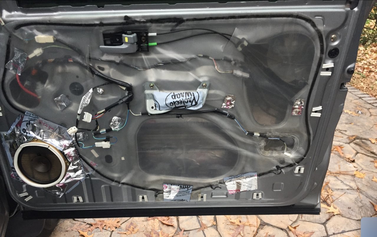

    I considered this moisture situation you discuss here when I did my doors like Jerry. I placed the foam up high and along the side perimeters outside of the drip line of the window. If you are in a dry climate then doing foam in the entirety of the door is fine. Also, it not necessary to butyl the entire door. Strategic placement around speakers is key, then small squares for 30% coverage max on the door. This saves material costs resulting in the same benefit.
    Pictured is my door using big box peel and stick butyl tape and HVAC foil tape to achieve the same results as Jerrys. There is butyl tape inside behind the factory plastic, as well. Also, used some weatherstripping around the clip attachment points (see little white strips). Gives great sound/vibration protection transferring onto the plastic panel after put back.

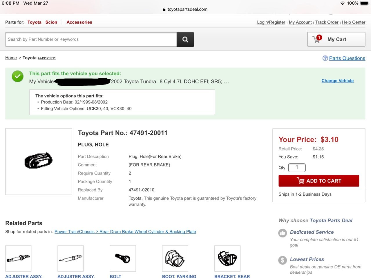

    How do the brakes look? No oil seepage from the axle seals? @Dpy
  27. Mar 28, 2019 at 9:46 AM
    #5427
    Dpy
    Dpy New Member
    Mar 19, 2019
    #27804
    129
    No, they are dry, no oil leaks . They are still probably 1/8 " thick . I will get new ones anyway and do a bit of adjustment .

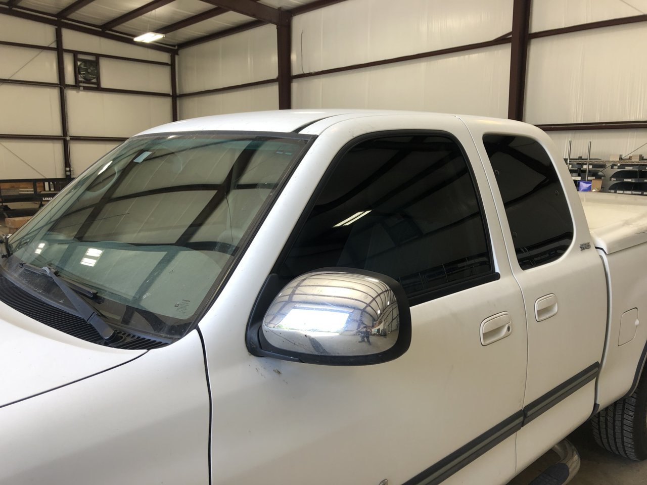

    I just got some tint on the windows. Paint is next! What’s the average cost for paint nowadays? I just want to make sure I’m not getting ripped off. No body work needs to be done.67D7F4A7-98E4-40B7-83F5-8F4283257B18.jpg

    Depends on your desired level of finish.
    $ Ranges is from: 1) Throwing a bucket of paint on. 2) Applying a decent paint to look good till the check drys. 3) High quality deep glossy multiple coats finish with a good primer base.

    Maybe this picture doesn't show the problem but your paint doesn't look that bad, just dirty. What's the problem exactly?
