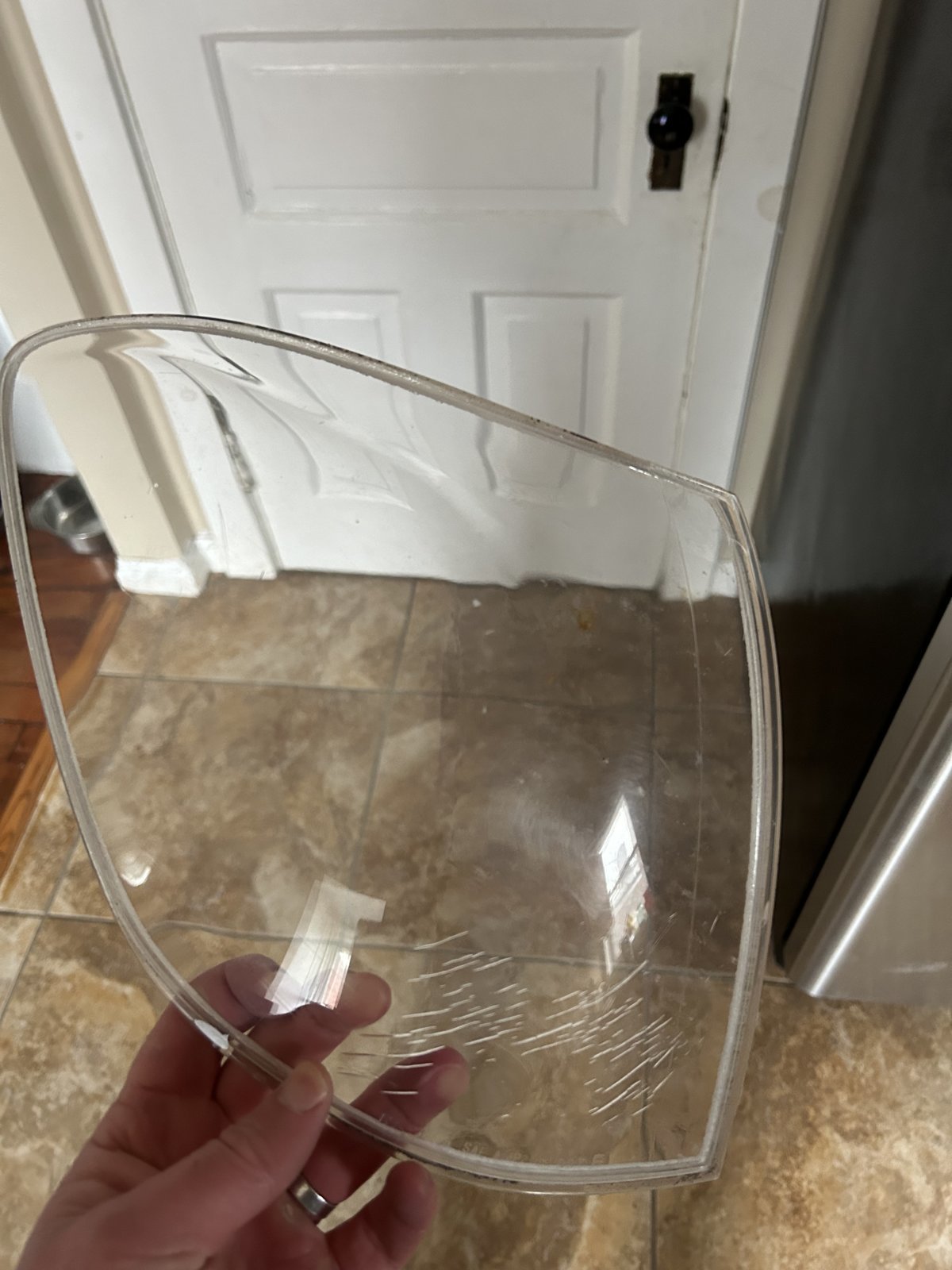

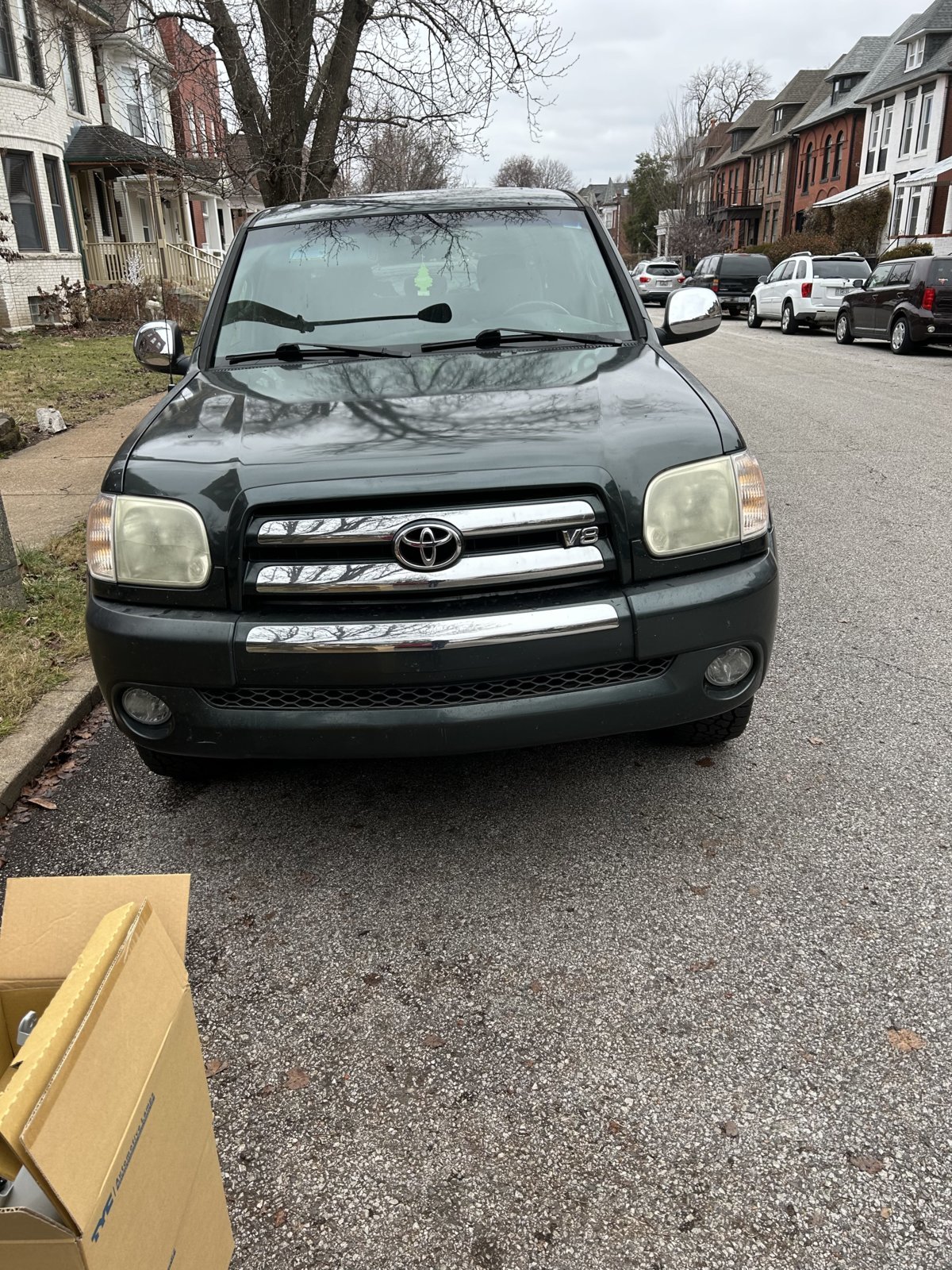

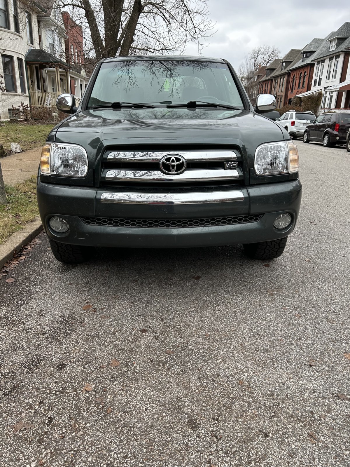

    Alright I need some urgent help please! replaced my headlight housings this morning and the passenger side corner marker light lens popped off. It looks like it has a ridge that can snap back in but I can’t get it to stay. Nothing is broken, maybe some clear silicone around the edge in the meantime? Anyone had issues with this? @shifty`

    Usually it’s set in place with a butyl rubber material. Gotta scrape it out and reapply

    Amazon => Morimoto Retrorubber (MRR). Remove bulbs and rubber. Stretch it out and slide it into the channel. cap it back together. Bake in the oven at 250° - 275° at 5-7 minutes time to melt the MRR. Allow time to cool.
    This is what gets done for any headlight retrofit, bake to soften the glue, pry lens off, reapply MRR, bake together.
