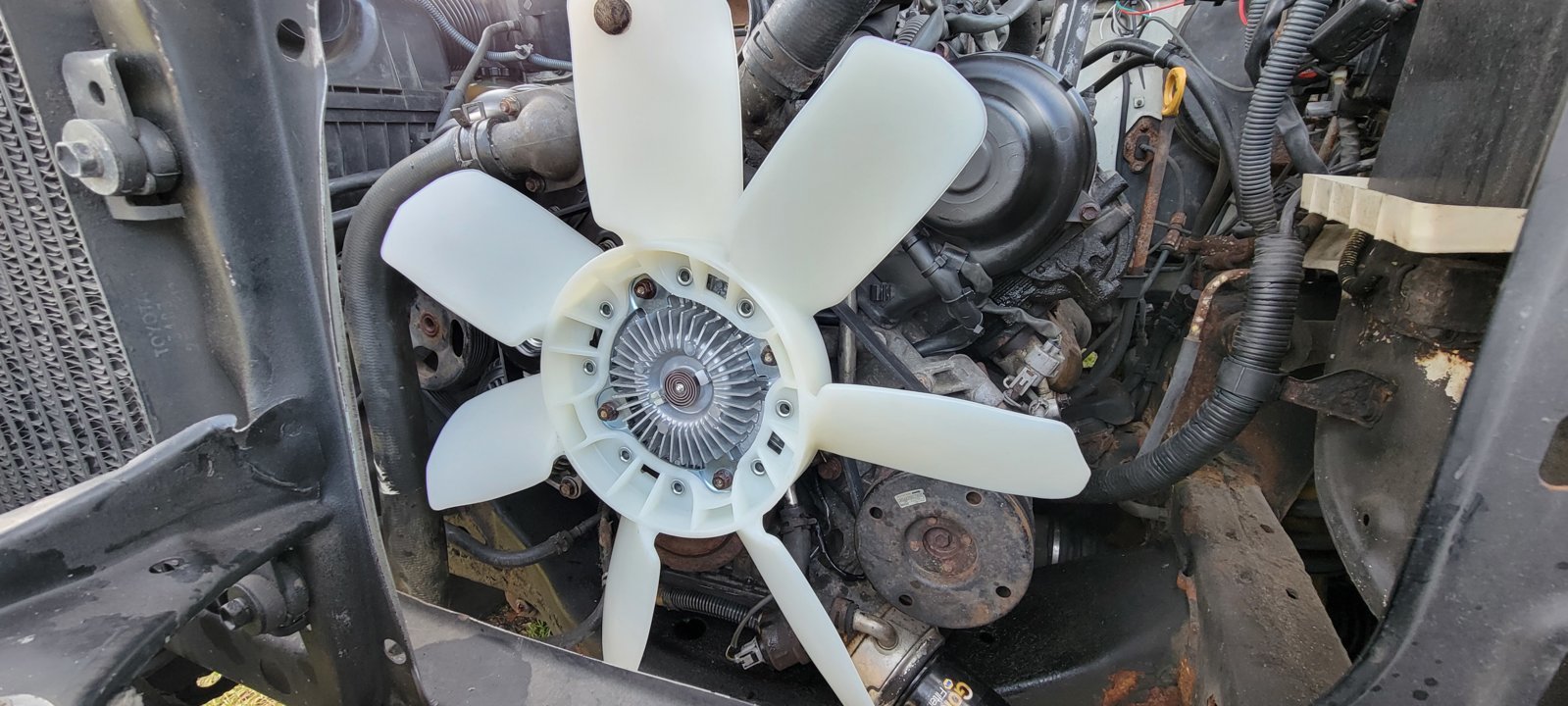

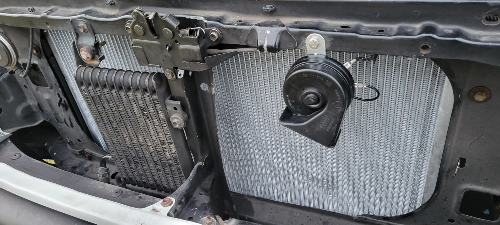

    Everything is completed on the Radiator/Clutch/Fan/Tensioner/Idler job, I took my time and really enjoyed the work.
    Still need to do the "park on a hill burping session" but it's not bad now. Heater seems quite a bit hotter.
    Poor heat was the reason I spent about 30 min burping it before, and it worked. So at least I don't have air major air bubble in my heater core.
    The tensioner was a squeaker at first and I wasn't real happy, but by the time I got done topping off the rad, it was nearly silent.
    Revving the engine does not make the fan smack the water inlet anymore, but there is still a little wobble.
    It's in the fan mount, and I bet it took a hit when this thing was in it's accident and it looked good enough so they used it.
    Unless you look close you don't see it, but it amplifies out to the blades. That will wait until I do the timing belt 2025.
    Looks like valve cover gaskets too, I did tighten them and some were pretty lose.
    Bonus jobs: re-route sensor wires properly, and added the missing LOW tone horn $8, so It doesn't sound like my Civic anymore. It was pretty hilarious.
    I never broke my "restrictions" but damn my right shoulder is sore.

    Any issues with getting the fan and clutch off due to rusty bolts or was it relatively easy?

    Surprisingly not bad at all Jack. I didn't even use any penetrating fluid, and you can see in the pics they were a bit rusty.
    I used the double wrench method but as near as I can figure it's accident was late 2014, so after that when someone was rebuilding it they had it off/put a salvage yard one on.
    So it wasn't as bad as "never been touched" since new. I picked it up with 288k in Sept 2021, According to service records it had 280k in Feb 2014.

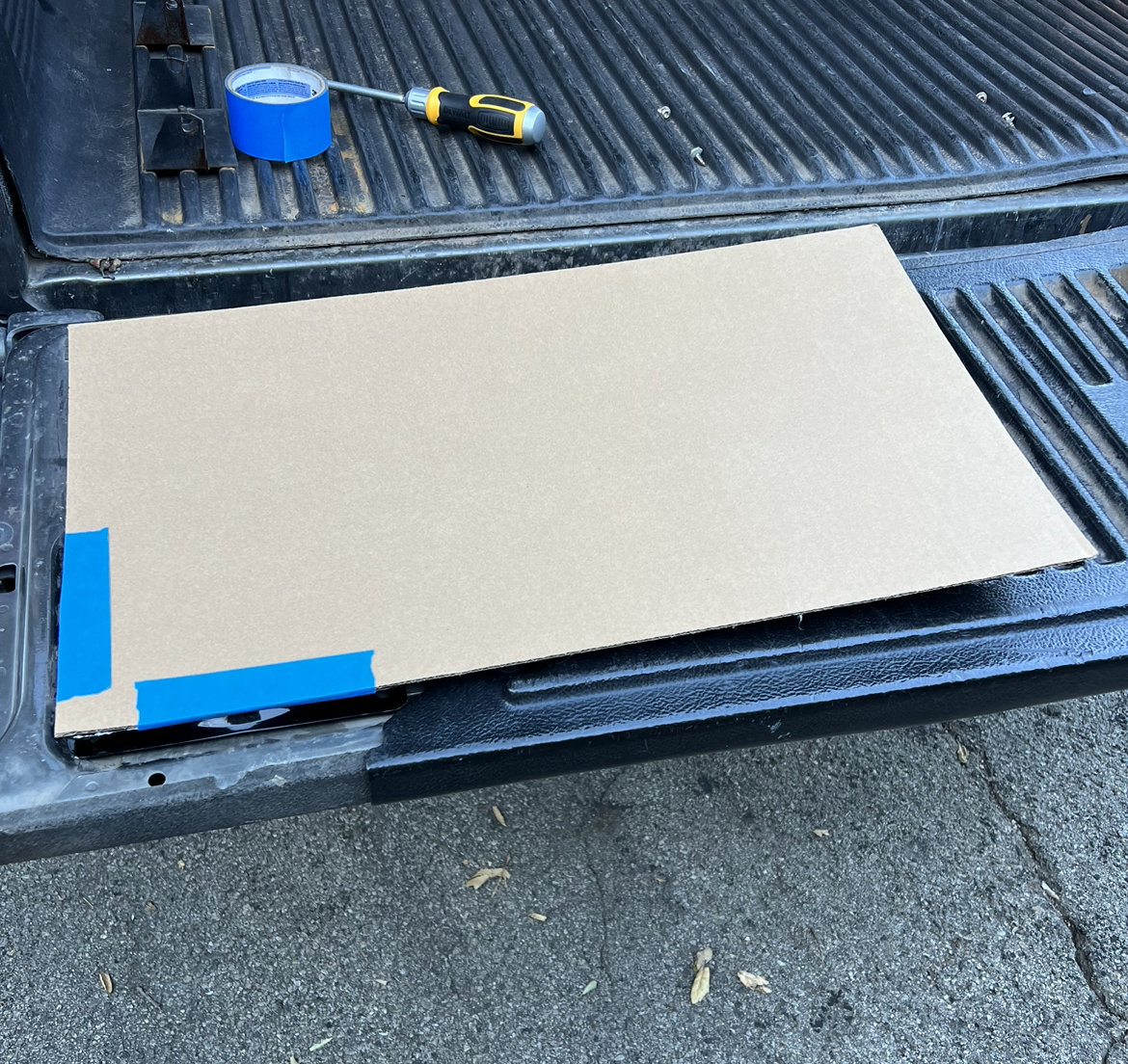

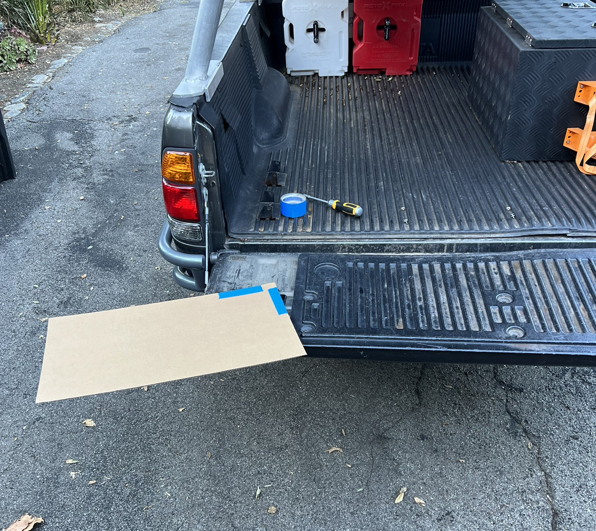

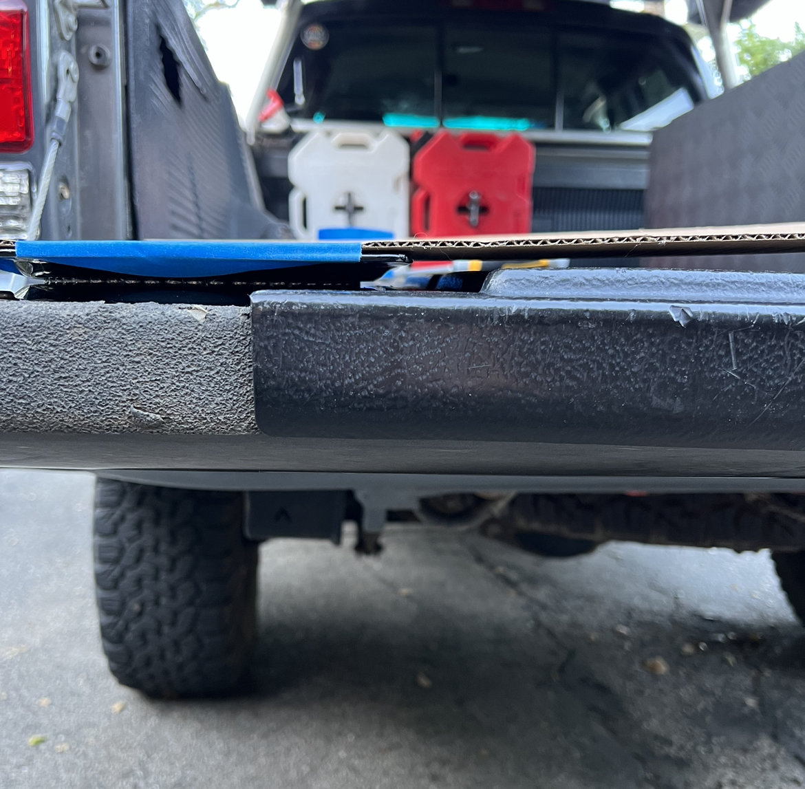

    So I had an idea about more table space…F886EEA7-CE0D-49B6-ADE8-46AFCFACF7DC.jpg
    Figure a flat piece of aluminum should hold up well as a surface for the stove which will leave me plenty of room for cutting board, water bottles etc I keep on the tail gate. Chef boy r V

    You could also put a hinge and another piece of wood, so when it’s open, it can open even more!!!

    Considered it but feel it wouldn’t be sturdy for anything meaningful and really this is all I need

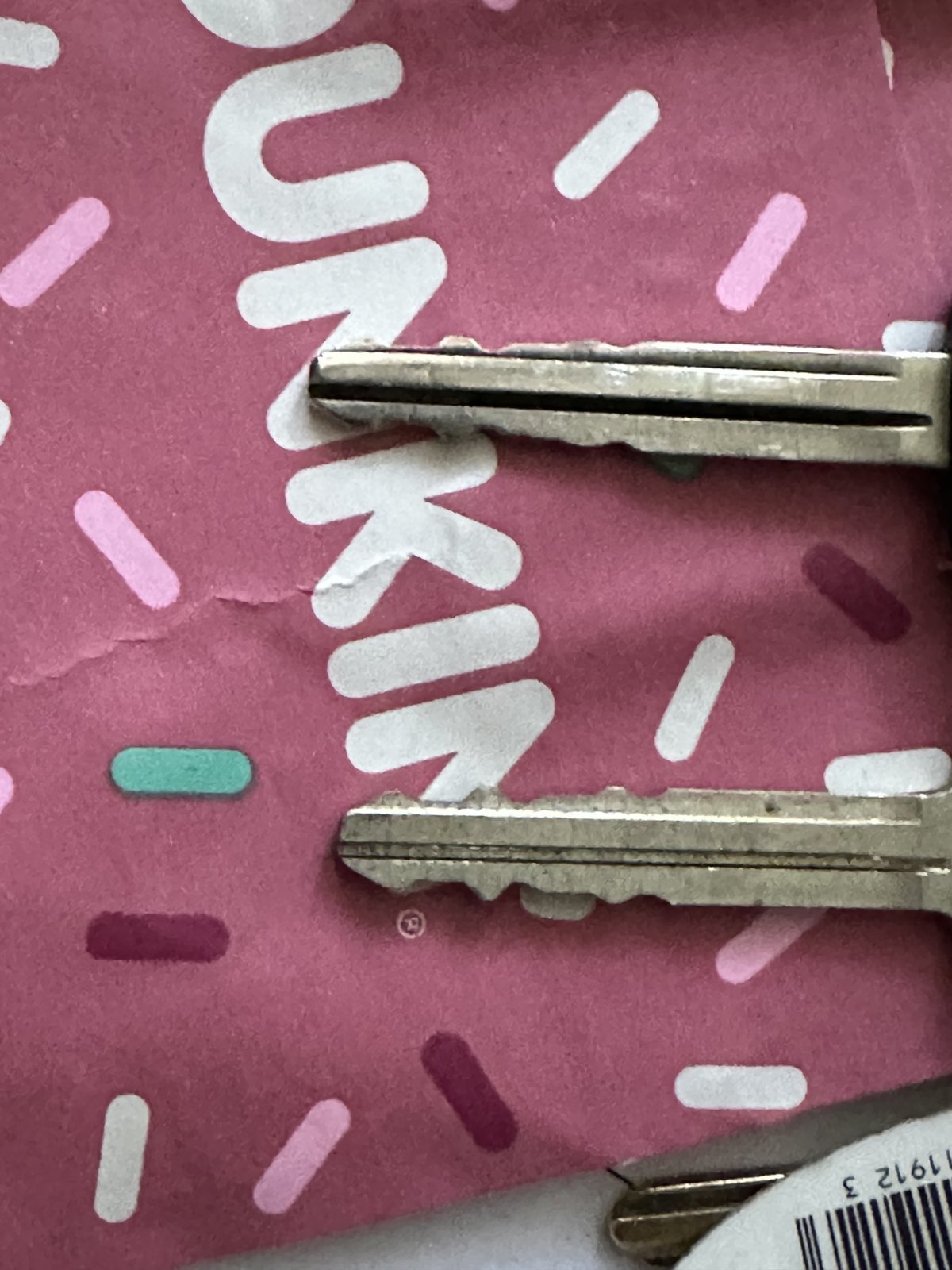

    Had to walk 2.5 miles from Target since my worn down ignition key wouldn’t budge in the ignition cylinder. Cycled back and tried one of my 3 remaining backup keys to get me going.
    Time to toss out the worn one. Not bad for almost 22 years of abuse.
