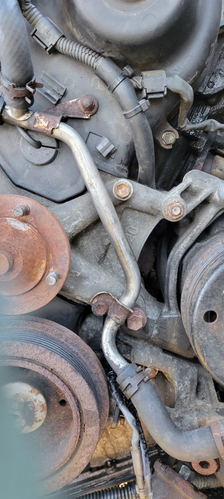

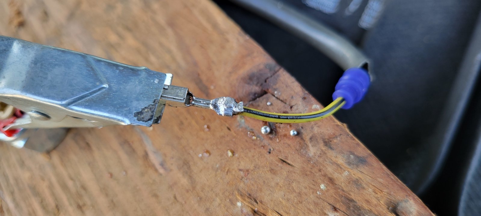

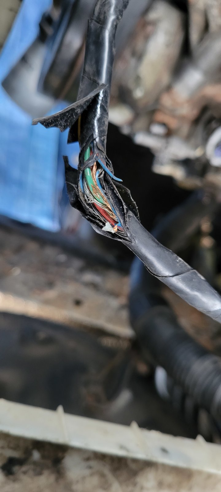

    Over a year ago (while I was still cleaning up the POs stuff) I found this, and did that repair.

    Oof. Comprehension > Me

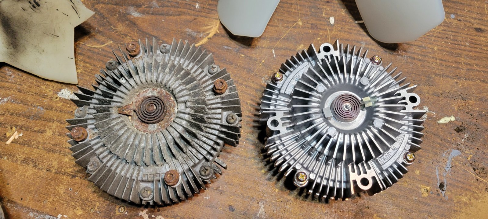

    Out of curiosity how hard is it to replace the fan clutch? I’ve been told I’ll need to do it down the line but not immediately. Also how can you tell when it’s time?
  12. Dec 15, 2023 at 4:48 AM
    bmf4069
    Sep 1, 2018
    #18880
    9,873
    Beau
    TX
    02 AC sr5 4wd v8
    I'd recommend removing the shroud and radiator to make room for yourself. After that it's 4 bolts and put the new one on. It'll start making really weird noises when it starts to go, and will feel gritty and lumpy when you turn it by hand.

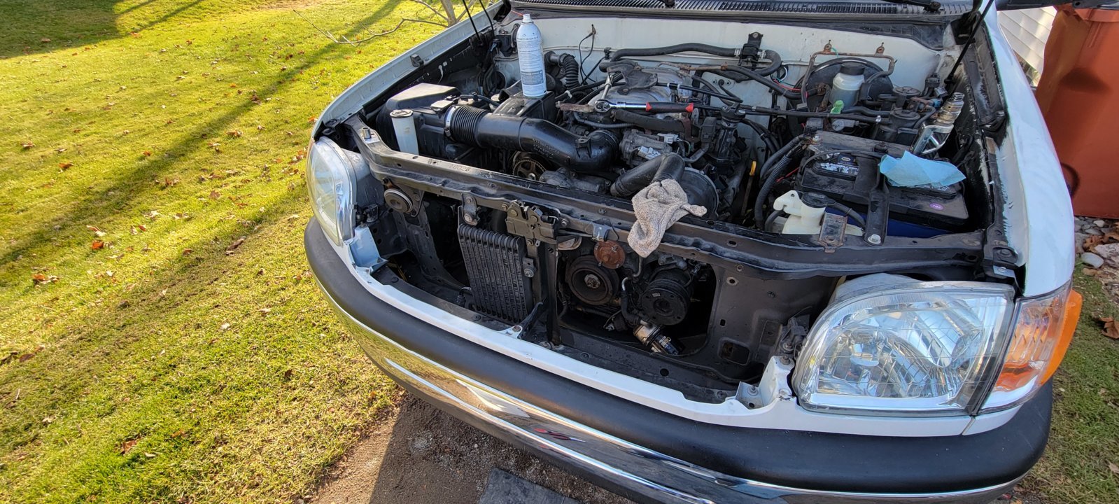

    Pulling it wasn't bad at all, one of the easier things I've done.
    The biggest challenge for me was getting my big ass meat fists in there.
    If you leave your radiator in, the fan shroud has to come out with the fan/clutch assembly (at the same time).
    Disconnect the rad hoses and move them out of the way.
    If its locking up:
    Longer to warm up (a bigger deal here in MI)
    Excessive noise on acceleration (when engine is warm)
    When cold, fan will not free spin or has a lot of resistance.
    If its free spinning too much/all the time:
    Poor cooling and poor AC performance (notice either in stop and go traffic)
    Fan will continue to spin a few revolutions when you shut engine off (warm engine)
    Fan spins freely by hand with little resistance (engine warm)
    I'm just an armature shade tree driveway wrencher, You boys correct me if I'm wrong on anything.:thumbsup:

    Weird thing with the brand new clutch is that it has the same resistance (a lot) spinning it by hand as the old one.
    And when cold they should spin more free?, maybe it's just that I can't apply enough ooogadoogas but it doesn't make sense.
    Like I imagine this new clutch in there, and trying to spin it, and it's not going to spin very dam far.
    I'll know soon enough, tensioner and idler are in the delivery truck heading my way.

    Thinking about it now I could have made my life WAY easier if I'de done it like you did. I mean the radiator was coming out anyway :rofl:

    Im still on my original fan and clutch at 270k with no discernible symptoms of failure. There, now I’ve jinxed it. I plan to replace at my next TB change anyway which is coming up in 2025 by time, I’ll fall short of the 90k miles by quite a bit. May do the whole shooting match earlier due to the need to replace starter contacts soon.

    I've been trying to determine wtf caused my fan to flex into water inlet/thermostat housing...
    One possibility is the clutch was locking up too much/putting pressure on fan blades/contact/explosion.
    I also thought maybe the PO put the wrong clutch in there, but it's exactly the same as the new BeckArnley.
    And they both seem to have the same (cold) resistance right now.o_O

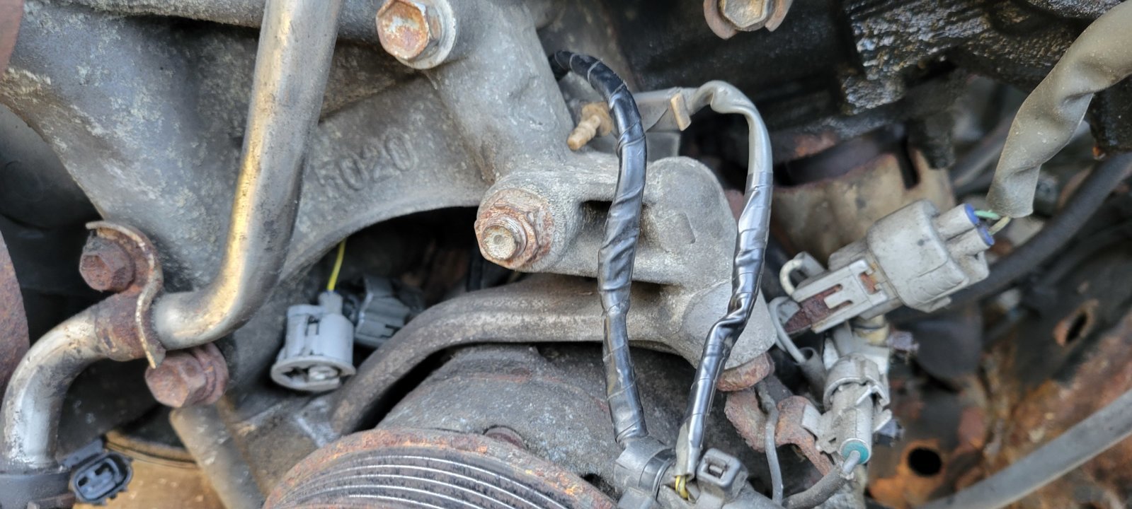

    So is that part of the harness supposed run through where I pointed out Shifty?
    I swear I might be able to fit the connectors through there, and NOW is the time to do it with the radiator and everything out.
    Shit I could even De-pin them and do it if I find some ambition...

    Yup, here's some before/after:
    https://www.tundras.com/threads/wha...-gen-tundra-today.2558/page-1597#post-3155629
    I have some others from mine, but the result was similar.

    Behind the water pump, you can see another zip-tie example here in PHM's build: https://www.tundras.com/threads/the-professional-hand-model-reinvestment-‘build’-a-chronological-story.46816/page-7#post-1885894
    Gimme a few, I'll try and take a pic of routing on my truck.

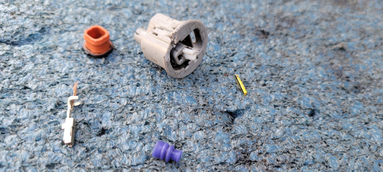

    Plugs easily fit through those openings. Oil sender wire was hanging by a thread, tried to be careful but... De- pining and doing that repair on my way to the re-routing wires :thumbsup:

    I couldn't get a good picture of anything from above with the intake installed and no ability to get in front of the truck (I have to pull it up to 1" from the wall or I can't walk behind the truck)
    I'd love to see a pic once it's re-routed how it should be.

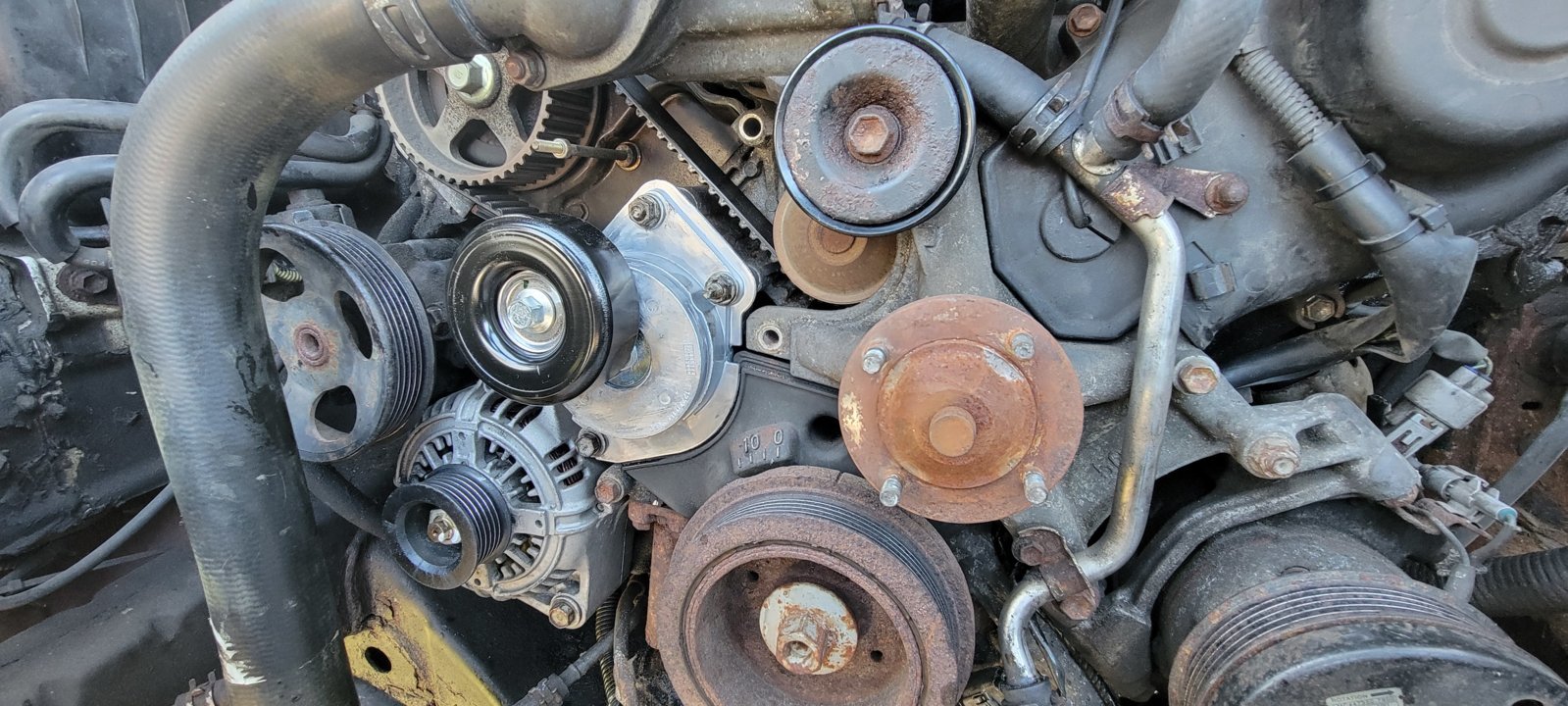

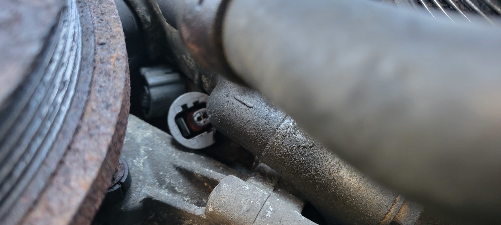

    Yeah, I figured it would be hard but i appreciate it :fistbump:
    Even with FREE access this is some next level hand ninja (and i am XL paws man) not imposible though.
