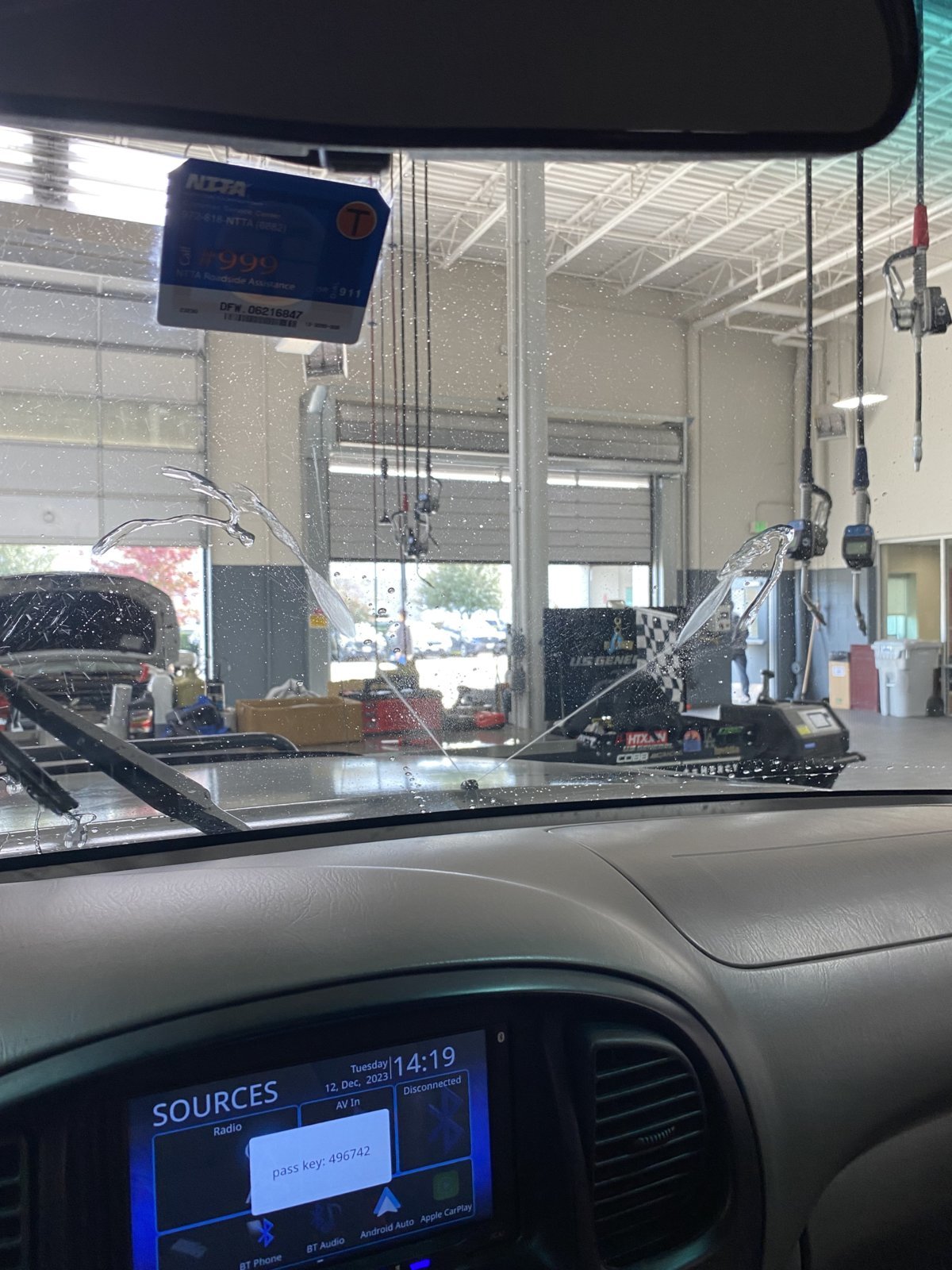

    Upper windshield lost its seal. Probably rusted.

    So mine had a big crack from top to bottom in the windshield when I bought it. I don't know if that had something to do with the leak, but the crack ran right by the problem area. When I finally got the windshield replaced a few months back, the guy said he had to clean up a lot of rust behind the seal. But since then, the leak has been gone. I suspect when the windshield cracked, it caused the seal to lift up slightly and allowed water to settle in the pocket it created. That caused the rust, which further pushed the seal from the roof and eventually caused the leak. That's my theory anyways.

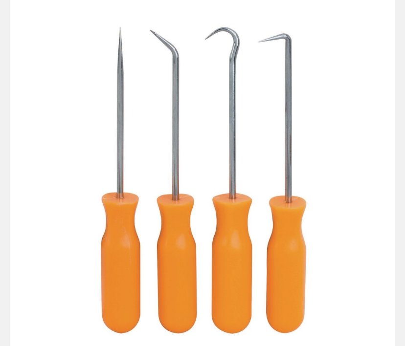

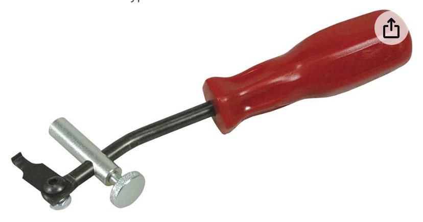

    I have a seal removal tool like this
    but somehow since the last time I used it, the hook tip part unscrewed itself and went AWOL. It’s recommended by a lot of mechanics but honestly, it wasn’t super great. The hook tip part wasn’t very strong and the ‘hook’ straightened out and wouldn’t grab anymore during its first use. It’s also just a clumsy design. I ended up using these from harbor freight as I had them already. They’re like 2 bucks.
    The seals came out easier than expected. The trick is to stab between the shaft and seal, and then point the hook to the outer edge and pull out, working your way around so it comes out straight and evenly, otherwise it will bind. The shaft is extremely hardened steel so you won’t scratch it unless you’re really trying to.

    What does the silver part of this tool do?

    I was going to get one of those tools when I did my crank seal...but I ended up using a 50 cent paint can opener. It worked surprisingly well.

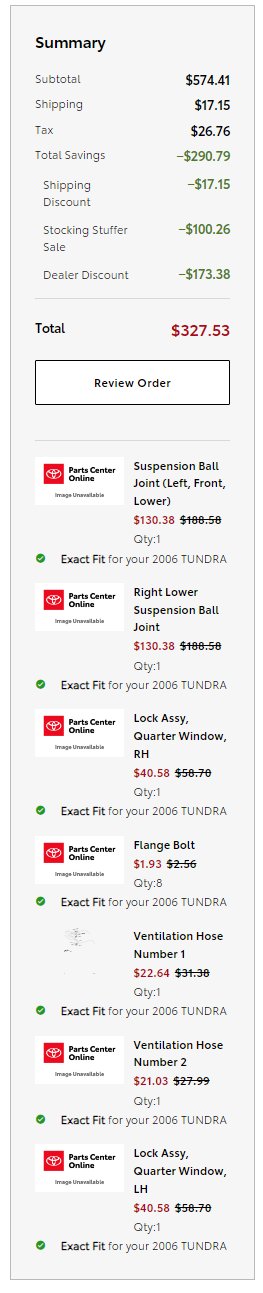

    Thanks, @JakeJake. As if I needed to spend the money or something. :rolleyes: :rofl:
    "Today, shifty ordered some parts for his Tundra!"
    BroHon, bmf4069, Voss and 6 others like this.

    It's a vicious cycle. Cant complain about $290 in savings though!
