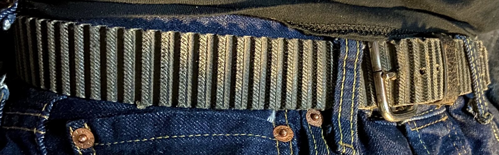

    On a positive note, now I can make myself another timing belt belt. The one I made before I’m actually still wearing, and has outlasted any leather belt I’ve worn in the past.

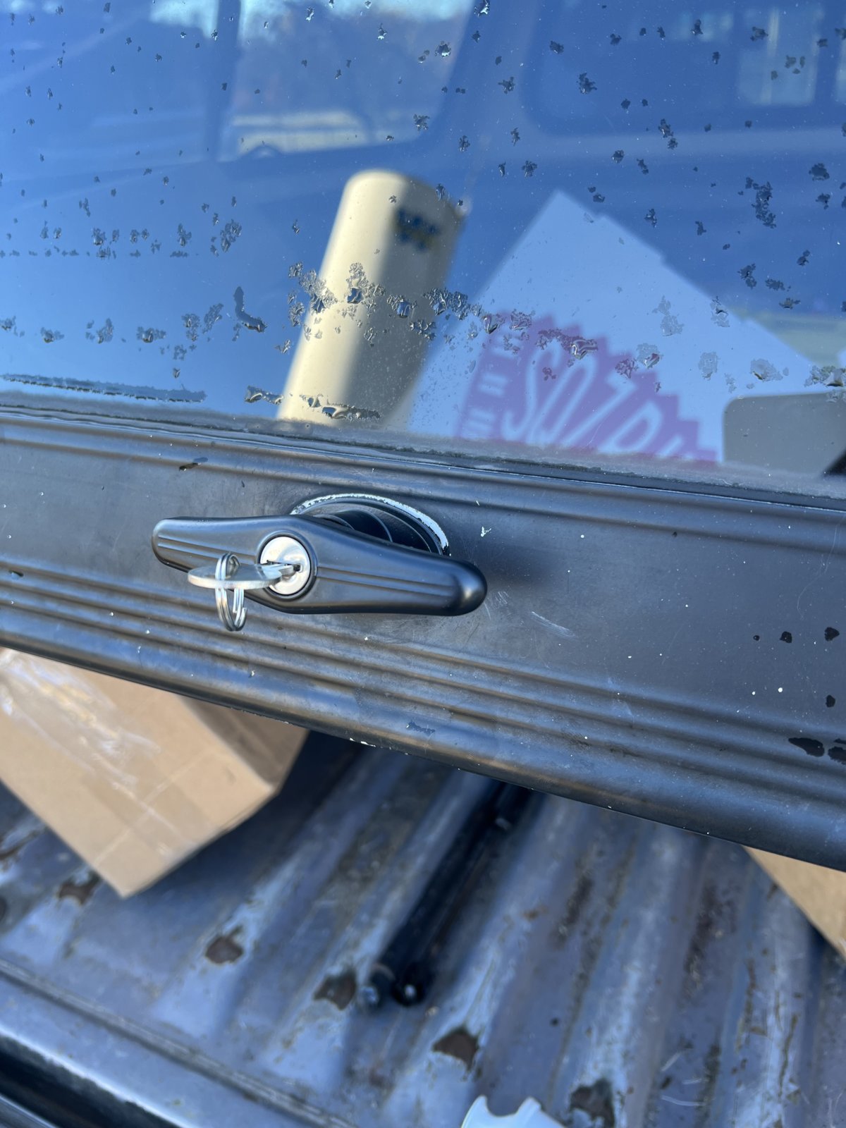

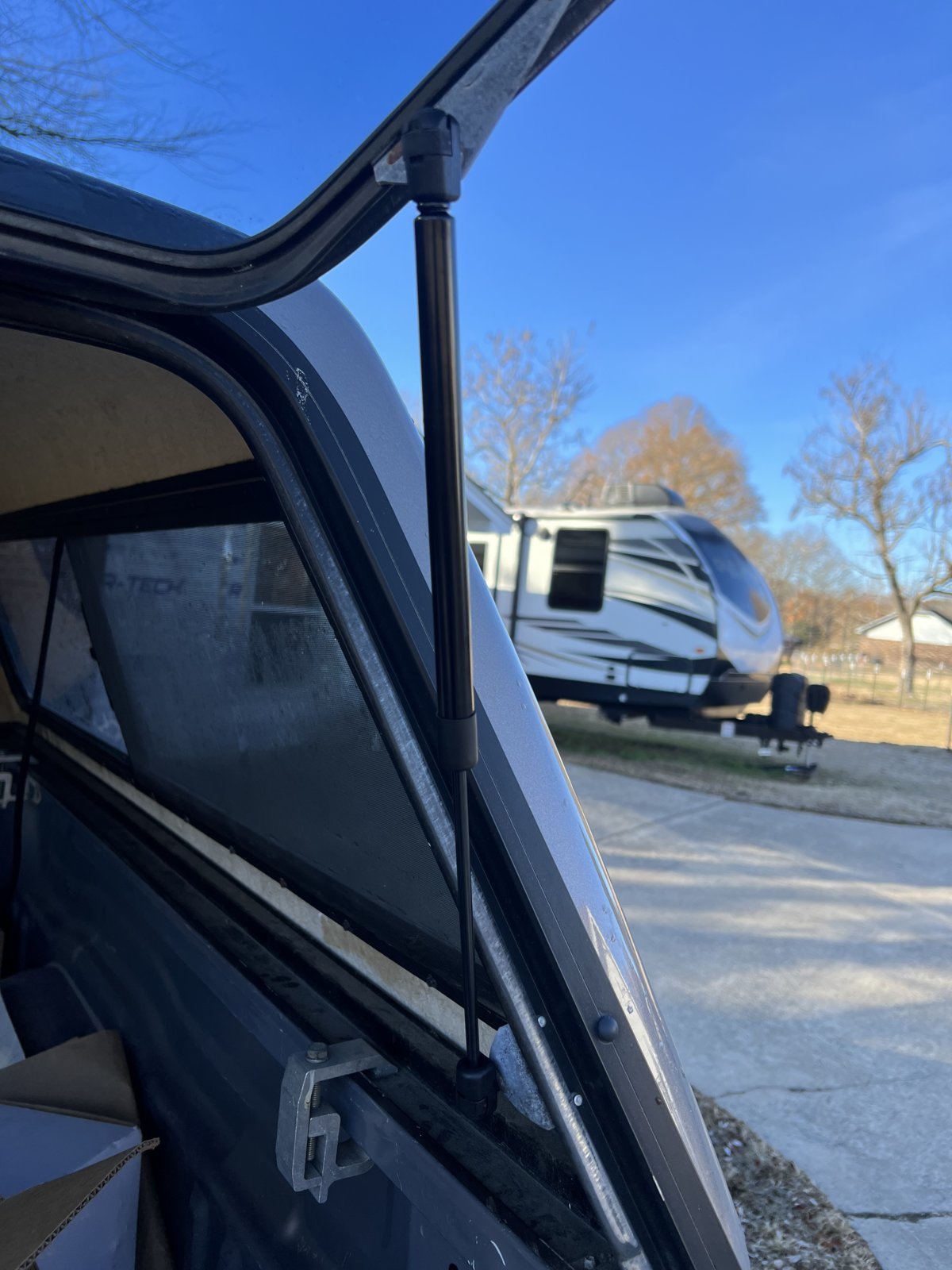

    Swapped my tired gas struts on the camper shell door, probably the originals. Also swapped for a new handle with keys so I can actually lock it.

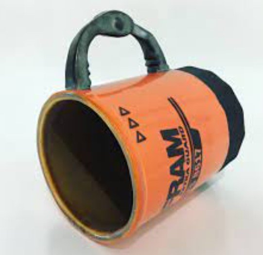

    As usual, late to the party. Already taken. To be fair, it probably makes a better mug than an oil filter based on the branding.

    What's the best tool to cut it and preserve the rolled lip? Or do you have to cut it and re-roll it? The top seems to thick for can openers.

    I've tried to find a way to lock mine from the inside for when I'm sleeping back there on the road. I'm sure there is a way I haven't thought of yet.

    You can lock the tailgate. I'm not sure someone would want to break into an occupied camper shell. And if I was sleeping in mine I would have my (G)Lock armed. I think a strategically placed vice grip on the latch bars would create a lock of sorts that would give you time to respond.

    That’s a porcelain mug bud. The handle is made to look like a set of filter pliers. Would you really want to drink out of an old oil filter anyways? There are just so many other things to drink out of besides one of the filthiest things on the planet. Just a sayin….

    No doubt. People may not know I'm sleeping back there unless they shine a flashlight. I would like a few seconds to grab said (G)Lock.
    I like the vice grip idea.

    I was actually talking about how to do it with our filters, not replicate what was done there. It’s a fun novelty though.

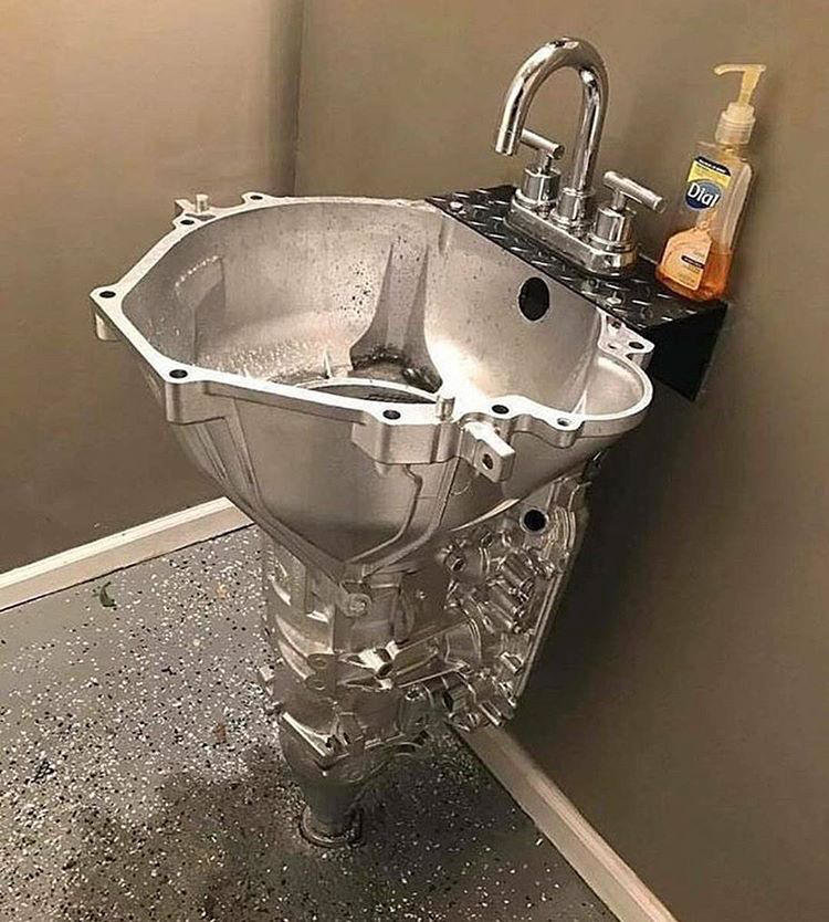

    Like have you seen @bmf4069 's hall bath?
  29. Dec 11, 2023 at 10:25 AM
    Mr.bee
    Mr.bee King Turdra
    Jun 4, 2022
    #79178
    6,423
    SATX
    '02 AC TRD
    I never understood what all the fuss was about. Seems like a great idea to me.
