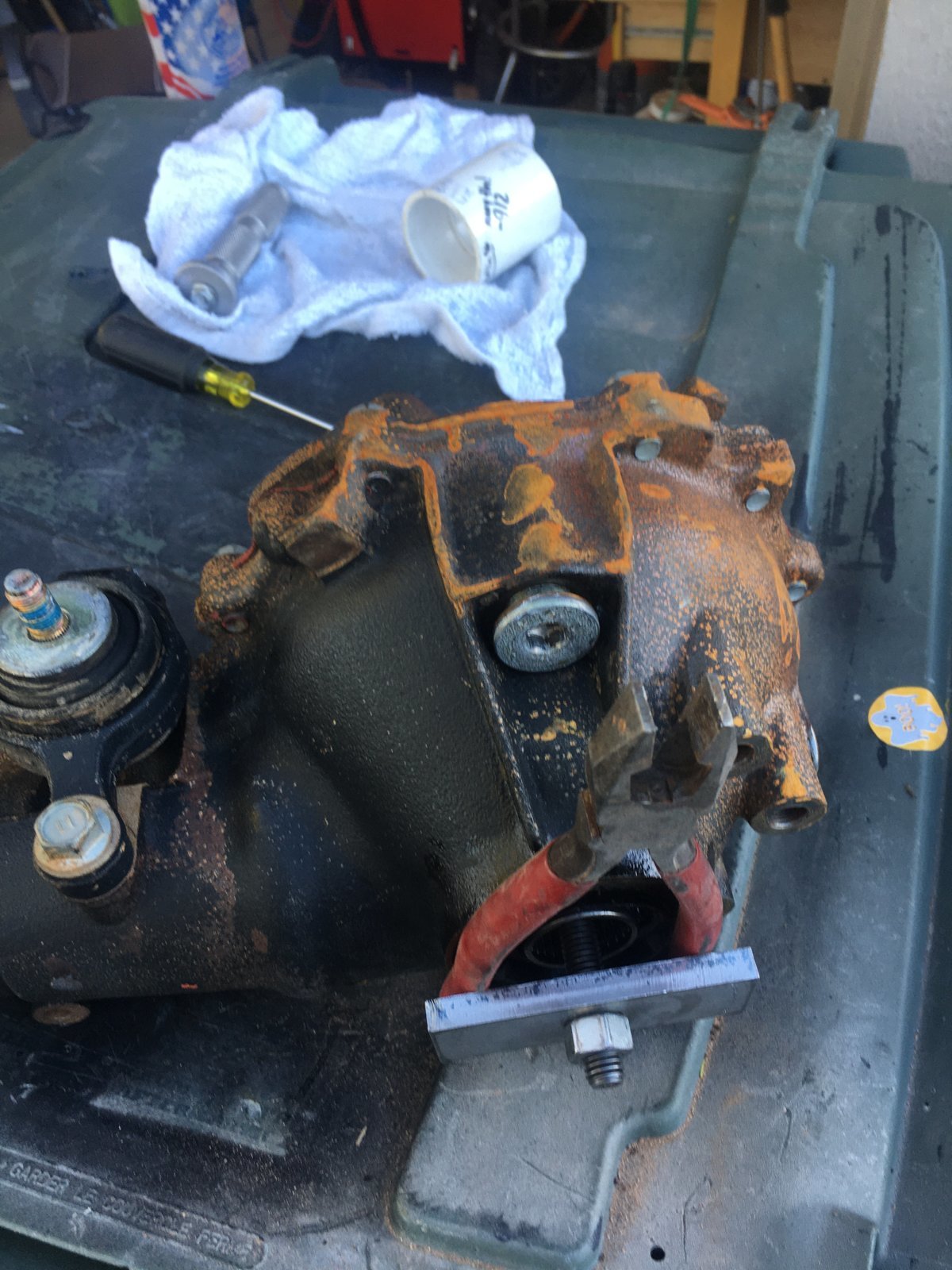

    1E74F5B8-6D32-494F-88C7-9C75BB98B833.jpg Much easier pulling the needle bearing when it’s on a “bench”
    I couldn’t find my seal puller, but channel locks worked just fine

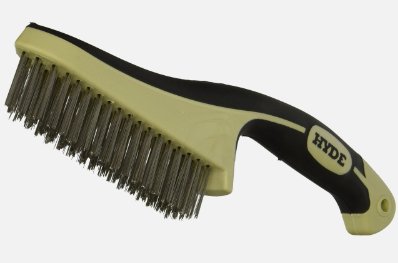

    I wouldn't use either, they're both overkill for rust that light/flaky. I'd use a steel stiff bristle brush like this to remove the rust, then naval jelly it. Anything more will do more damage to the metal than it's worth.

    A wire wheel won’t damage the metal and it’ll get into the pitted metal and clean it out better and faster than a steel bristle brush done by hand. I’ve done it plenty of times and never had an issue.
