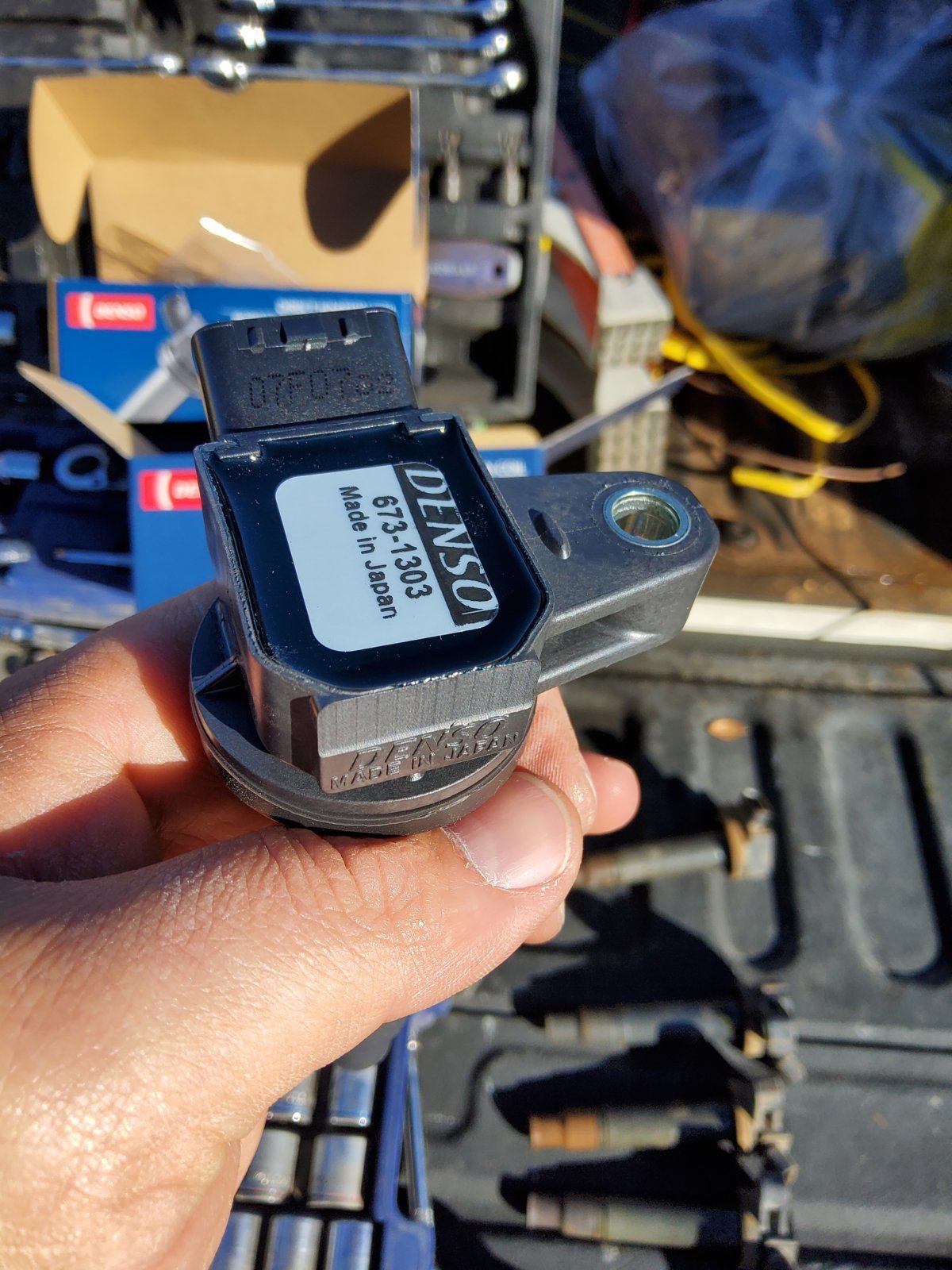

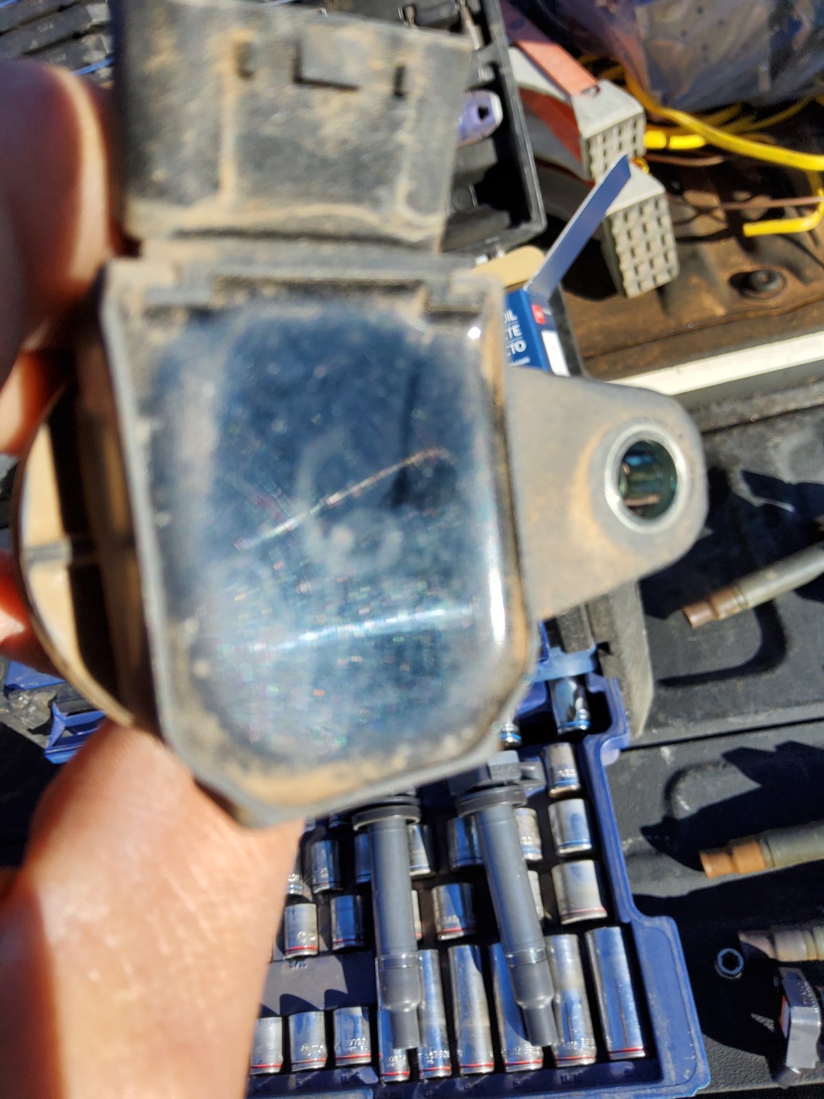

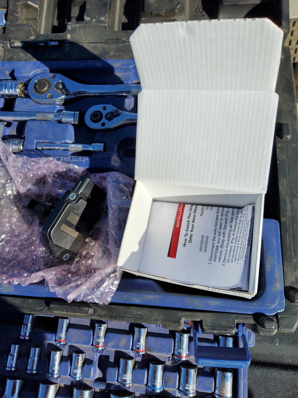

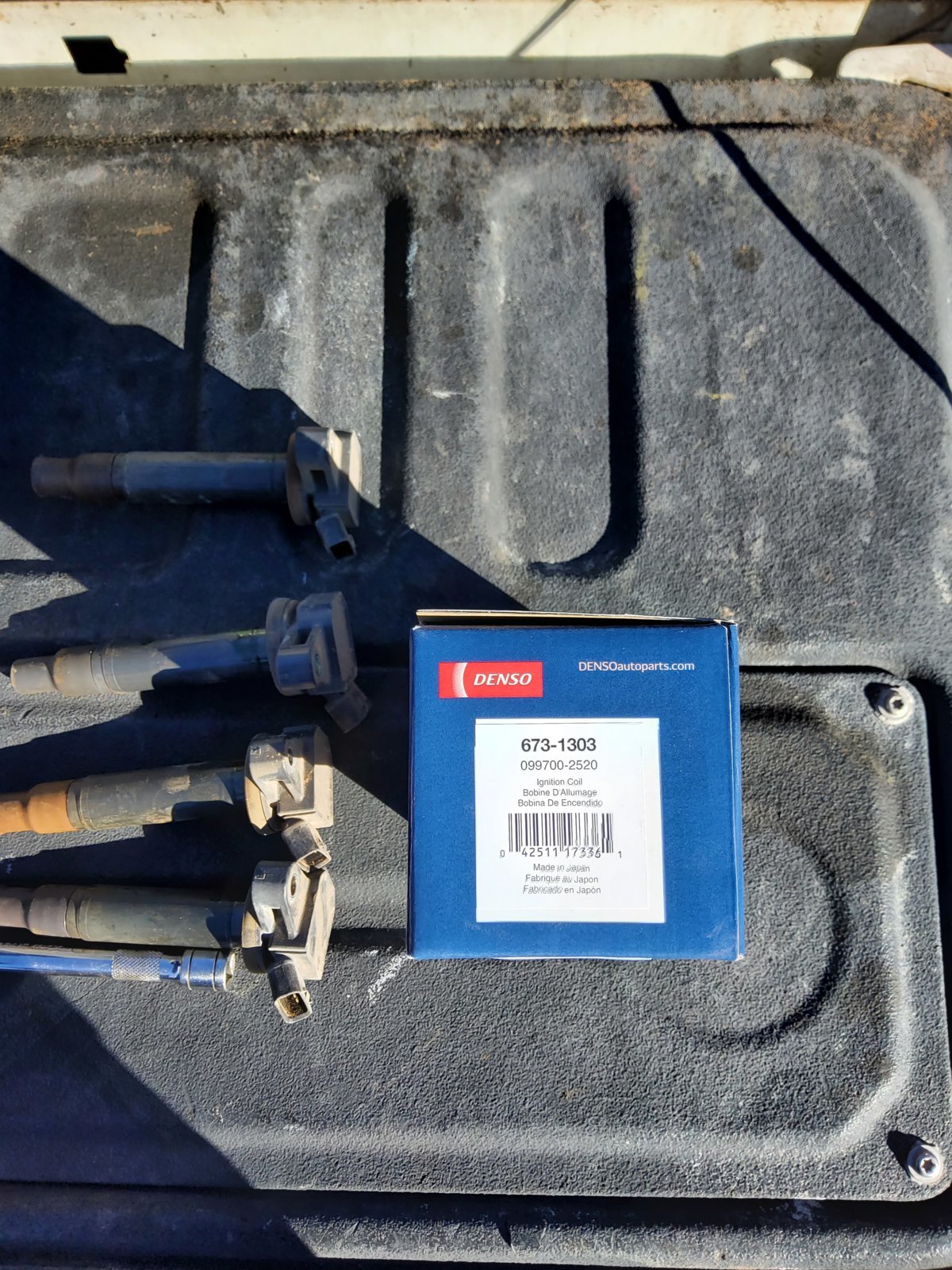

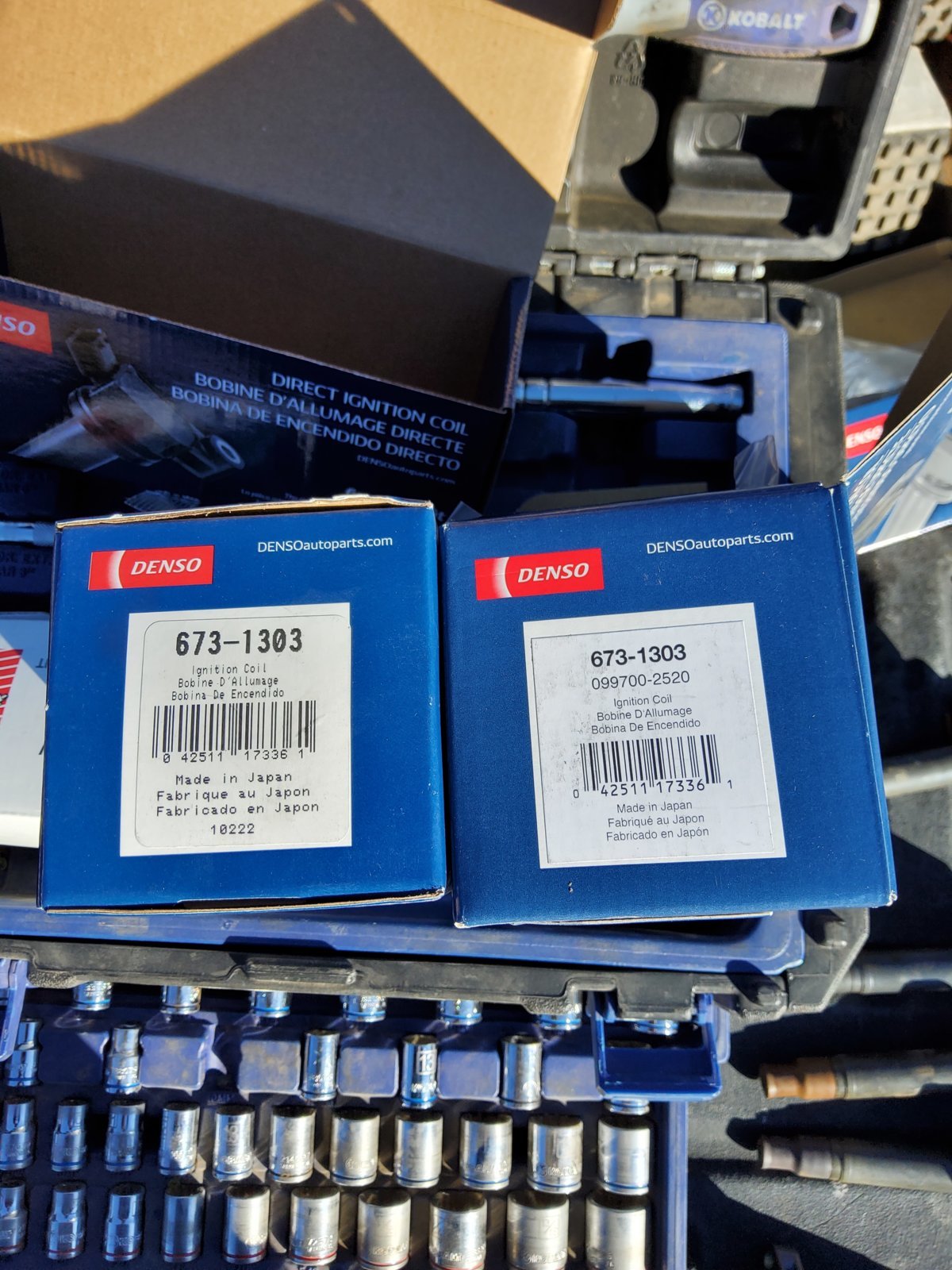

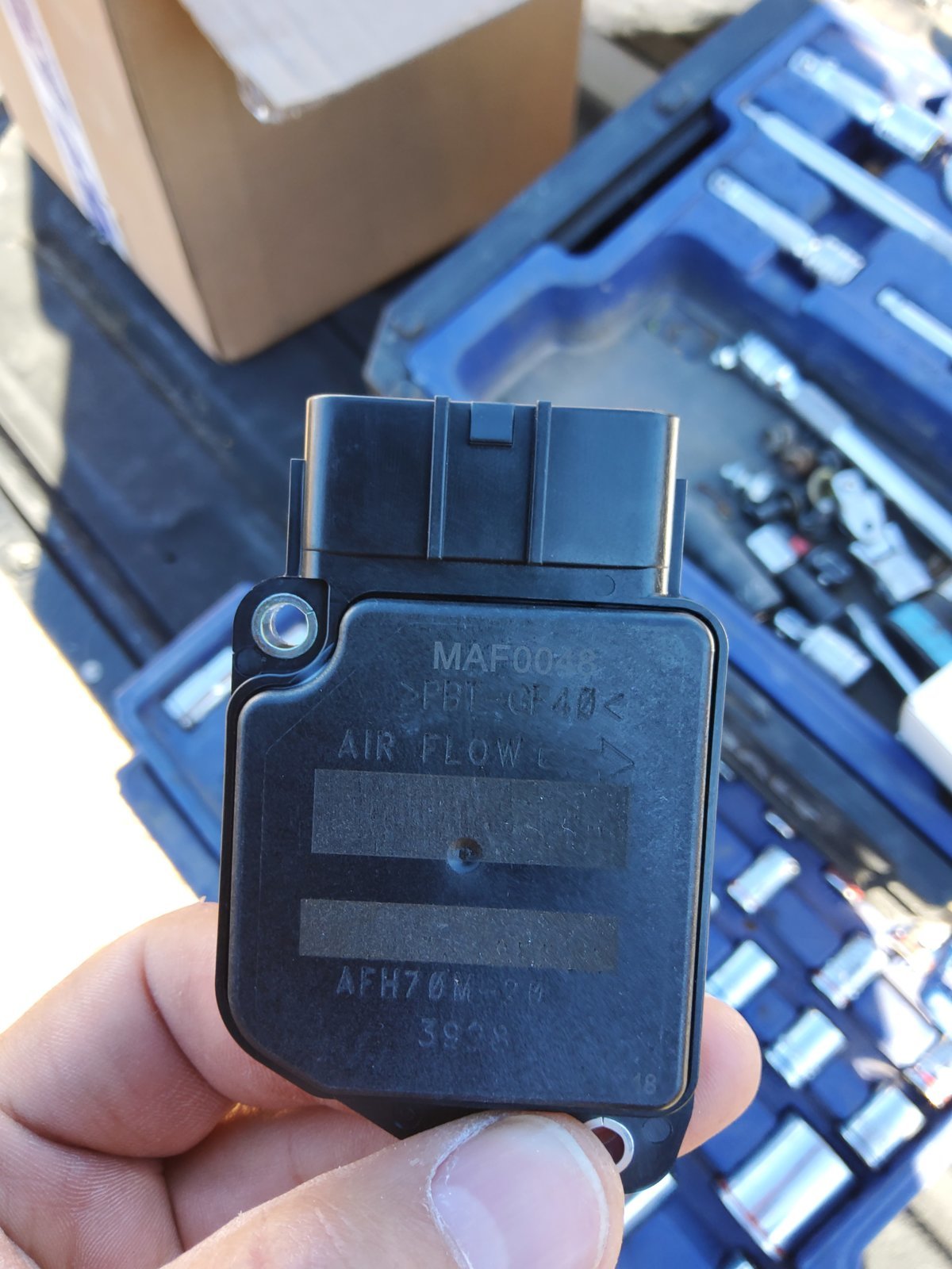

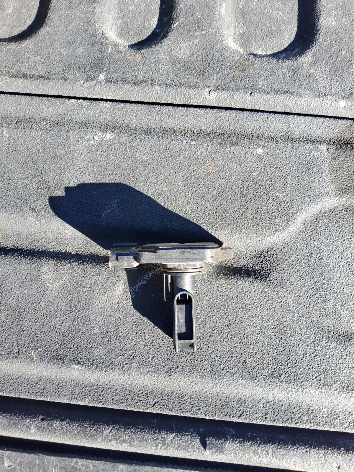

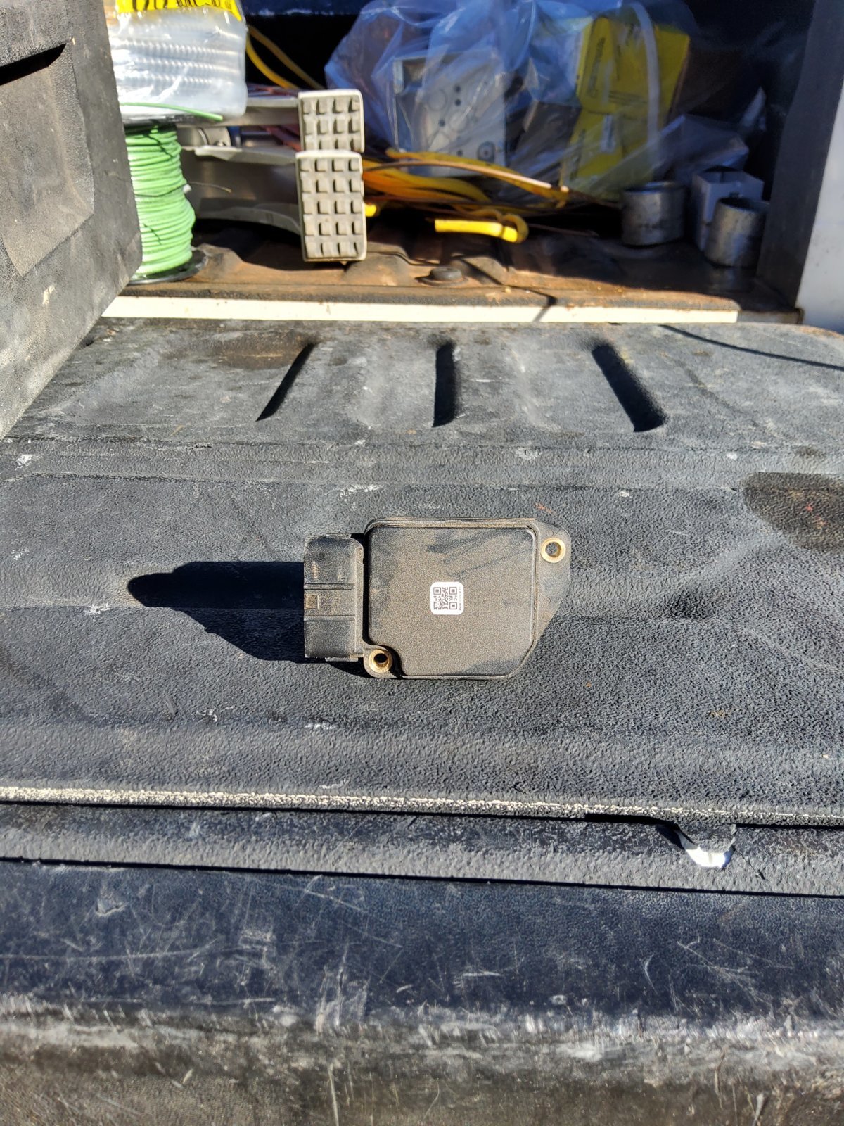

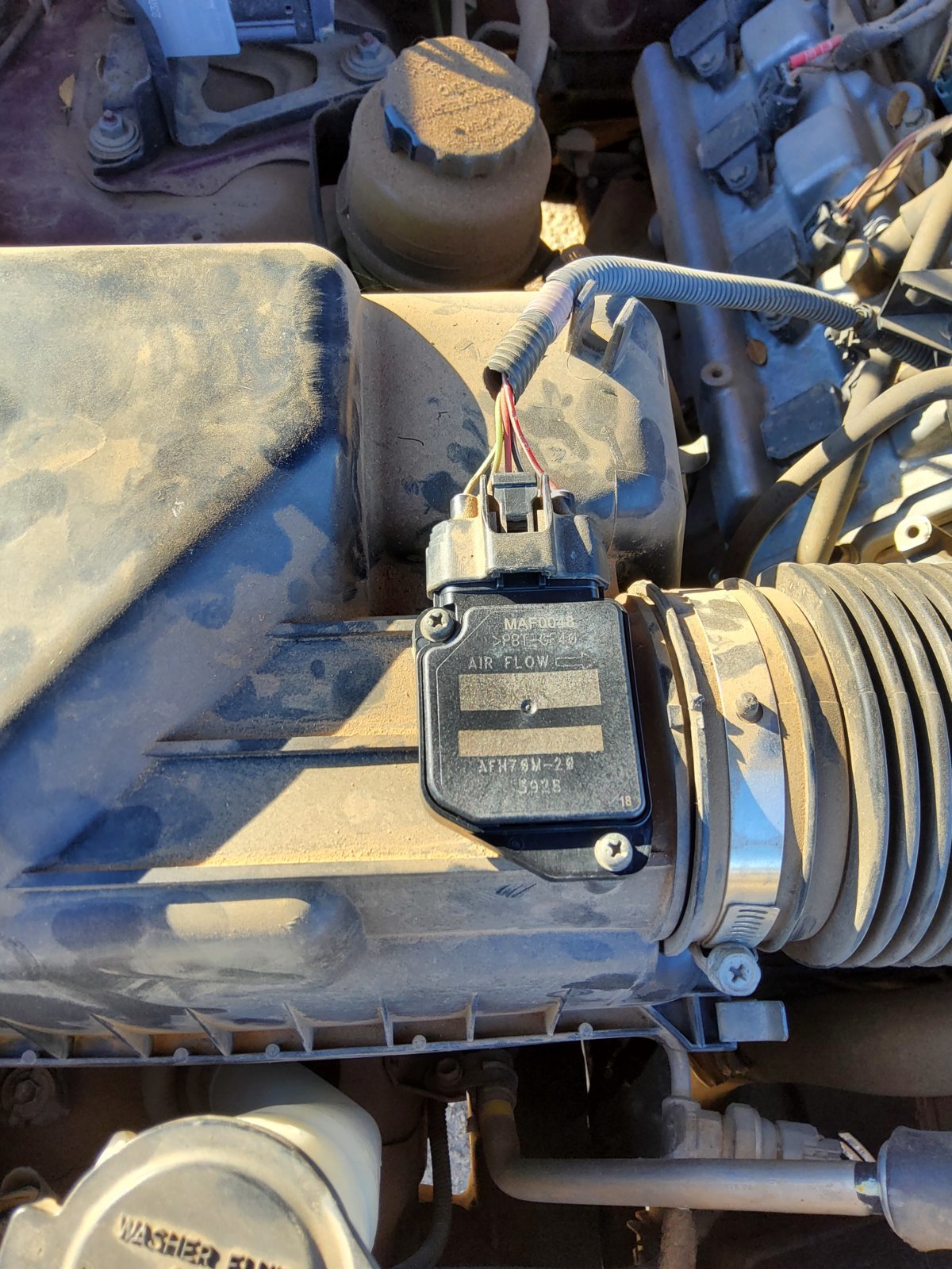

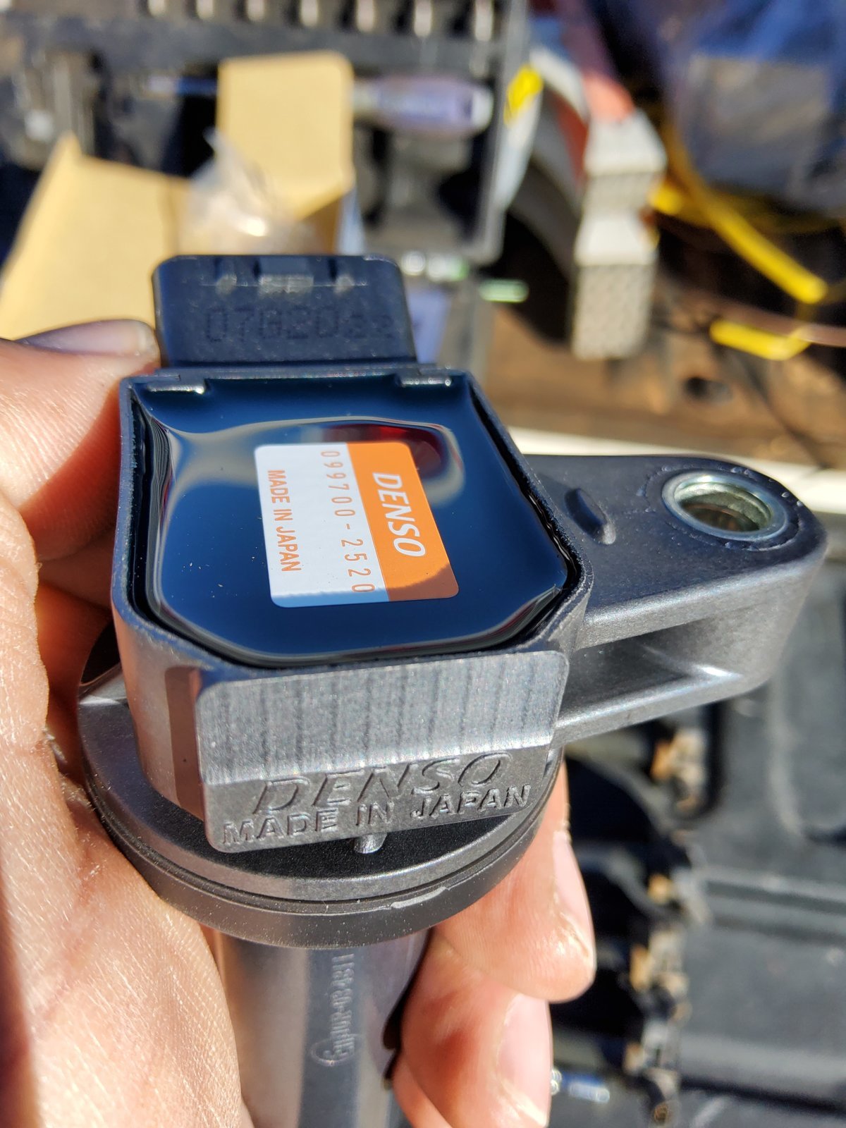

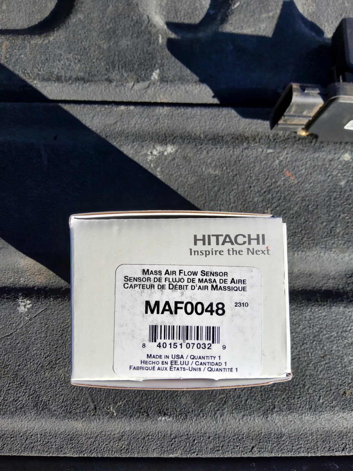

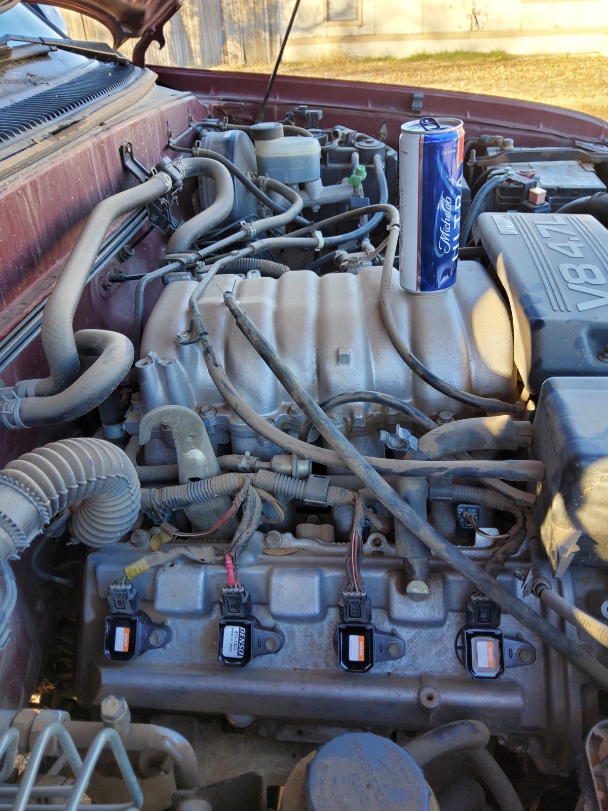

    Changed out all the coils and put an OEM MAF in(rip PHM). Not too bad. About a 2 beer job. I heard you weirdos like pics so here you go...

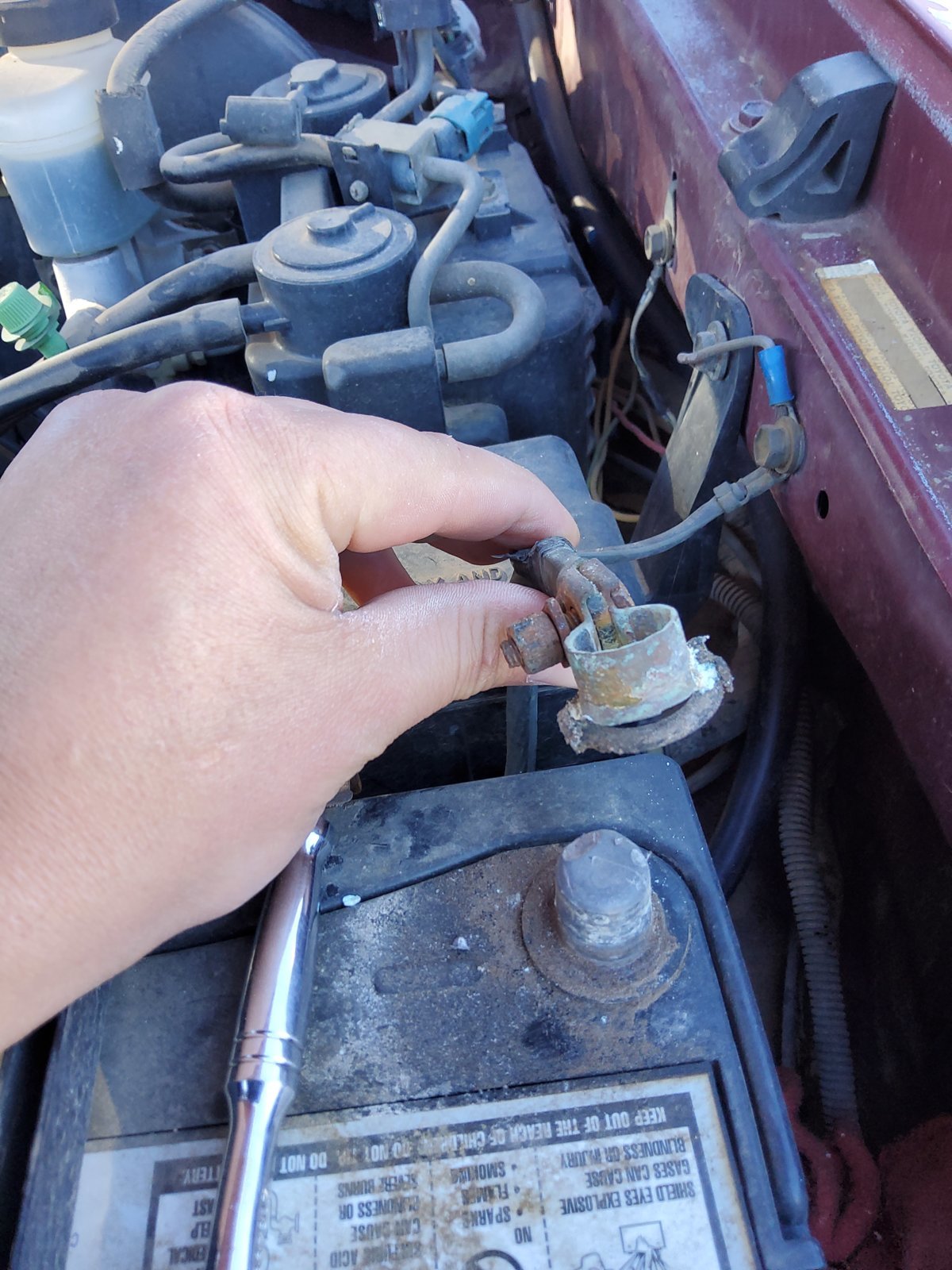

    I think I need a new ground ring...
    New OEM MAF
    New coils.
    Looks like I have a bit of a leak. Ehh.

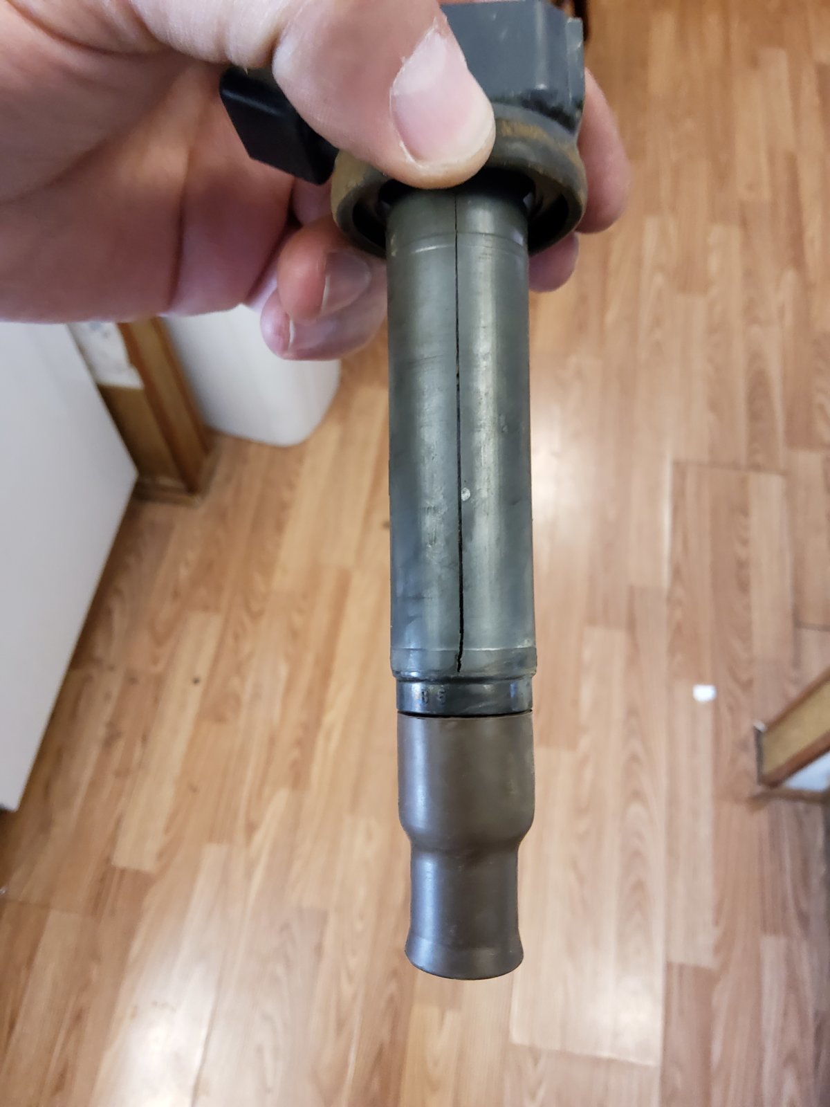

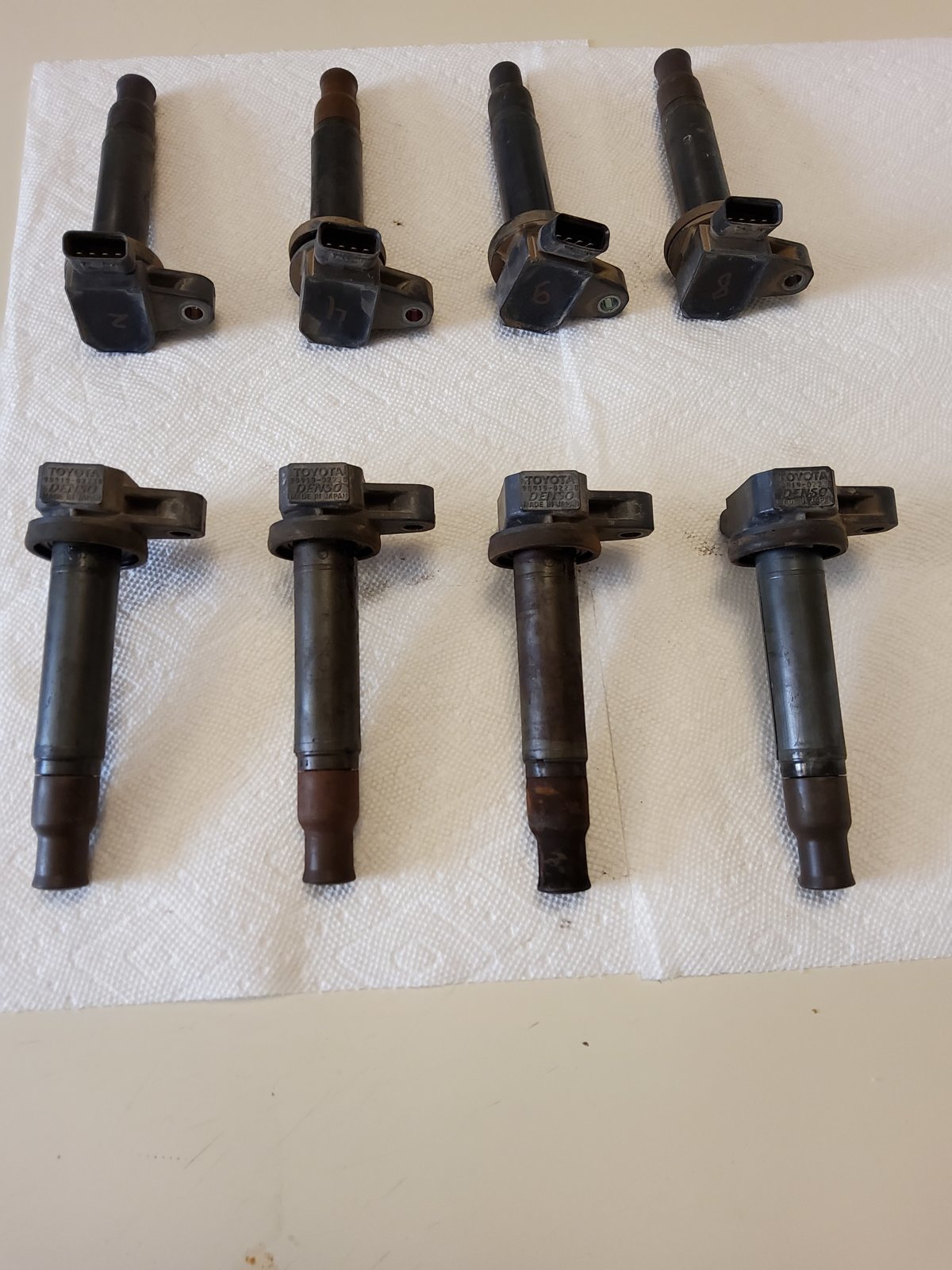

    After I got the coils in I noticed one was different. So I checked the boxes. I have 3 that are different.

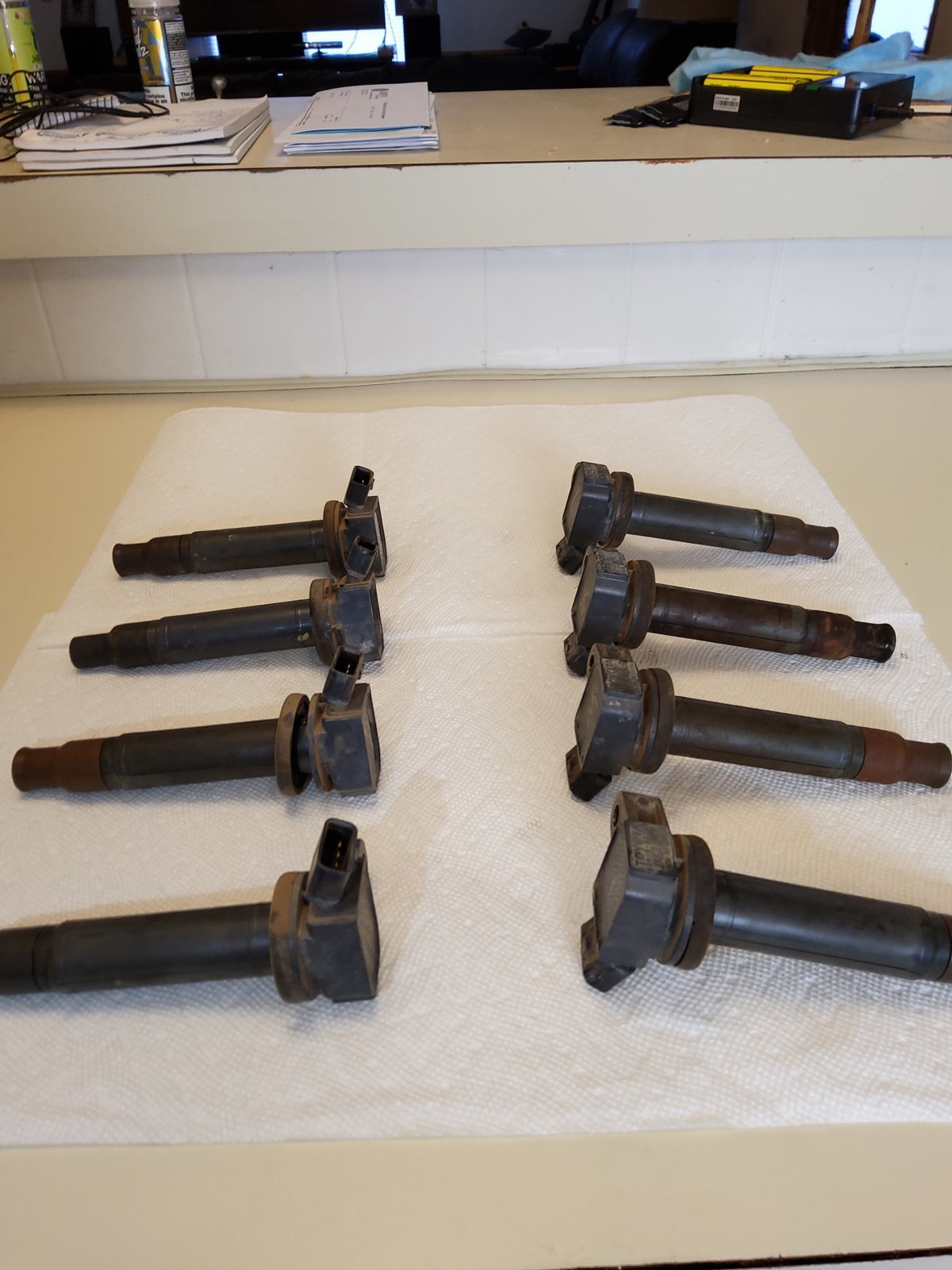

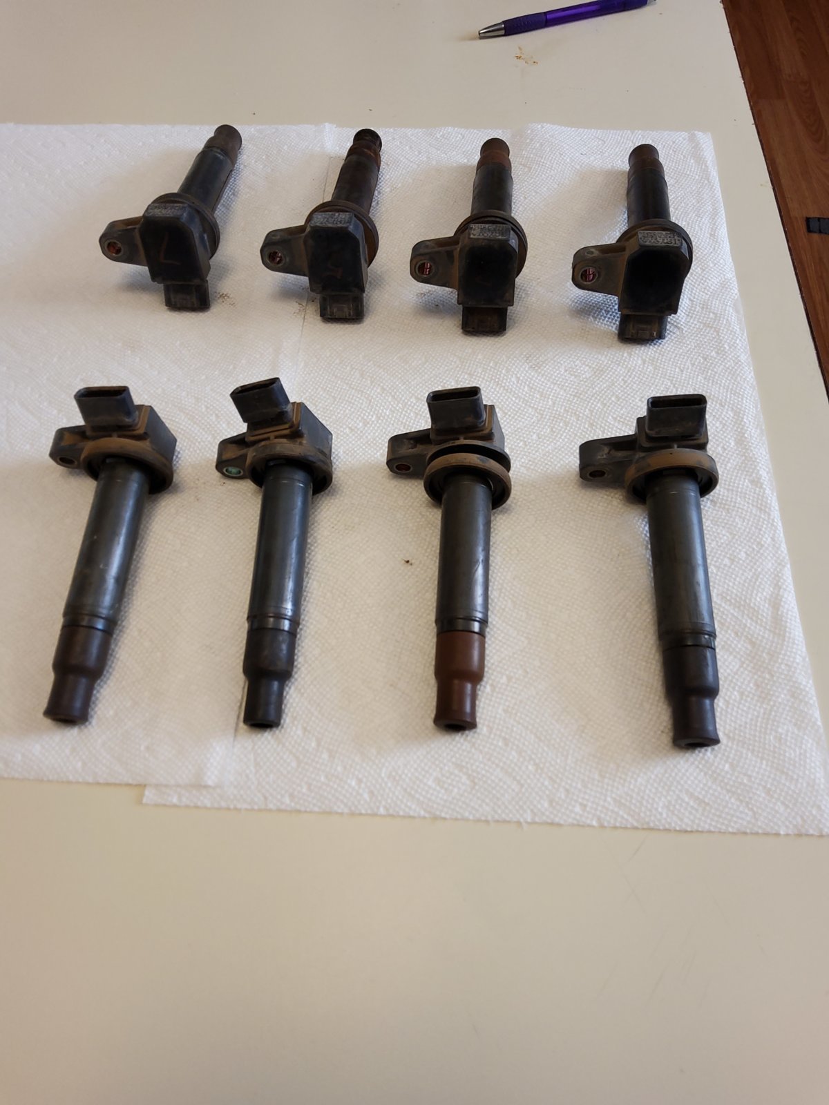

    You can see where I sharpied the cylinder numbers from my VC job. Kinda neat it lasted almost 5 years.
    Passenger side done. This is when I noticed the different coil.
    Drivers side done.
    The old coils.
    Drivers side.
    Pass side.
    The biggest crack of the group. #7 cylinder.
    I thought about it....
    The pics of the coils don't really do it justice. All but one of the coils is cracked, and it's because it was replaced in 2014 the 1st time I had the truck. The drivers side coils are also way more cooked, lending credence to @shifty` theory the drivers side head runs hotter. Which I'm sure we've proven before, just adding to the pile.
    After I fired it up, it shot up to 2k, came down to 1k, then went down and almost died. Shot up to 2k, and repeated that 2 more times. Shook like a mf'er, smelled like gas, and was generally not ok. I gave it a minute and cleaned up my tools and took out the trash. Gave it about 10 minutes and took it around the block. The block is about a 2 mile drive around the highway. 60 mph tops.
    My 1-2 and 2-3 shift hesitation are gone. Butt dyno says it feels ever so slightly stronger, but more than likely a placebo. Pulled in front of the house and left it in drive and it shook just a tad. Put it in park and it kinda hunted around for idle a bit, and smelled of gas. It smoothed out enough that I could feel a shudder every second or so. Not rhythmic, random. The "big block at idle" feel is gone, but not sure if that's the MAF or coils. I still have more to do. A lot more.

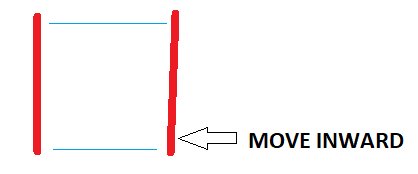

    Think of the vertical channels (inside the door) as perpendicular slides, the window riding up and down in between them. His logic was, basically, if the window wasn't fitting loosely between the channels, this problem would be solved. So for the vertical channel below the rear view mirror, he re-drilled into the door at its lower mount point in a way that reduced the distance between the lower section of the rails. Effectively making the channels/rails "grab" the window tighter, going from this:
    To this:
    I've got issues with drilling into stock sheetmetal like this. There HAS to be a better way that's not invasive, and won't exacerbate rust.

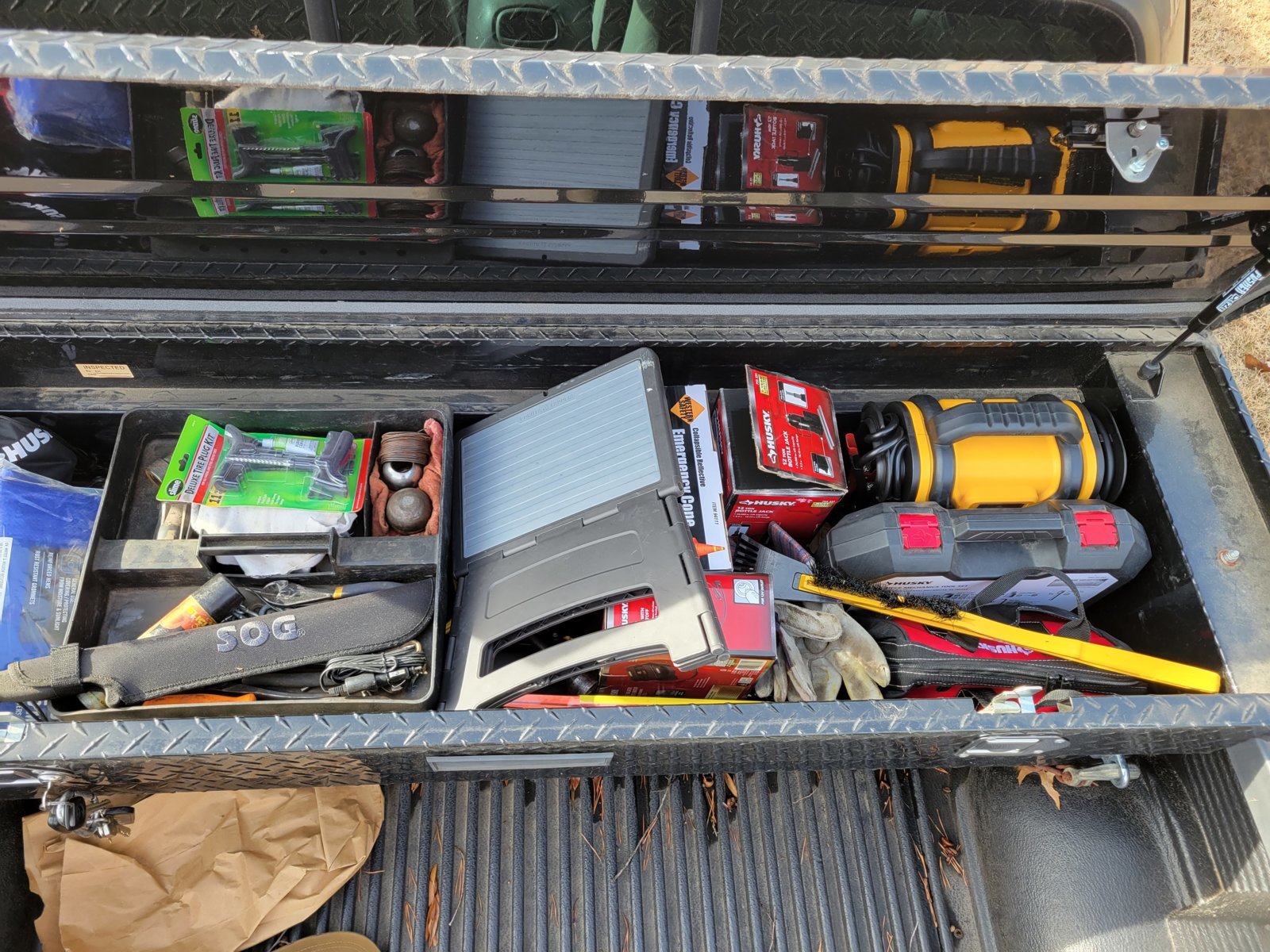

    Today, I de-cluttered and organized my toolbox. It was a total mess before.
