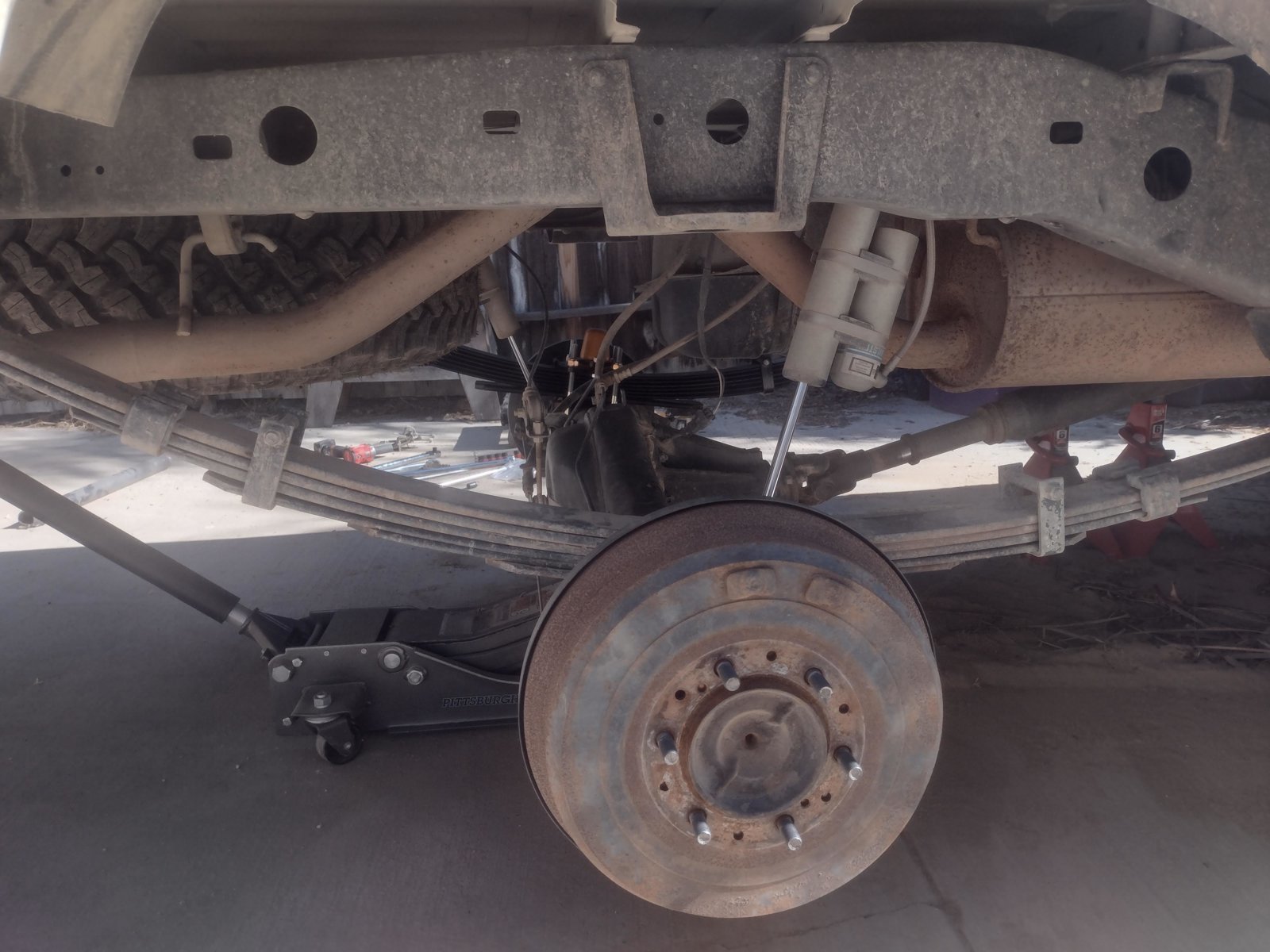

    Yes. It's a game of seesaw where two jacks are ideal. Floor jack under the diff. Bottle jack from the truck to assist along the way. With a lifted pack you will almost assuredly need to unbolt the lower shock mount. I know I did.

    Oh, and when I say 'see saw' game ... Doing one at a time, I felt like it was see saw, where the diff was the pivot point. Not really, but it visually looked like it.
    If memory serves ....
    Actually memory failed me, because I remember I wrote this day-of work and it explains exactly how I did it solo, pretty easily : https://www.tundras.com/threads/wha...-gen-tundra-today.2558/page-1707#post-3334239
    When you finish DO NOT forget, you'll likely be putting more strain on your upper shock bushings. I needed to spin mine down half a dozen threads, they were shrooming hard. Don't forget to tighten u-bolts down equally in criss-cross.
    Sorry if preaching to the choir on this. Figure if nothing else, someone may read it and it'll help. I remember getting that shackle reattached (edit: to the frame) was a bitch until I figured out how to leverage the bottle jack (pun intended). And the front driver pack mount sucks due to gas tank.

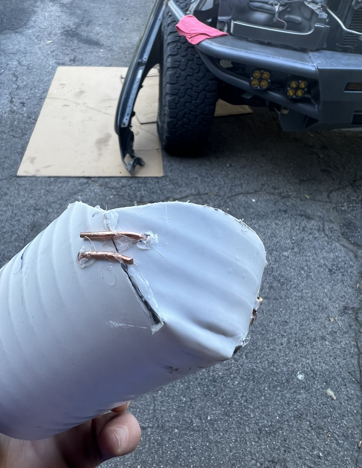

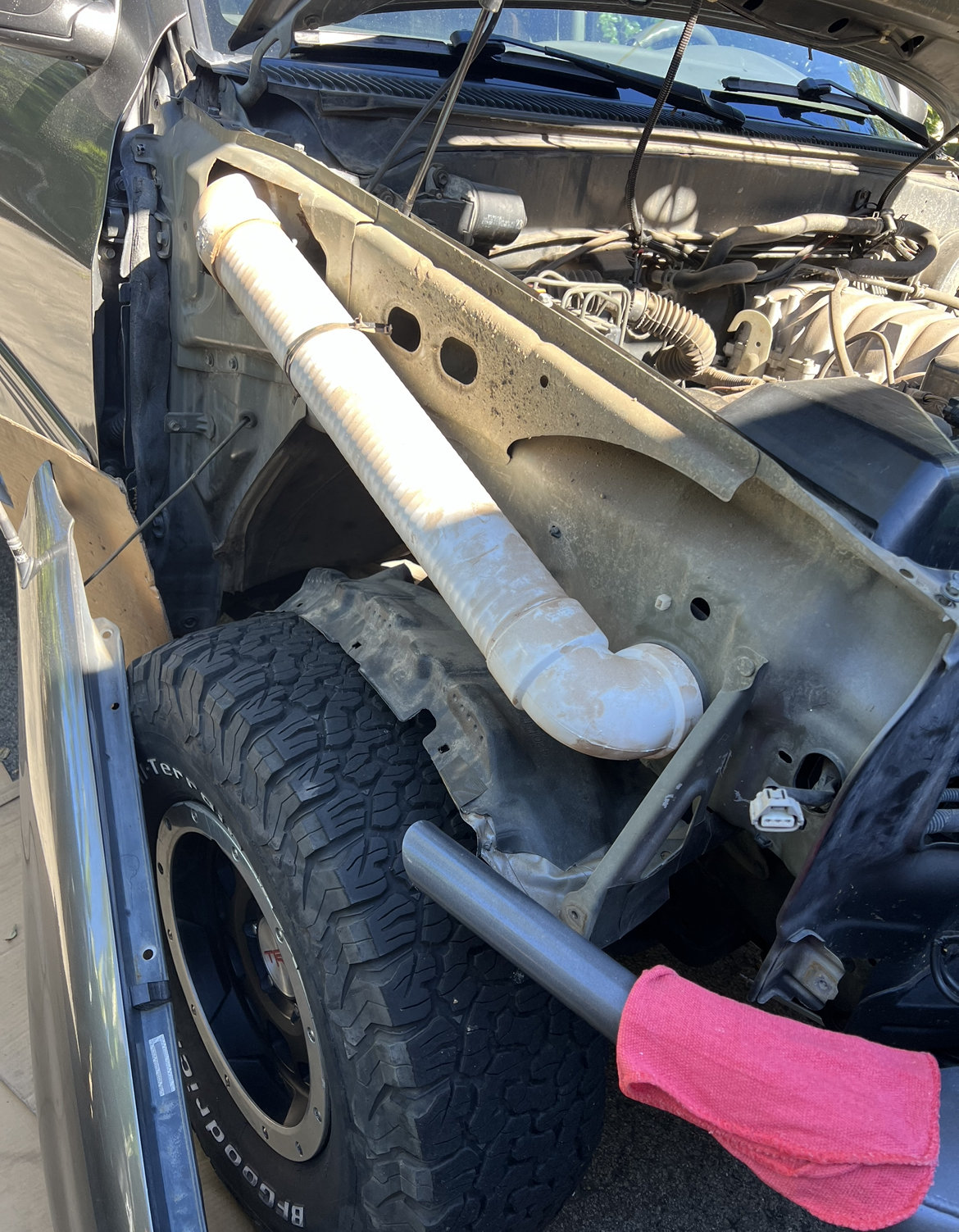

    Today I’m making a modification to the hidden snorkel. Mr Mo Tundy, who once hooked 4 trout on a single cast reminded me our trucks defi physics when driving through puddles. Somehow ends with a waterfall on the windshield which got me worried since it draws air in the cowl space. 05992D71-5C5A-4E65-AD72-150FDF61267F.jpg

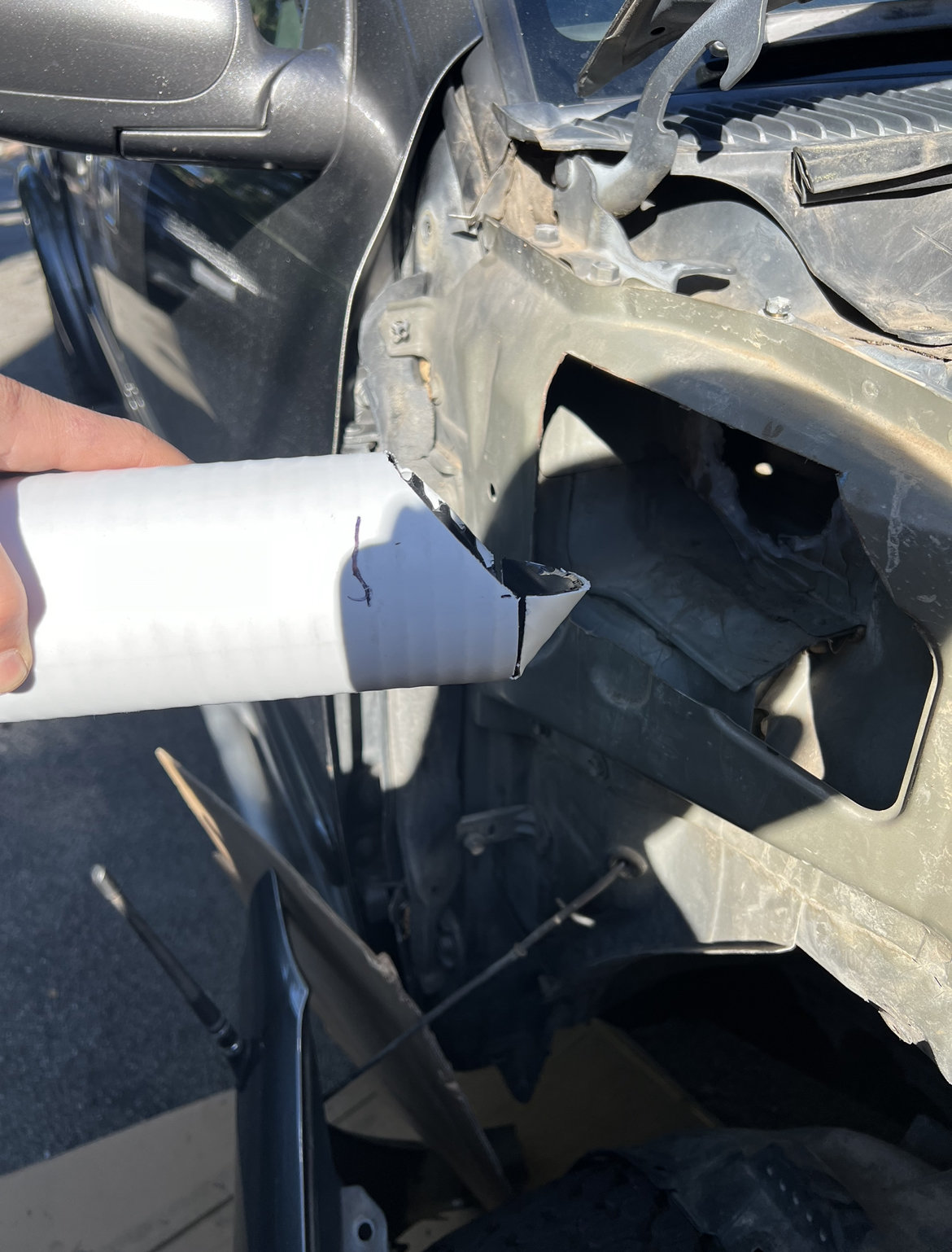

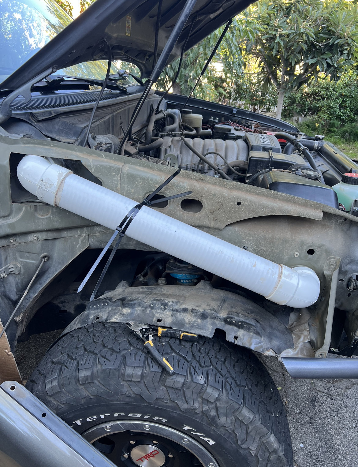

    Took a few tries but feeling like this is the final portion of the hidden snorkel in the cowl. 1583428B-504B-4B77-8134-A643610724D4.jpgGives me an extra 1 3/8” higher intake while keeping the 3” opening and is well above a few places water can drain even if I get massive gush into cowl. CE71146A-6299-46DF-9118-572EF0E5C31A.jpg
    Sewn together with copper wire and hot glued the seams. 1C711546-BBB7-4B69-A2E4-EF04832665EF.jpg
    and she’s back in with enough time to finish b4 dinner. AF46283C-2ECD-437F-98E6-888C0793342B.jpg
    Happy Thanksgiving all. Appreciate all the help I got here when I started working on my truck. Good peoples

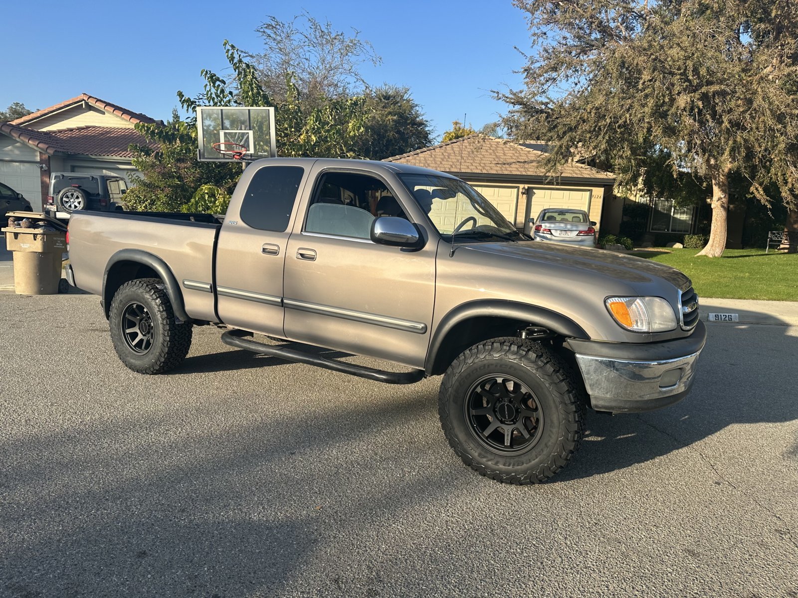

    During. My 20 year old son learning how to wrench on his truck.
    Aftermath. All new OEM LCA, Ball Joint, Cam Sleves and bolts. Bilstein 5100, Freedom Off Road UCA, new inner outer tie rods, steering rack bushings, extended sway bar end links, new carrier bearing, 1” block in the back.
    Done!! 285/70/17 on Vision Flow. 9” wide , -12 offset.
    456AFD5F-2030-49A3-A016-2CE5EE745B9D.jpg AD993E7E-550C-4CC2-8DF0-0348D830095E.jpg

    Nice! That's practically a 34" tire. I don't see to many people running those

    Oops sorry 285/70/17 not 75.
    Josh at First Gen Off-road was a load of help planning out the setup.

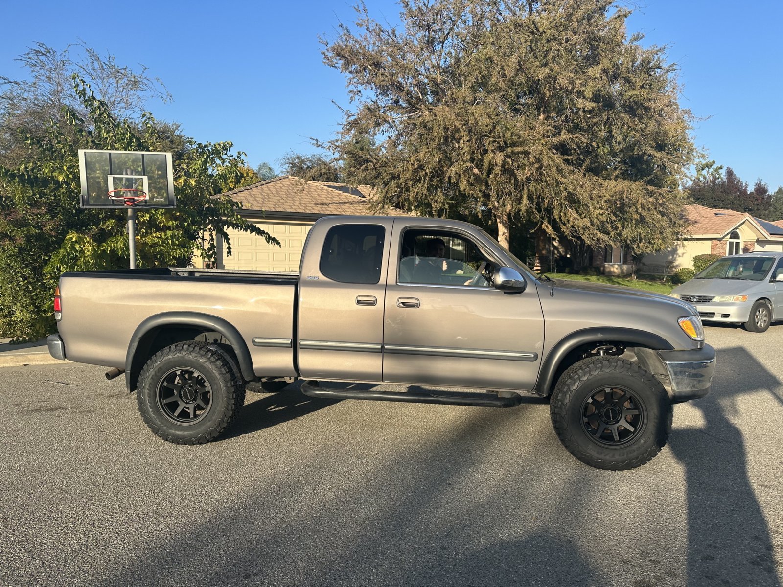

    Got the Archive garage springs installed today. Wasnt too bad by myself actually, but removing the lower shock bolt helped a lot with lifting the new springs in place.
    Ill have to double check my measurements, but it looks like I got atleast a 1 1/2" lift with these springs. Thats compared to the originals with a Wheelers AAL. So it almost looks like I have a bit of rake now, but hard to tell in my driveway. Ill have to take it for a drive and get a better view of it from the side when i can.
    But so far it looks pretty good and im glad I didnt go with the HD springs and get even more lift and rake. Time will tell as they probably will settle a bit too.
    Happy Thanksgiving guys!
    EDIT: Also got the U Bolt flip kit installed as well. Cant wait to go camping now and see how this rear suspension feels!
