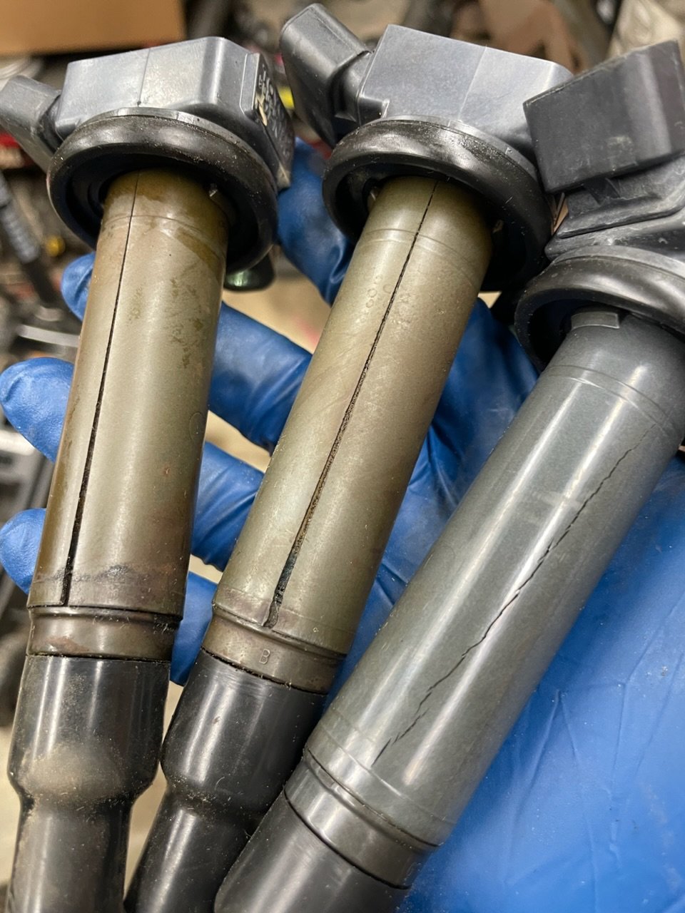

    Long story short(ish). Radiator blew up on the highway. Pretty sure I shut her off before she over heated. Had it towed home. No water in oil, no oil in coolant (that was left), and no white smoke out of exhaust.
    Pressure washed engine, installed a new Denso Radiator. Fired her up. Noticed she wasn’t very smooth running, but figured I was being over sensitive. Put a thousand miles on her over the next week or so, still was thinking she wasn’t as smooth. Weather changes, mornings get cold (Ca cold low 40’s, and out of the blue, major misfiring one morning. Felt like I was driving over solid cement bags on the highway.
    Still got me to my office and home about 200miles, and I noticed once she warmed up she ran ok, definitely still missing but not violently.
    In my head I knew what it was. 100k ago I changed plugs and noticed the coil packs were puffed and cracked. I figured it wasn’t missing, so I ran them. I also noticed at the time the tube seals were leaking. (Future project, already had all new OEM parts to do valve cover gaskets etc.) I assumed when I pressure washed, I got water in the spark plug tubes, and the coils were shorting out. I was right, but the truck didn’t throw a check engine light till I almost got home 200 miles later.
    Plan was to do Valve Covers, PCV valve, Plugs, and Coil Packs.
    Nice to see they cleanly machine “Toyota” off the Rock Auto Denso Coils.
    Old Coils, the rest of the 8 look like the one on the right.
    Air filter with about 100k on it. I live off dusty roads, and drive to remote work sites on miles of gravel wash board roads. I probably should change more often.
    While I was at it, I had to VC’s powder coated a deep metallic orange.
    Truck is running better than ever, but now I’m fighting some engine codes that don’t seem to going away even after I cleared them.
    P0308 Misfire #8
    P0117 Coolant sensor 1 circuit low
    C1201 Something about the ECM shutting down the BCM
    So that’s fun lol

    Meanwhole on the codes ... that is weird. I could see the first two codes being tied to bad ground or something, but when you add in the 3rd, I almost wonder if the arcing/short from the coil packs may've backfed to the ECM? Or it could just be highlighting the other two codes as part of the problem, as that can be.
    This is a whopper where the only guy whose input I'd trust is @empty_lord or @BubbaW
    For shits n giggles, I'd swap coil packs #6 and #8, and check the plug for cylinder #8 while in there. See if the misfire jumps and throws P0306. Although ... did you unplug/replug the coolant temp sensors just to verify it's not a loose connection? The proximity to valve covers is ... curious.

    i cant remember off the top of my head. but are there any grounds going to the valve covers? the powder coating may be the problem.
    if not.. just check for loose grounds arounf where you looked.

    I thought that, and I looked back through my before pics, and didn’t see any.
    I’m hoping it clears it self out.
    I’m upset I didn’t check the codes before I started.
