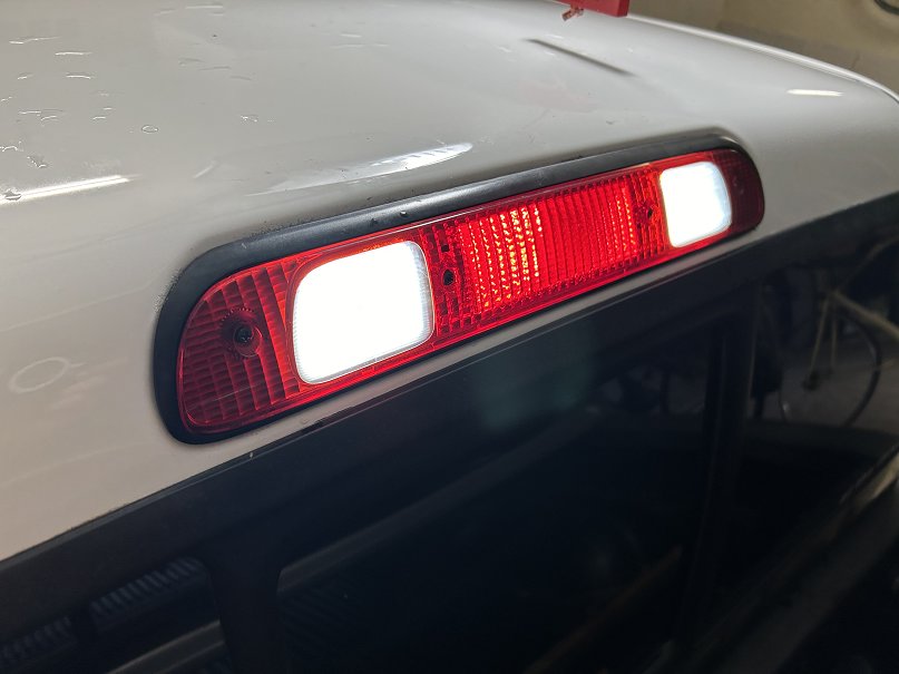

    Meanwhile, what I got done today. Switched rear brake lights to LED, cleaned the shell, its windows (again), tested electrical, and try to dig in and assess what it needs.
    Rundown...

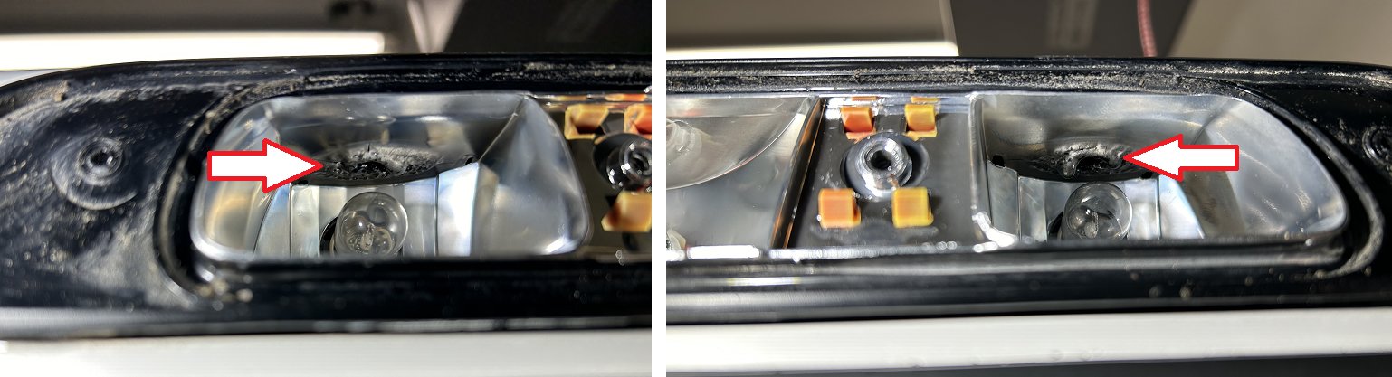

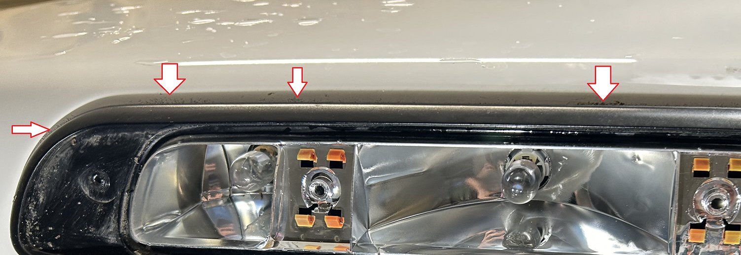

    First off, my '06 wasn't immune. Melted to hell above the bed/cargo light provisions. Above the brake light bulb was fine. How weird.
    Good thing I bought a full replacement housing assembly during a Toyota Parts big sale. I figured I'd need it for the light-to-cab gasket, since you can't buy separate. Passing on that for now.

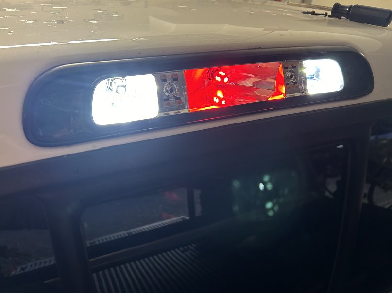

    LEDs installed, testing before button-up. I got all three the correct polarity. Hot damn. Not happy with the brightness of the red bulb, honestly, but the cap is covering it, I mainly did this for heat reduction.
    All buttoned up again....

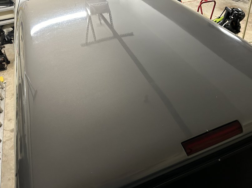

    I notice some of my paint was pitted on there. Meh. I'll probably need to do a little touch-up filler if/when I replace the housing. Anyway, I took the truck out and hit it with that new "Dawn Power Wash" product because it had a thick layer of 'honeydew' (aphid piss) regular water wasn't taking off. Went ahead and hit the entire cap with it, and took a semi-soft jumbo detailing brush to scrub every nook and cranny. Still needs a polish, but at least it's free if aphid waste. If anyone's gonna piss on my truck, I'm the guy, dammit. Too bad the paint is the wrong color, it's in really, really great shape.
    Sadly, I tested the electrical and found the high-mount brake light has a segment of dead LEDs right in the middle of the bar. But it works, so now I need to do a little reading on best way to tap into the brake light circuit to go hot.

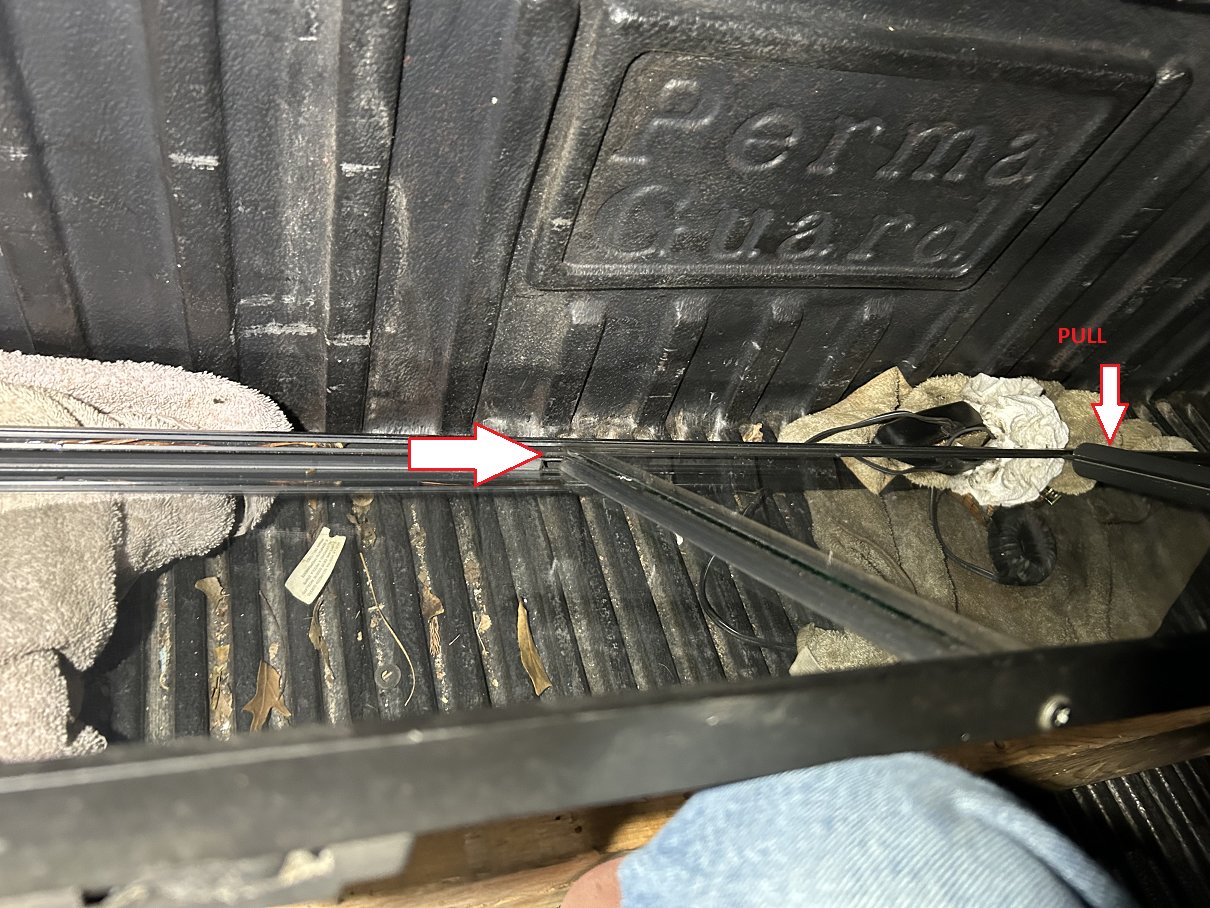

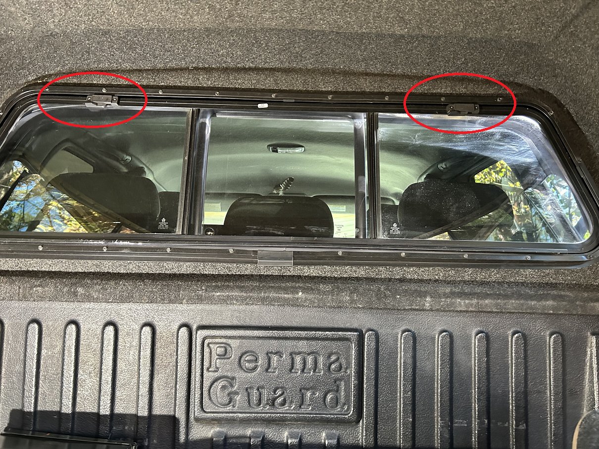

    For cool news on the cap front, I found a nice perk. The cab-side window is removable but was stiff as hell. That's what the latches were for (tag @JasonC. @daveeasa @KNABORES @Mr.bee @des2mtn @NickB_01TRD or whoever else). Like ...here are the latches...
    Then I noticed this at the base, which looked strangely like the hinge they use at the top of the rear cap door.

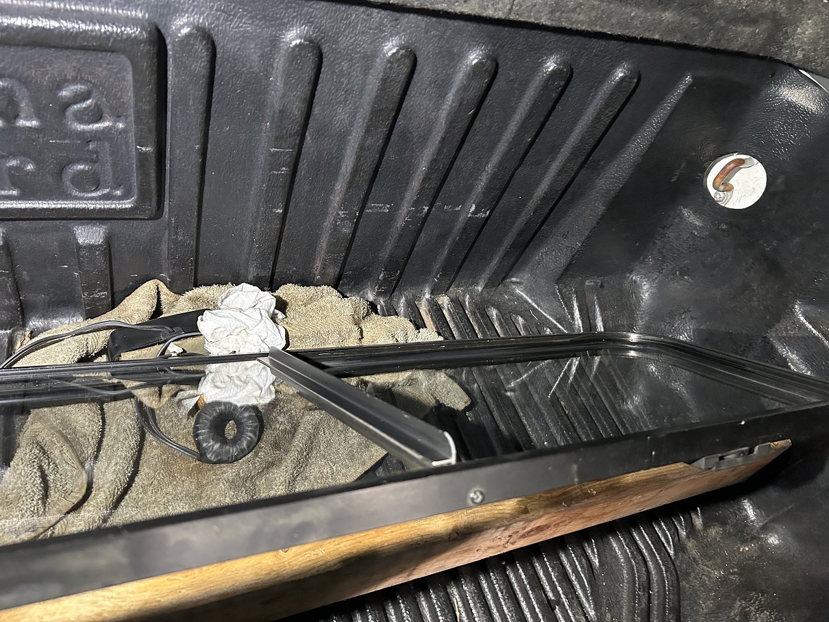

    I was a little concerned because with the latches undone, it felt like there was something still holding it in when I pulled the top edge back more than an inch or two. I think it was just stuck together with gunk, because a little rocking back/forth and ... BOOP ... it flipped forward at the hinge and lifted out.
    Cleaned out the opening really well, then cleaned the glass a little more intently. I'll probably remove it again later so I can really clean up the channels, then try to find some way to lube them that won't collect garbage. Silicone spray, maybe? Dry lube?

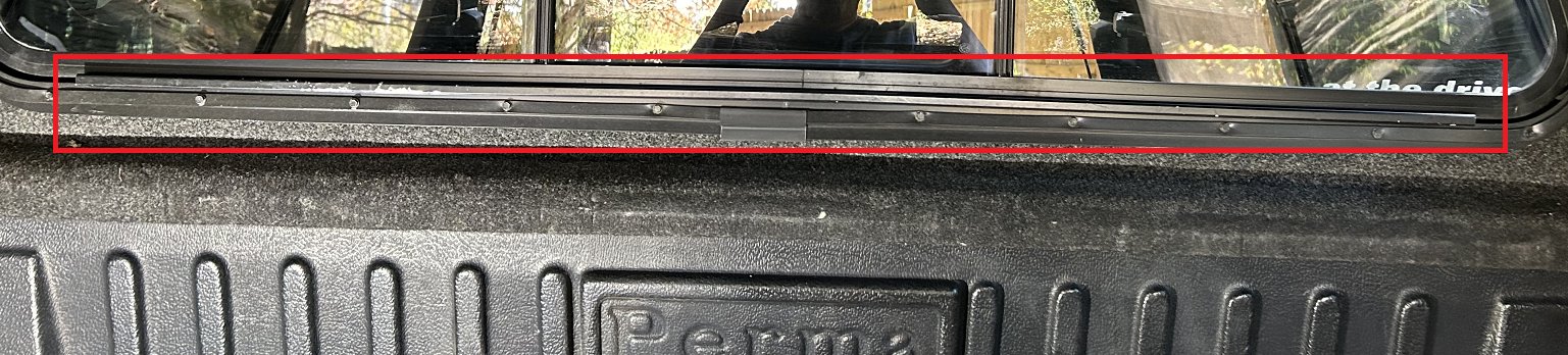

    This was the confusing part I was talking about earlier. The actual slide is on the outside of the shell, so you can slide it open from the cab, I guess? Weird.
    But yeah, the glass is pretty much outside the left/right panes, faviring the cab. Here's a pic of the pull and how far out the window is. I really need to clean that slide. I'm shocked they didn't use felts on this cap, but ... maybe that makes waterproofing difficult.

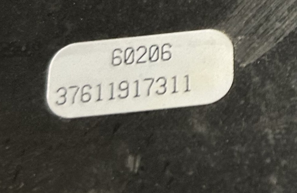

    Here's the sticker with maybe the part numbers from the pop-out cabside window:
    And the rear window sticker:

    Yeah I’m glad I did the entire 3rd housing replacement, my gasket was more toasted than me!

    I'm still pissed about this paint swiss-cheesing though... lots of little pinholes. Really deep ones over on the left. Terrible spot for it too.
