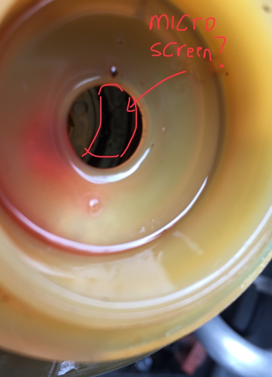

    Today is clean out the Power Steering Reservior Day. Based on yesterdays observation, I believe there is a micro screen at the bottom of the cup located near the side near the smaller hose port. Here is a pic from yesterday.

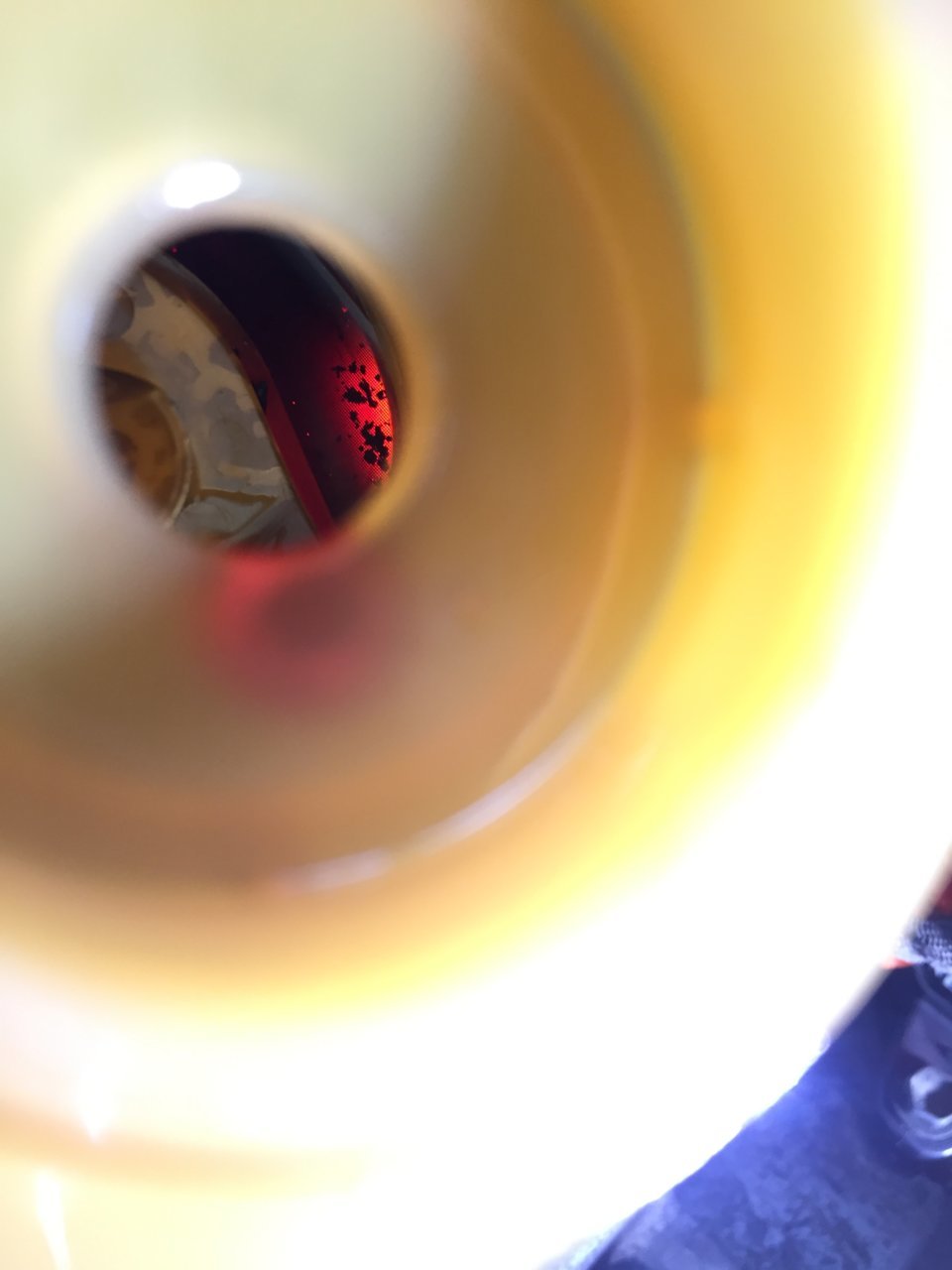

    Confirmed micro screen in PS reservoir by draining and shining a light from underneath. Did two more flushes to rid the cack chunks. They feel hard but when easily smashed almost look like tiny mud balls inside. A light brown color inside. Dark on the outside.

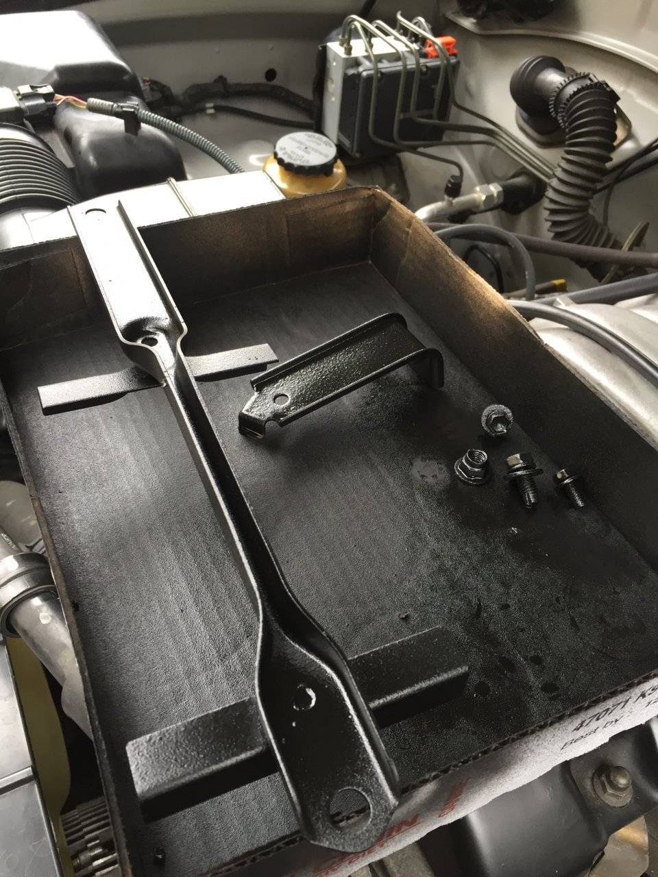

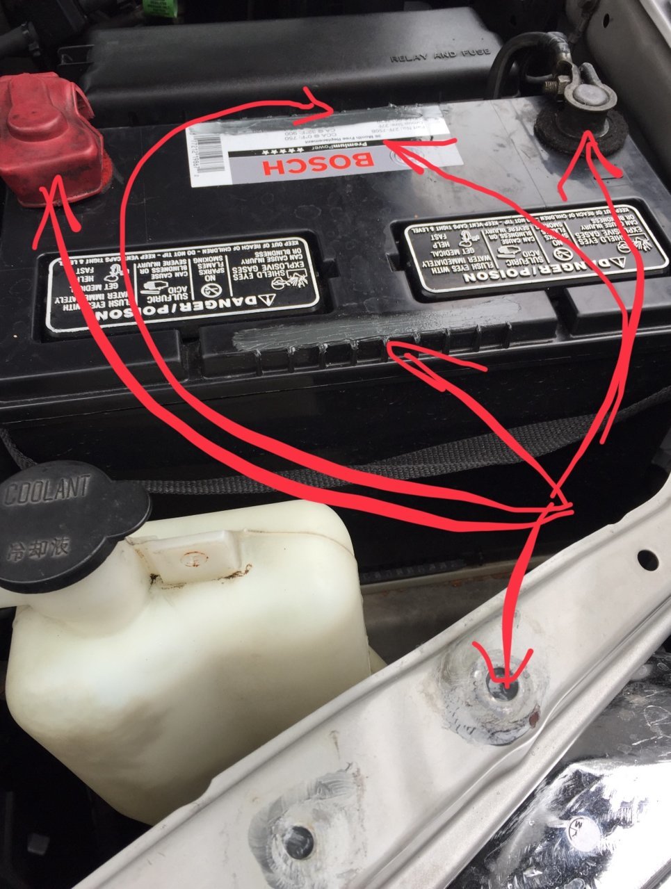

    Painted up the battery hold down bracket and slathered some electric silicone on all the mount points.
    Cleaned the MAF Sensor.

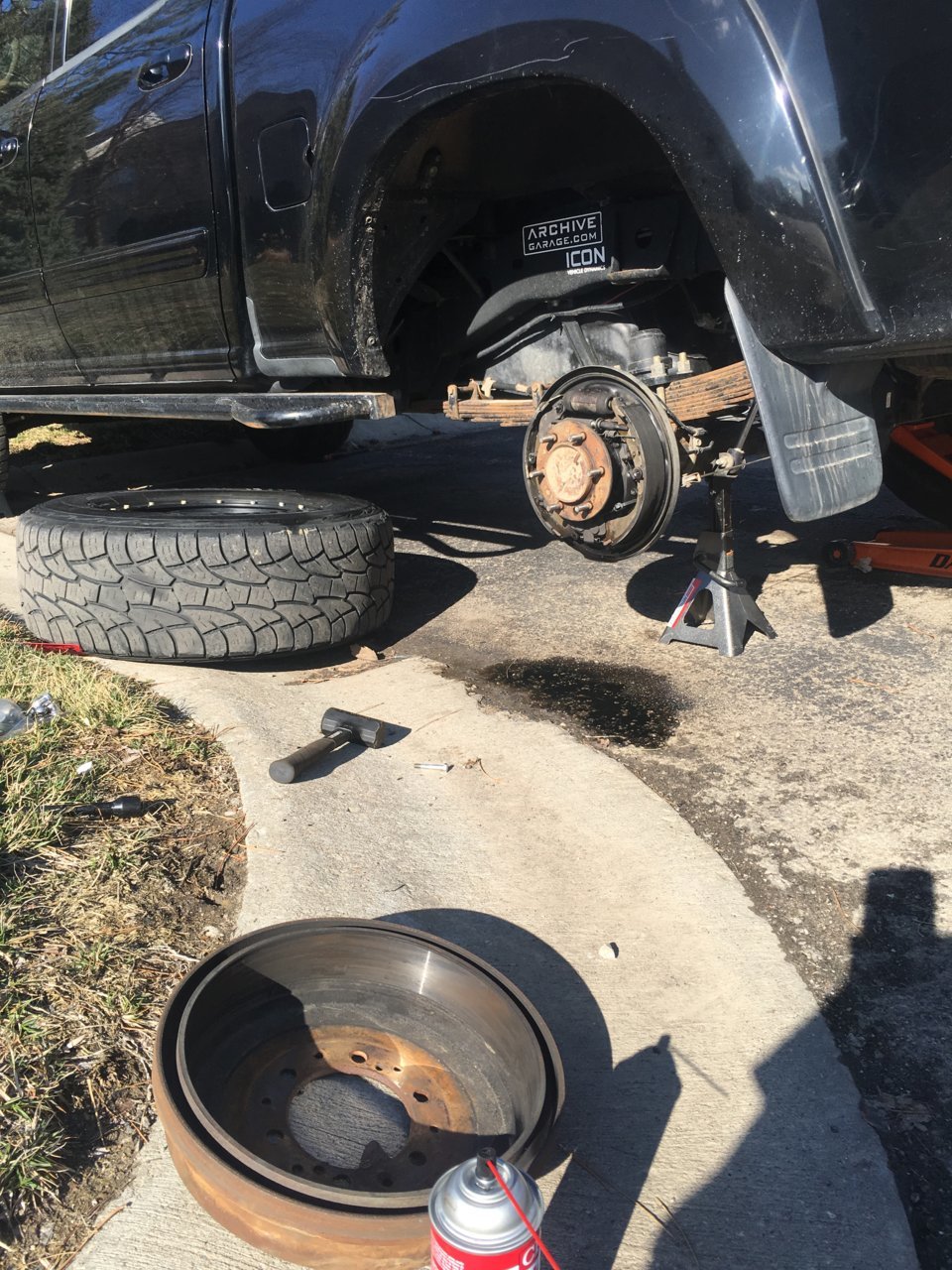

    Yesterday was adjusting the drums. Been two years since everything was replaced so just a quick adjustment to tighten the pads up was needed.
    Today was a new alignment. Had a nice talk with the tech. Told him I wanted as much caster as he could get. And everything else around half a degree.
    He got 2.5 caster. He said that was the max he was getting.
    Much better than before. No more rubbing on the frame at full lock and more room near the firewall.
    I’ll have to compare it now V.S. before...

    Where do you adjust these drums shoes? The dial notch thing? Cleaned mine the other day and the drum tolerance fitment was pretty tight on the put back. The shoes seemed as close to the drum as possible without touching.
