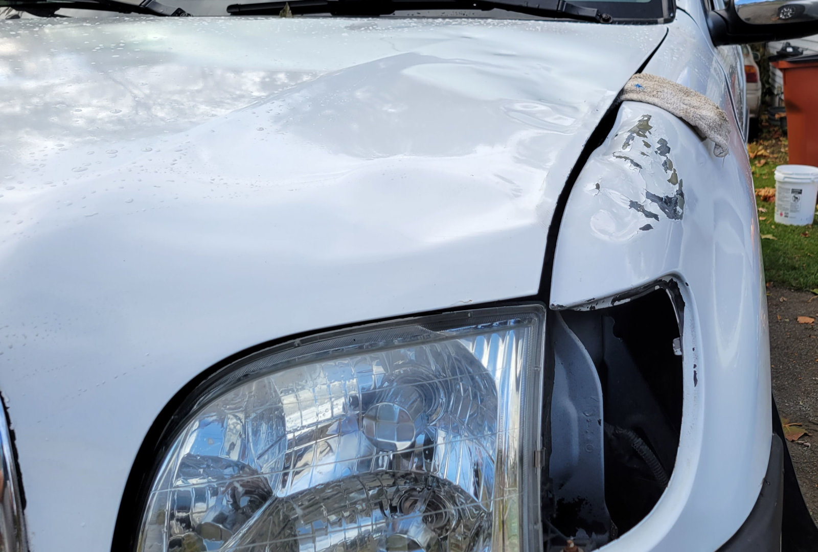

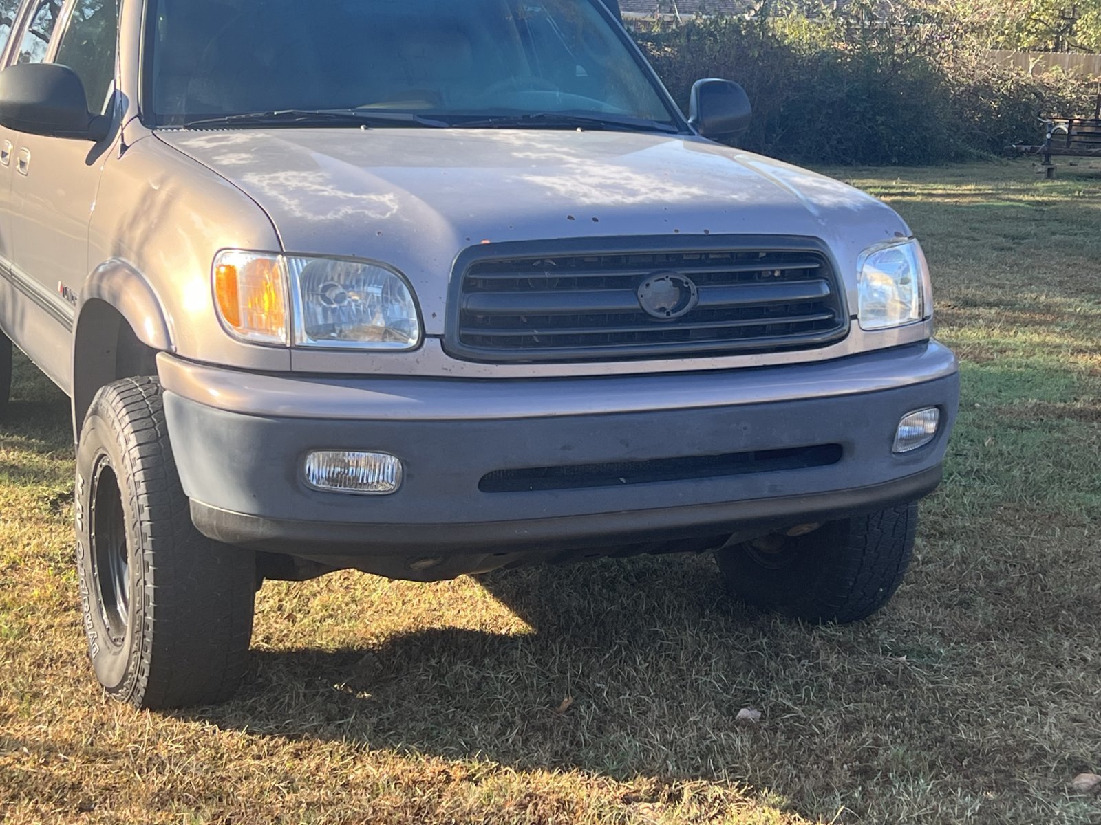

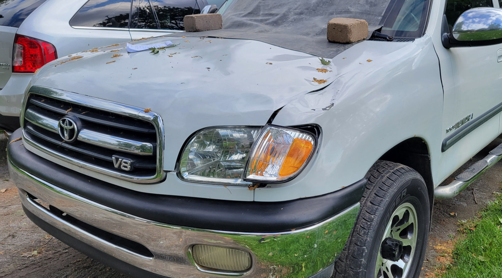

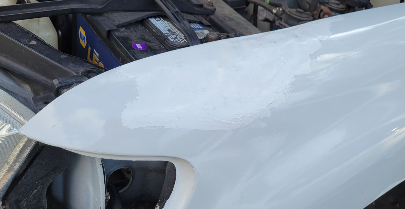

    Spent a couple hours bashing out the damage from August's storm, pretty sure it's a permanent fix. Unfortunately she just isn't worth getting a new hood and fender.
    Good enuff to protect the metal here in MI. Still love this Jalopy. If things go to plan she will be the plow/farm work truck when we move to our rural/acreage, and there will be a decent FGT in the garage.

    For a minute I thought those were perfect reflections of clouds in your hood.... and not failed clear coat :eek::D

    Bro, this was mine before sanding and paint. Age is a bitch

    Yeah I saw the roll on you did... and it's been looking better :thumbsup: like you sanded/buffed it out?
    I used Rustolium oil based satin and a brush... and a heat gun, it was maybe 50 out.

    You mean another new hood and fender? That's already a new hood and fender. Unfortunately, whoever shot it decided to throw 2-stage paint on a single stage painted truck and it sticks out like a sore thumb at the angles you shot.
    I've seen a couple of parts trucks around here with the right OEM white parts to get you fixed up! Too bad you're up in the BM! You ever roll down this way?

    Yeah, it's been in a Hard front drivers accident, and it's "OK" now but not good. A Mortal wound to her, at some point Ill show some of the Ugly shit. Maybe tonight i'll dig up some ugly show and tell shit :rofl:.
    The PO didn't match the paint, its Def not natural white 056. We don't travel at all, we've been saving up hard core for Launch day (my retirement), and getting the Fuck out of the outskirts of Babylon.

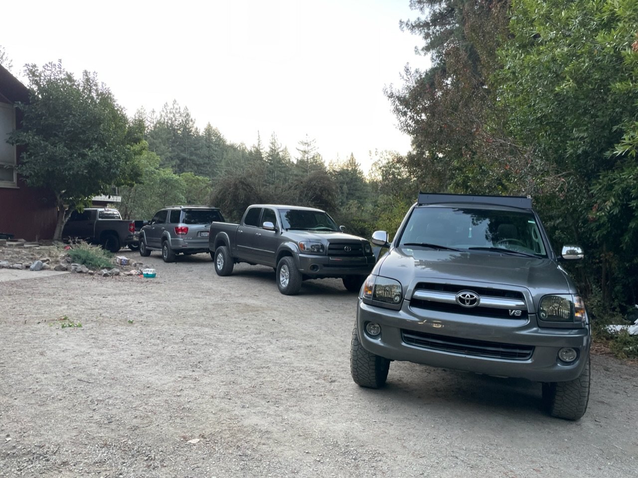

    Spent a few hours on the 1st gens.
    Oil changes and greasing the drive shafts.

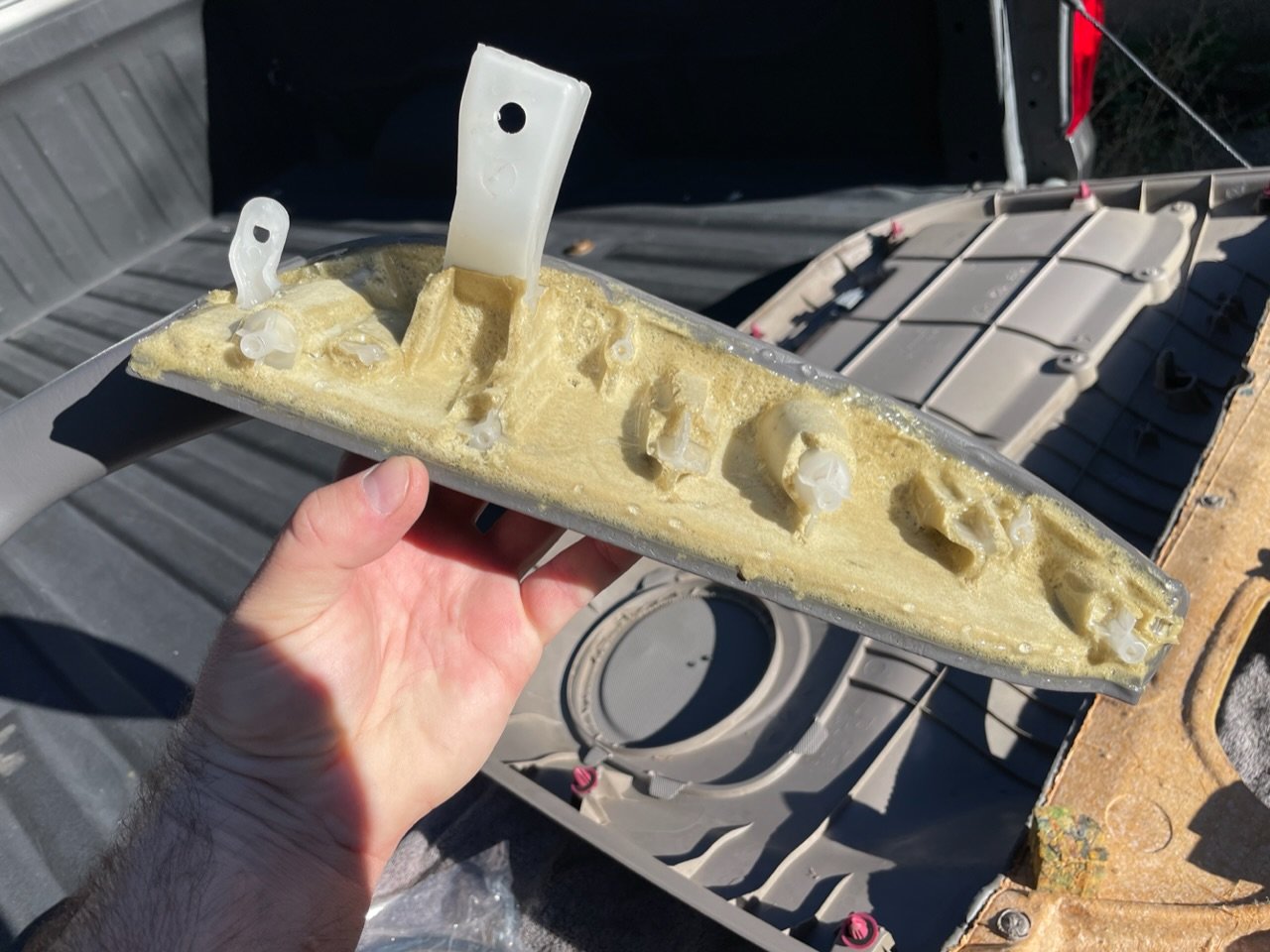

    Fixed the brand new $180 passenger door handle with some Gorilla Glue.

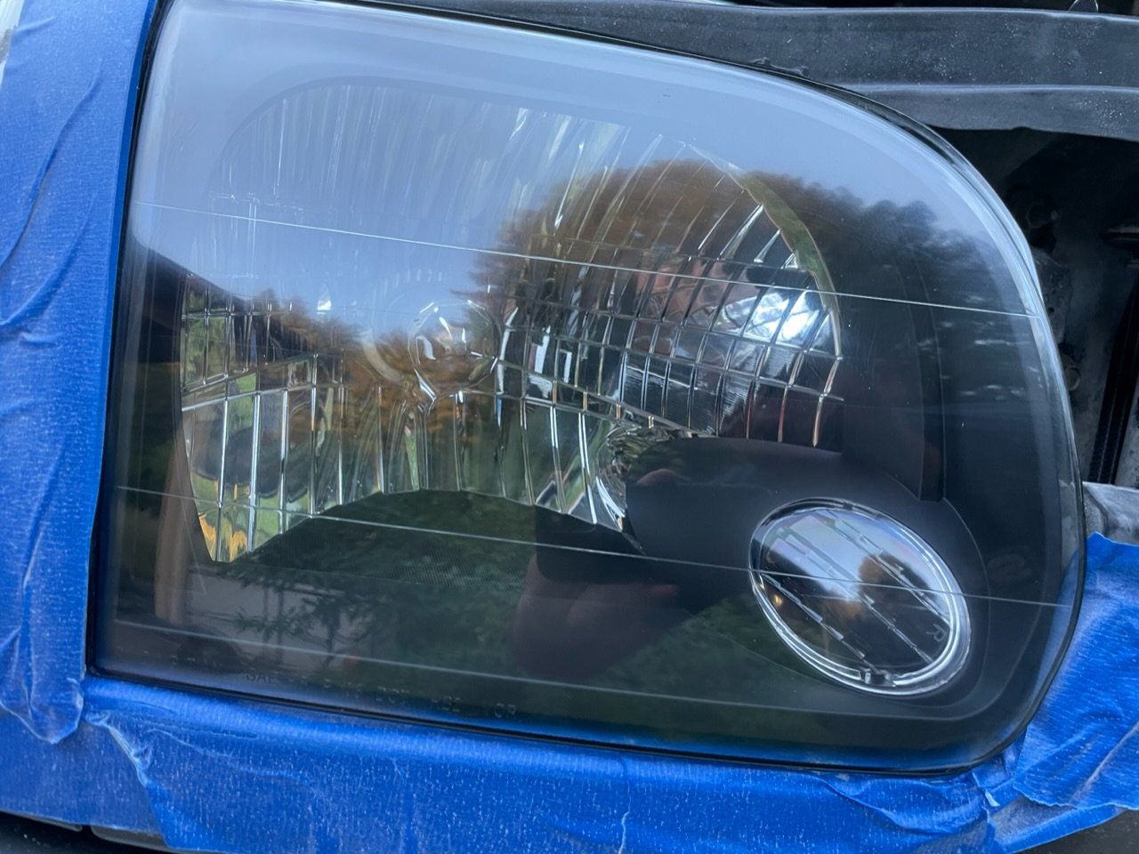

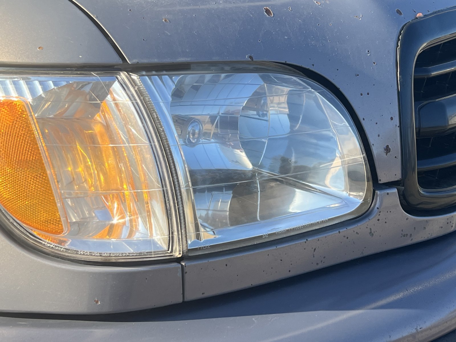

    And sanded and coated my completely roached out eBay special headlights. They came out great. Saved me from having to buy a new set. And only took about 40min start to finish using the 3M headlight restoration kit.
    Not the best pic, but they are clear. No more yellow.

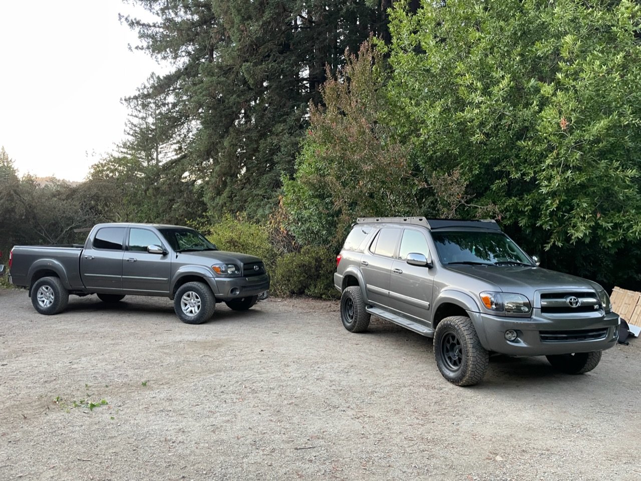

    From right to left. Girlfriends pretty well built 2007 Limited Sequoia 210k. My 06’ SR5 Tundra 333k. My sisters 06’ Limited Sequoia 250k, and my brother in laws 14’ TRD Offroad Tundra, 210k sadly in the middle of a Head Gasket job both banks.

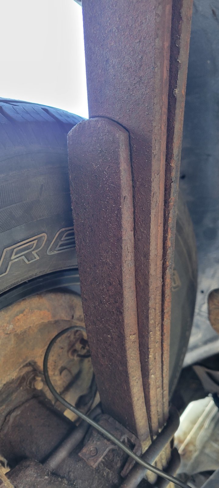

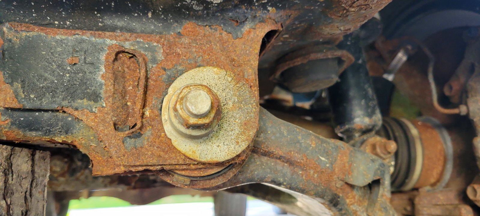

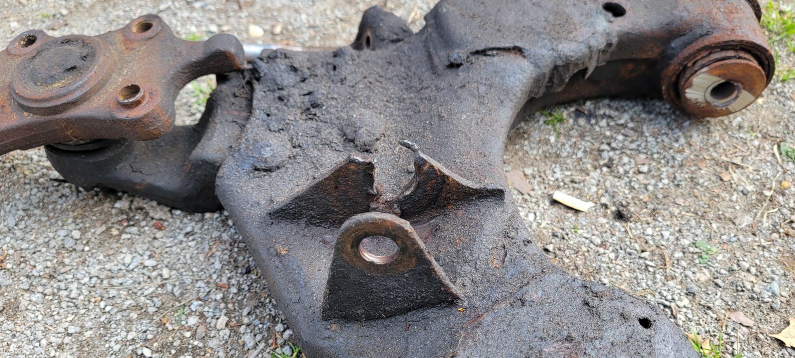

    As far as I can tell there is prob a 1" inflection in the frame where whatever entered the drivers wheel well and SLAMMED into the cab mount. Cab is tweaked. It doesn't dog-track, but you can see its fucked up.
    They left the UCA and LCA but replaced the entire spindle/caliper/rotor... so now I have a 13WL on drivers, and 13WE on passengers... Fuckin bastards. Brake job surprise...
    I'll say from a MI perspective the frame isn't that bad, crusty over most of it, no huge holes. But its not right, and after doing LCAs/LBJ/UBJ/links... Doing driveway caster/camber was interesting... struggled to get positive caster on drivers side.
    I didn't even consider taking it to a shop to have it laughed off the lift/device, but it drives straight, and no crazy tire wear, and it's what I've got for now. I don't do a lot of driving.
    The whole front end has been tampered with.... No condenser, No curved reinforcement under bumper, no skid plate, one horn, it didn't even have fucking fender liners. What you see hanging in the picture is cut from a huge black tree pots, they actually work great, for free.
    I swear this truck is Crackies long lost cousin (still have to make it through all that thread...) This thing put me through 8mo of hell before I got it to stop stalling @ stop lights, NO CODES. Turned out to be the ECM... which looked pristine.
    The rockers were rusting the fk out and I rebuilt them with steel studs from HomeSleepo and a shitload of rust converter, polyurethane caulk and rivets, and self tappers, roofing sealant, and herculiner. They actually did pretty good through the first winter 0 rust.
    Ill dig up some pics.

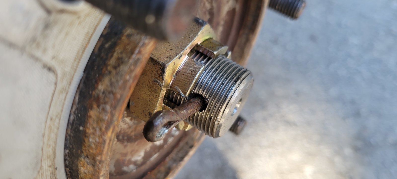

    some other wft moments

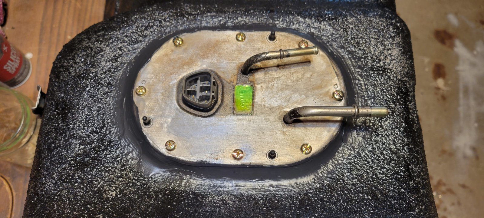

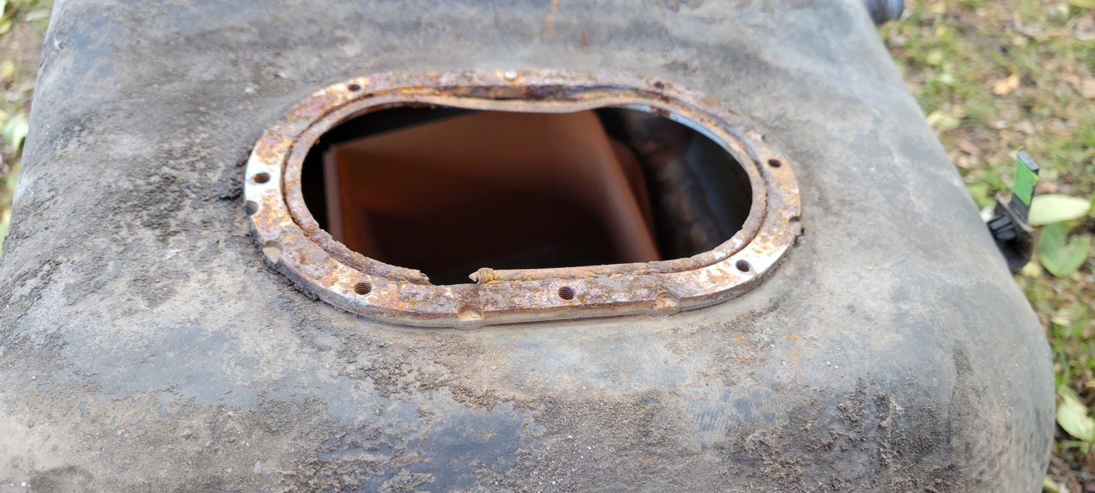

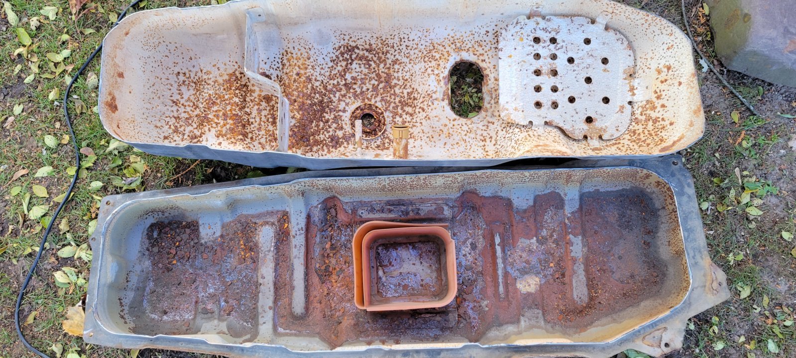

    Fuel tank replacement
    Truck sat for 6+ years after its "accident", Tank got pretty bad.
    Death wheeled it up to dispose of easier, pretty shity in there.
    New tank, Herculined, sealed up. New DENSO pump as well.

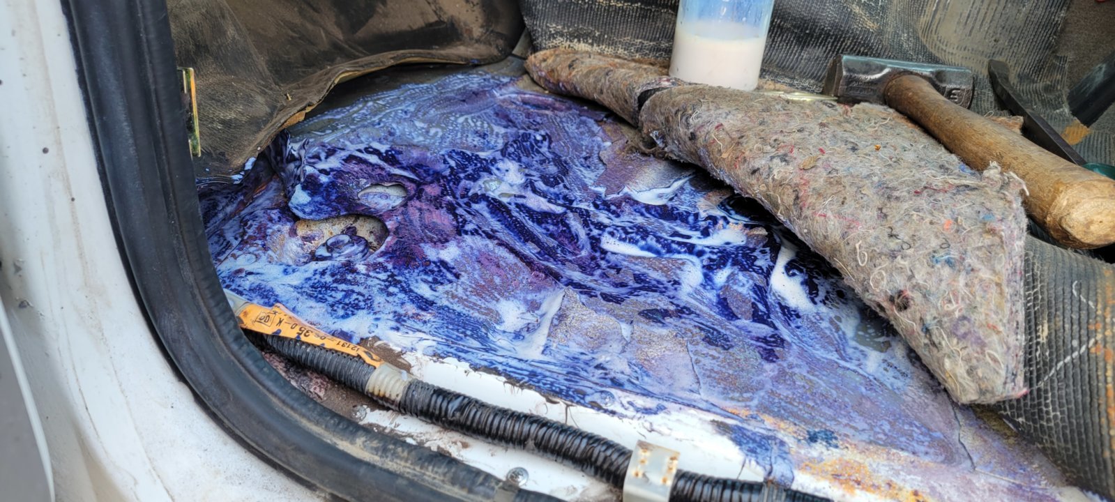

    I did throw a bit of Converter in there under it. There was a big bump in the floor from the accident that I put the Beat-Down on.
    I vented a lot of anger on that thing... I had a few neighbors come out to see wth was going on..20230320_153454.jpg
