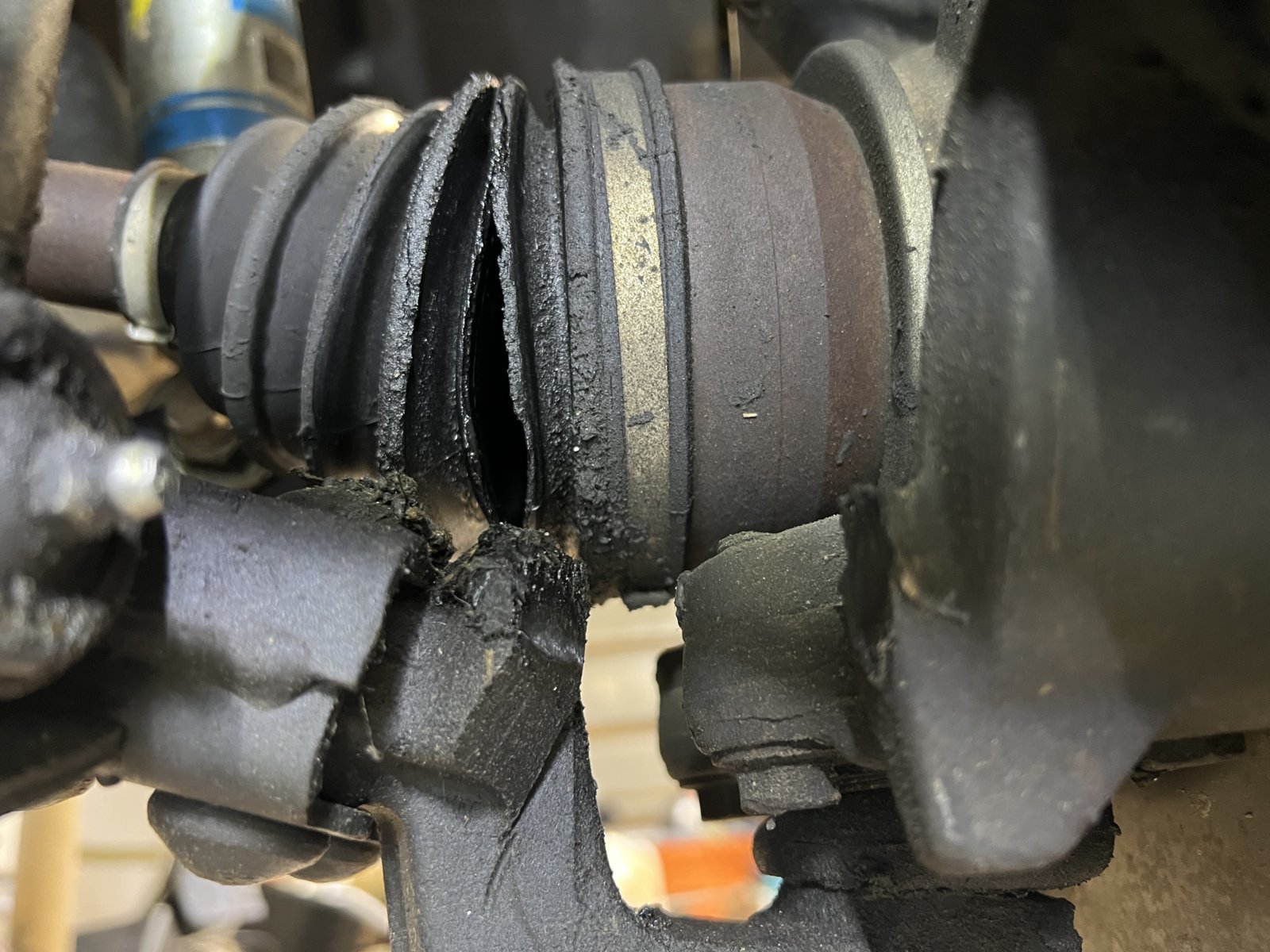

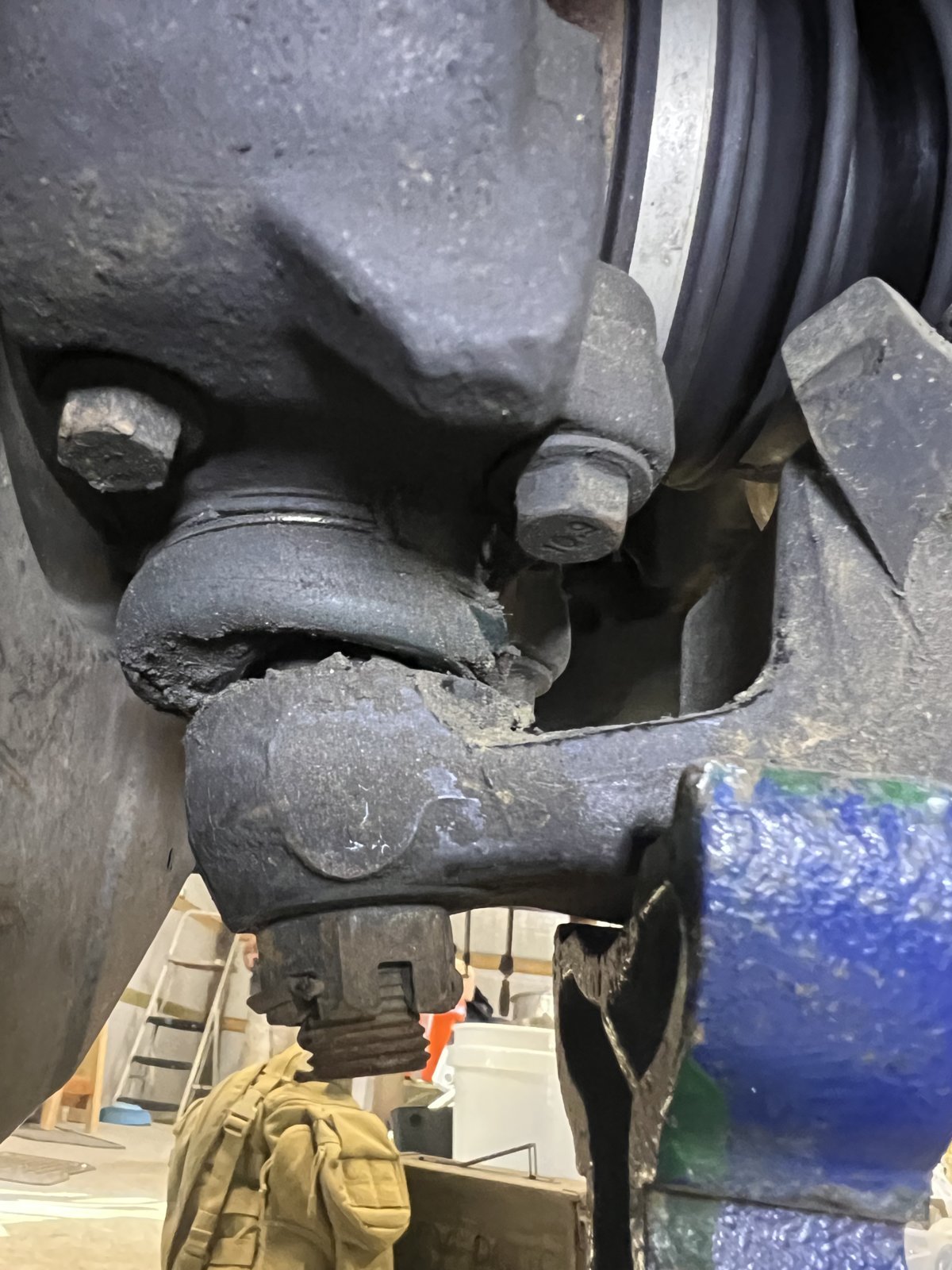

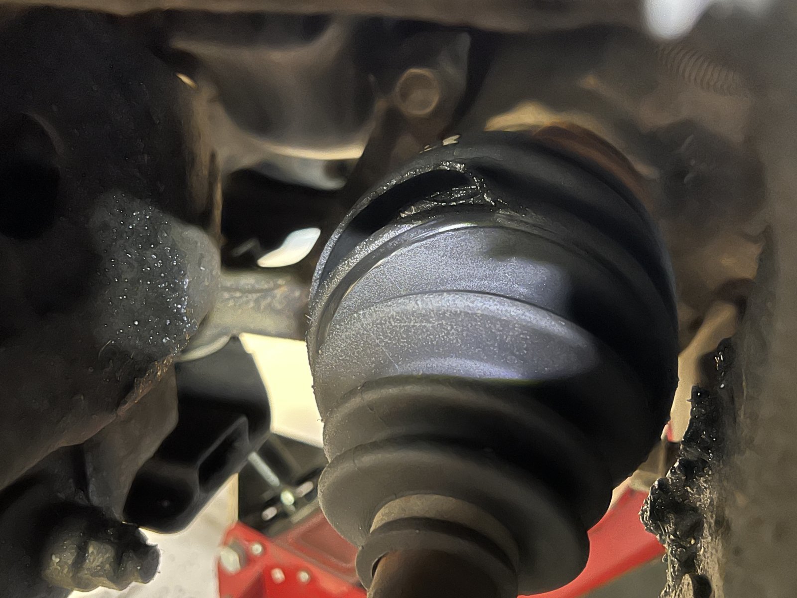

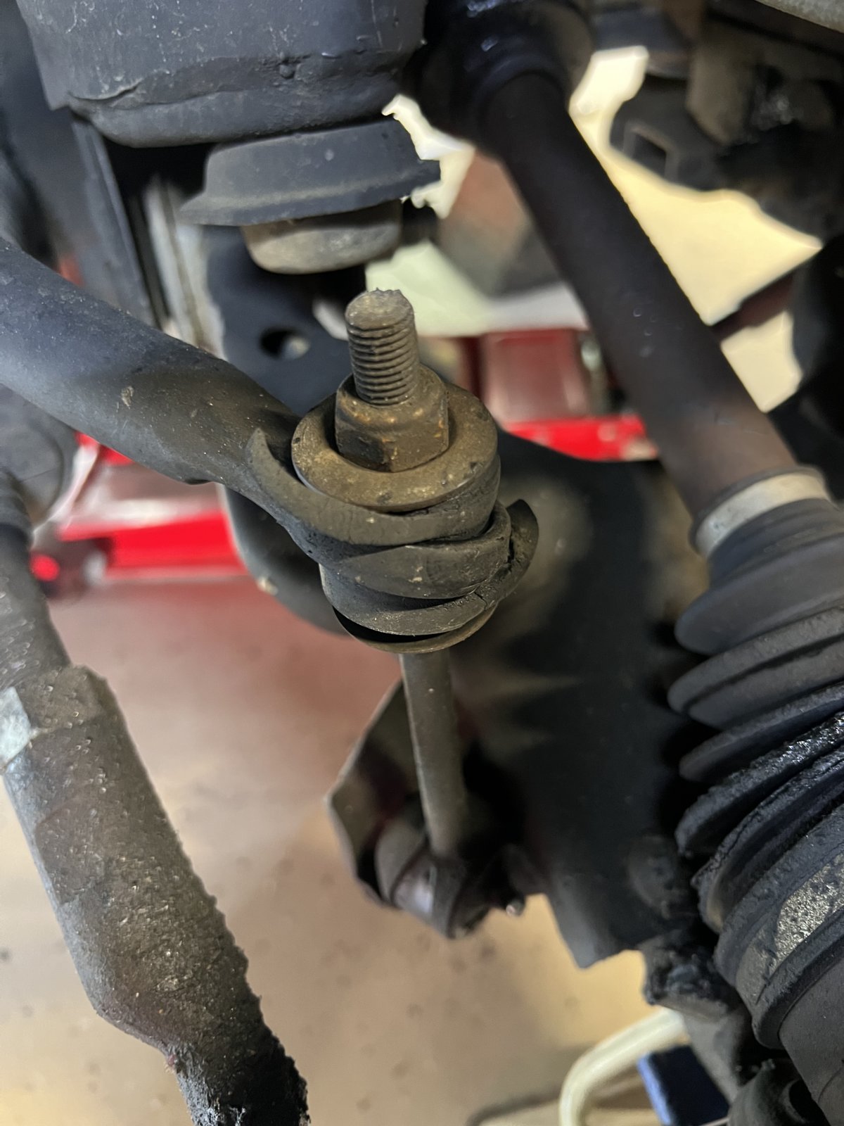

    Houston, we have a problem(s)

    Getting the full Monty today. Brakes bled, driveline lubed, tires rotated, oil change, throttle body and MAF cleaned, rear brakes adjusted and looks like new steering rack bushings. Lower ball joint boots are fucked, so ordering some new OEM LBJs. Axles are Advanced auto, lifetime warranty. This will be my third exchange due to failing boots.

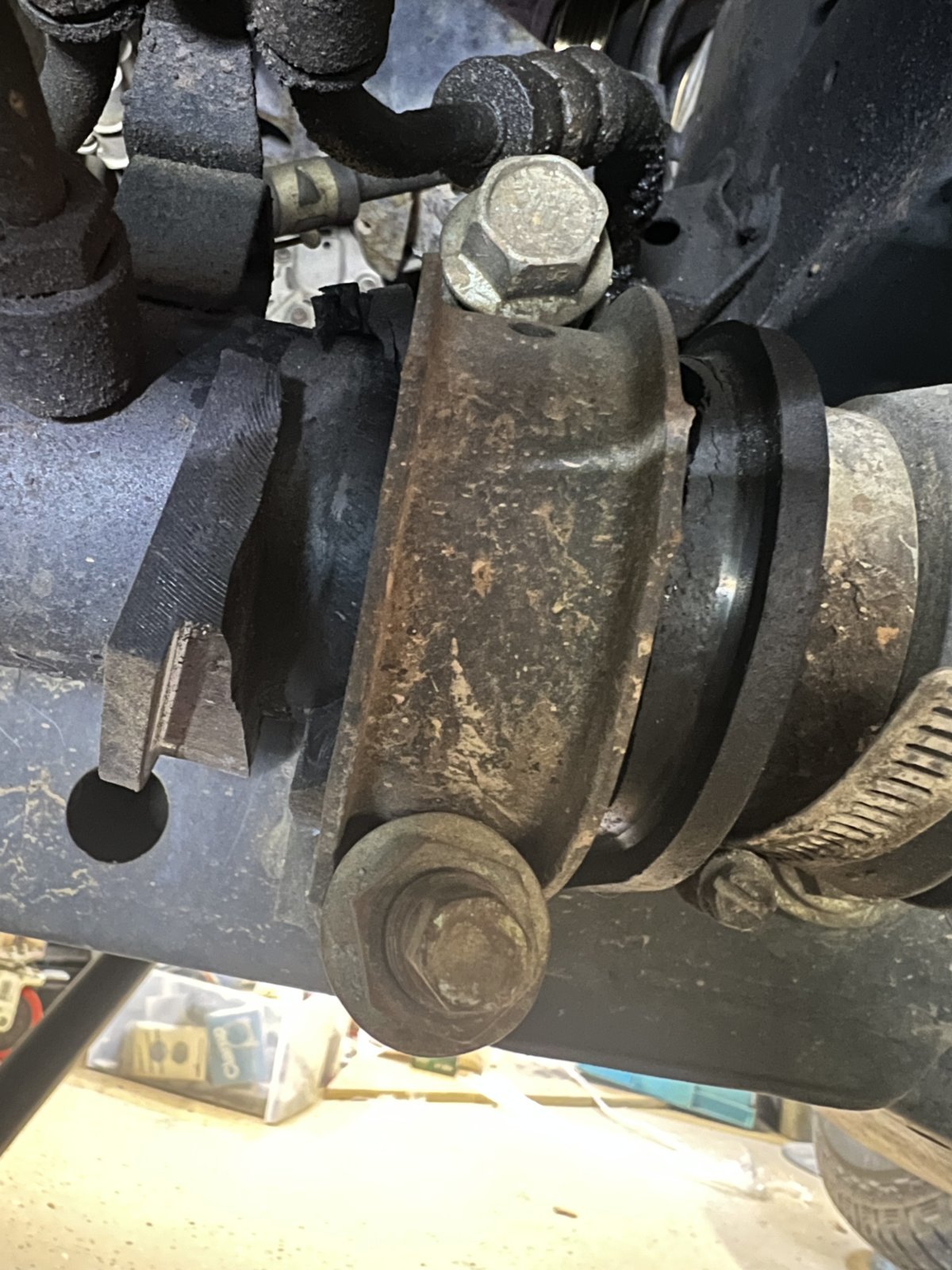

    More carnage

    Simple solution…… sway bar delete

    gonna try some washers under the lower bushing cup first to lessen the angle. Or get extended ones.

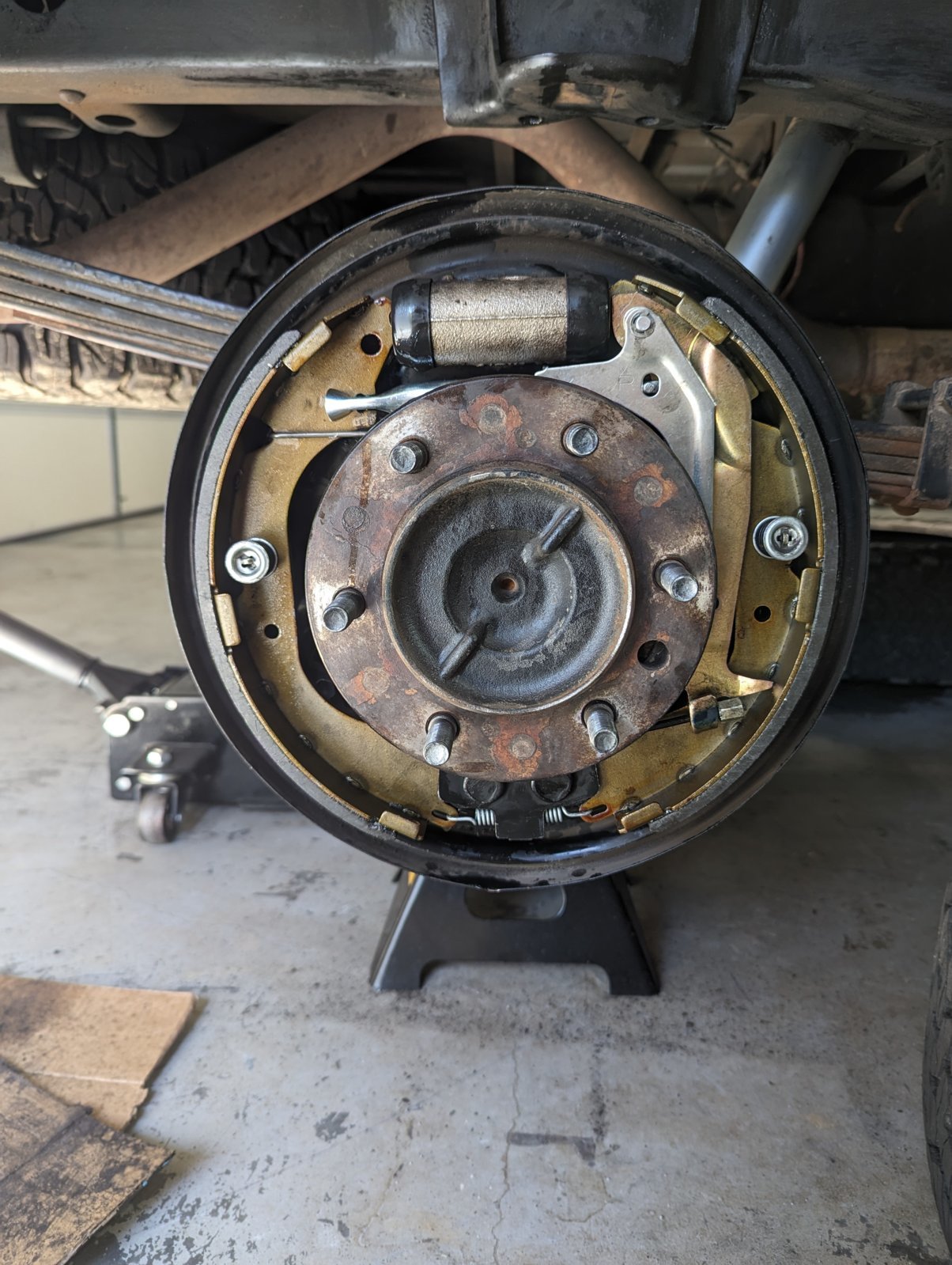

    Are most of you still running your original drums?
    oscardog86, bmf4069, 912 and 3 others like this.

    Yep. I am. As crusty as they are.

    Done with maintenance day. Mostly. Happy with my sway bar “spacer” results. Sits pretty level now. The upper bushing isn’t the correct style. Another round coming soon for LBJs, bearing and CVs.

    I got new drums, springs, shoes and wheel cylinders. Not sure what else I could replace other than going to 4 wheel disks. Jason felt that it wasn’t worth the cost and effort. Drums are fine by me, they work.

    Finished up the other side earlier. I confirmed both self adjusters seem to be working as designed when I press the parking brake, even the Napa adjuster on the passenger side. Happy this job is over.
