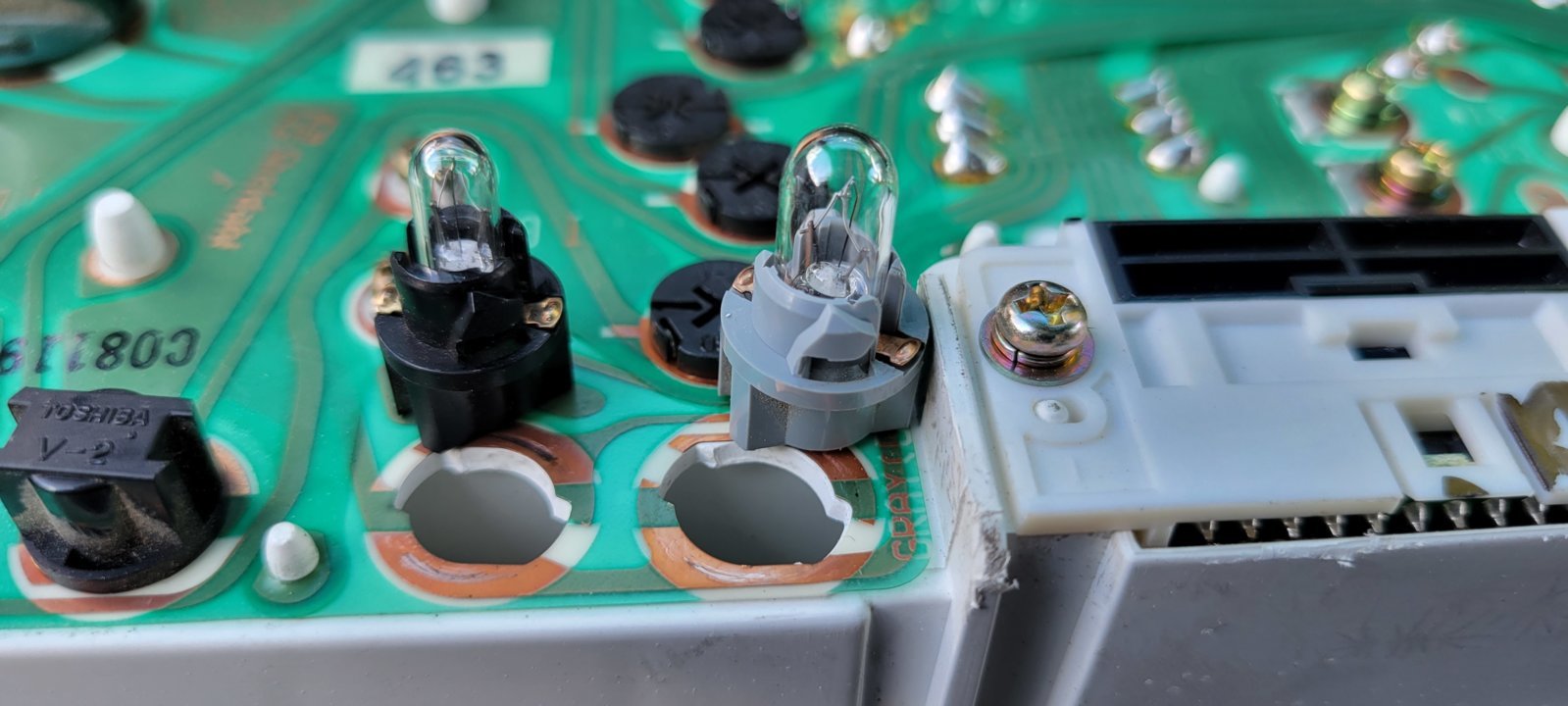

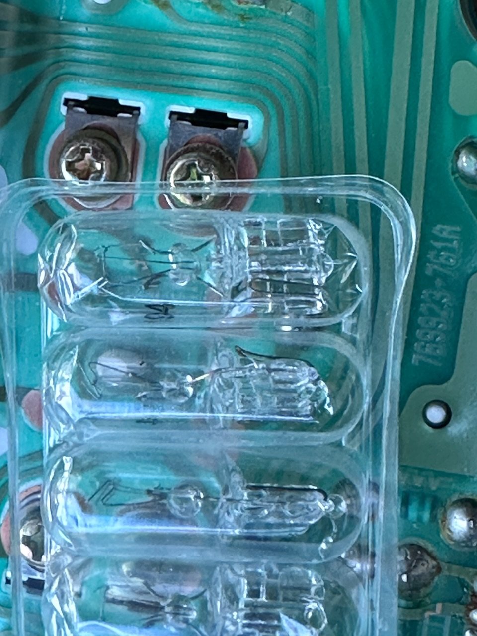

    Got my check engine light back by using the adjacent bulb but now one of them is out and it’s difficult to tell if the fuel light is working. Ohmmeter jumps all over the place.
    Appears these 194s are huge and do not fit the shifter light sockets. Anyone got a breakdown on the different bulbs for the dash console?
    Fuel bulb is bigger than check engine bulb. Check engine bulb is bigger than the shifter bulbs. Here’s a comparison of the 194s I bought and the tiny shifter lights which say T80 on the back.

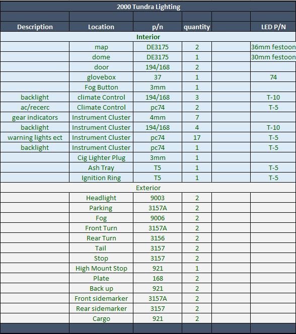

    Gauge cluster: 4x T10 bulb - https://amzn.to/3HXQNoj 19x T5 bulb - https://amzn.to/3X49pac (Only 1 is needed for backlighting, the rest are for warning/indicator lights) 7x 4.2mm NEO bulb - https://amzn.to/3HBHhpe (OEM non-led option)
    I got it from this videos description: https://www.youtube.com/watch?v=H1MKCgnfCu4

    I'm pretty certain @Tundra2 posted a list of all the bulbs for all the dash positions back when he was doing dad's truck.
  18. Nov 2, 2023 at 4:25 PM
    Jack McCarthy
    Nov 2, 2020
    #54409
    10,472
    Bill
    North of Boston
    02 Tundra AC SR5 V8 4x4
    I’ll have to check his build thread. @bmf4069 did a pretty good job with his spreadsheet listing.
    Tundra2, NUDRAT[QUOTED] and bmf4069 like this.

    bmf4069
    Sep 1, 2018
    #18880
    9,649
    Beau
    TX
    02 AC sr5 4wd v8
    As much as I'd like to take credit, I stole that from someone here back in 2020.

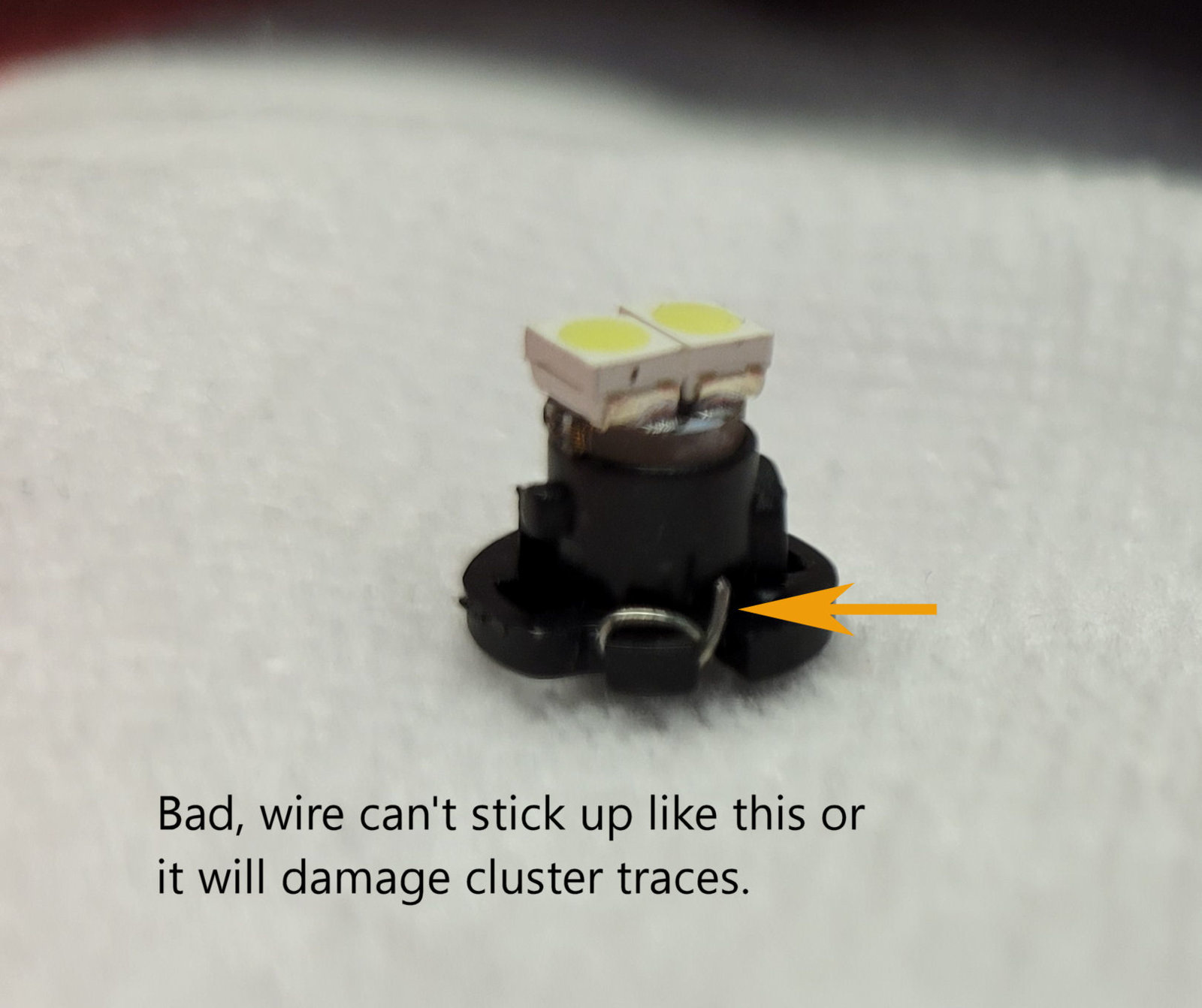

    I kept the low fuel incandescent when I did my LED conversion. I heard it needed the resistance.

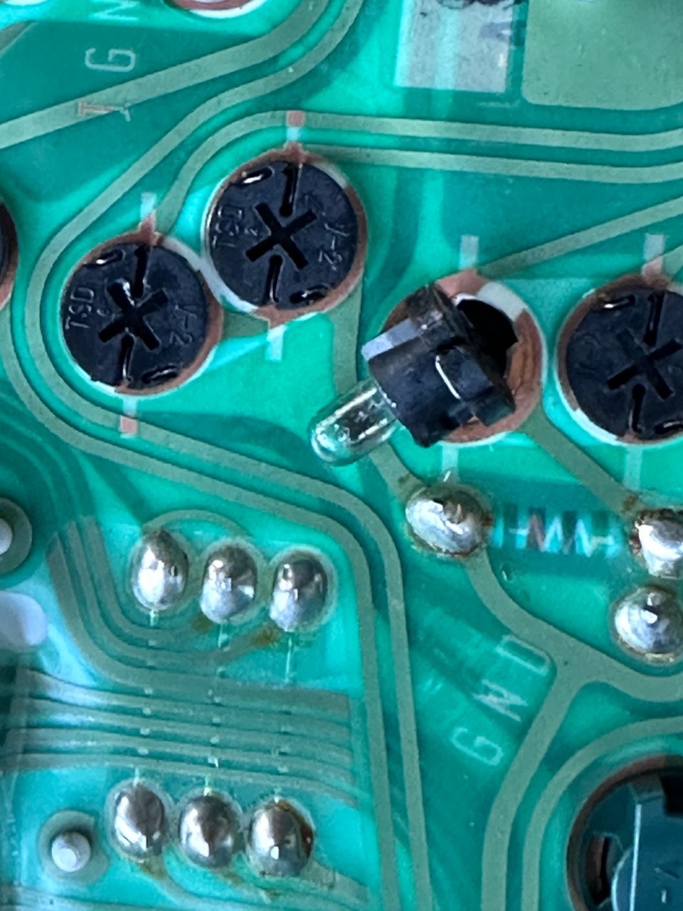

    Take a super close look at those wires that are supposed to make contact with the traces on the cluster.
    I even used a tiny tiny swab of dialectric silicon after cleaning the contact areas
    Try a different one, could be a Dud right out of the box?
    A couple of them looked like this

    When I pulled out the LED bulbs in mine, I found that the LED bulb contact base had stretched the housing contact points out. I had to take a small flat head and massage the contact points in to get them to make a good contact with the incandescent bulbs. Not sure if that's what is going on, but it was my experience.

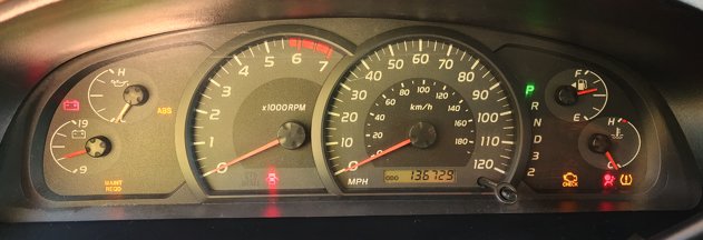

    I'm not sure what's in the middle but the TPMS is on the far right per my truck.
  29. Nov 3, 2023 at 7:21 AM
    KNABORES
    KNABORES Sarcasm incoming
    Jan 1, 2020
    #40572
    14,275
    Arkansas
    That's where the "A/T P" light is. It's a warning light for the 4wd system when your in park instead of neutral switching between 4hi and 4lo.

    Yeah, no tpms for me.
    Thanks, @KNABORES. It’s good to know what it’s for since the light appears to have always been out for me.
