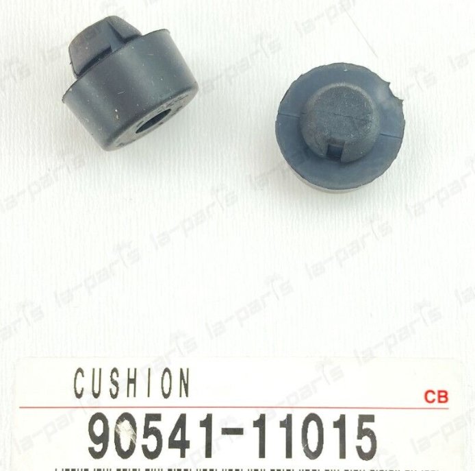

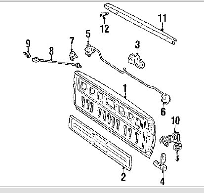

    I'm fairly certain the p/n is 90541-11015. Edit: Made visual confirmation on my truck, and (1) I do have bushings on both sides, and (2) this rubbuer bumper part matches my existing bumper. I pulled that part number from the EPC-DATA website for my make/model/year if it matters.

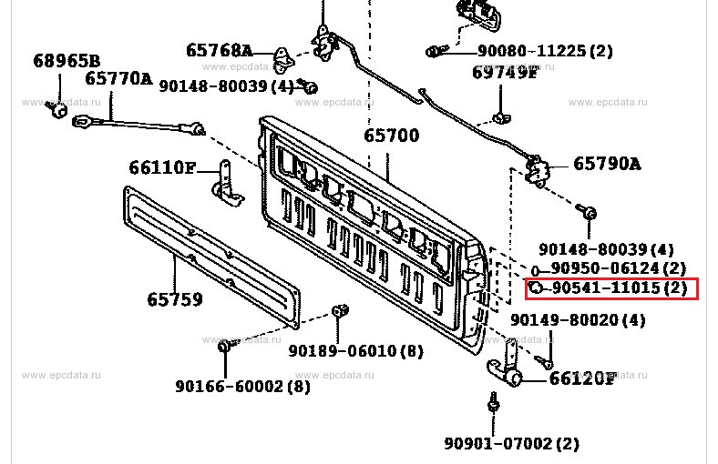

    The wierd part is, look at where Toyota shows that part: https://toyota-usa.epc-data.com/tundra/uck40/3806/body/6553/
    It's basically going into the side of the tailgate?! And clearly, you can't buy the tailgate bushing separately, you need to buy the latch assembly (66120-0C012 for LH, 66110-0C012 for RH on my '06 AC)

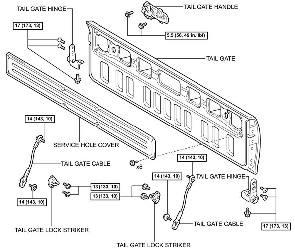

    All of the diagrams are odd. I checked in two separate systems and both don't even show the cushions/bumpers in mine. I even looked in the bedside and still couldn't locate them.

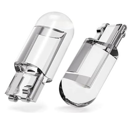

    I put in T10 LED bulbs but they didn't fit into the sockets very well. The LEDs fit into the sockets was not good. I had to force them in and they still barely grabbed on. I think I will try different ones that don't have those little square components near the connector.
    These are what mine look like.

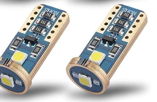

    I have some of these that would fit better I'm sure except they are an Amber color instead of white.
