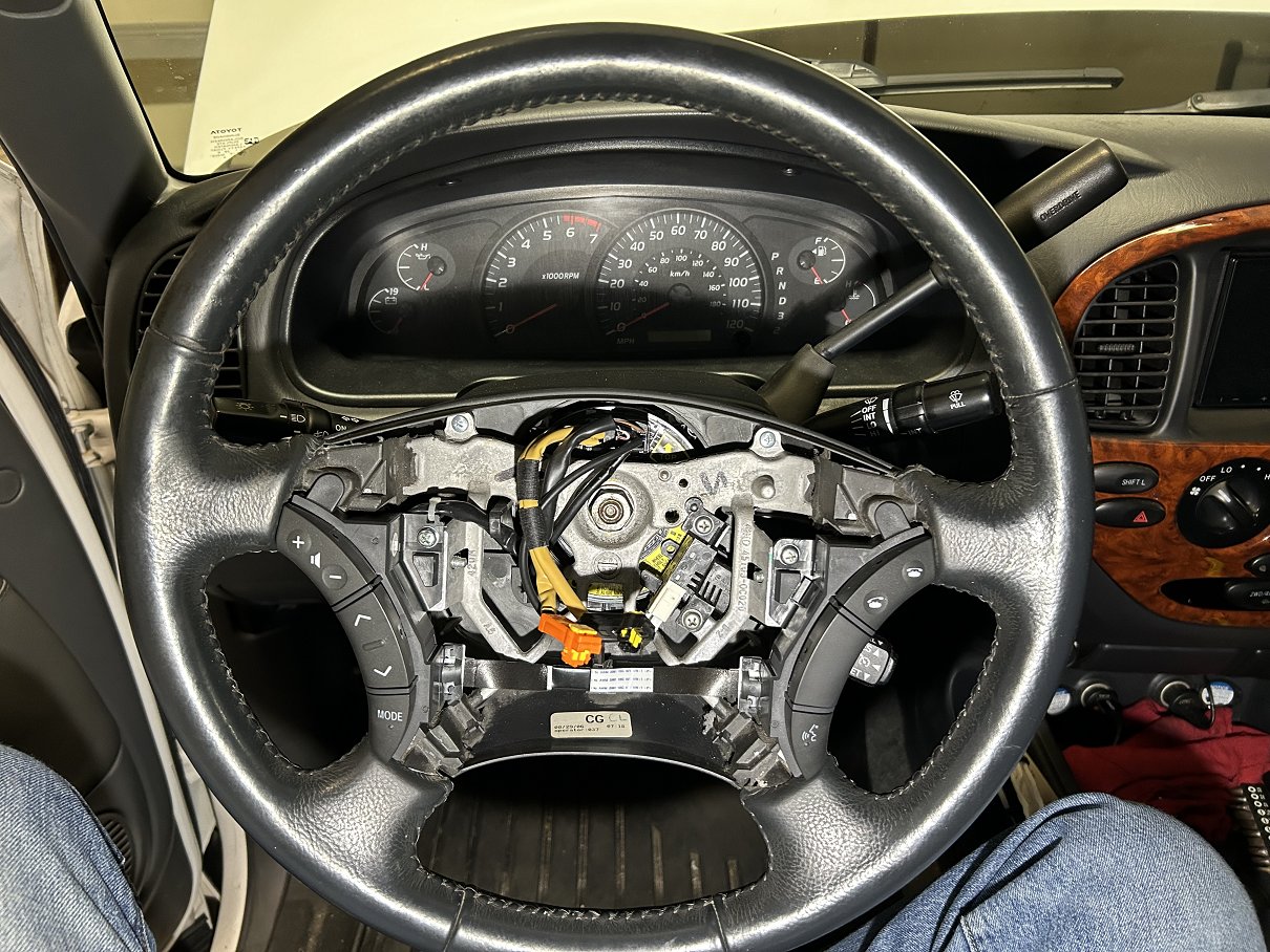

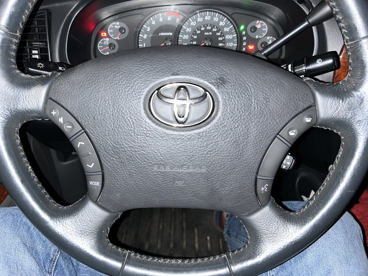

    Some OEM+ upgrade action today, long overdue.
    Installed 2006 T4R leather-wrapped steering wheel, then added right-hand T4R controls. Color doesn't match on the right, but they seem to function right out of the box (although I don't understand the purpose - 'speak' makes the head unit listen, and 'phone off hook' brings up the phone loading screen!)
    I'll be happy either way, and I guess I'm on the hunt for green-backlit right-hand controls so I can gut the PCB to swap over. Adding the write-up on how to do this over in the steering controls info dump thread at some point in the next couple hours or five.
    If anyone needs a low-mile charcoal grey OEM steering wheels WITH left-hand controls and cruise, I'll plop it into the sales area before the weekend, or hmu. It's mint, probably toss it out there at $100 shipped?

    If you already had steering wheel controls, what did you gain by swapping it with this one?

    He got the leather wheel?

    Leather wheel ... more grip surface, more comfortable to me, better grip. And for only a little more than what I'd pay for a Loncky wrap which would take 2-3 hours to finish if I left the wheel in or maybe an hour less if I pulled it. Either way, I'm probably pulling the wheel.
    And right-hand controls added is a bonus. I think, maybe.

    Didn't you determine it's not possible to add steering wheel controls to my 2002? Otherwise I might be interested in your old wheel.
  19. Oct 12, 2023 at 5:23 PM
    shifty`
    Jun 20, 2020
    #48239
    31,575
    ATL
    '06 AC Limited V8/4WD
    It's possible, anything is possible. @artsr2002 did it recently on his truck. You add a couple of wires into the plug on the back (pedal) side of the clock spring, assuming your clock spring will accept the steering/cruise wheel control harness on the airbag side of things.
    I think the wall you'll end up hitting is (and maybe @daveeasa can confirm this) your 2002 probably uses a single stage airbag, with a clock spring compatible with single stage air bags. I'm pretty sure you would need:
    • Later model clockspring that supports dual-stage airbag
    • Dual-stage airbag and trimmed airbag cover
    • If I recall, 3 wires you can insert into the (pedal) side clockspring harness to run over to a control module like the iDatalink or ASWC-1
    Not super plug-and-play. I dunno if you'll want to do there or not.

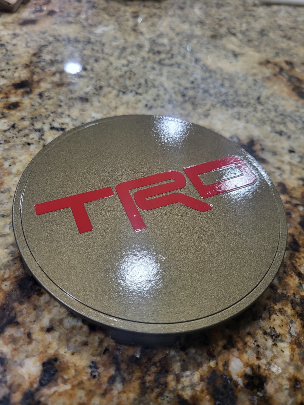

    Well, the wheels are at the tire shop and have Falken Wildpeak 275/70/17s wrapped around them. They'll go on the truck after work. Finished up my center caps tonight too. They came as solid matte bronze, but I added the TRD stickers and hit them with 3 coats of Duplicolor clear coat. First, they were a little more matte than the wheels themselves. Secondly, since the letters are not recessed at all like the polished aluminum OEM TRDs, I thought the clear might protect them from the rain and car wash. We'll see how they look tomorrow.
    Here's what they'll look like, but this was pre-clear coat.

    I think that looks damn perfect man. Good'nuff for Gov't work.
