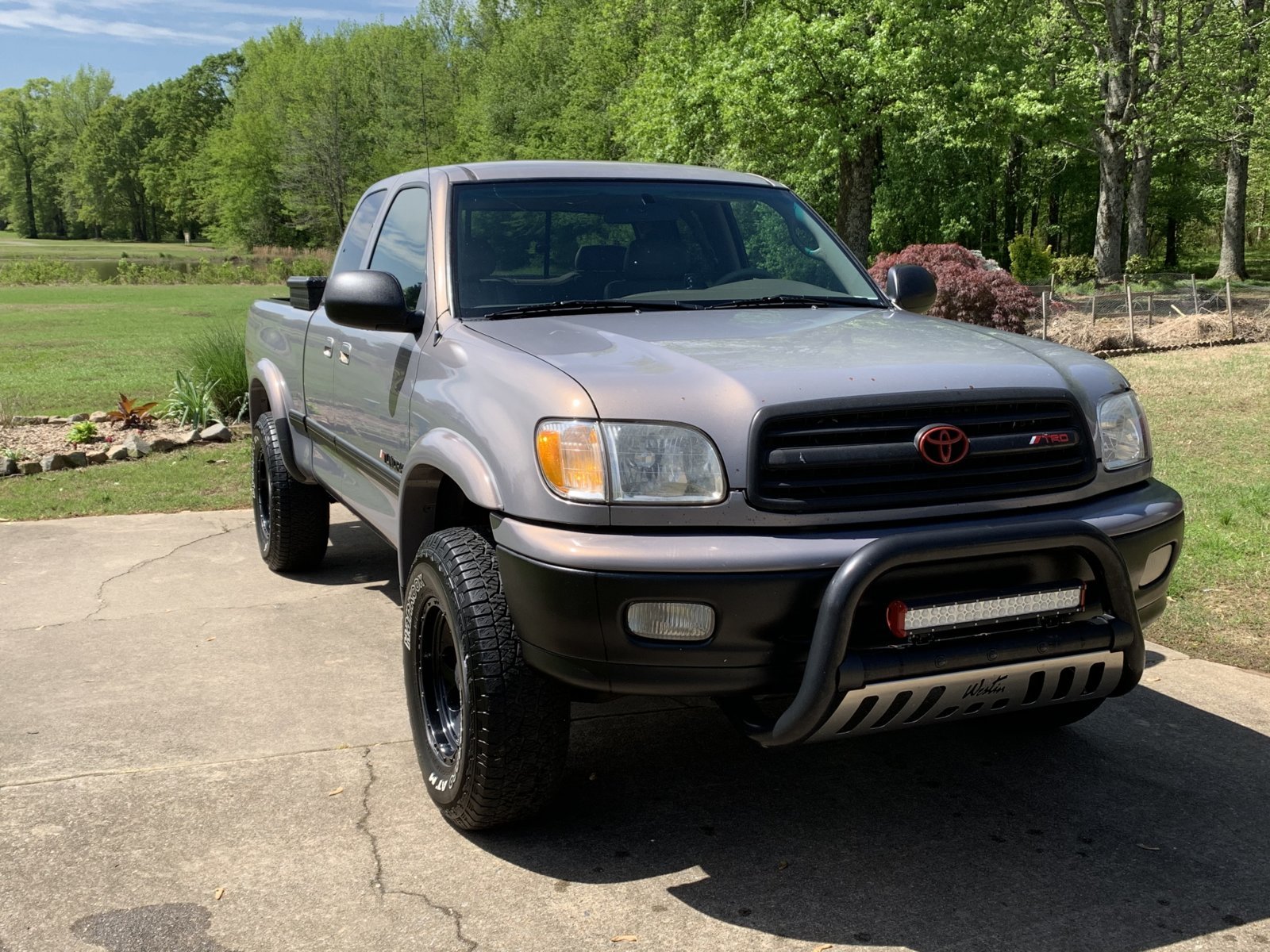

    I’m supposedly on 4.5” backspacing on my 16x8 wheels. I added 1.25” spacers due to them being tucked under the flares too much.

    31.5” tires. 265/75/16. Mild ATs

    Yeah, I don’t think I’d be rubbing if my tread profile was that tame. I’d probably have a good inch or so of clearance. The Mickeys I went with are pretty chonk.
