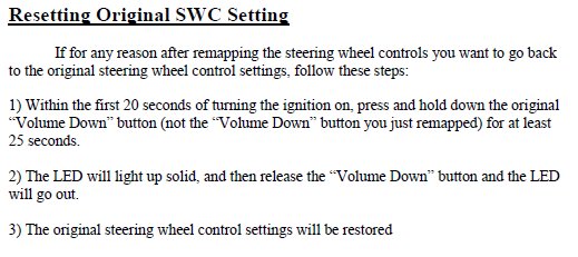

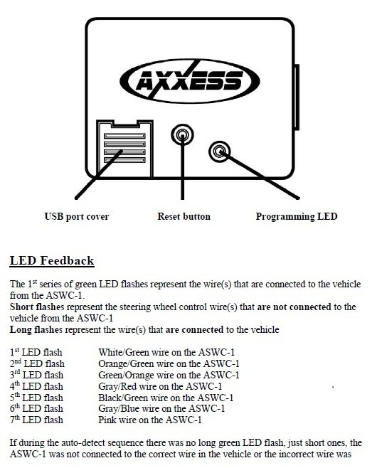

    If you indeed stuck with Kenwood, I would suggest not removing anything until you have at least tried following the below ASWC-1 programming instructions a few times to verify proper LED feedback.
    While my Kenwood install went well, programming the ASWC-1 took a little bit since you have to watch the "Programming LED" as you follow the instructions as it flashes feedback telling you have the wires hooked up right and that the proper radio was identified. In case you do not have the ASWC-1 install and programming instructions, I have attached them below to help with mapping or re-mapping the buttons.
    Before removing anything, I would suggest going thru a reset procedure if you haven't already....

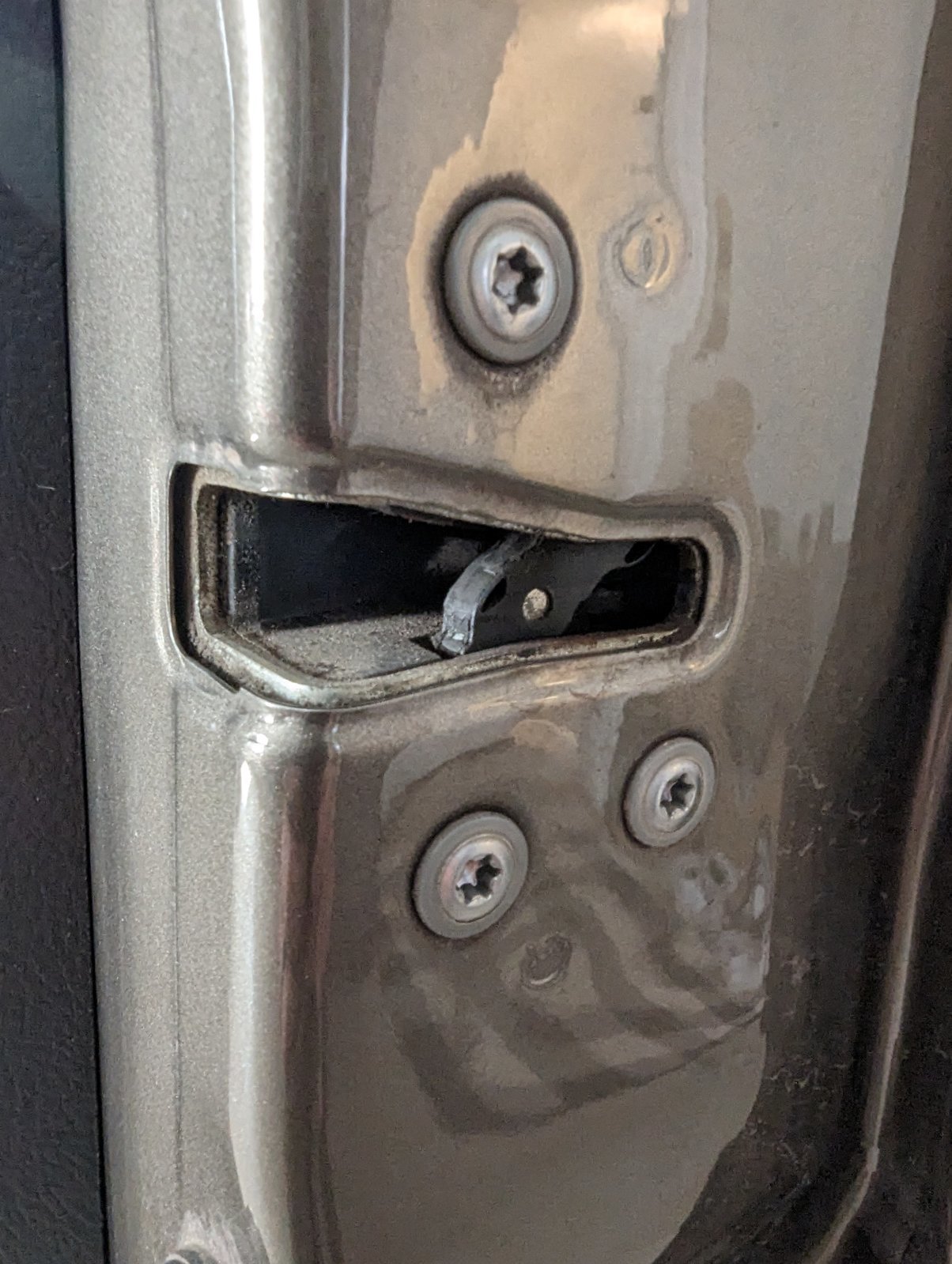

    Does anyone know if these 3 fasteners are also used to adjust the latch? Our RAV4 hatch won't stop rattling. All 3 were loose but so far nothing has helped the noise.
    I can't be positive it's the hatch making noise but I'm not sure what else it would be.
    The more I look at it, I don't see how they could adjust anything. It's odd that they were so loose.

    On mine, they only tighten. They do not adjust

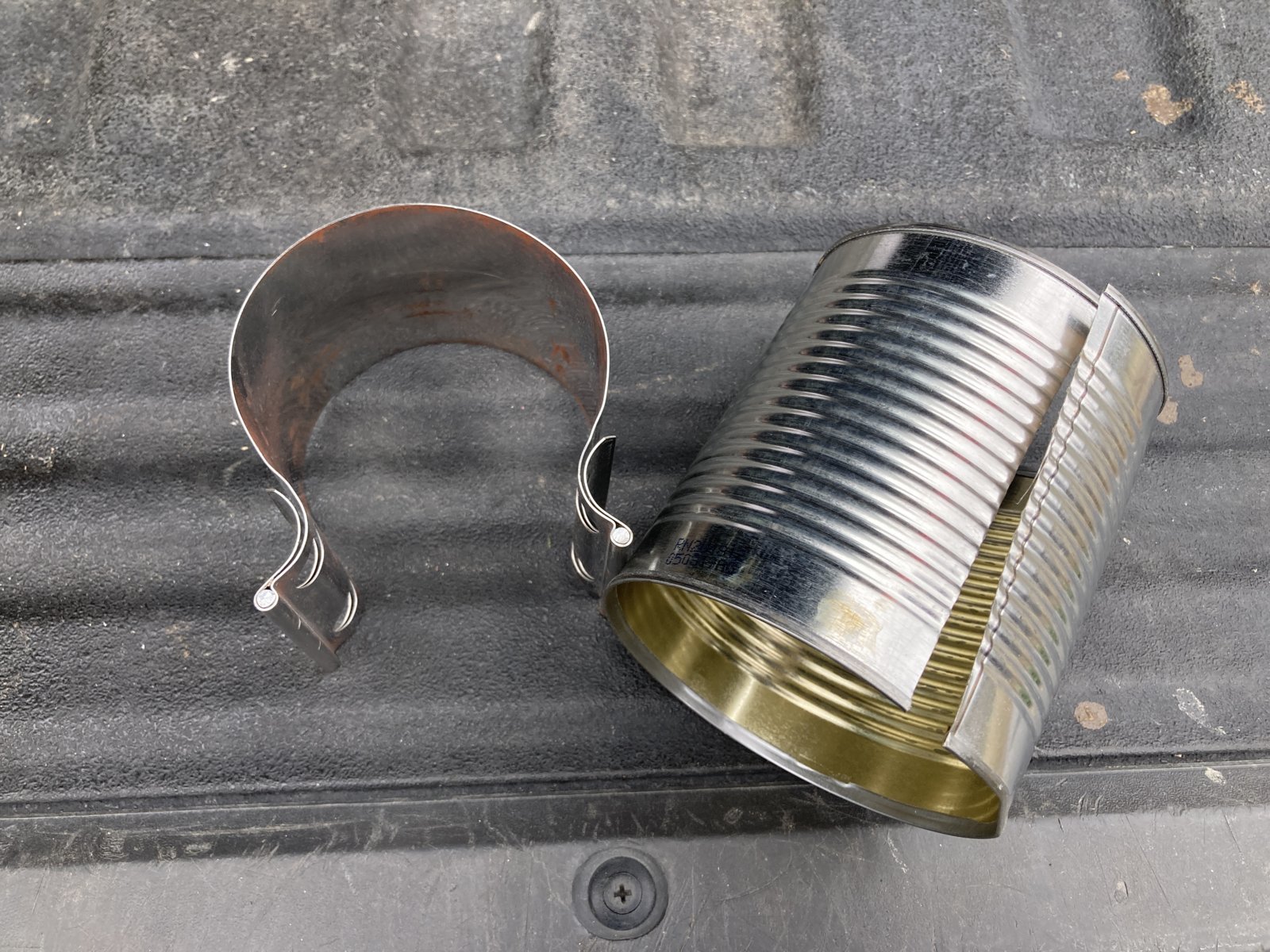

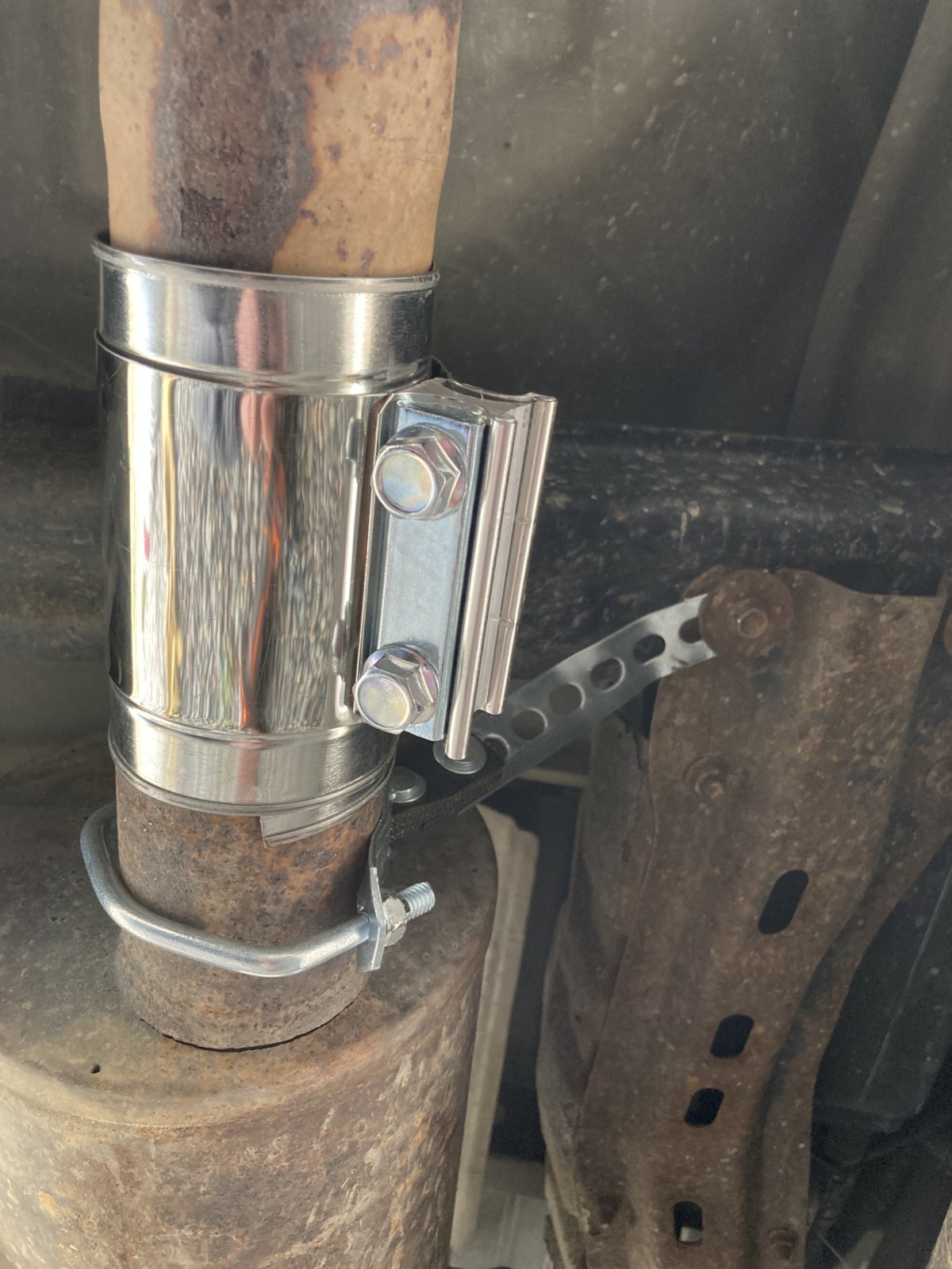

    Last week I drove the Tundra 1,800 miles from ID to WI and the exhaust note was exceptionally gnarley so I figured I'd refresh the band-aid at that I installed 2 1/2 years ago.
    2021's broken pipe and repair. It wouldn't be a band-aid if a soup can wasn't involved!IMG_1856.jpg

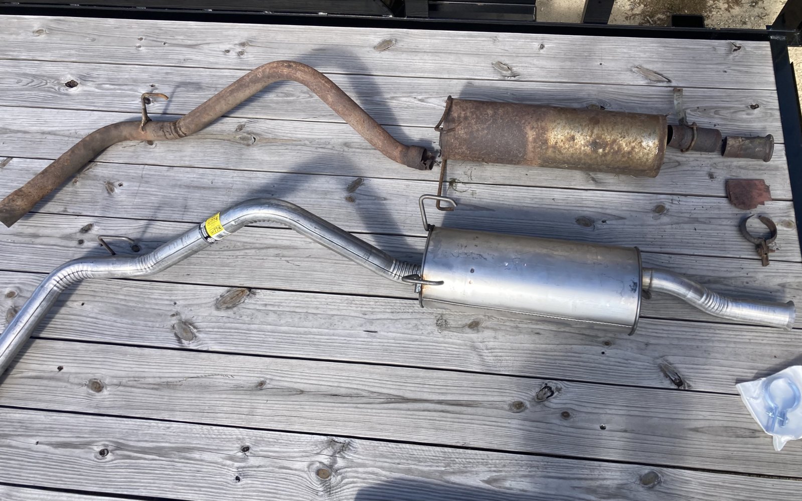

    It turned out I was only going to get 2 1/2 years out of that band-aid because the muffler disintegrated when I attempted to loosen the clamp.
    Oh well, off to Napa to buy a mufflerr assembly and clamp $180 w/tax after 20% off. 12 hours later the replacement fit perfectly and I installed it in about an hour.
    As much as I love the sound of an unmuffled Tundra, I HATE the drone on these 10 hour travel days.

    I would guess the rear hatch has the two rubber nubs that screw in out to stop rattles like the hood has. If not then Toyota would keep it quiet between the hatch latch & the gasket around the opening. Is the RAV old enough that the rubber gasket is beginning to collapse? Assuming the gasket runs in one big 'circle' around the opening - try pulling the whole thing off & put it back on clocked 1/4 turn. That may hush things temporarily which would confirm it's time to replace the gasket.
