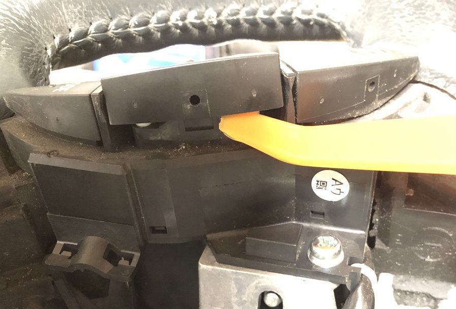

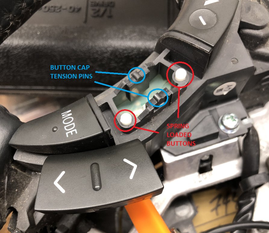

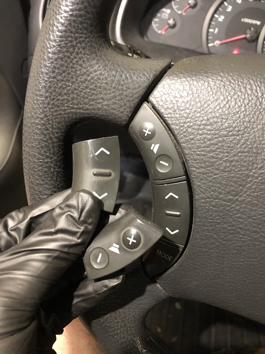

    Meanwhile, I guess this is the WHYDTY1GT thread and I just did something Tundra-focused building up to other somethings ...
    Purely out of vanity while working on some other upcoming stuff, I swapped out the button caps on my steering wheel controls. This is 100% possible to do with the steering wheel is installed on the truck, airbag intact, with limited/no risk I could foresee. That said, anyone with non-matching control colors, you can buy cheap Chinesium parts on scAmazon in the right color and swap the buttons (or even the OEM circuit board inside) over if you want matching controls ....
    Since the LED backlighting on other models (T4R, I'm looking at you) is amber vs. green, I didn't want to swap controls. I have a T4R leather wheel on-hand with controls with fairly pristine buttons. Turns out there's nothing fancy about the buttons at all, just a little locking nub that acts as both a lock and a pivot point for the steering controls. If you get up under that, mid-control, from the inside or outside, you can pop up the cap safely.
    Props to @assassin10000 for helping me realize there's no springs underlying - I was concerned if I popped the cap off, there'd be a spring between the center of the button and the control contact point on the PCB. In hindsight, that would be a really horrible, fallible design for automotive use. Instead, Toyota opted for these little white-capped spring-loaded bits to push into the PCB you can see nestled down inside the control housing in this pic:
    And with that ... so long old, glossy buttons from years of rabid music listening, track-skipping, eternal-volume-upping. Hello, new factory-fresh(er) looking buttons. I must have a lot of acid at my fingertips, I tend to wear the matte finish on keyboards and mice shiny like this too.

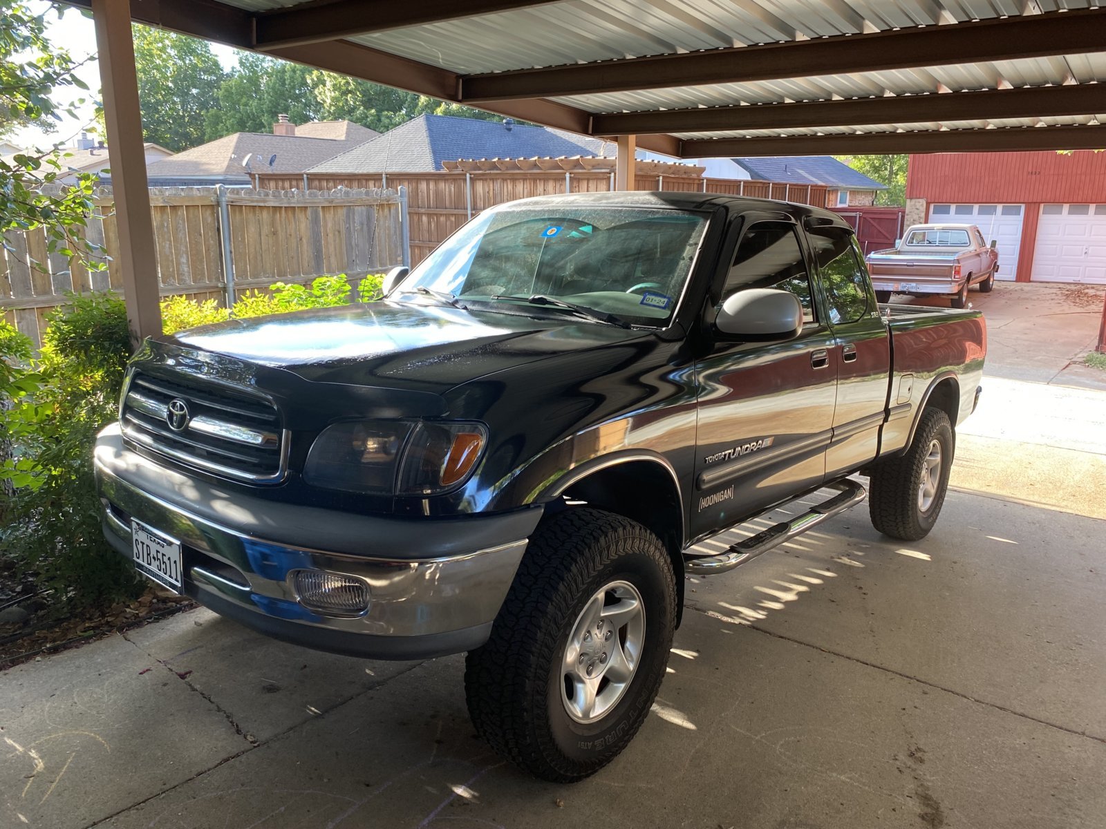

    The paint is tacky to the touch so I put the hood defector back on and drove her home. Here’s the instagram angle. You can gauge the shity roof for comparison of before and after. Once the paint cures, I’ll take a finishing compound to it. I realize that I will have to remove the hood deflector again, but I have 3M tape by the truckload available to me at work.

    Shouldn't you give that at least 6-8 days cure time minimum before you start cutting? Enamels typically don't start firming up fully until 2-3 days out IME.
    I'd give it 1-2 weeks, then wetsand at 800 grit, then 1200 grit, then cut it hard.

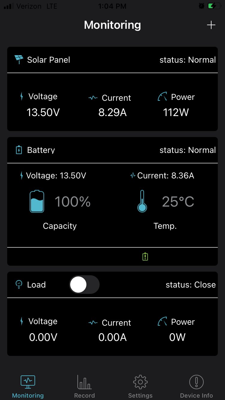

    87A21AEE-42EB-4F41-A576-9F41FD4AAE24.png Making power!
    now I just need to replace the battery and we should be back in business

    Yes. That’s the plan. I’m not doing that anytime soon. Our weekends are full for the next bit.

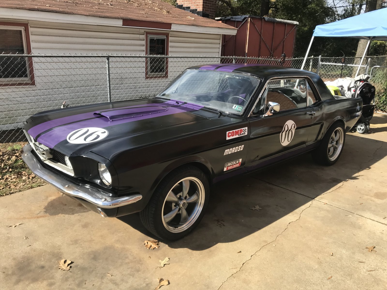

    This was my 65 done completely with a roll on method of rustoleum. I didn’t do any finish work to the paint, but it did the job really well
    Nicklovin, Voss, oscardog86 and 7 others like this.
  25. Oct 5, 2023 at 6:09 PM
    Azblue
    Nov 17, 2017
    #11025
    10,587
    The Dirty T ( ^_^)_且
    Pretty impressive, I'm surprised.

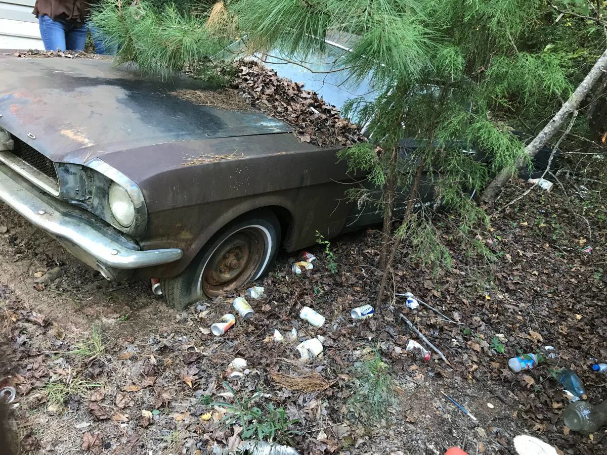

    I sure do miss that old girl. Here’s a before and after. I literally dug her from her grave and made her run and drive… and did burnouts!
