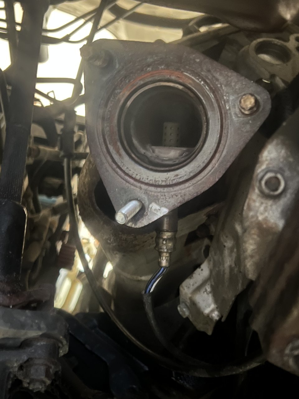

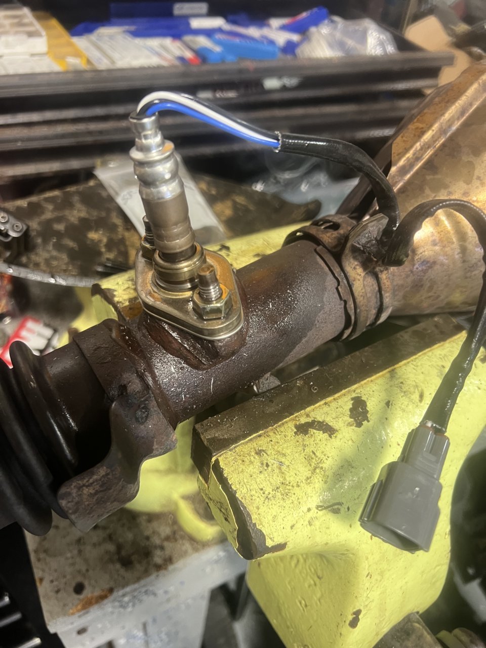

    Got it done! No more CEL

    Congrats, do tell though: Is the stud on that flange pressed or threaded?

    Which flange? I wouldn’t think any are pressed

    His 1st pic. Note the oddball. I'm assuming threaded hence the bolt, but asking for future knowledge.

    Yes it was threaded

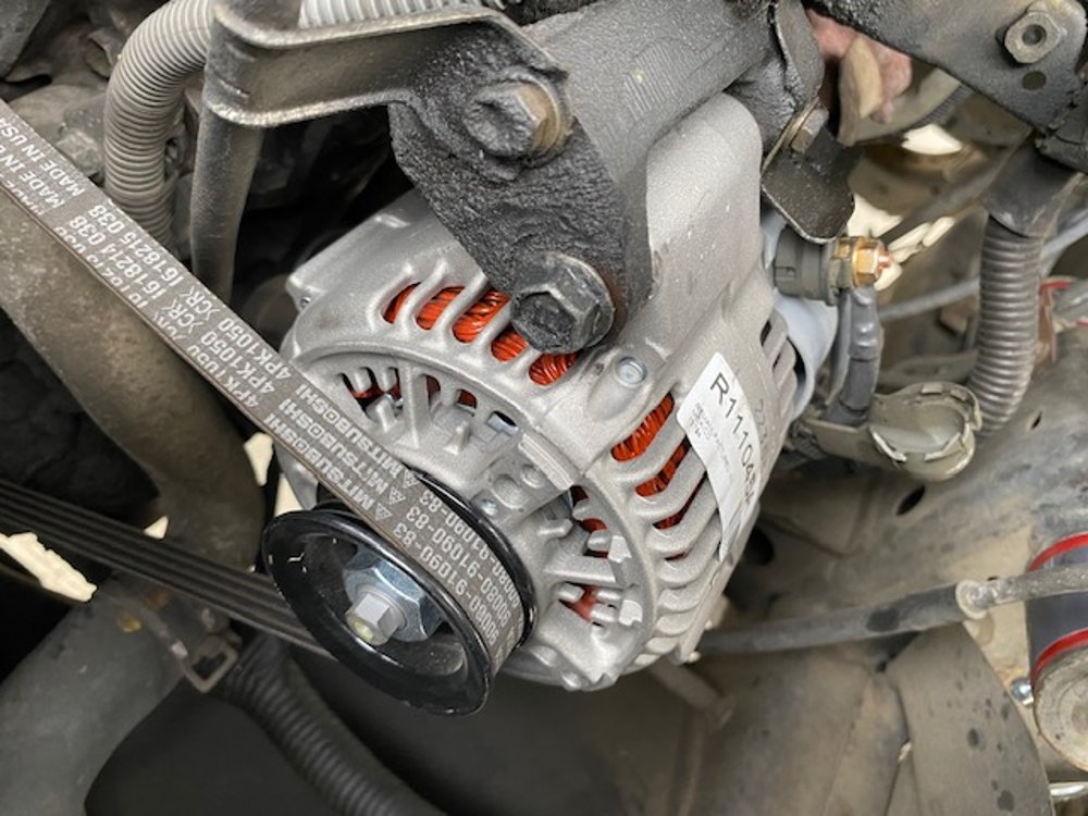

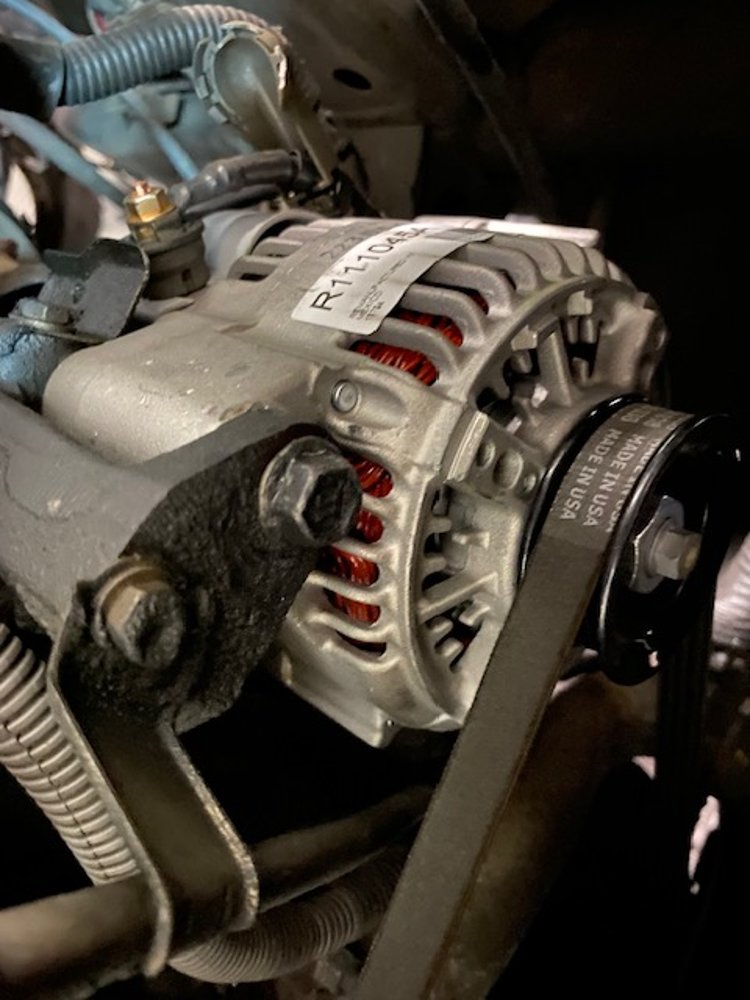

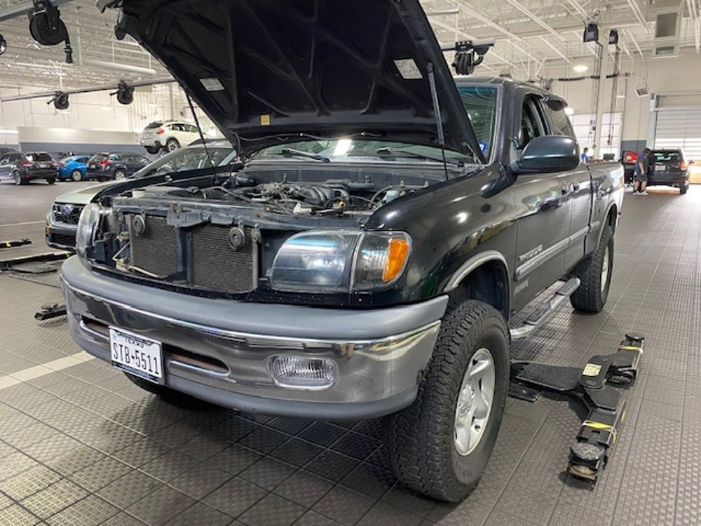

    Replaced the alternator. Also cleaned the throttle body while I was in there and replaced a few vacuum lines that didn't survive removal of the intake. It was time for them anyway.

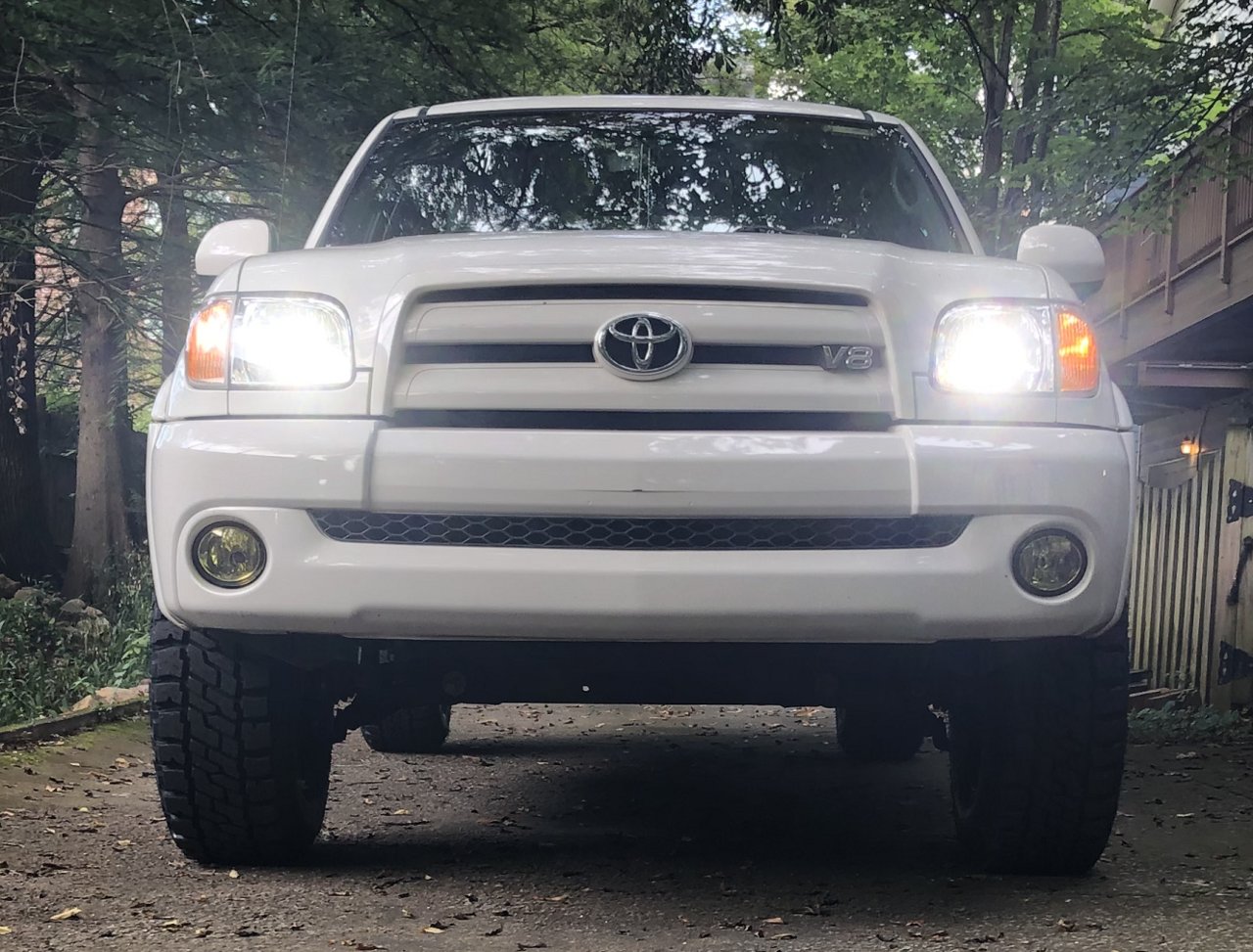

    About to drive it home but had to stop and pull an OEM tire out of the cab.

    Lt. Dan, you got new legs!

    Man that looks good. How’s it driving?

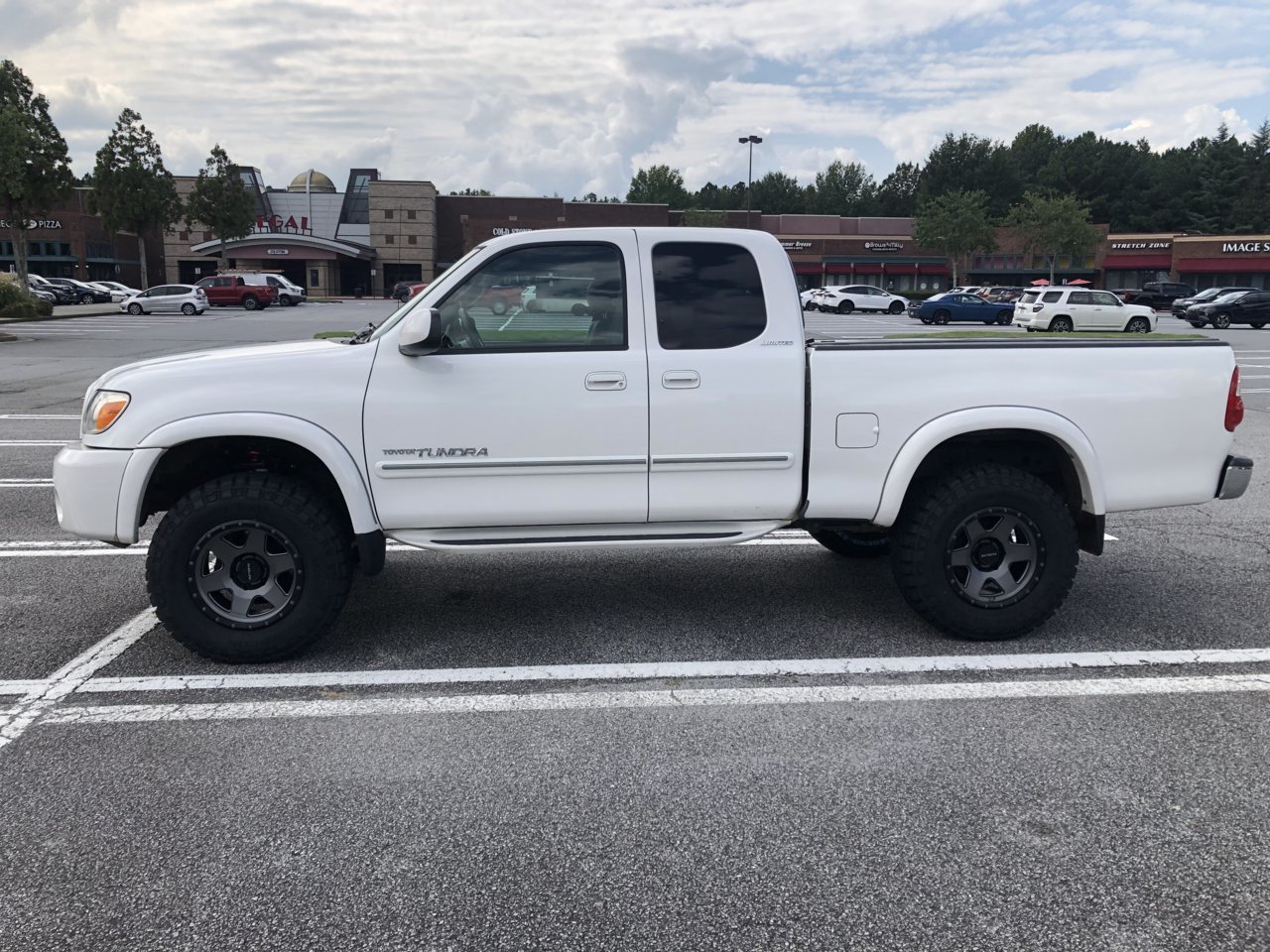

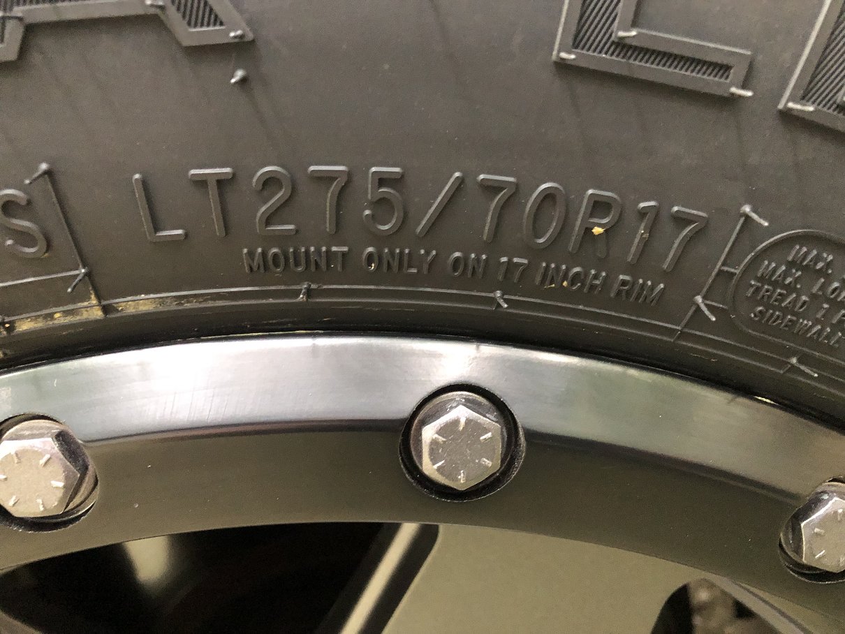

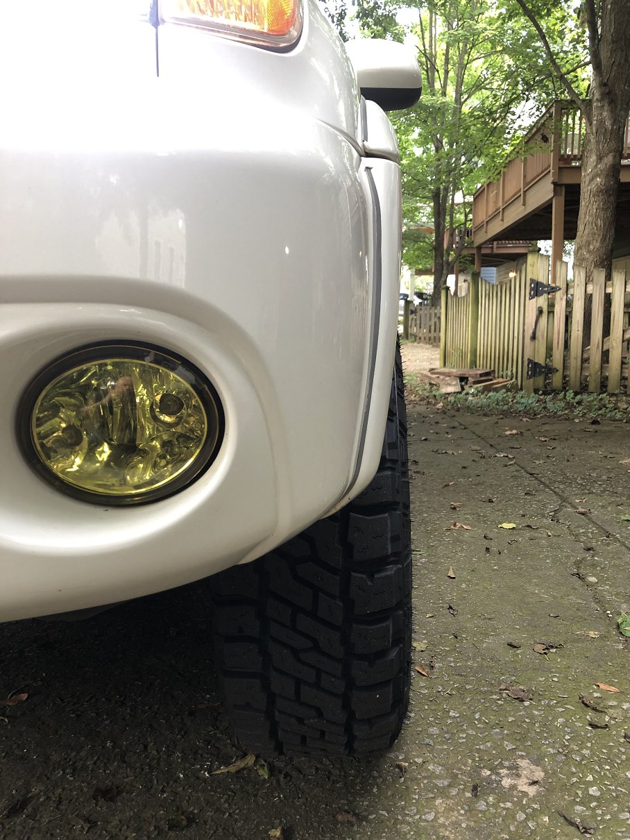

    Those are 275's? They look great. Hit us with some close up shots of the wheel/tire.

    Yup. More pics below.

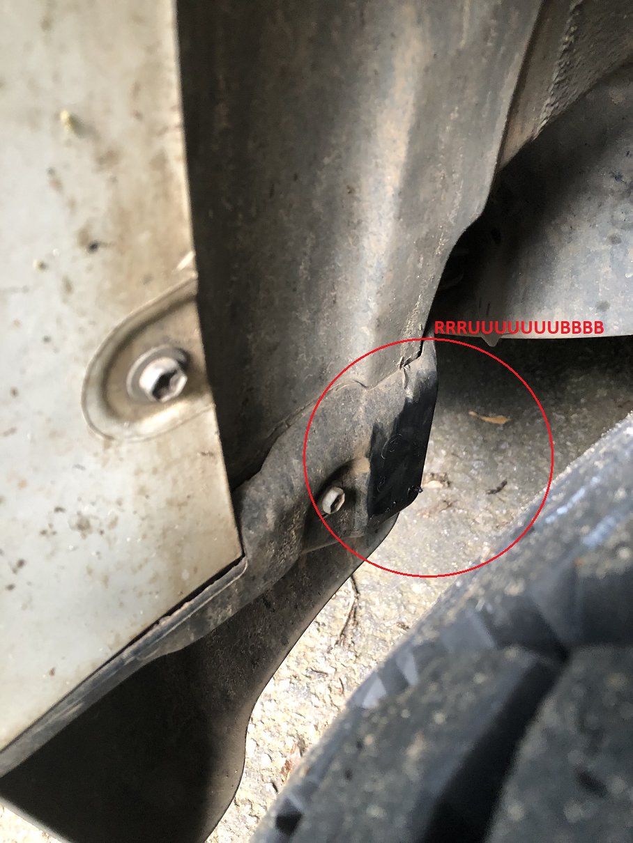

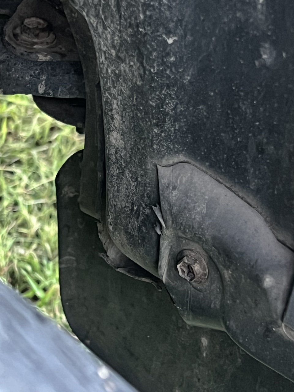

    Initial feedback? Noticeably more hum while driving. Not obnoxious, but maybe halfway there. I did notice a little driftiness to it when I first left, and making a U-turn on the 4-lane road in front of the place, I could tell I was definitely rubbing (maybe because 17x9? that xtra half inch would be just enough), even with 2" lift and LT275s, you can see where below. And I'm actually surprised how much heavier it feels on acceleration. But I'm still waiting on the alignment #s, I think caster may be off what Assassin reco'd.
    Rubbing on both sides in this spot on my fairly new flaps...

    Looks great Shifty', even if it isn't OEM :thumbsup:

    (I don't think I'm planning to keep them - and still not sold on these wheels yet, either. I really would prefer something more gold. I may look into what it'd cost to have these refinished.)

    I cut that area off of my flaps.

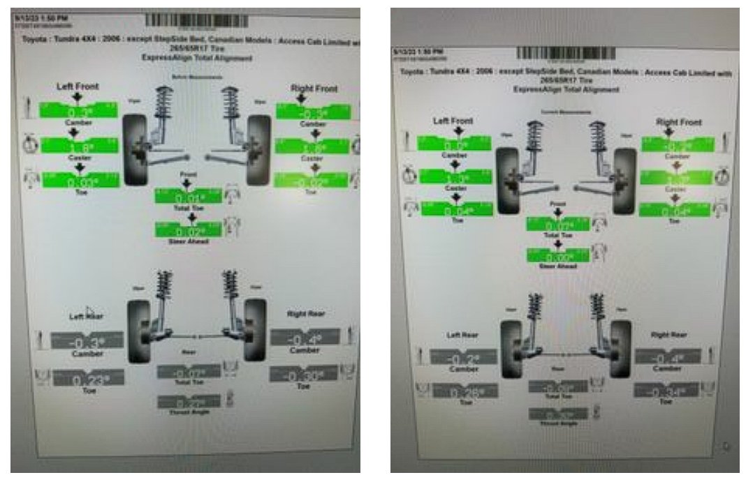

    This is the best I could get on numbers, blurry as hell, and I don't know which is before or after, I assume left is 'before' because I know the driver side camber was farther off when I finished. The guys told me I got really damn close for freeballing the alignment after the lift, but that doesn't help.
    They've convinced the numbers they're showing below are what's best for me. I think I'll ping them tomorrow and ask for clearer shots.

    Remind what wheels are those? I know they're 9in wide and iirc -12mm offset

    Yup that's where you gotta :sawzall:
    Though I recommend an angle grinder or cutting wheel for the metal bits. You can use what ever for the plastic. I used the tin sheers

    Mmmmm, angle grinder on plastic, my favorite smell.

    And the melted plastic boogers

    I'd rather just let the tires do their job.

    You could always just remove the mudflaps.

    Aforementioned “notch” in the mud flap

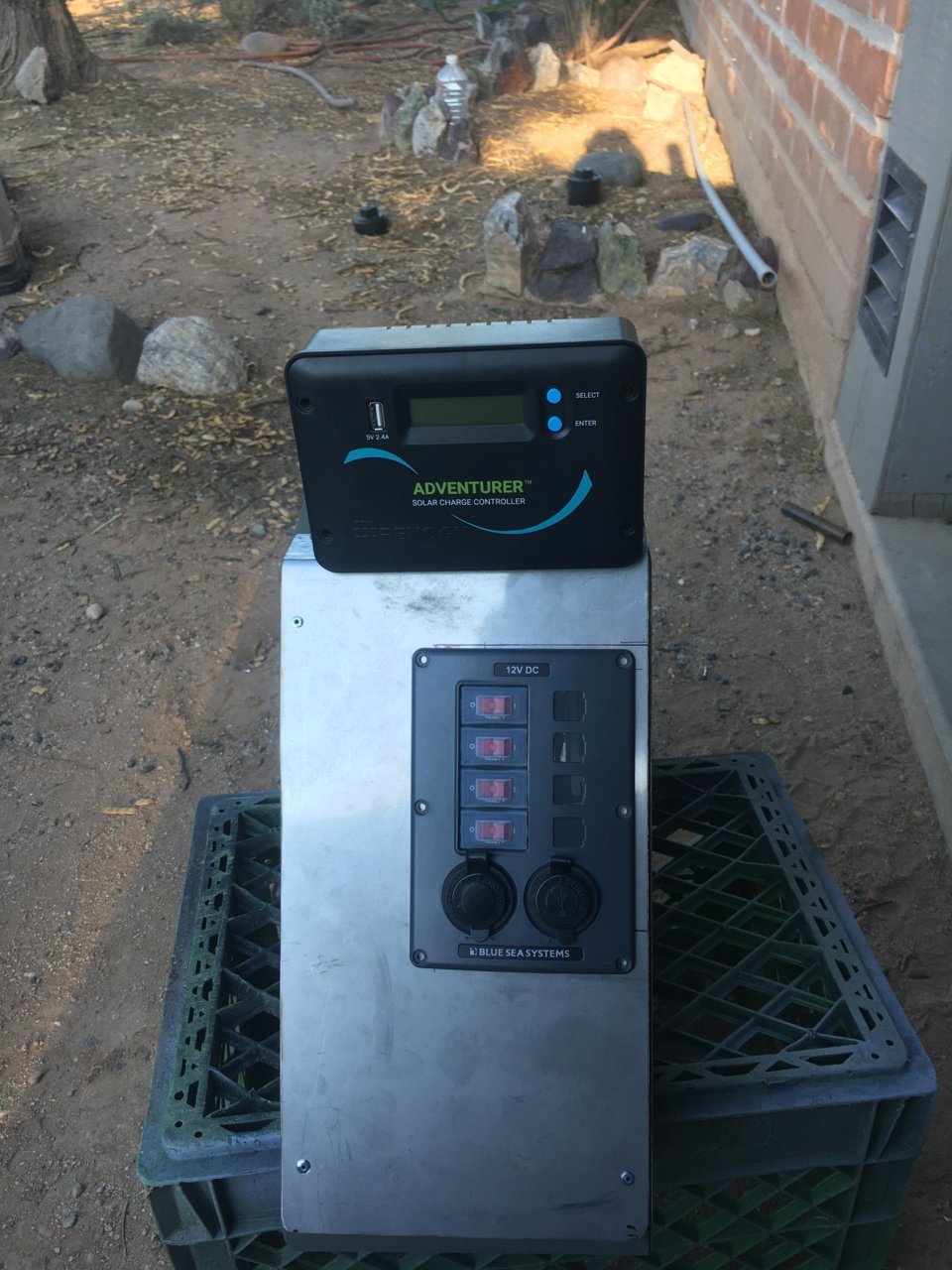

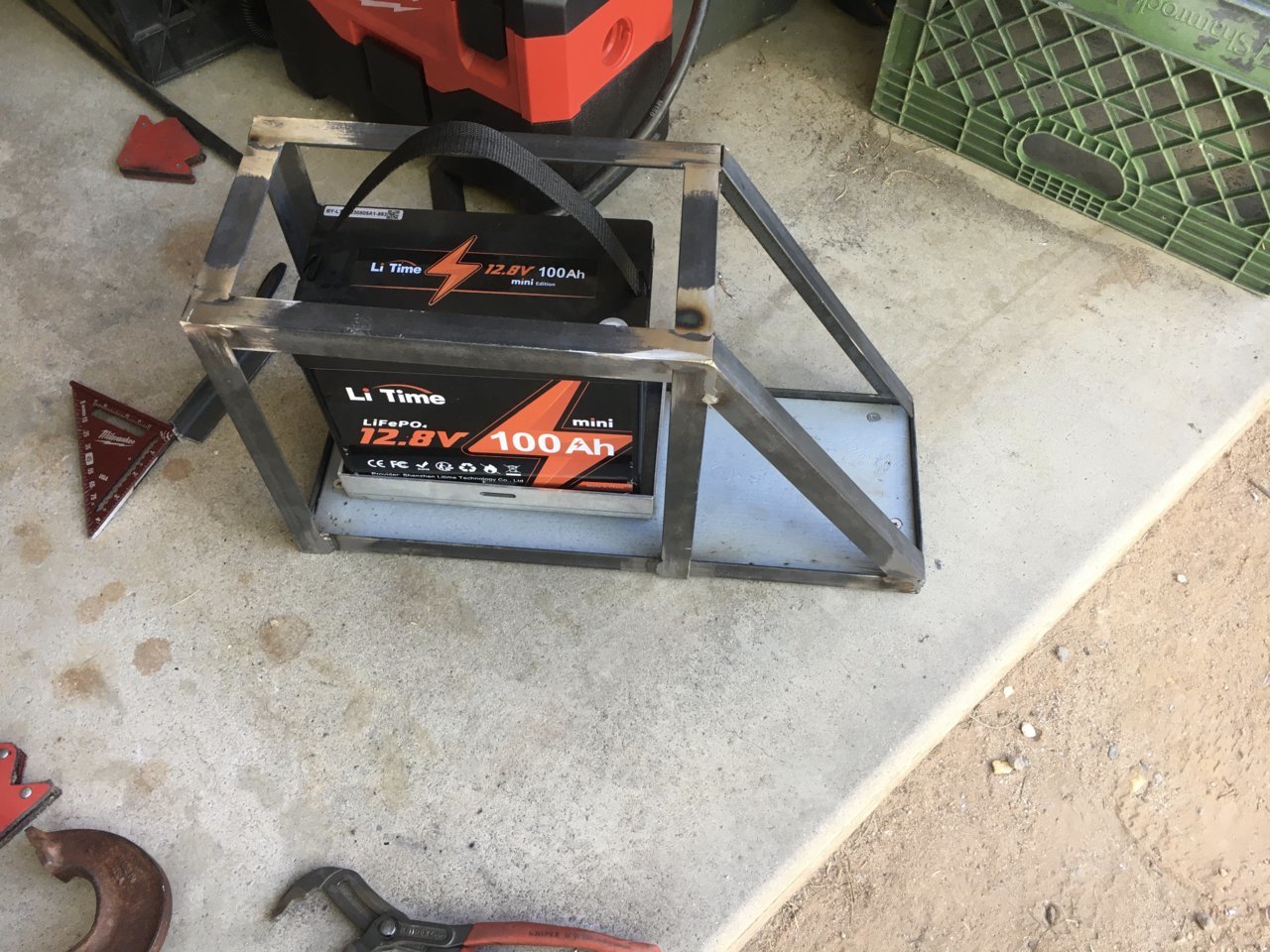

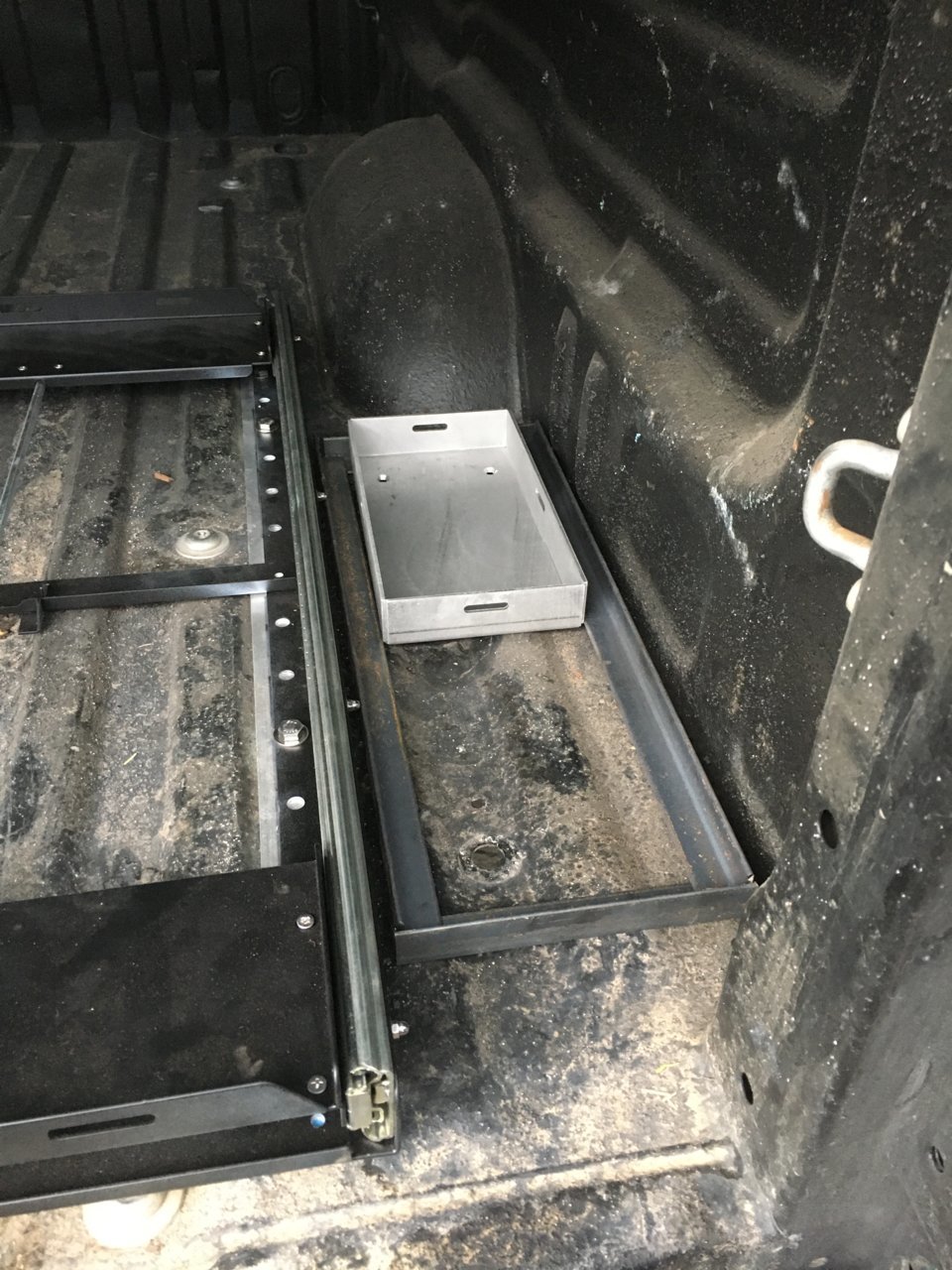

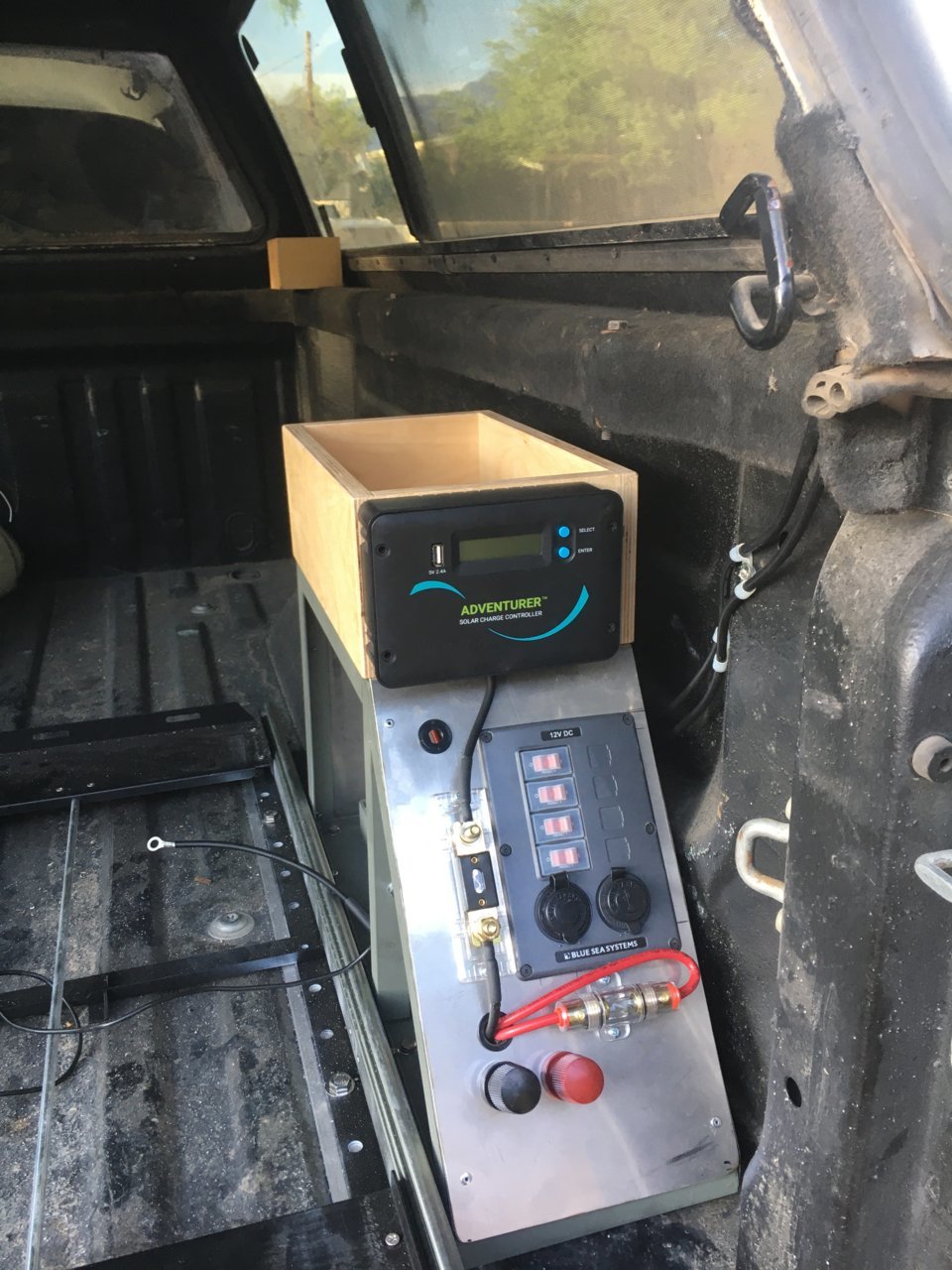

    This beaver has been busy, slow and steady. A week or two ago I embarked on a journey, I had most of the parts minus some custom fabing and wiring materials(I did good on my take offs; maybe 1.5’ of extra from each Ga wire I bought)
    2CD7305C-571A-4D98-AE39-87187608DD99.jpg First stages of mocking and getting everything as tight as possible

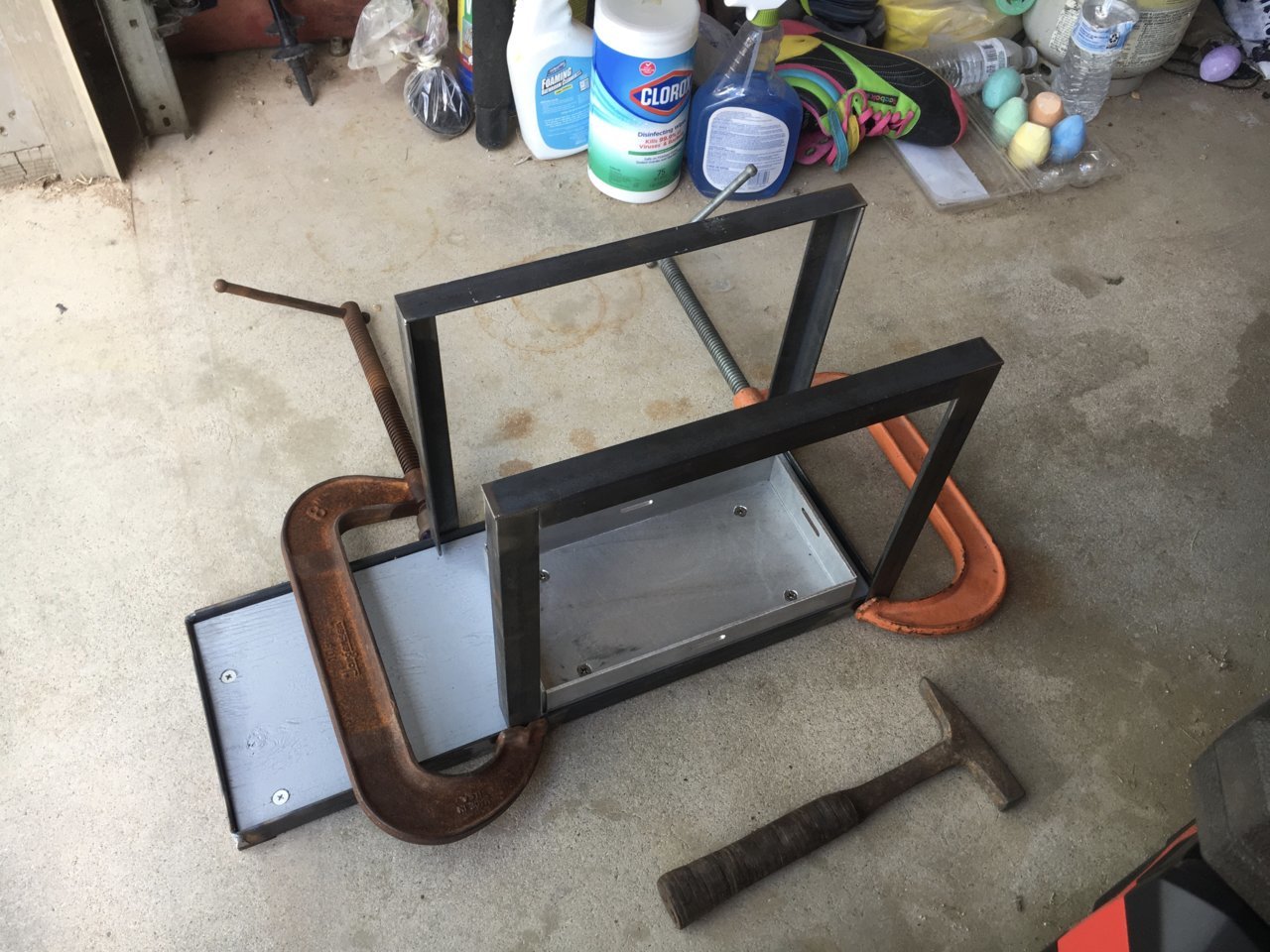

    563ED1FA-B0F4-4BF3-A4A8-52B7CD4E88A5.jpg Fabbing, messed up a few things and wasn’t as square as I’d like, but I already metal glued it together…..
    9BBCB662-3B89-4867-8581-92C10CFE4A50.jpg Skinned it with SS

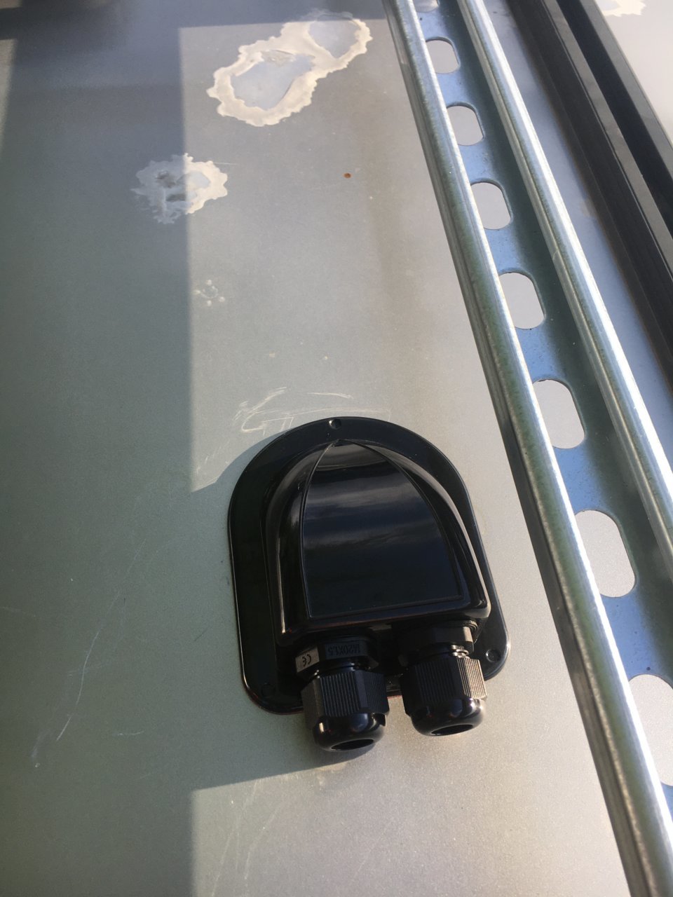

    02B78183-40B7-4F7D-81A2-DFD683540A02.jpg Roof penetration for solar wires

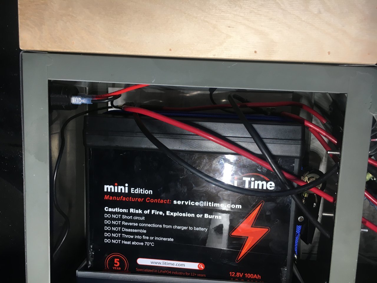

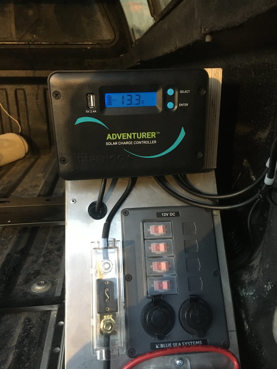

    24B2DF9F-6FC2-46FB-8C1F-50D1A53DDB96.jpg Even with some really really really ridiculously good hand yoga, my sausage fingers held me back some, but I managed to get it all where it needs to be(I’ll tidy up stuff with zip ties later) and nothing popped or sparked, I’m stoked to be done with the hard part!
    12v socket on the rear for my fridge, switch panel with 3 open slots,4th being the 12v plug and usb on the front. Fuse for battery from controller, and fuse for the switch panel,
    and two massive 3/8 lug/posts for me diesel heater. I’ll add my 12v regulator and wire in my vent fan later this week.

    I removed my flaps, and cut out the whole area underneath 'em.:sawzall: I couldn't reinstall my flaps if I wanted to.

    All this time I thought you were building a sliding fridge bracket.
    Either way I'm impressed.
