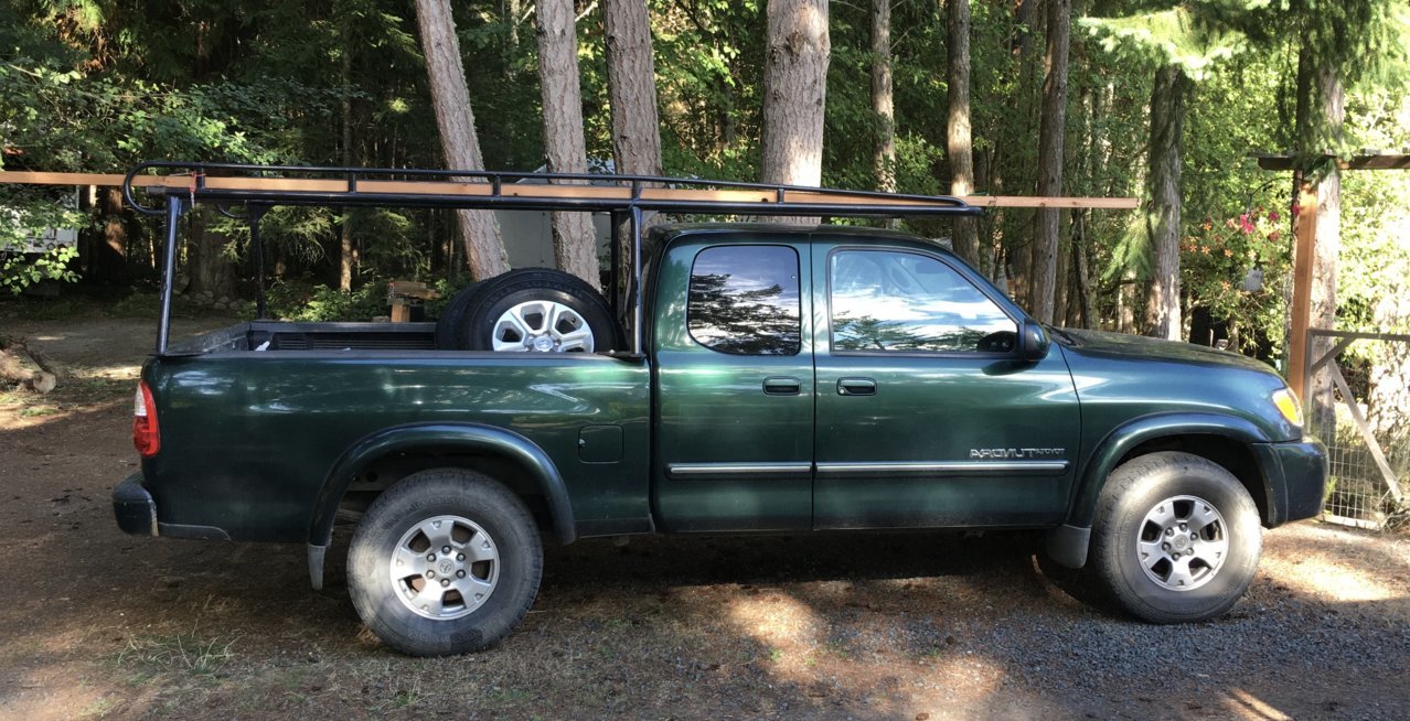

    Actually did something to the Tundra today other than use it.
    I picked up a set of 4Runner take offs last week, basically brand new as were the tires- nothing special, but I like the way they look on these trucks, and much better offset from the Tacoma wheels I’ve been running, maybe they won’t rub the frame ;-)
    Time will tell how I feel about the tires (factory Dunlop Grandtrek), they don’t seem that well reviewed, but I’m not that demanding either as long as they work well enough. They’re nice and quiet and smooth right now.
    I’ve had the same Yokohama Geolanders on the Tacoma wheels for a long time, couldn’t say how long but they were on my T100 for a few years before moving them to the Tundra 4 years ago, they have been good tires, they were rated for more capacity too, I have some heavy loads sometimes.

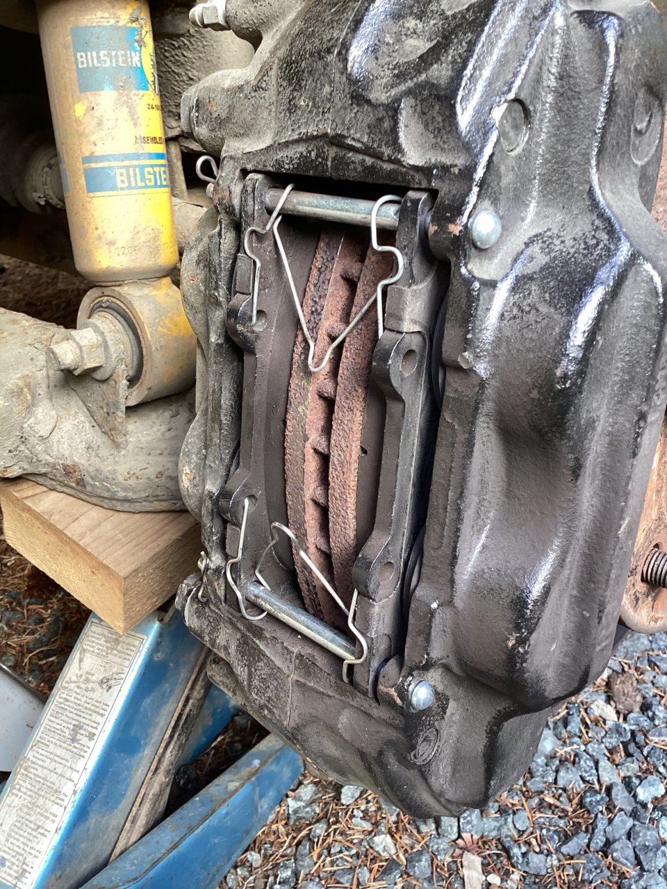

    Oh, also, I noticed the caliper pin spring rubbing the rotor, anyone else had this happen? I was able to bend it about, but it still barely cleared, is that normal? Never noticed before.
    Both lowers were missing too, not sure if I forgot them or if they both got torn off somehow… maybe that’s why I had two on hand.

    I'd bend it. I believe Toyota only put them on the top, because I added bottoms to mine... didn't see any observable differences to pad wear.

    Same, i'm running double springs. Feels like nothing, but i tell myself its making all the difference when i read about people having weak brakes.

    I run both springs. It keeps the pads from rubbing the rotor when they aren’t engaged. Does not improve braking performance unfortunately.

    Double springs here also. Adds at least 10hp. 'Nuff said.

    I’ve been hearing an annoying sound like a loose washer for some time now while driving, turned out it was this and what I was hearing was the pin rattling loose, I assumed it was supposed to have a spring and I forgot.

    I have double springs on each caliper. One actually came loose when I had to pop off my driver side knuckle to install my lift, and I didn't notice until I bolted up the caliper again. Had to unbolt the caliper to fix the damn thing and even then it was riding perilously close to the edge of the rotor so I bent it upward.

    Should be able to manipulate the springs with the caliper bolted on, no?

    Not the way it was folded over, nope. No way to bend it back. Would need to show you a pic. Imagine trying to install a new spring with the caliper on. Situation would've been similar. Or maybe there is a way to install a new spring with the caliper on and I was overthinking it. Letting the hooked ends go down into the caliper to hook around the slides/pins wasn't working. I know it looks like it could work, but it just wasn't working for me.

    Couldn’t you just slide the pin out?
