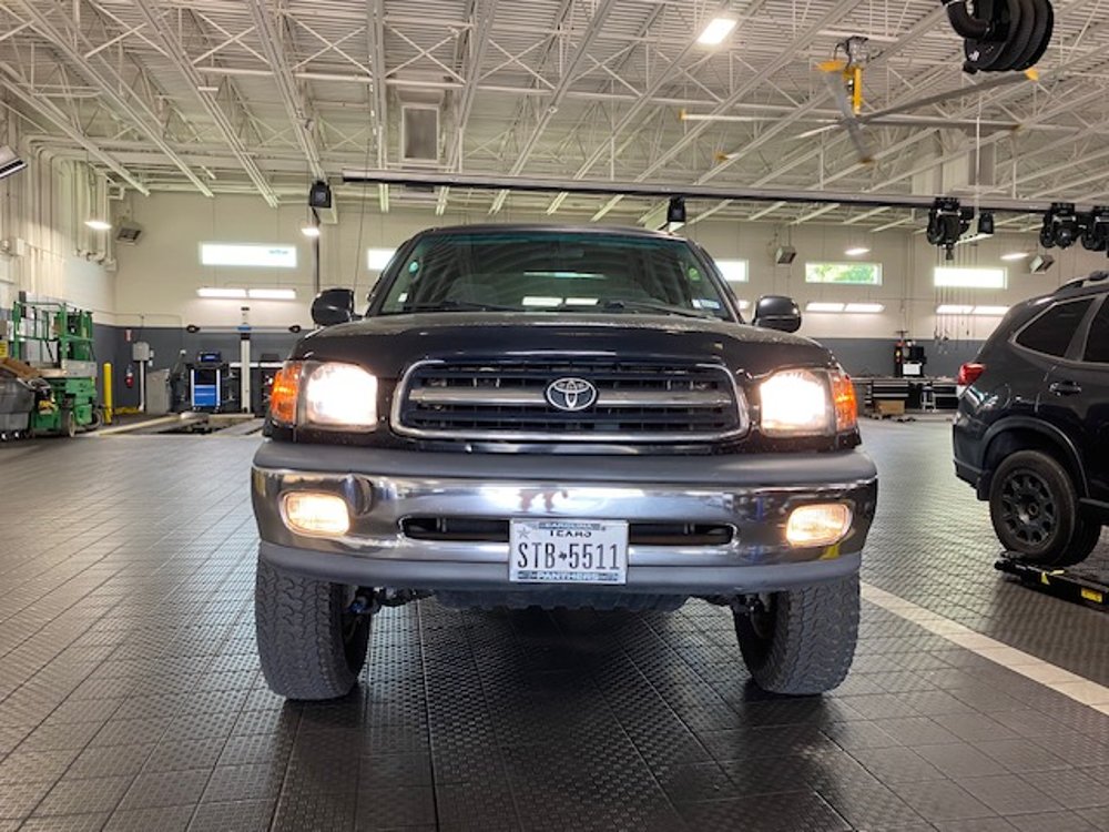

    Alright, I'm done :). No OEM switch yet, but I may luck out and come across one.

    Thank you. I think thats wax , no dents on front. What your seeing is a reflection of my gray t'shirt lol. Previous owner did put some scratches on passenger side. I try to keep it waxed and spray wd40 on inside to prevent rot. Fogs do help the peripheral lighting. Still some fine tuning to do. Who makes the best yellow fogs-non LED. PIAA?
    Any help in your guys favorite yellow fog lights would be appreciated.

    I had some piaa yellow bulbs. They were. Fine. Not sure which is better

    It is claimed that yellow is better for visibility in fog, but where I live, we don’t get much fog, so therefore I just use them for the extra light

    I'm coastal so we get fog especially in winter.
    I've got 4 yellow LED pods now.

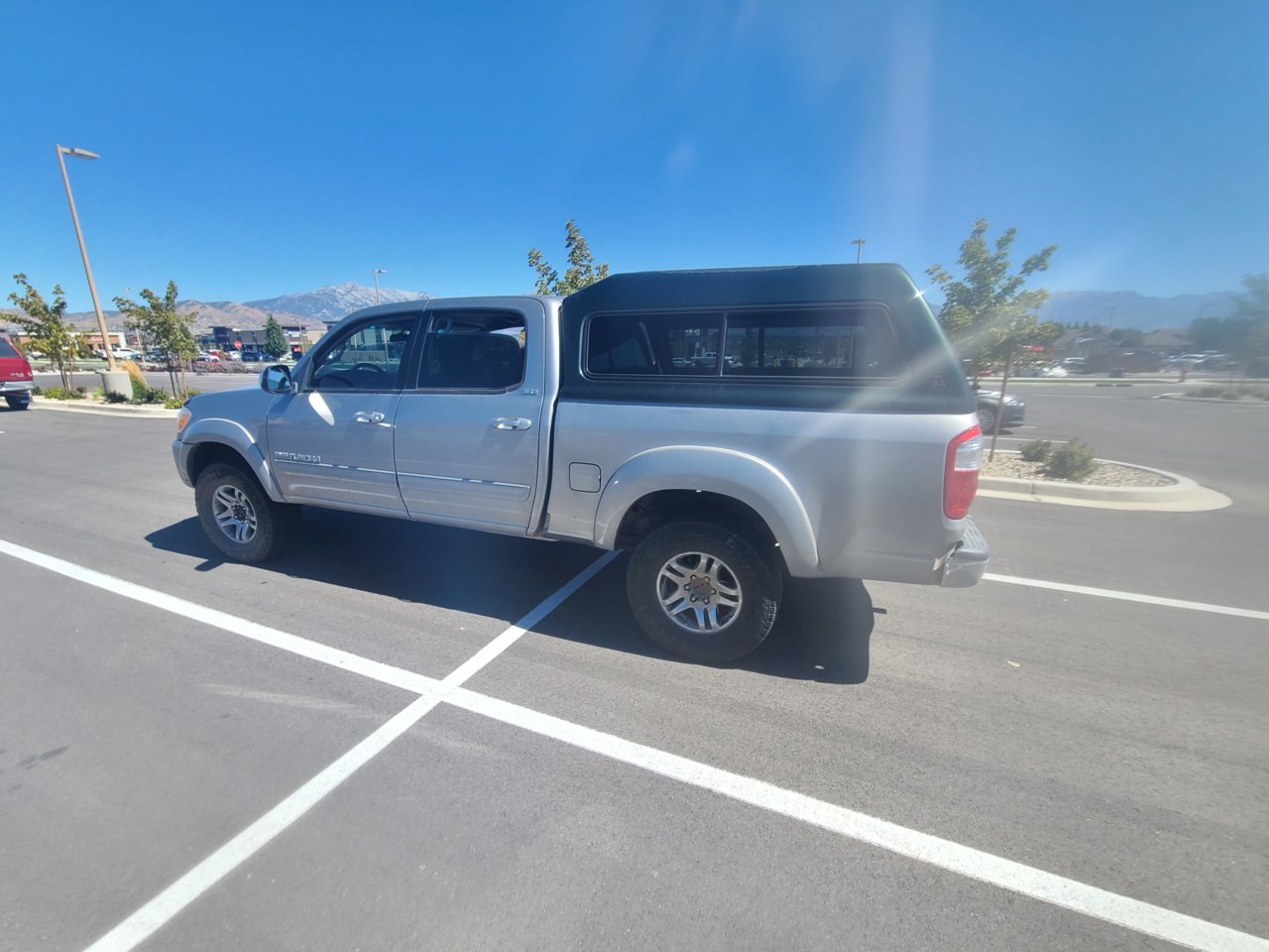

    Been looking for almost a year for a decent used cap in my area. Almost threw down for a new A.R.E MX a couple months back, but decided to wait. Finally found a good condition raised height Leer topper on the local classifieds for $500. Somehow I lucked out and called first and was able to head right over immediately and grab it.
    Nice birthday present for the ol' girl turning 150k today.

    Awesome. Got any more pics of the camper? Lights/wiring situation? Windows all work? Got keys? If you didn’t get keys, I learned recently that you can just order the key number (usually visible on the cylinder) instead of buying whole new handles/locks.

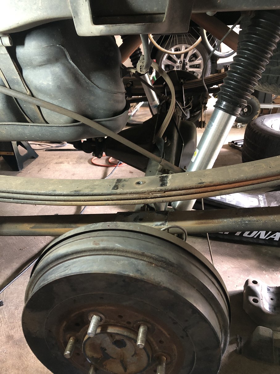

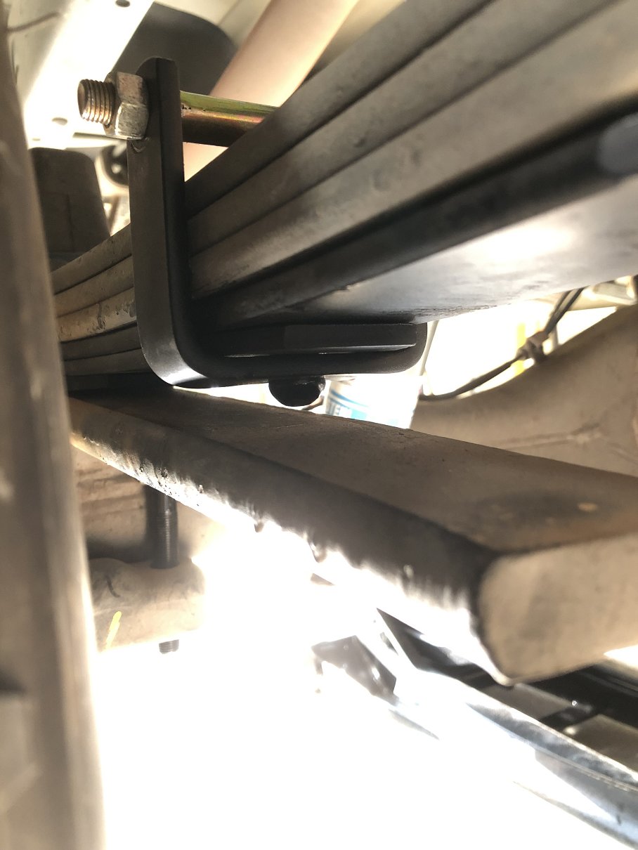

    Icon AAL is installed, with overload despite the warning in the instructions "that's not intended", but no post-install pics until tomorrow. Still need to torque down several bolts (wheels, lower spring mount, u-bolt plate, etc.) then go somewhere to shoot pics.
    I'm not happy with where the rivet on the AAL pack would contact the overload (pic below). I'm gonna get a few friends to sit in the back in the coming days, try and get 500-600lb back there and see if the rivet head hits the OL or not.
    Numbers look good at the moment. I guess I'll re-measure after getting the truck out tomorrow. It's a good thing I left the overload in, or I'd be almost dead level and that isn't what I was looking for here ...
    Looking like I've got about half inch of rake rear to front. And weird how the passenger rear is sitting half inch lower; gas tank is on the driver's side ...
    Edit: Here's the rear before-AAL measurements -

    Pic of that rivet and the overload:
    Oh, and a mid-install pic for extra credit.

    I know it's apples to oranges here, but I had the wheelers AAL on both my Tacos with the overload.
    I didn't use the overload when I installed the wheelers AAL on my Tundra, because flex

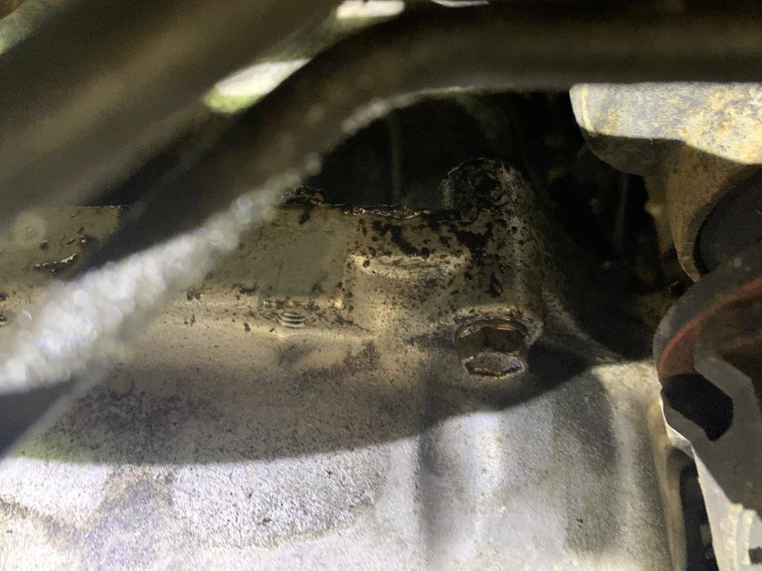

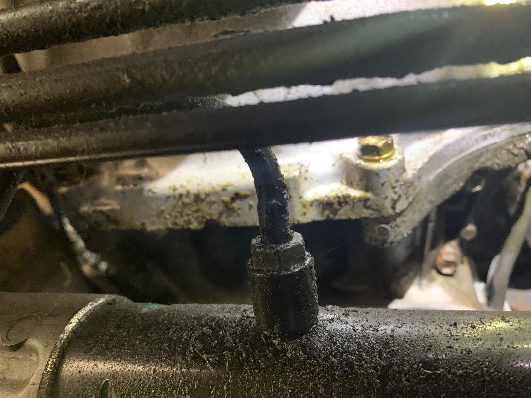

    Pull the Tundra from the pole barn to stretch it's legs today, thought I'd crawl under it (it's been a while).
    Looks like I've got some work to do at some point -
    this one I found interesting -
    Thoughts?

    Valve cover gaskets. Shoot us some pics of the flange that sites between the valve cover and manifold on both sides.
    No clue wtf is up on top of the intake.

    Talking more about the oil drip looking things on top of the bolt head, and in misc spots on top of intake. Almost like someone checked the oil directly over the intake manifold, and dripped oil all over.

    I thought that too but I haven't done that. I may have set a rag up there or something though.
    I was like what the, that's odd.

    Is possible a mutant rat took a brown oily pee up there for sure!

    Will do, I'll take a few before I cover it up this evening.
