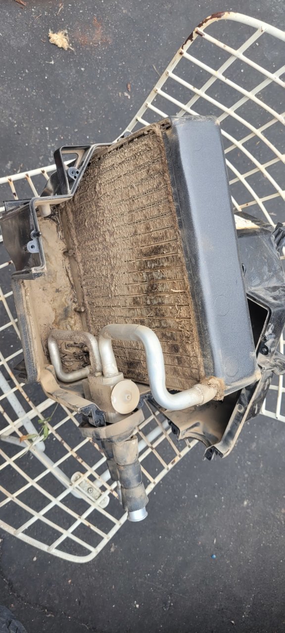

    Your AC had to be non-functional

    I guess I'll give mine a look, dusty as hell 'round here.

    That's crazy. Years and years of driving in dust. Are you replacing it or just doing a deep clean?

  8. Sep 3, 2023 at 12:27 PM

  9. Sep 3, 2023 at 12:45 PM
    shifty`
    shifty` Inside his chest they found ten thousand pencils
    Jun 20, 2020
    #48239
    30,585
    ATL
    '06 AC Limited V8/4WD
    Holy shittle, you were growing a miniature desert in there!

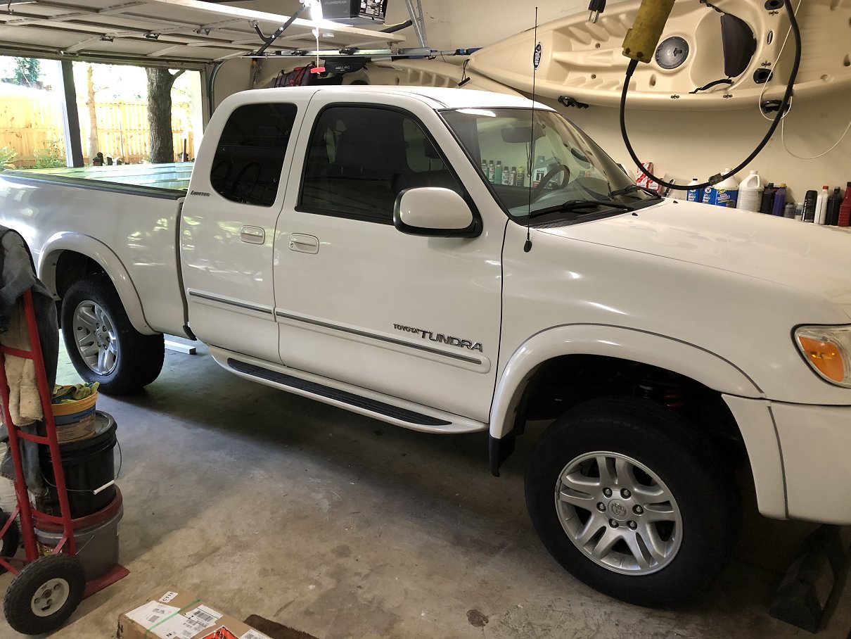

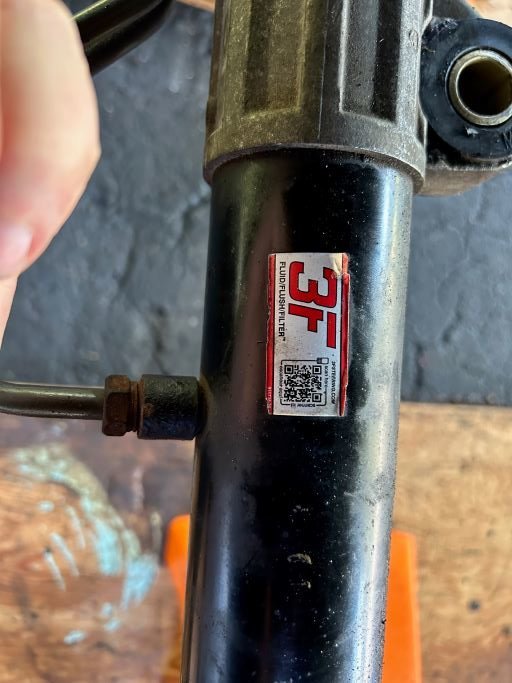

    So I decided to install my upper and lower control arms this weekend. While I'm at it, this would be a great time to install my new Bilstiens as well. It turns out I have to drop the rack to get to the rear cam bolts. While I'm at it, I may as well install new rack bushings. While the spindles are free, I may as well install new upper ball joints (bought them on sale...just in case). And a good time to install that steering shaft seal as well. Easy peasy, right?.
    4 days later...
    - Thank god the upper ball joints were still nice and tight (been watching @shifty` s trauma with the UBJs). Pain and suffering postponed for another day.
    - I knew that I would have to saw the lowers off, but nothing prepared me for just how big a pain this would be! It's easy if you have a lift (like the numerous YouTube videos), but when you're up on jack stands there's not so much room. Hours of contortion.
    - I knew Diablo blades were the best, but I did not anticipate how quickly they would wear out. 3 trips to Home Depot, and I finally returned with Diablo Carbide Blades for thick metal. I burned through 4 of these:
    https://www.homedepot.com/p/DIABLO-...hick-Metal-Cutting-3-Pack-DS0908CF3/207192133
    - I used anti-seize on the new cam bolts. Why doesn't Toyota do this at the factory?!
    - It was a great time to remove and treat rust that I otherwise would not have been able to see or reach, so that added some time.
    - Turns out that my rack is not OEM, but must have been replaced by a prior owner. Never heard of 3F before.
    - I did remember put the tires back on and drop the truck to the ground before torquing down the upper, lower, and strut bolts.
    - Quick test drive was uneventful. Didn't want to go far until I get an alignment. But the new steering shaft seal is AMAZING! Sofa King quiet!! Well worth the effort.
    I wonder if I can find an alignment shop open tomorrow?

    Tonto cover
    It had much to be desired for awhile but would still cool. Gonna blow ice cold now hopefully!
    Just a good cleaning with a soft toothbrush and some dish soap and water, gonna foam it in the truck later on. The top layer of junk came off in a sheet almost. I did replace the thermal expansion valve on it with a Denso unit. Trucks all back together now and will try to get it recharged tomorrow if the shop is open.

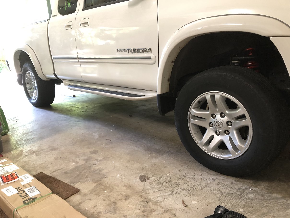

    Can't shakedown test to see where I land 'til I run to the LAPS for grease. I didn't realize I was at the end of my tube, can't grease the new UBJs. Ah well.
    Probably get to it tomorrow. Gonna hold off on the AAL. I suspect I'll probably land within 1/2" of level.

  14. Sep 3, 2023 at 4:04 PM
    DJenerated
    DJenerated Roads? Where we're going, we don't need roads!
    Mar 6, 2023
    #93302
    2,797
    Dija
    The Lone Star State
    Good job buddy. I knew the second side would be easier haha. Always is.
    I drove about 30 minutes before I realized I didnt put any grease in my SPC UBJs. They're still holding up alright. Lol
    shifty`[QUOTED] likes this.
  15. Sep 3, 2023 at 4:58 PM
    shifty`
    Jun 20, 2020
    #48239
    30,585
    ATL
    Thx. After having two kids, I've got the patience of a saint in most nooks and crannies of my life. I can wait a day.
    Second side only took 2ish hours, and I was definitely way more methodical. Honestly, I'm just sore af at this point. I definitely had to use muscles I'm not working out or utilizing in any regular sense. Traps, lats, erectors mostly.
    Let's see who is open tomorrow. NAPA has a special, Valvoline Palladium #3 is on sale for $3.99/tube for some reason, so I bought 2 tubes for store pickup tomorrow, and beat scAmazon's price of $13 by nearly 50%. I'll be shocked if it's actually ready for pickup tomorrow :rofl:

  16. Sep 3, 2023 at 6:48 PM
    Mr.bee
    Mr.bee King Turdra
    Jun 4, 2022
    #79178
    6,424
    SATX
    '02 AC TRD
    the ATL squat. You're a trendsetter.
    txagg, abcinv, bmf4069 and 1 other person like this.
  17. Sep 3, 2023 at 7:11 PM
    DJenerated
    Mar 6, 2023
    #93302
    2,797
    Dija
    The Lone Star State
    Much better than the gangsta lean to the driver side. I've had that on a few trucks before. :oops::D
    The only thing the turd gens got right imho is moving the gas tank to the passenger side.
    shifty` likes this.

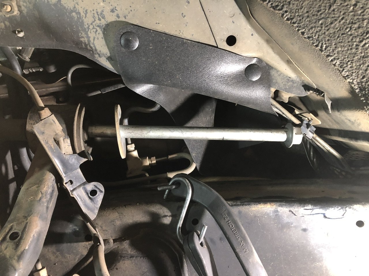

    Oh this was another fun one from the drivers side I had no idea I’d be up against. I’ve never heard anyone complain about it. UCA pivot bolt smacks into the brake line cluster. This just seems like poor design to me. Apparently my lines aren’t seated correctly either. The little clip isn’t in its spot. Even if it was, the head of the bolt still hit it and made it nearly impossible to get the damn fastener out.

  20. Sep 3, 2023 at 7:46 PM
    FirstGenVol
    Dec 13, 2018
    #22934
    14,347
    East TN
    2002 AC TRD 4x4 V8
    Yeah it's a pain. I broke that little plastic clip on John's truck. It was brittle from old age. Toyota charges out the ass for it too.

  22. Sep 3, 2023 at 7:59 PM
    shifty`
    Jun 20, 2020
    #48239
    30,585
    ATL
    Boooooo. Surely there has to be a better way, to relocate or something. Did Toyota really make these into rollers with suspension on the assembly line before they got the brake lines installed? It makes no sense. Surprised nobody sells a relocation kit or something. Even if it’s just moved 1” toward the center of the truck it’s solve the issue.
    What I can say, with the SPC arms, if you push the bushing insert outward on the headlight side, it gives you a little extra play, which gave me just enough to send it home. Once the pivot bolt was in, pushed the insert back to flush again, and done.
  23. Sep 3, 2023 at 8:00 PM
    shifty`
    Jun 20, 2020
    #48239
    30,585
    ATL
    I didn’t. And at full droop, wheel on, there’s still slack. I’m not opposed to installing braided lines, my lines are a little dry, crusty.
    It’s the damn ABS sensor and bracket that had me concerned. Not enough slack for my comfort.
    des2mtn likes this.
  24. Sep 3, 2023 at 8:05 PM
    DJenerated
    Mar 6, 2023
    #93302
    2,797
    Dija
    The Lone Star State
    Wheelers has em. They often run sales on em too
    I think they were free one black Friday with purchase of front and rear suspension parts
