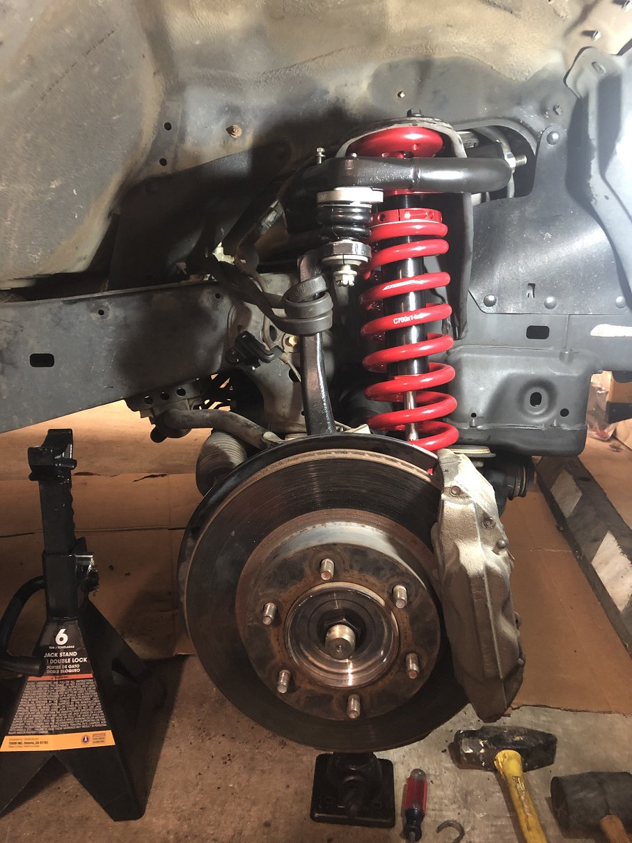

  1. Sep 2, 2023 at 7:42 PM
    des2mtn
    Jul 1, 2020
    #48721
    4,659
    SW
    2004 Black DC Limited 4x4
    Tonto cover
    Hmm? I've never had to mess with either to get the shocks in or out. If you're not loosening the LCAs, with the sway bar disconnected you should be able to pry down on the LCA to get the lower shock mount in. I'd just loosen the LCA bolts since you're going to need an alignment anyways.
    FrenchToasty likes this.

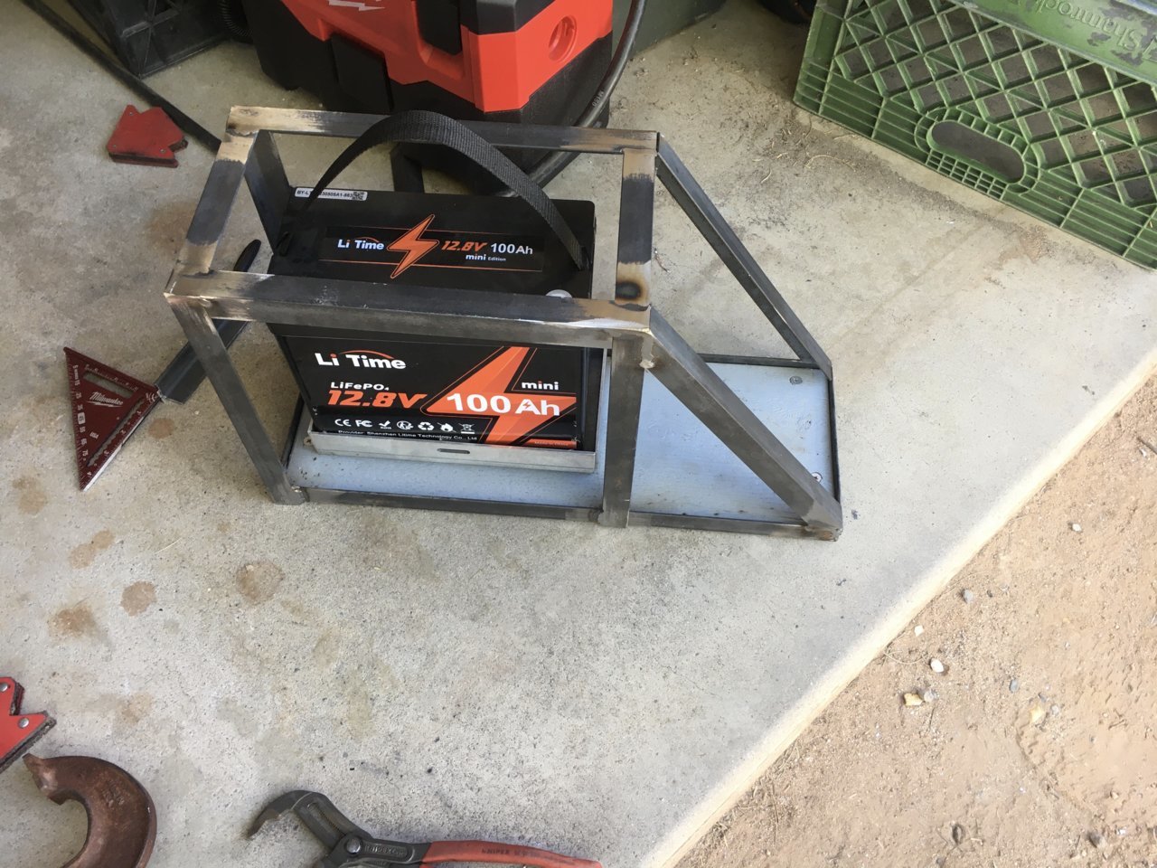

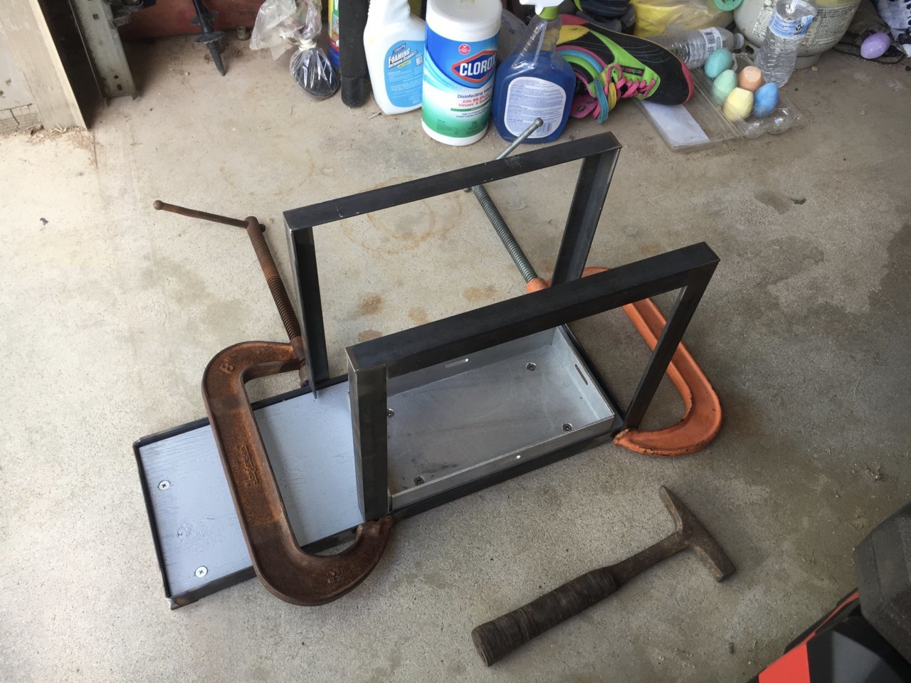

  2. Sep 2, 2023 at 7:44 PM
    FrenchToasty
    Sep 15, 2019
    #36156
    18,609
    Mo
    The SoAz….. big surprise
    Bone stock
    A98A87AF-9FEC-40FD-A6AF-49A34158CA5D.jpg F56CFC55-7A18-48EA-B55D-F8C4637C6B2F.jpg
    It warped a little, it wasn’t the easiest and I made mistakes. Tomorrow I’ll bolt
    It to the bed and get it skinned hopefully.
    Safety flops welding was fun, I actually burned my fingernail digging a spark out of my flops!!!
  3. Sep 2, 2023 at 7:44 PM
    shifty`

    '06 AC Limited V8/4WD
    TRE is limiting any further downward travel while prying, at the joint where it meets the LBJ and I've still got an inch to go.
    Maybe it's a DC vs. AC/RC suspension articulation thing?
    DJenerated likes this.
