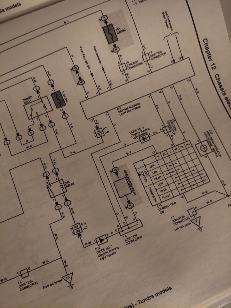

    Yeah, with a DRL truck, don’t attempt any quick fog anytime mods such as feeding parking lights into the switch input.
    probably the first step is probing the switch to see if it’s power or ground switched. Two wires are parking lights and dash illumination negative, should be easy to identify those. The other two are input and output.
    Personally, given the headache and cost, I’d just go with an independent harness and skip the OEM fuse and relay. Wiring on these old trucks is weak anyway.
    I’m not sure how to do it safely. All I know is that the easy way was not safe and blew up my integration relay.
    I plan to use a Switch-Pros for my two front pods and the rear set. If I ever get time to do wires.

    Unplug DRL connector kills DRL on my truck.

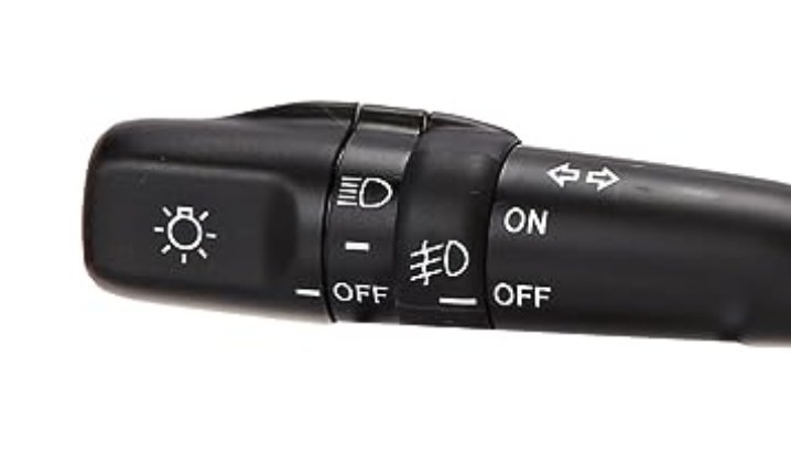

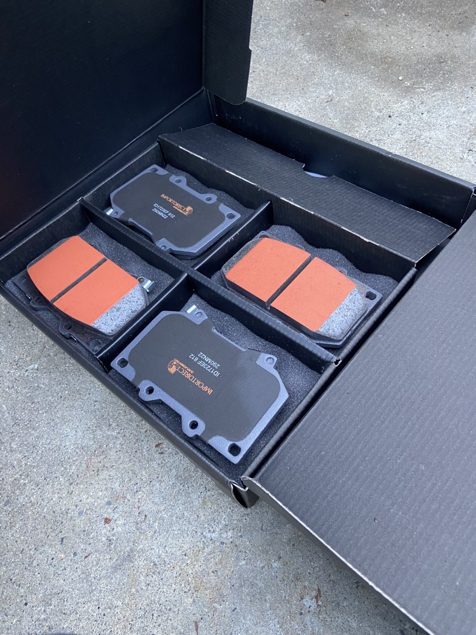

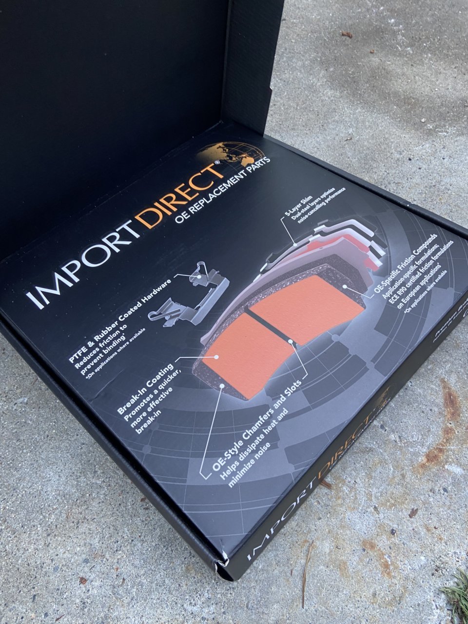

    I’d really just like to get a sequoia stalk with fog lights on the stalk. I actually do have a sequoia stalk with an auto option but don’t think it has fog lights and I sent it to Johnny years ago to see if he can dig up the connector for it. Haven’t taken my dash apart yet as far as the wheel goes. Someday.

    Damn thanks for hitting me back. Well far from dumbest thing ive done. Lol. Yea between the dimmer /drl/ alarm tied in that was designed late 80's. I think making symple circuit is best bet. I think i will just forgo whole thing for now. So nobody has really ironed that oem mod thing out for the first gens? Surprised.

    I think the 03+ also have the fogs on the switch. Mine does.

    Yes, if @Puppypunter ever paints the insert I bought for it. Some guy 3D prints one, I can try to find it.
    I’ll hunt for a part number but silly me wanted auto or at least DRL on the stalk as well as fog lights and then the dash indicator working for fog lights as well. Quite a tall order, hence my lack of progress. A Switch-Pros would really just get it done. And since I have two pod spots now, I’d either need to auto toggle w high beams or tie in the middle pair as DRL / high or … and I guess have the selective yellow override them. So the automation is all tbd too.

    Ditto on my '06. @daveeasa I looked up the p/n for my stalk: 84140-0C050 <---- (Don't use this link, it was auto-inserted. If you order OEM parts from scAmazon, you're gonna get ripped off!)

    It definitely looks super clean. The one I have is used but has Auto, don't remember if it has fogs though. I definitely want fogs if I'm swapping the stalk, but getting it all pinned and wired up, that's time.
