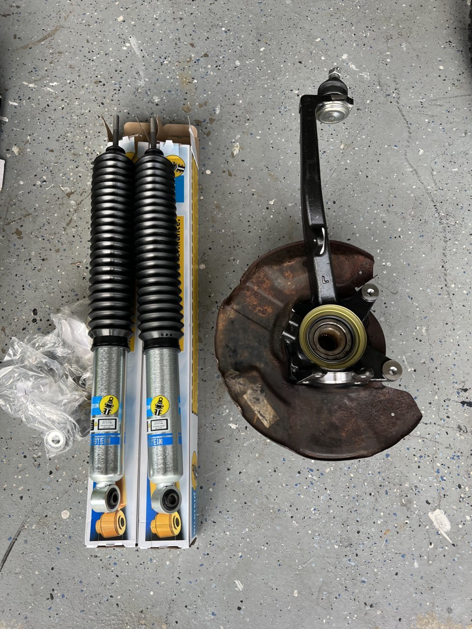

    Little project for tomorrow. New steering knuckle and bearings as well as new Bilstein 5100’s for the rear

    Where’d you get that knuckle and what’d it set you back?

    I looked everywhere and most new knuckles were around $300-400, put the part number in on Amazon and found one for $200 shipped new. The bearings and seals cost almost as much as the knuckle, Napa bearing was $135 than seals retaining clip were about $50. Local shop pressed and assembled the unit for $195. Not cheap, didn’t have to do this but I broke a lower ball joint bolt in the steering knuckle and couldn’t drill it out. There was nothing wrong with the truck to begin with, just trying to freshen up the front end. Guess the old saying is true, “ if it ain’t broke don’t fix it” lol

    Big ouch. The OEM Koyo bearings were $80 each. The seals were $20 each. I have yet to attempt this as I have not found a shop willing to do the pressing and I only have access to a 20 ton press. Tempted to buy some new knuckles to press the new bearings in and have them ready for a hot swap.

    $75-$77 on a bad week

    I want to replace my knuckles because they take up a lot of front suspension real estate and mine look like crap with the surface rust. I know I could just Ospho and paint them like I did the frame and rear axle, but I kind of want to start “fresh”. Wish someone sold a ready-made kit.

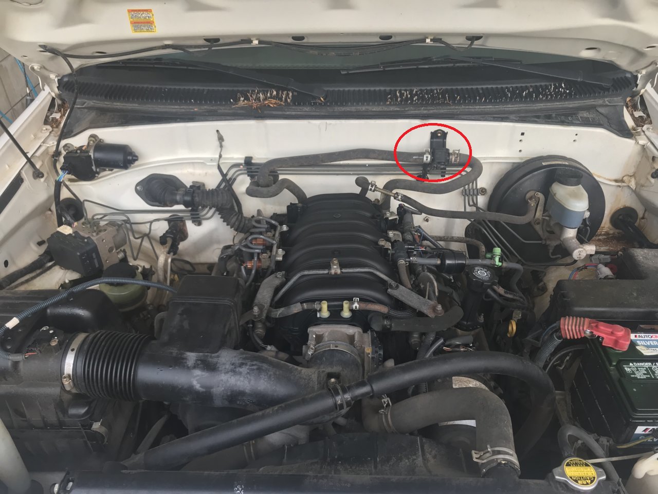

    Weird on the damn coolant. Did you notice it was low prior to refilling, i.e. was the reservoir empty or anything?
    No heat + no air in the rear ... Sequoia doesn't have the mechanic center dash like we do, right? Are their climate controls in the rear, maybe a fuse for the rear also?
    I was going to say, "Controls binding issue" and maybe the heat/cool knob wasn't working, and the vents weren't engaging out back via the front, but I keep forgetting the system is different. Chances are with the heat, it's not activating the control flow valve (that pipes heated coolant into the heater core) bolted on the firewall, OR that control valve is just ... shot. I'm sure the seller knew about both issues...

    I noticed that the heater core does not self bleed easily, next time you run it give the in/out lines on the firewall a good squeeze along the length of them. That will help force any air out of the heater core.

    Yeah, this little bastard, right? (not my pic, not my truck)

    Yep. All three of those lines were holding a good amount of air for me. line 1-From the head to the heater control valve, line 2-from the heater control valve into the firewall/heater core, line 3- out of the firewall/heater core back into the head. Makes sense since they look to be the highest point in the system.
    Another note on cables:
    The cable for the heater control valve runs through the upper right side of the drivers footwell and through the dash. It's easy to manipulate the valve open and closed form the firewall if you think that that the cable might be the issue.
