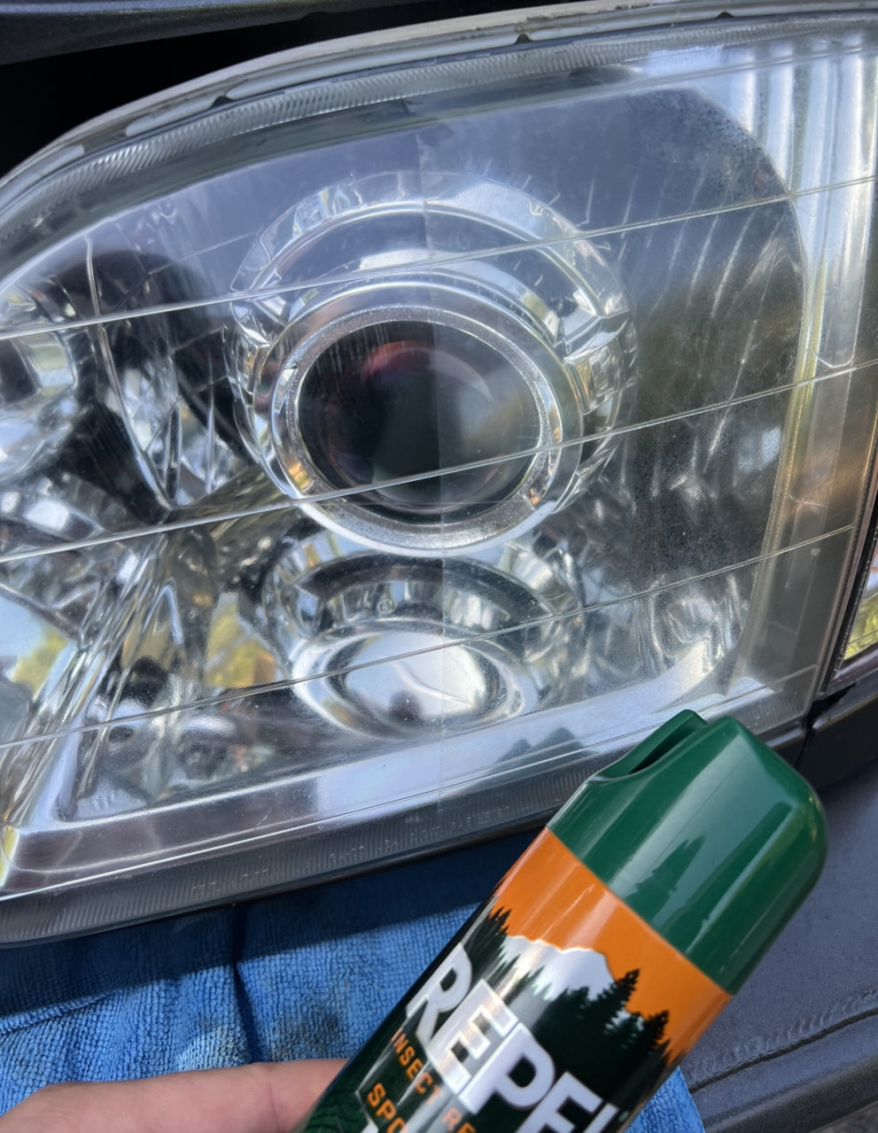

    Basically the equivalent of doing the same with WD40. Gone after 1-2 washes or showers.

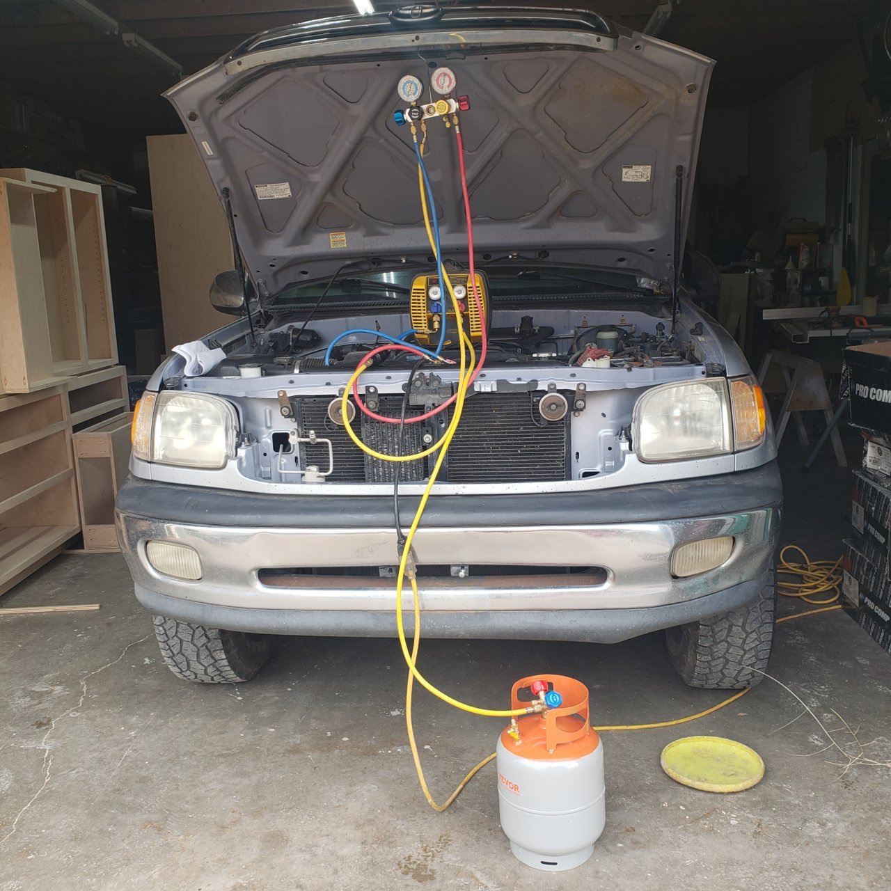

    Its about 20 degrees cooler than it has been this evening so I figured I would evacuate the refrigerant so I don't have to deal with it while doing the timing belt and swapping on the new compressor.
    Only recovered about 4oz so its likely got a leak somewhere. I have a seal kit and some dye in stock so I'll chase that ghost after I get it back together.

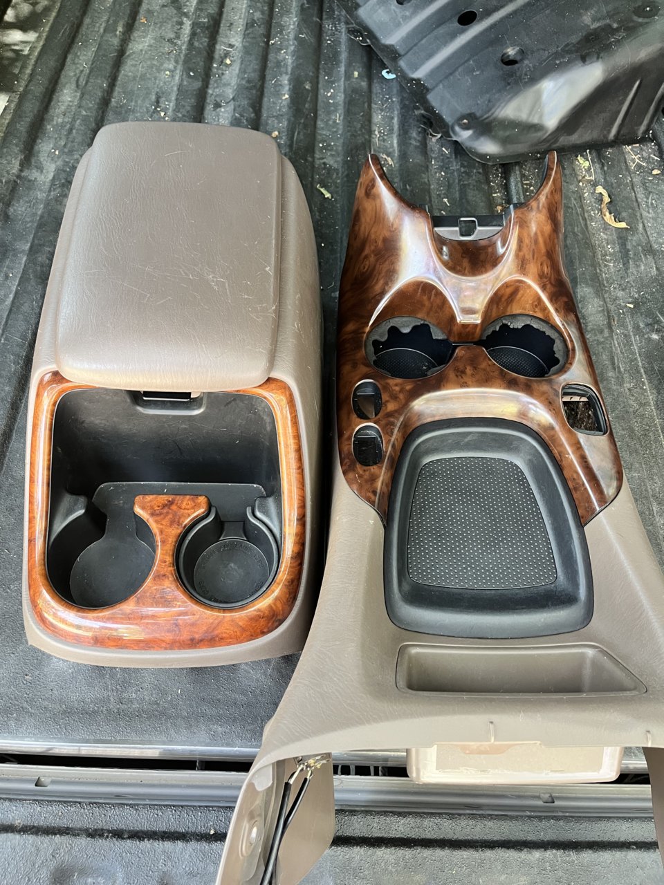

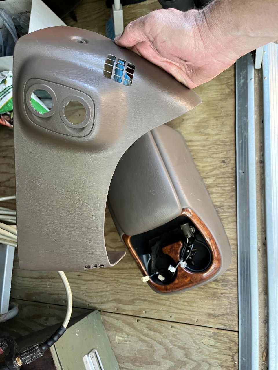

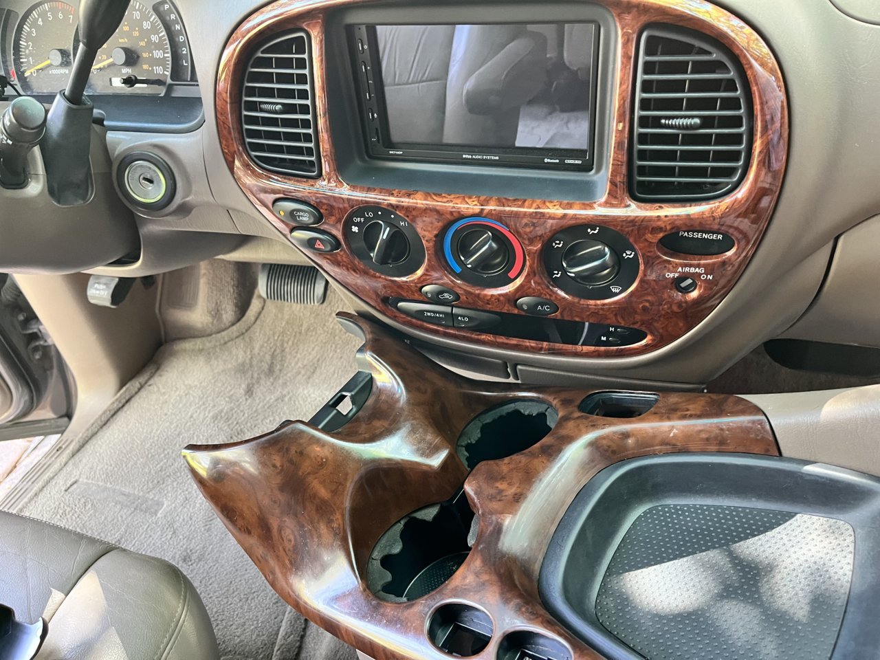

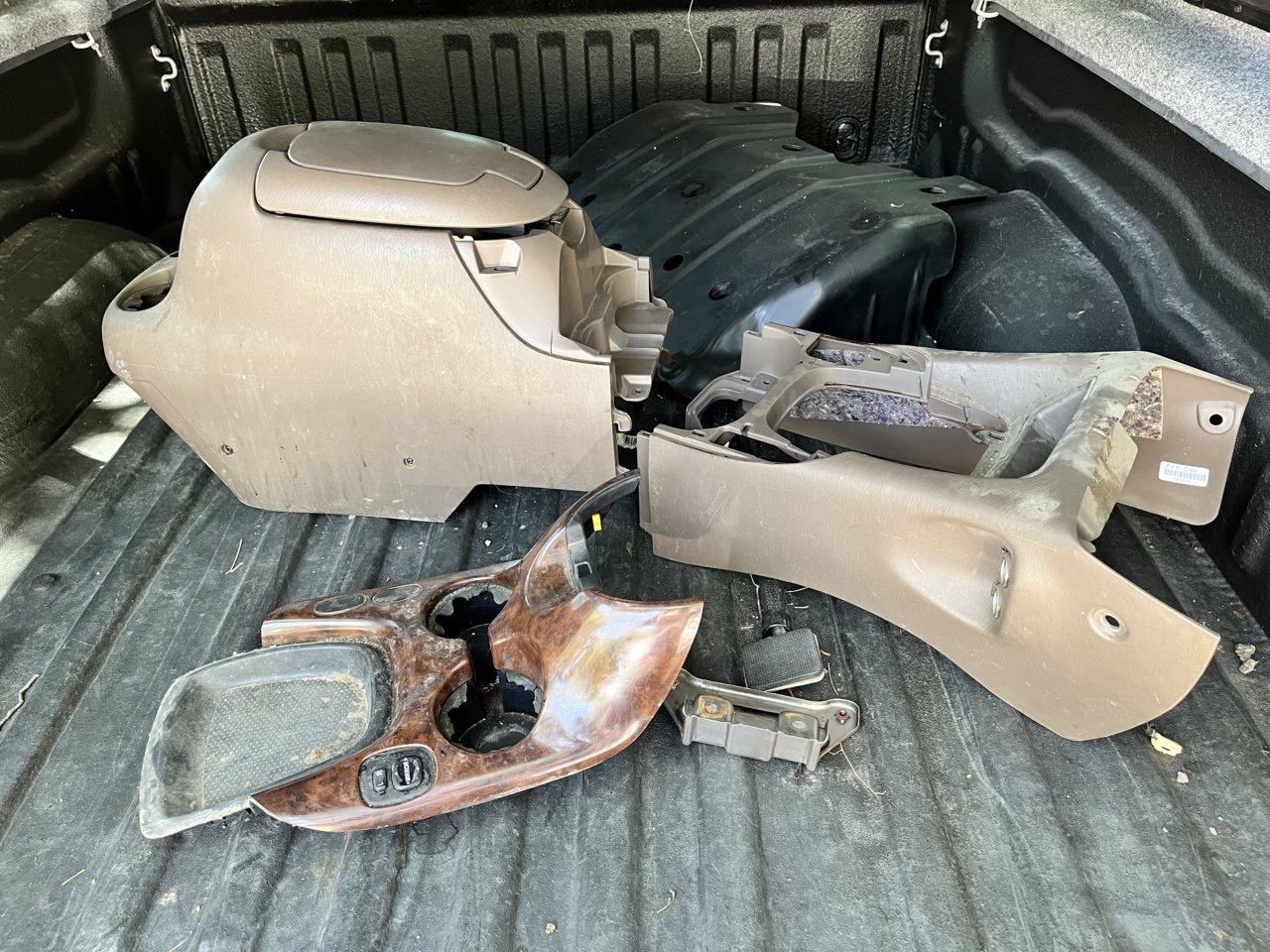

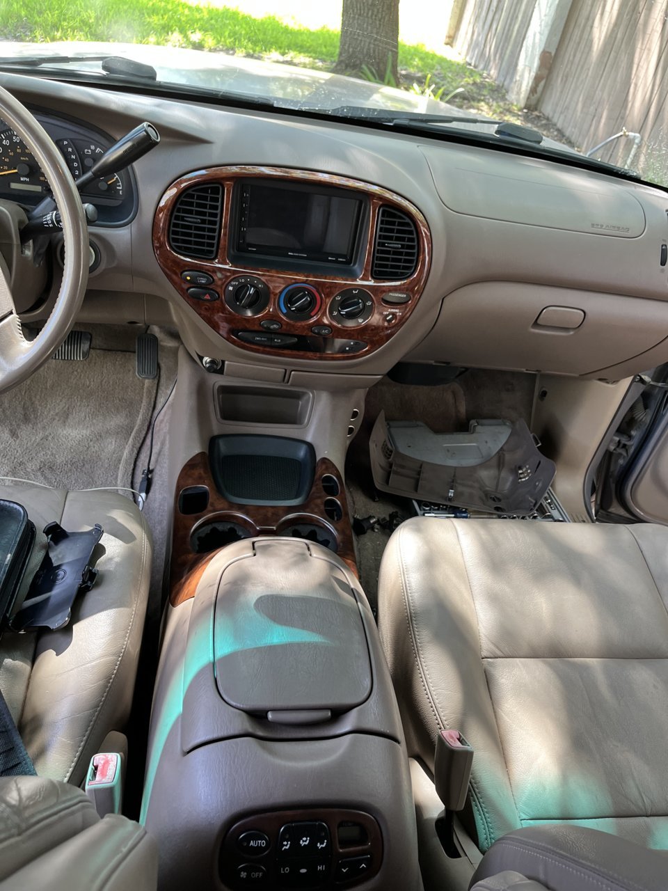

    Ok so that was a relatively easy upgrade. Wood grain is close enough match for the girls I date. I think @shifty’ observed that not all years’ wood grains were the same—he’s right.

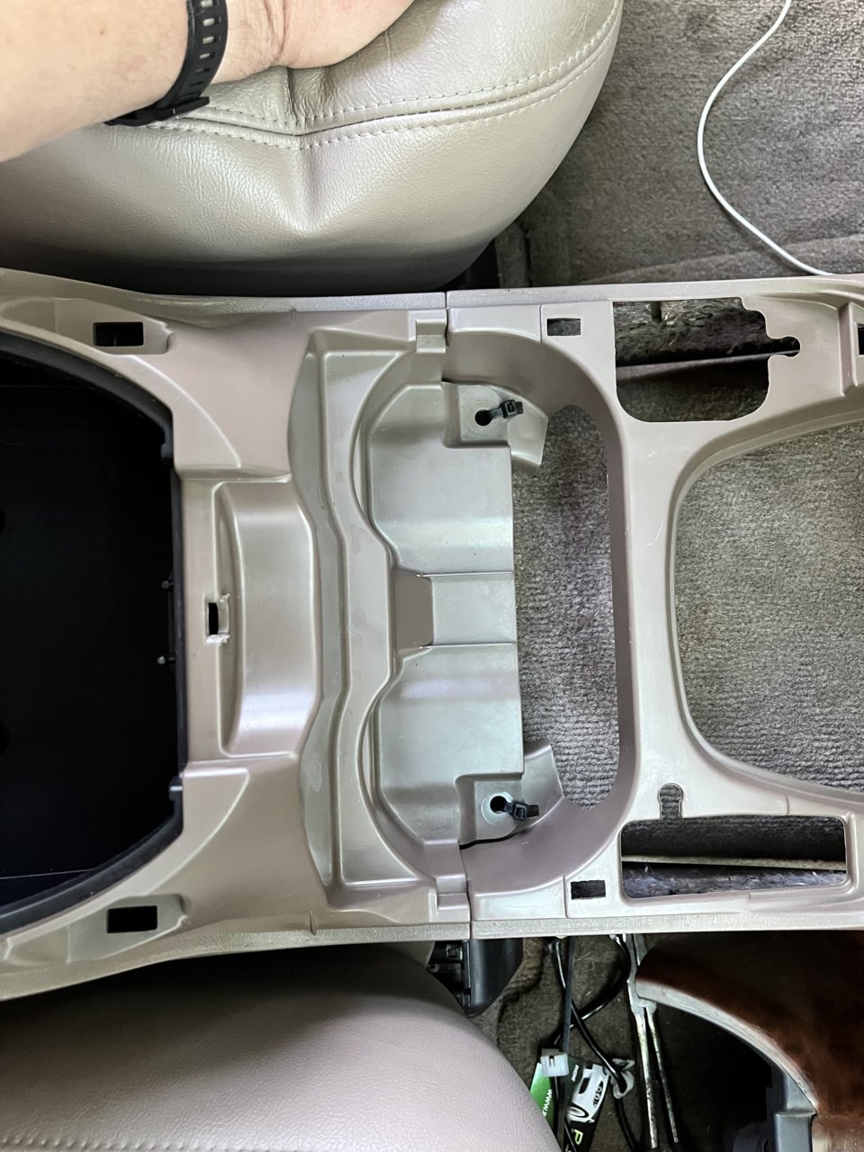

    As others said in the Sequoia swap threads, only the “rear” bracket you take off the Sequoia will be useable. The front has no attachment points except up under the dash, and those are just the plastic “push screw” fasteners. I used some zip ties to tie the two pieces together in the middle just to give it some stability since my hardware collection turned up nothing useful to bolt the two pieces together since I couldn’t put a screw into it.
    A pic of removing the old original one; four 10mm bolts:

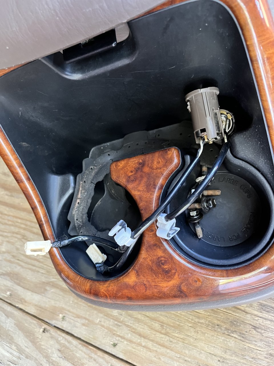

    Some more pics below. Tried to flip the weird foam drink holder things over to the less ugly side but they’re only one-way.

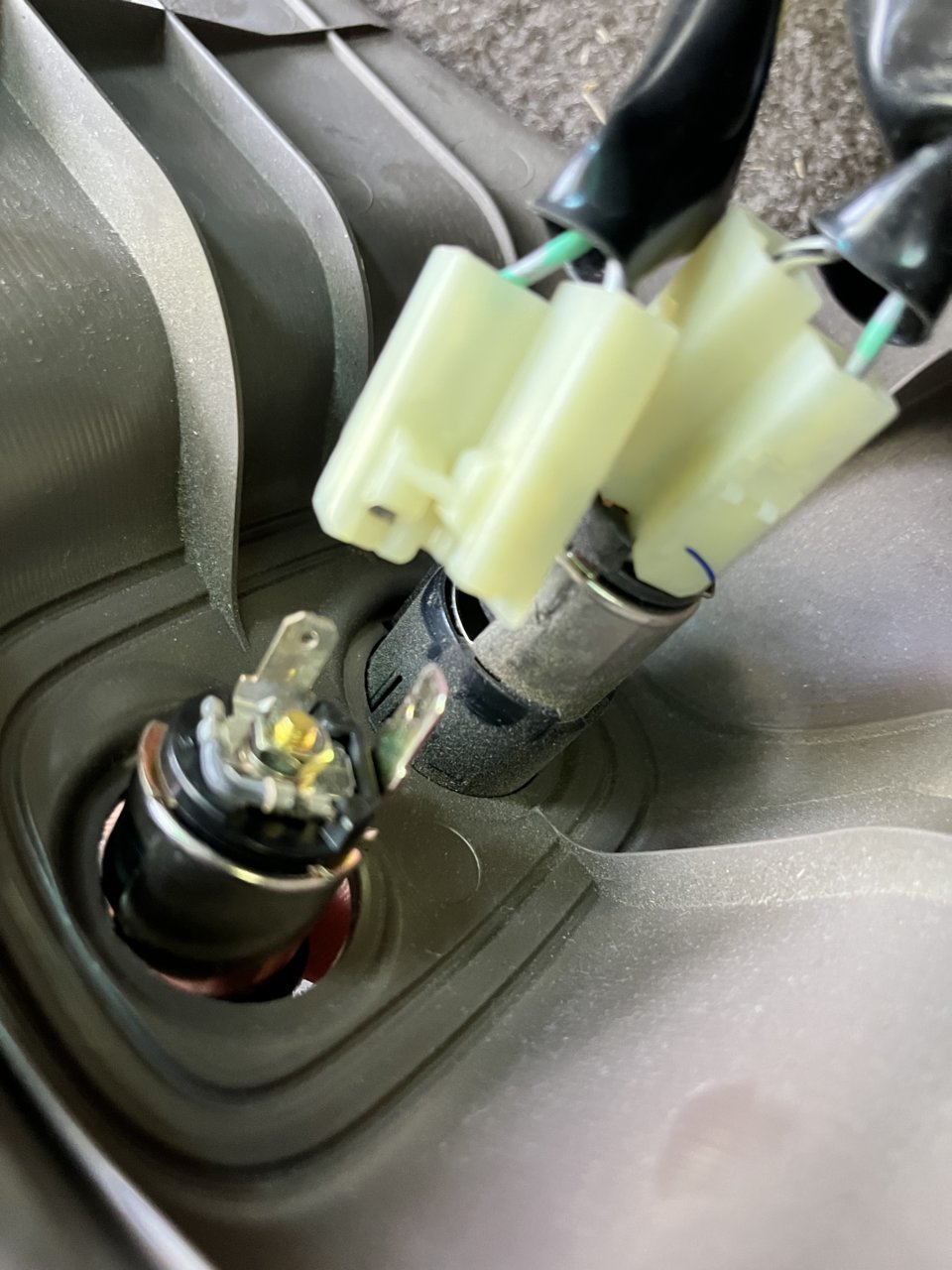

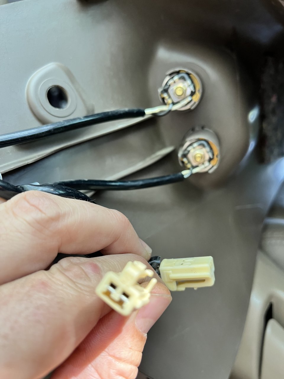

    My 2001 Tundra AC connectors for the 12V are this V-shaped thing, but the 2004 Sequoia’s are smaller and flat, so you have to swap these or splice the wires (I swapped mine because my caps still work):
    End result (before I put all the blanks and side mirror thing back in). Fitment not perfect but it’s very sturdy and I’m beyond pleased:

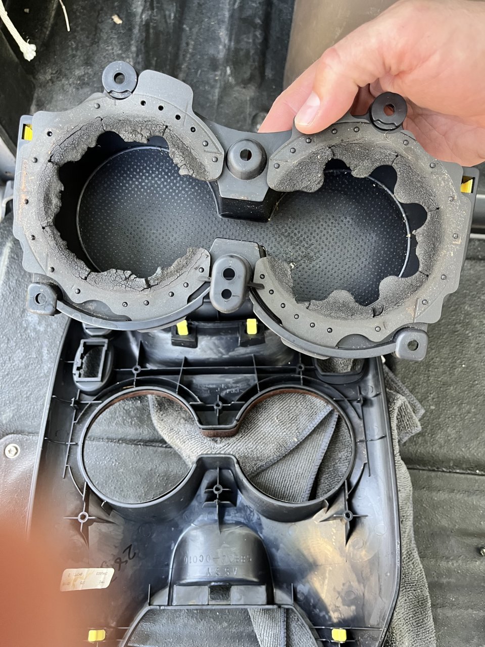

    Those foams on the cupholders aren't stock anyway, the stock ones are triangular. New foams are inexpensive enough on fleaBay. That's where the PO of that Sequioa probably got theirs.
    Show me a pic of what it looked like before? I can probably shake down the part numbers. I usually try to grab a pic of the VIN off any vehicle I yank parts off of for exactly this reason.

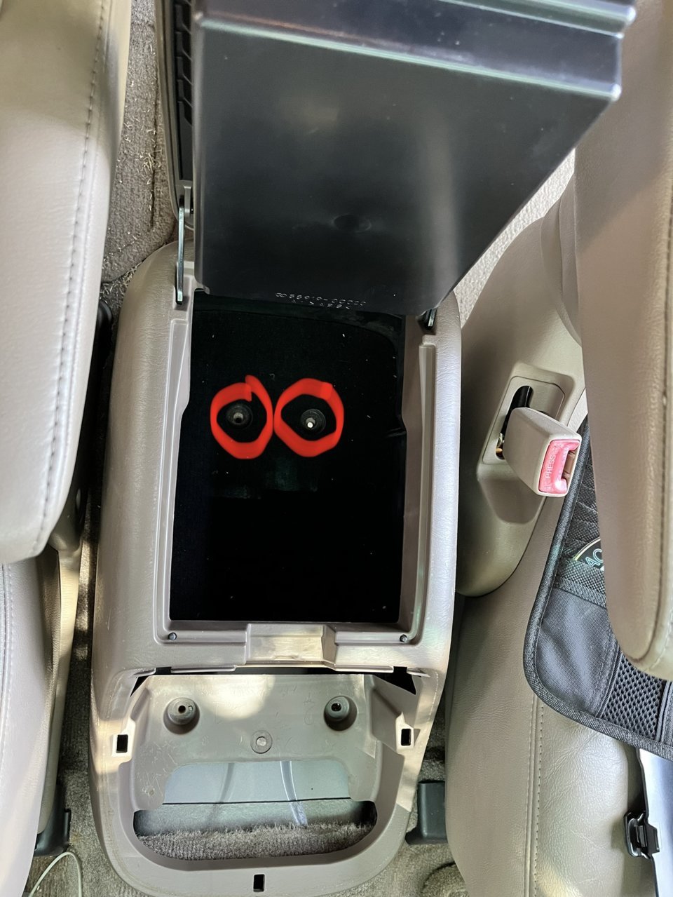

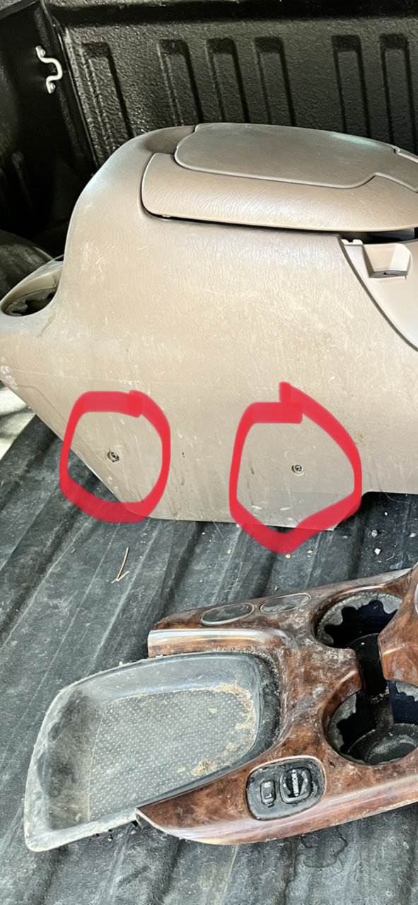

    Also, wasn't there a bracket that bolts to the floor under the box/cubby part of it, and you run two screws into each side, horizontal, to stabilize the box, or am I nuts?
    Once you get the two bolts in where the front cupholder is, it stabilizes everything.

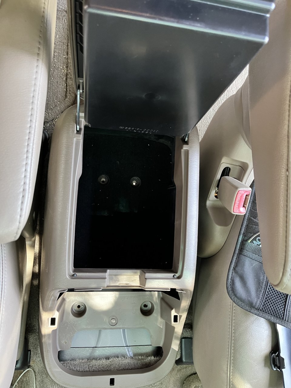

    The bracket goes under the “big” part of the cubby/box piece, using the same 2 bolt holes that held the original smaller console inside its cubby/box piece (which the original did without the bracket).
    So these holes from the original cubby (that’s daylight you see through those):
    Are replaced by the bracket (terrible pic) which lines up with the original holes and the holes in the Sequoia cubby:
    Definitely very stable. More so with the zip ties between the two main pieces (held together and to the floor with bolts on the Sequoia, but there are no holes on my Tundra where those went). Edit: see my comment and shifty's parts diagram in this thread, which has P/Ns for the bracket from the Sequoia you totally need if you want this to be a plug-and-play mod.

    Oh if you mean the screws you can see here, I didn’t mess with those at all. You remove those and you can separate the color shell from the black square insides of the big main cubby/storage part.

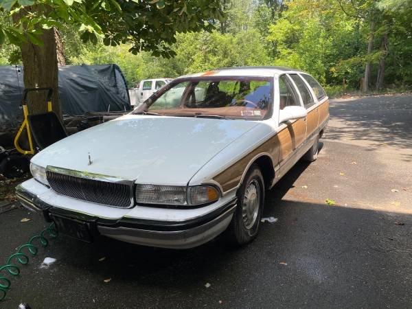

    Found a picture!!

    That'll be a big nope from me, boss. I like the box ones, not the bubble ones. Although I will say, having a GenII LT in it would make the swap probably easier, and the Roadmaster 4dr non-wagon looks great bagged laying on the ground, that one is a hard pass for me.
