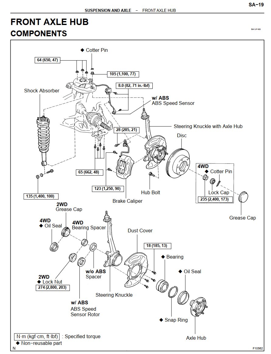

    PS @danb - torque specs for '05-'06 if it helps, note the legend in the bottom left corner so you don't over-torque anything:
