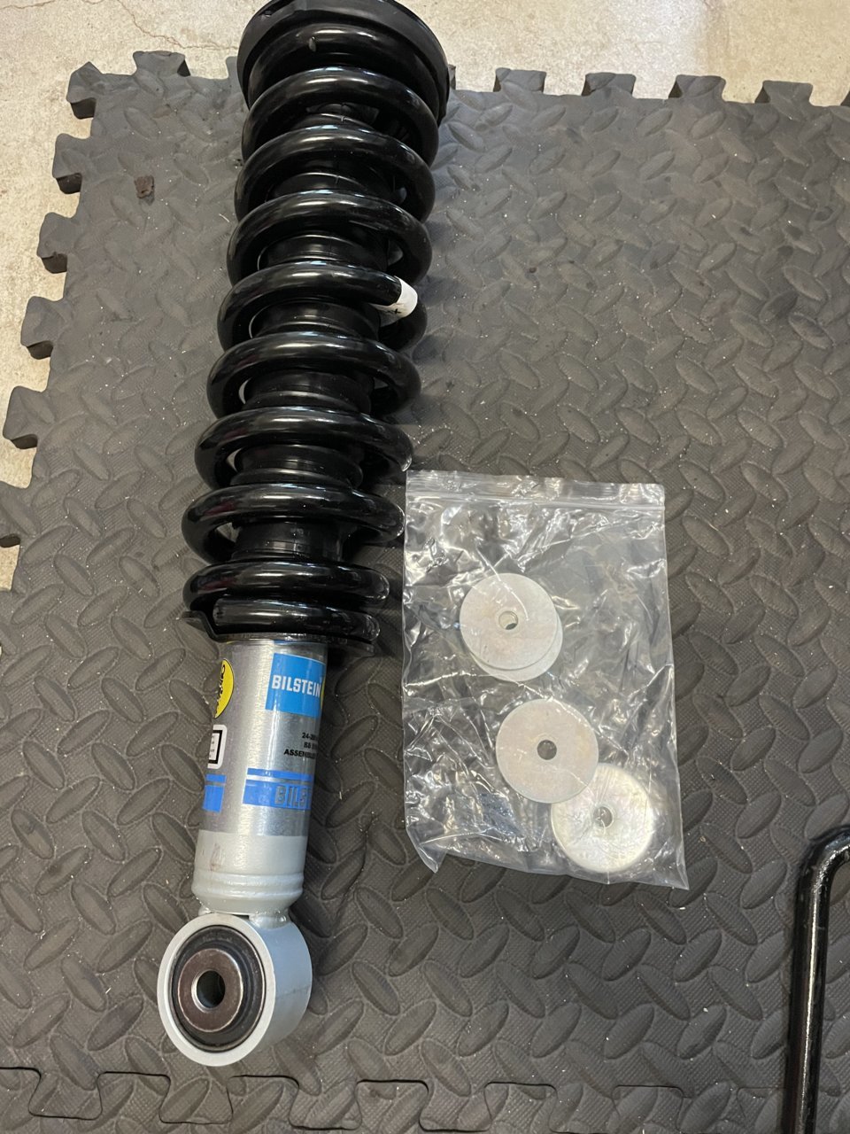

    Installing the Bilstein 5100s with OME springs that were preindtalled and cant figure out what these 4 big washers are for. Instructions say they're for jounce bumpers?

    "jounce bumper" is another word for "bump stop".
    Some vehicles will have bump stops integrated into the strut, I've only seen it once or twice in my lifetime. Our trucks have two bump stops on each side of the frame, facing downward, up front. Hold up and I'll get a pic from my recent suspension activities. I dunno where you'd be using those? (left stop is hidden, but it's there - basically these are what the LCA come in contact with when the suspension is in full travel upward, i.e. hitting a big ass bump - I assume this is the 'jounce bumpers' they're talking about?)

    Those big washers are for your front bumpstops. They spin on and off with a larger crescent. Use two washers as spacers to make the bump stops stick down a little further, then reinstall. Keeps you from bottoming out the shocks. I didn’t use them with my first set. Blew the passenger side shock at 60k miles, may not have been related.

    I mean, if I were really worried about it, I'd probably replace the factory bump stops with Duros. I need to see what my travel is like once I get my suspension in.

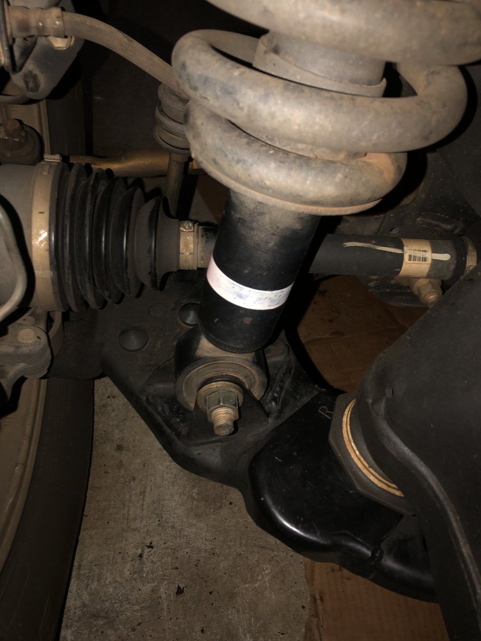

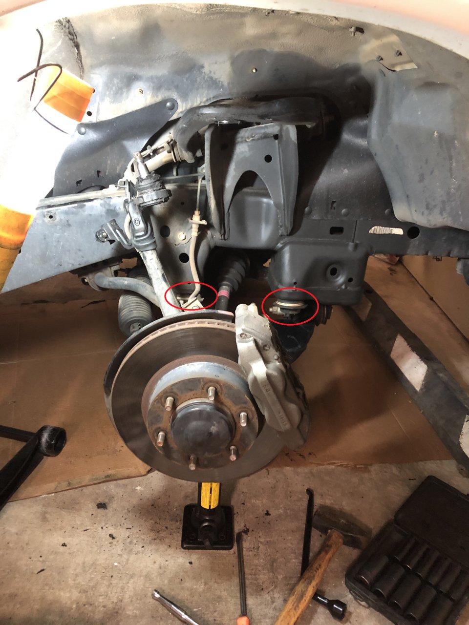

    Ahhh thank you, makes sense. Will throw them on tomorrow. Got one side in no problem, but the driver side is a pain. The bolt at the bottom was bent and a normal ass nut was securing it. Went to fit the shock and the bottom wouldnt line up parallel with the bracket, offset a bit. The blue lines would be the bracket, green is the shock. I dont know enough about suspension besides messing with the spring can kill you, so I'm not sure if its possible to twist it to fit. I would think I'd have to mess with the nut keeping the spring in tension right?

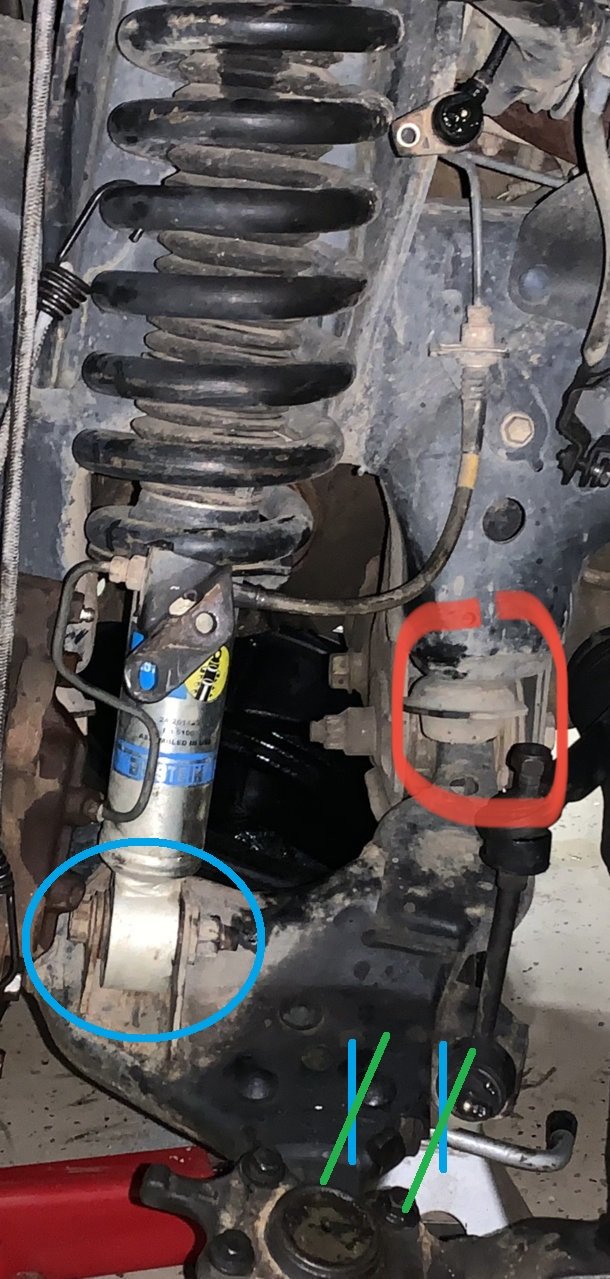

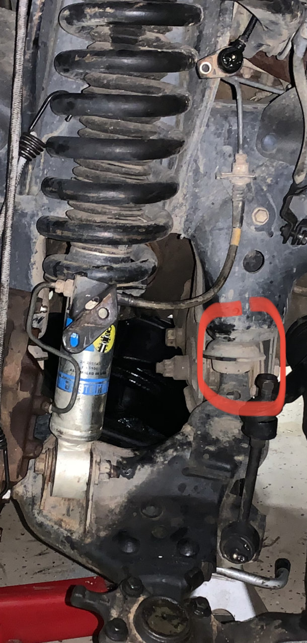

    I'm not following the problem. You mean the shock mount won't line up so the bolt goes straight through? If so, just take a BFS (big f'n screwdriver), insert into the shock mount, spin the shock shaft until aligned, then insert into LCA provision and work the bolt thru.
    With my truck, I found it's easier to remove the top bolt of the swaybar link while the truck is still on the ground to gain some added LCA downward travel making the job easier, but there's no reason you can't do it now. EDIT: Although it'll be easier if you grab the OEM bottle jack and toss it under the tapered end of the LCA, and jack it up to relieve tension on the swaybar link. Reattach when the truck is back on the ground, or use the jack to jack it back up into place, maybe easier.
    I'm pretty sure the lower strut mount nut on mine was a normal nut also, is the other side different? It's unusual the bolt is bent though. I'd probably want a new one, personally. But that's just me. I'm anal-retentive.
    Make sure you install the bolt the same direction it came out. Nut should be on the front bumper side, bolt head facing the rear. Careful not to damage your CV boot in the process.
    As long as the spring is mounted properly inside the strut, there's not really any risk of losing teeth or skull fractures.

    Yup, exactly. I wasn't sure if I could mount and twist to fit without damaging the assembly. A lot of this is new to me so I appreciate the help.
    Yeah the bent bolt is concerning, and the regular nut as well. The passenger side nut for the mount bolt had a flange on it, much more substantial as well. Back to the parts department tomorrow I guess

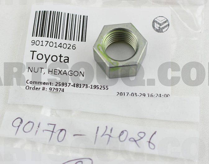

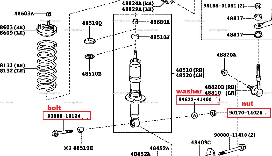

    Mine is a regular nut and washer. That's it. Pic below. For our 2006, per parts system, here's your part numbers.

    It skipped the other pic of my bolt etc. Here.

    Last but not least, can confirm it's just a regular old nut, not flared at the base. So mine must be stock.

    what a dawg, absolute G. been struggling to find those numbers!
