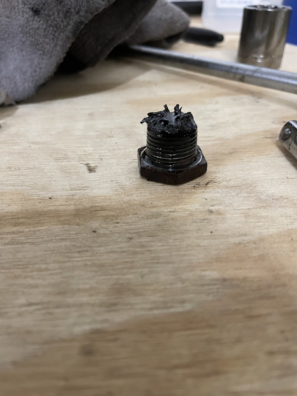

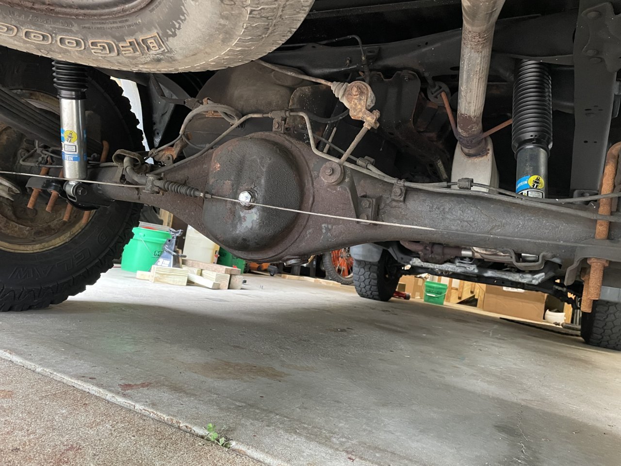

    Swapped out rear shocks, drained rear diff, and tried to find a lug nut key.

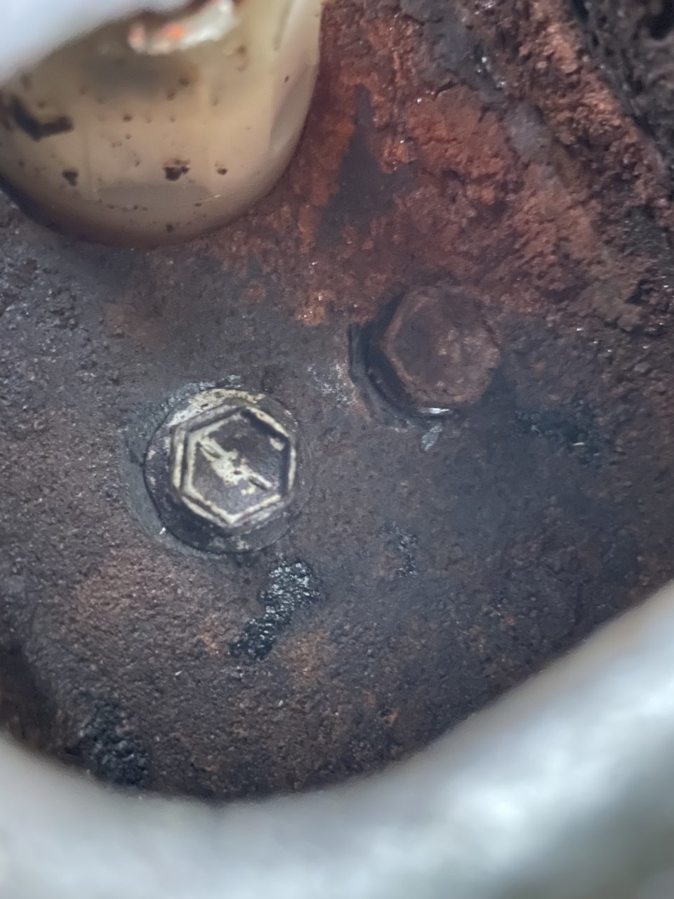

    Rear shocks were OESpectrums and trash. The Bilstein 5100s are night and day better. Rear end feels planted and actually absorbed bumps. Working on finding a lug nut to remove these locks, previous owner didnt know where key was. The Mcgard set that includes a key from o reillys didn't work. Mcgard uses rounded edges with different sizes compared to mine. Might have to go to the pawn shop to find some old sockets to hammer on. I've got 5100s with OME springs ready to install on the front to replace the Rough Countrys there.
    Drained rear diff and saw a shitload of metal shavings on the plug. Oil was reddish brown, looked like shit. Hoping this is the first time its been changed and thats why there's shavings on the plug. Will dig into the diff when I get more time, might be a reason for some of the vibrations in the truck.

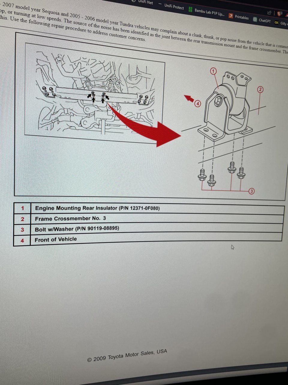

    Also tightened the bolts under the trans mount. The two that look like they dont have washers were pretty loose. Will be replacing all 4 tomorrow.

    This is only known to be an issue on 2wd trucks AFAIK, wonder if this is something we should all be looking for.

    Yeah I read that too, but I'm replacing them anyway. $8 for a piece of mind isn't bad

    Hey, I got the wrong PF video above. I just edited my post to update it. Watch that video. He shows you how to defeat virtually any lugnut with inexpensive tools, and no damage to wheels.

    Be sure to verify your rear diff breather is working properly as part of the rear diff tune-up. They get mucked up.

    Part number for that ('05-'06 at least), it's only like $8 or something stupid: 90930A3001 => REAR AXLE VENT BREATHER

    Those are the locks discount tire sells. Swing by and I’m sure they would sell or give you a key.

    Dude nice, thanks for the tip.
