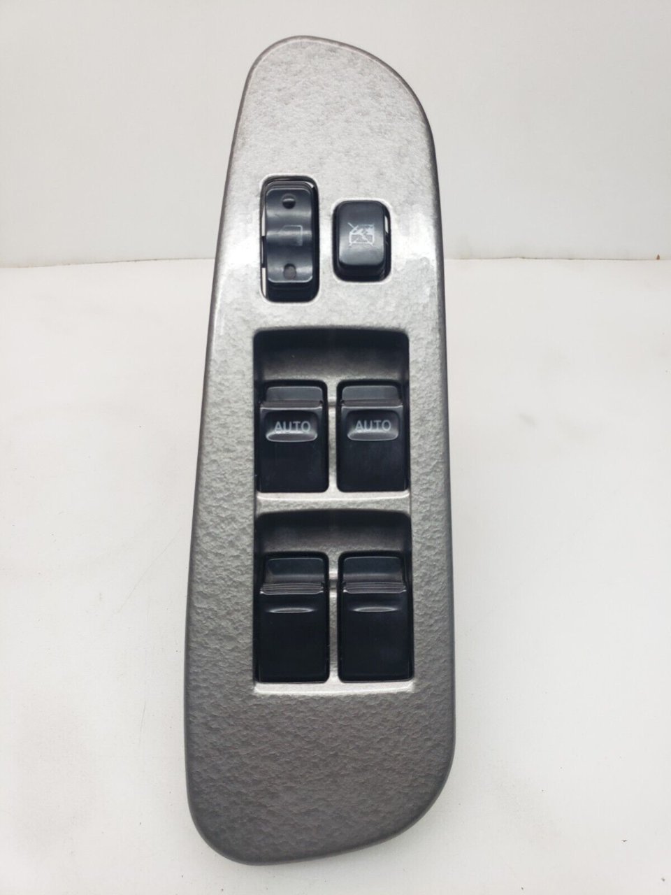

    Has anyone done a passenger window auto rolldown feature much like the driver's side? It doesn't seem like it would be that hard to do although I'm guessing I'd need a different toggle switch or need to put in some type of latch circuit to make it happen. I think I may try it.

    Thanks, @Mr.bee. I'll have to look at the wiring diagram of one to see if it's different. Maybe the latch is built into the switch?
    Is that a separate window rolldown switch? I need to look at mine real quick.
    Edit: Nevermind, that's the door lock switch.

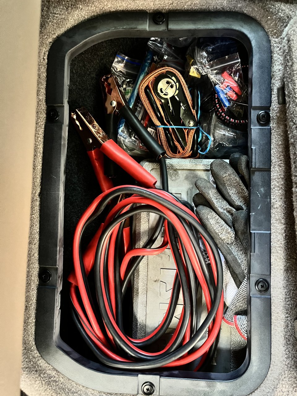

    Made up a roadside emergency kit. Nothing fancy just got some stuff in here from an older kit I was throwing out:
    - jumper cables
    - standard toolkit with some extras thrown in (zip ties, fuses, etc.)
    - first aid
    - air compressor
    - gloves, emergency blanket, poncho, etc.
    - ratchet strap and bungee cord
    - need to figure out a good place to stash a four-way tire iron
    Galladanb, bmf4069, Mr.bee and 2 others like this.

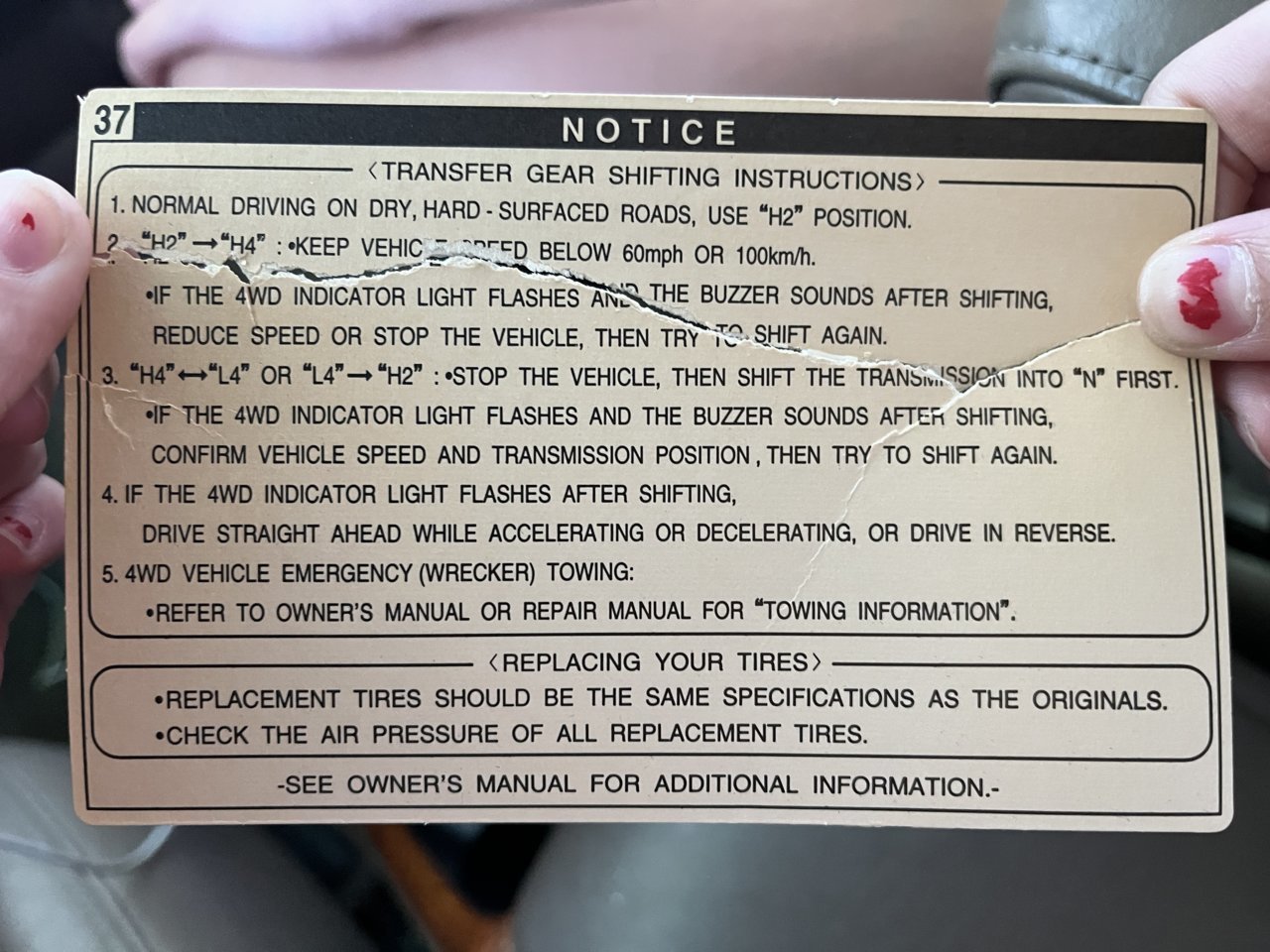

    Oh and one of my kids lowered the passenger-side visor and this fell out and literally “broke”. Like it’d never been opened!

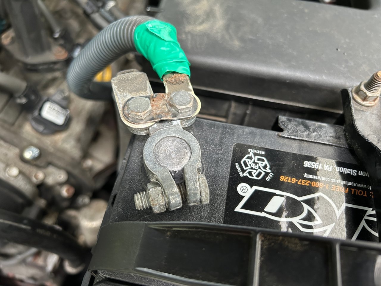

    The other day I hopped in the truck to go to work, turned the key, and "Click". SFP! Well I've been to this movie before, in fact, I recently got a new battery and ground cables because of the same problem. So I hopped out, gave cables and battery camps a little twist...and "Vroom", off to work I go. Today I had time to fix it right. I pulled the camps off the posts, scrubbed them up with that bristly battery post thingy, and clamped them up good and tight. "Click!" SFP!! I peeled back the conduit on the positive cable to inspect for corrosion...good as new (The green electrical tape is because I didn't have any black handy. The aesthetic bugs me, but I'll change it when I find my black tape). I pull the starter relay (major pain in the ass, BTW) to test it...no problem. I used a shorting cable to turn the starter while the relay was out..."Click". "Click!!". "Click!!!" SFP squared! Then I saw it...
    The two spade lugs on each of the positive cable were corroded underneath where they bolt on to the after market clamp. I unbolted those connections, scrubbed them clean with a file and then Emery cloth, then bolted the sandwich back together (7/16" BTW...Hmm, I wonder what else on my truck will turn out to be SAE). "Vroom"!
    It's never the starter!
    But there went two hours of my life I'll never get back.
    (Note to self: Add Emery cloth and SAE combination wrenches to my road tools).

    DIELECTRIC GREASE. Coat that shit, now you cleaned it. And FFS, even if they're seen as a gimmick, get you some of those terminal donut felts to cut down on terminal corrosion. I have them on all our cars, one of my wife's was exceptionally bad about throwing corrosion and the felts cut down on about 80-90% of it.
    And yeah, it's never the starter ... until it is, but based on others here, you can expect to get a good 200-250k miles out of the factory unit. However, it's definitely NEVER the fuel filter :rofl:
