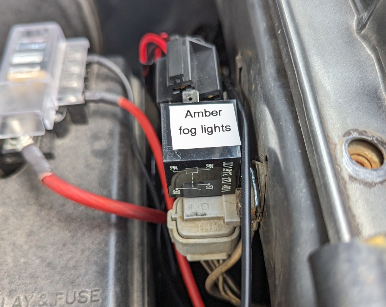

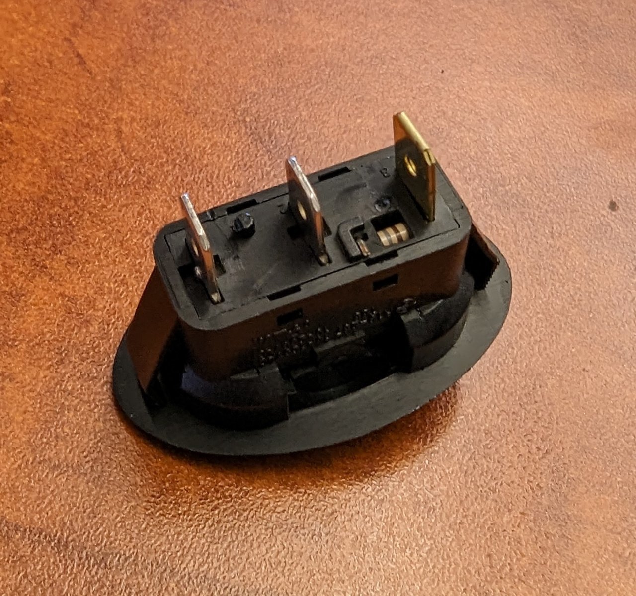

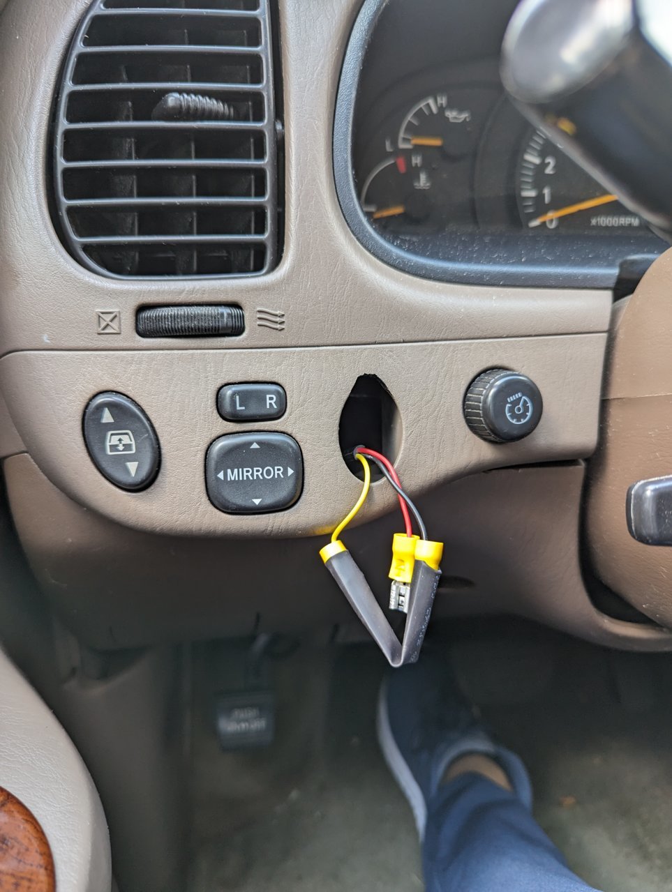

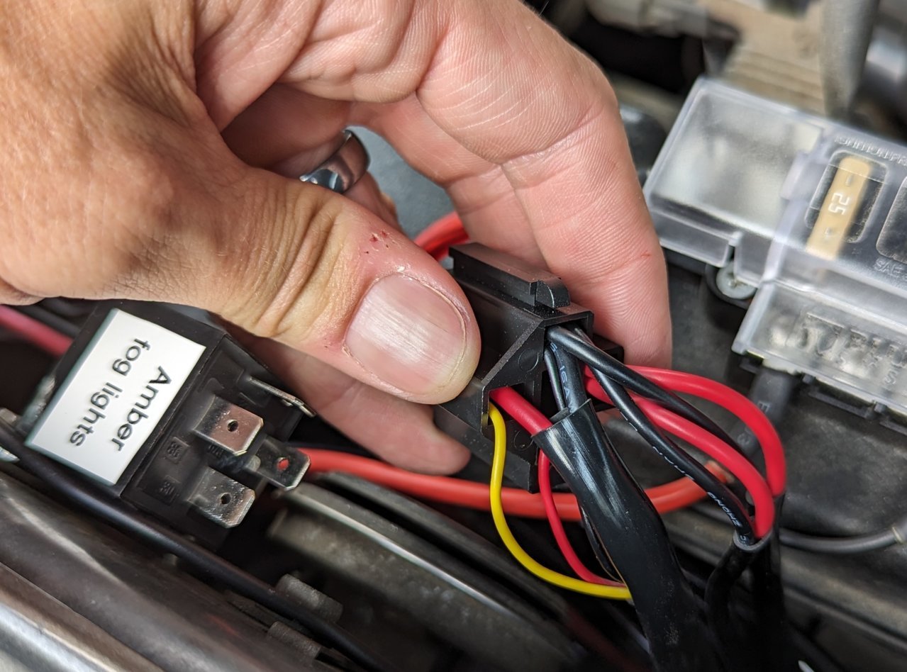

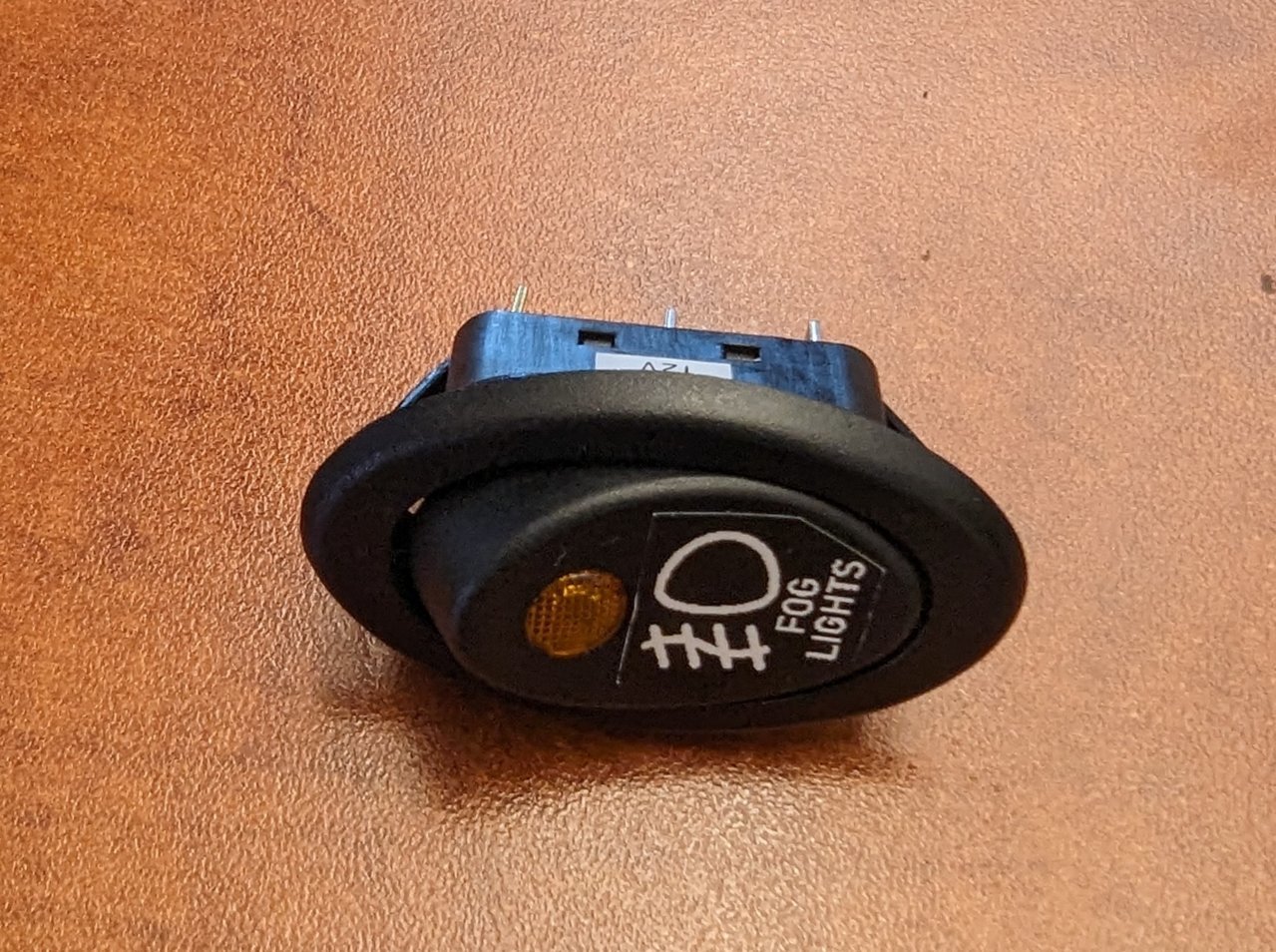

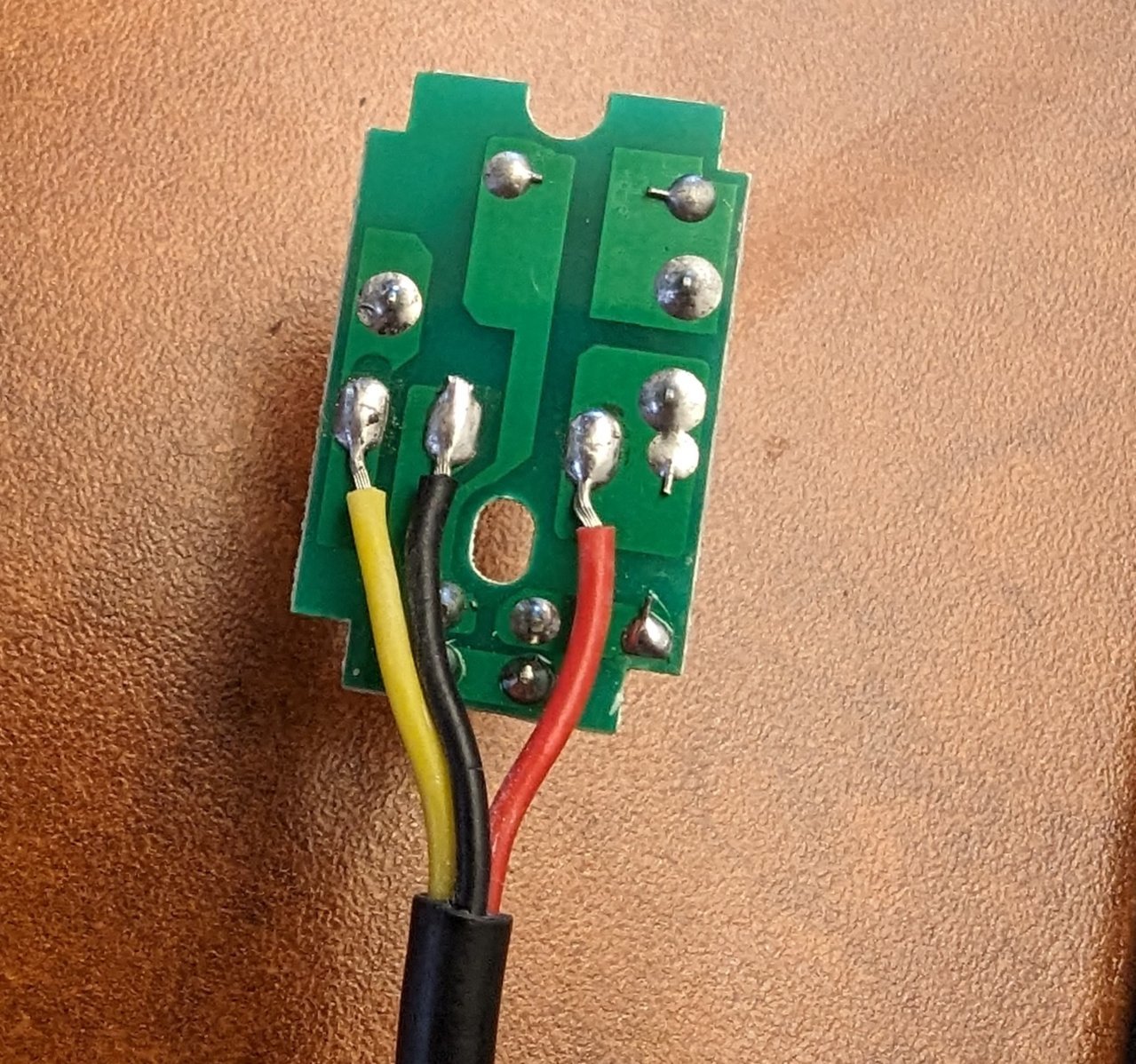

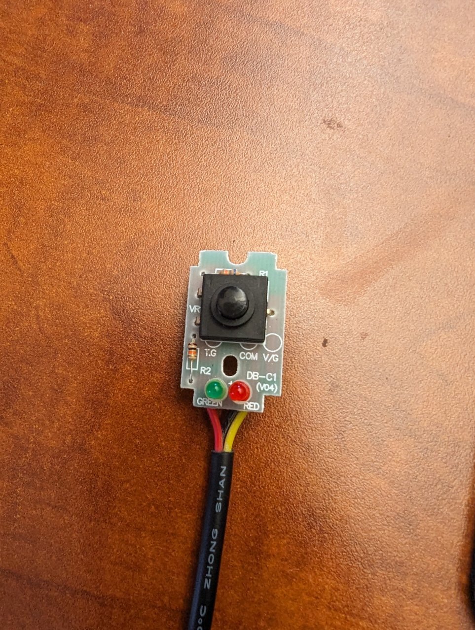

    Anyone willing to take a crack at helping me wire this switch correctly for some auxiliary led pod fog lights? I tried and failed. Already popped one fuse in the process. I'm using a fuse tap running off the tail light circuit.
    It worked fine using the original push button switch which I've since cut off and I'm trying to wire up one of these: https://www.keepitcleanwiring.com/c...17Y/Oval-LED-Rocker-Switch---Yellow-15a-12vdc
    It didn't come with a diagram and there are no helpful labels on the switch itself other than the numbers 1, 2, 3 at each terminal.
    Original switch:
    Here's the new switch:
    Relay:

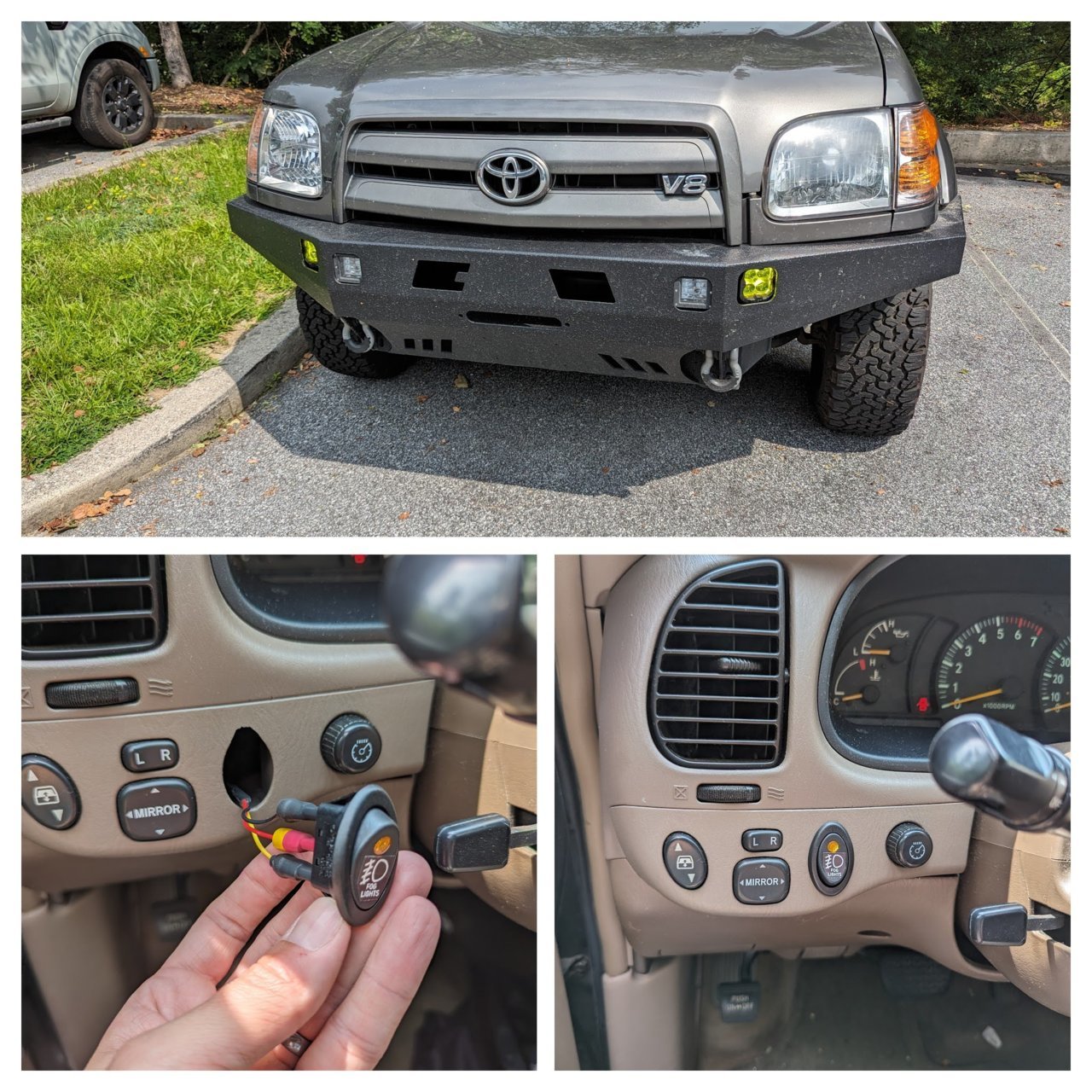

    Intended location:

    Looks like yellow is battery 12v+, red is switched 12v+, black is ground.
    If you have a meter see which terminals on the switch have continuity with the switch in the on position, then test the other terminals for continuity with the same terminals. Ground + battery 12v terminals will always have continuity, battery 12v and switched 12v will have continuity when the switch is on, switched 12v and ground will never have continuity.

    oval switch looks like power in, switched power out and ground for the led indicating it is on.
    Black is a clear ground candidate.
    so red vs yellow is only a matter of getting the indicator working. One way it’s on regardless of switch position and the other it’s only on when switched on.
    Use the output to feed the relay. Which also needs fused power and ground of course.

    The relay is getting power from a fuse tap tied to the tail lights in the cabin and is grounded to the frame near the battery. I was hoping for a simple diagram on the package or switch itself but no such luck

    https://www.12voltplanet.co.uk/relay-guide.html
    Terminal 86 - Connect to the +12v low amperage signal from switch
    Terminal 85 - Connect to a suitable earthing point on the vehicle chassis.
    Terminal 30 - Connect to a +12V feed from the battery.
    Terminal 87 - Connect to the +12V terminal of the driving light bulb or driving light loom.
    LED rockers brass is usually ground, center is 12v per in, end is power out to terminal 86 of relay

    'preciate all y'all

    That bumper looks pimp as hail! Are those lights the ones you can order from Coastal Offroad or something you purchased separately?
    I am close to pulling the trigger on one with the full bars, found a local guy who'll weld it up for me for $250. Knowing how pressed for time I am (and that I don't own any welding equipment and really don't know how to weld beyond mere functionality), that seems hard to beat.

    The clear driving lights came with the bumper kit. I'm not sure what manufacturer/model they are, but they are high quality and really help light things up at night. I'm also running the 90W/100 high powered Osram halogen headlights. The clear pods are connected to the factory fog light harness and switched on the stalk.
    The new pods I just added are these: Lasfit 18W SAE Fog Lights
    There are some clearance issues with these inside the bumper which makes it difficult to aim them and get them near flush with the bumper face. I'm going to remove them and drill new mount holes in the base of the pod light brackets to hopefully position them better. The depth of the fog lights create some fitment issues with the internal bumper structure and if I had it to do over again I'd probably find some that have a smaller footprint. I got the clear fog lights and added some yellow Laminex film.
    I had the bumper welded by a body shop while rebuilding my front end after an accident and the owner said in hindsight he'd never weld together one of these kits again. I think he assumed it would come in like 4 or 5 pieces and could be done a couple hours but took him waaay longer than that. $250 sounds like a good deal to me.

    So did you get it to work?
