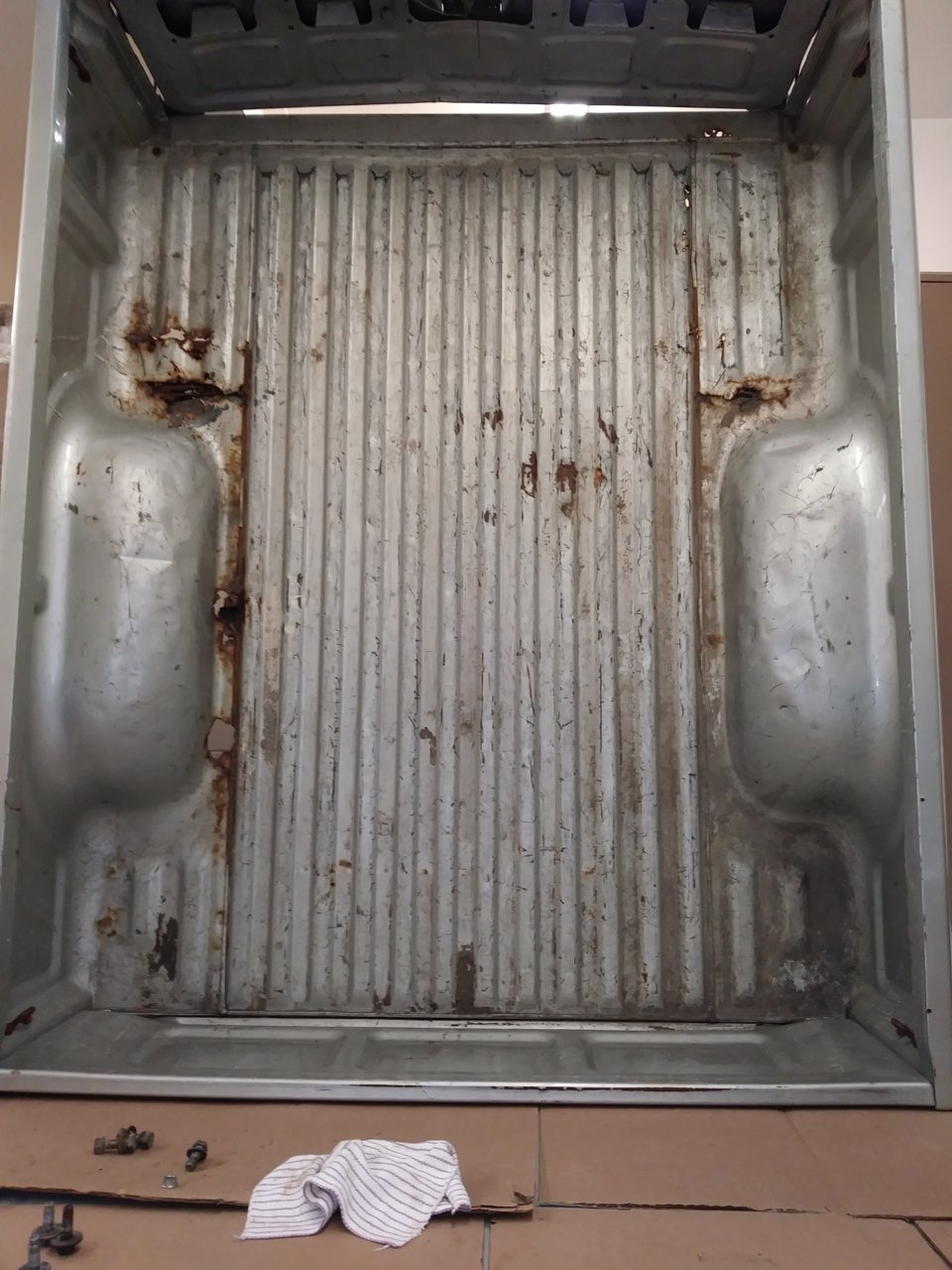

    Did you pay someone to do it? Dropping the tank sounds like a pain.
    One time mine acted up was after a trip to the mountains where I was on a really rough road. I thumped it with a mallet and it didn't do it again for about a year. My truck hates it if I short stroke the starter. I have to let the truck sit for a minute before trying again. It will roll over but seems really angry with me. I apologize to her and move on.

    It looks better than my truck when I didn’t have holes that rusted through. That bed liner wore down the paint on the raised section much worse than yours.

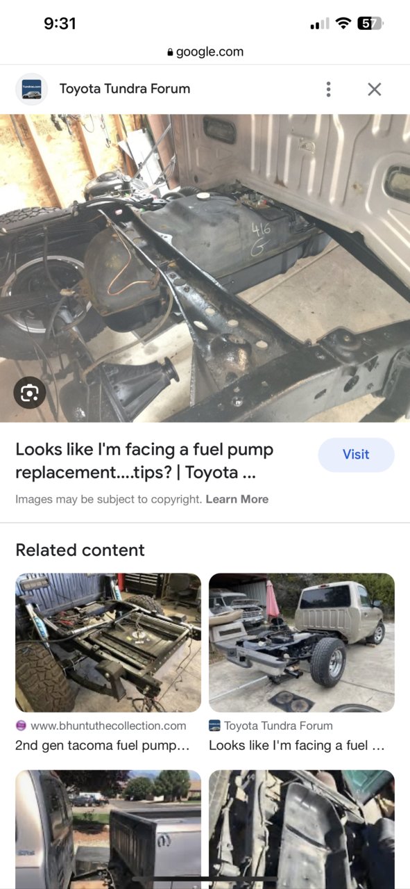

    Maybe we can get @Tundra2 to post a pic of when he had his bed off but I'm pretty sure the fuel pump is accessible with the bed removed. People have posted pictures in the past.
    PHM dropped his tank but said it required hand yoga.

    Ok, i was wrong. Seems to be accessible, but looks tight.
    & my post about the ranger showed up on the google.

    Pro tip: After you hit those seams with a deck brush to get the crap out the corners, hit it with some spray-on, qipe off hybrid wax. Assuming you weren't gonna already. I love this stuff:

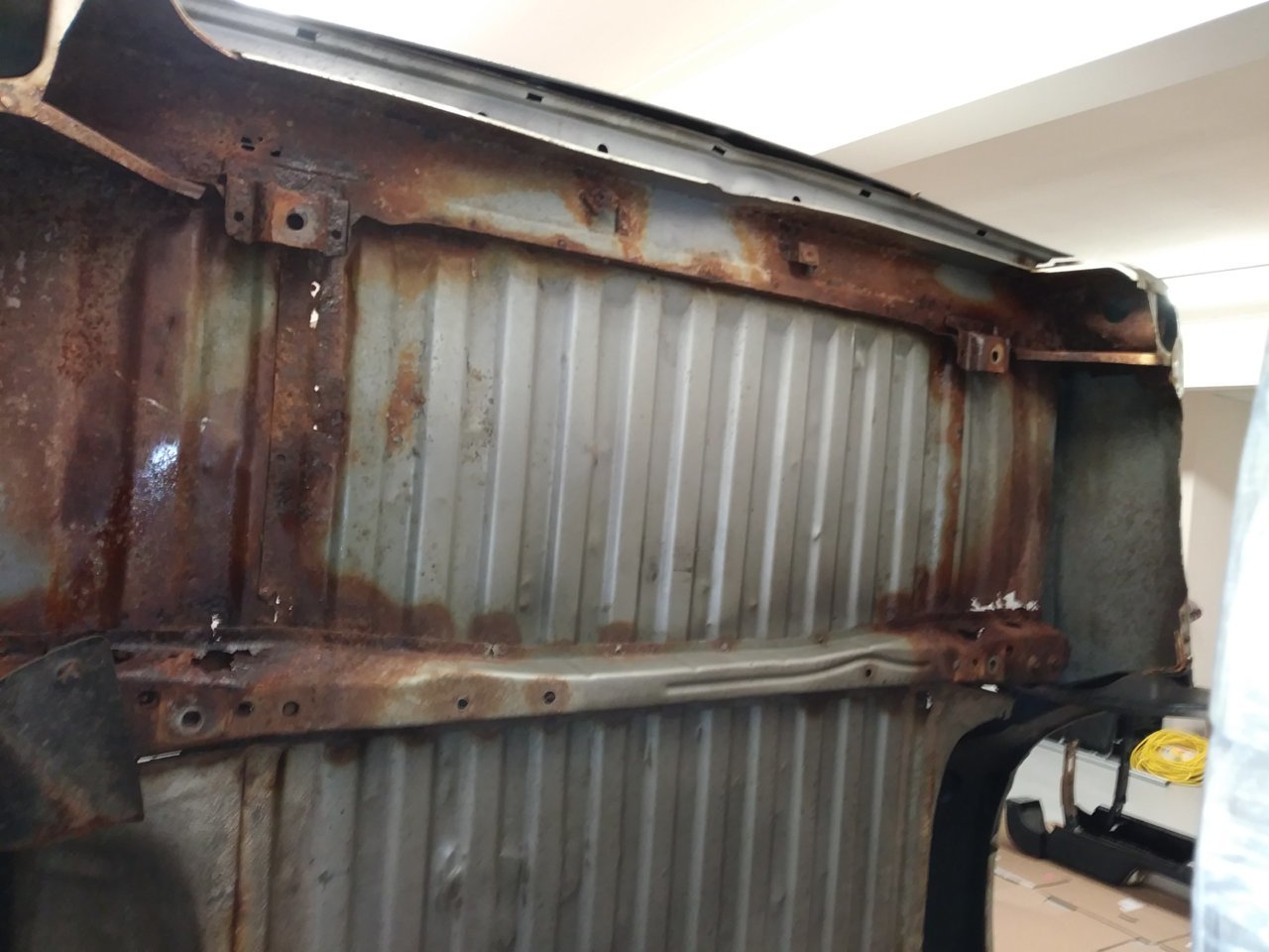

    Of course the rust comes up from the underneath, so...
    both pic, the top is tailgate end of the bed. Way more rust under than shows from the bed.
    I now 'clean' under the new bed by keeping it coated in Fluid Film &/or Woolwax.

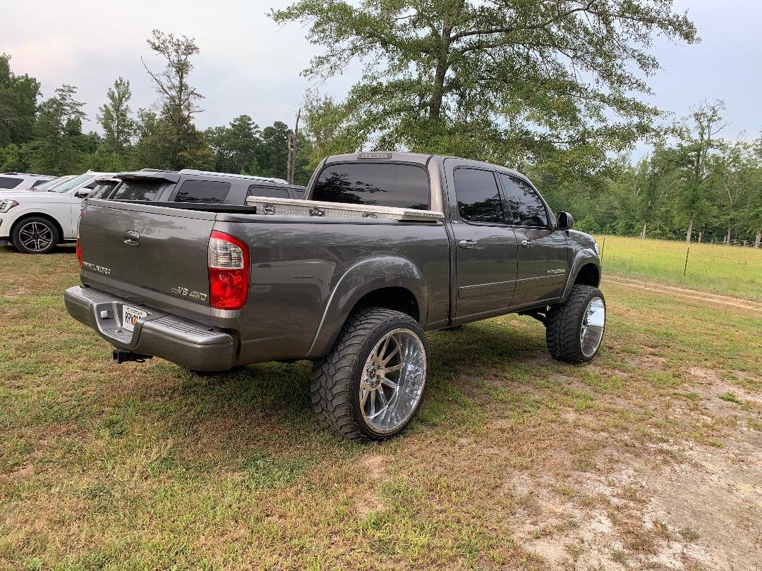

    I was at a fund raiser for less fortunate kids and snapped a pic of this Tundra
    The bed light is kinda cool....

    Why? Just why? That poor truck. :(

    I asked the same question...
    Is this not how it should look (maybe without the nerfs)NFab 3 11-6-22.jpg ?
