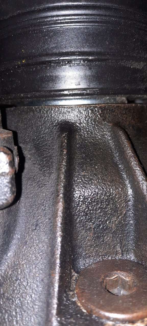

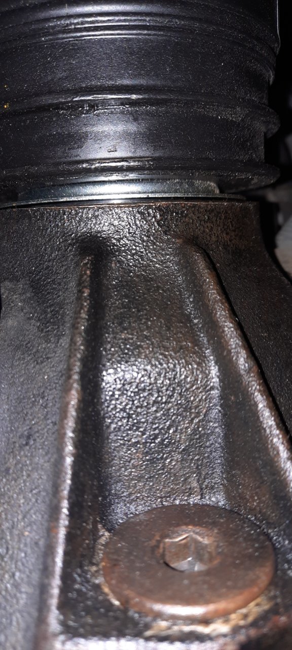

    welp...gonna pull the drive line and reorient everything again. Looks like the rear yoke is just a scosh off...even after quadruple checking and it's driving me crazy. It doesn't seem to be vibrating or anything, but I see it and I can't unsee it o_O.

    Indeed

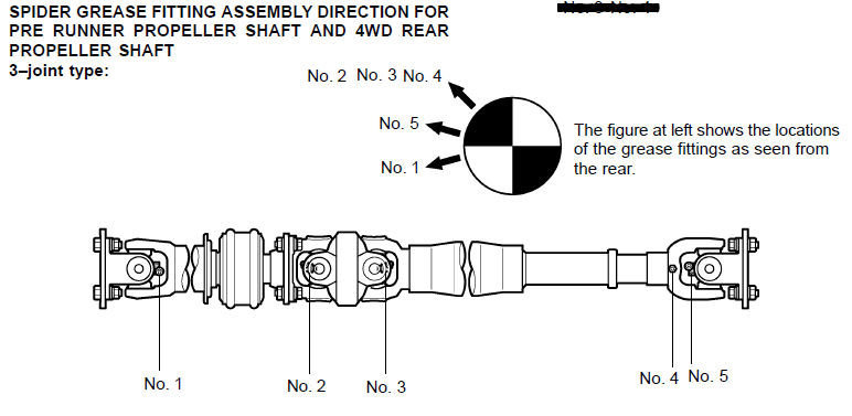

    Is that what you meant? When i replaced my carrier bearing i didnt mark the slip yoke like a champion & that pic set me up right.

    However, there are 3 zerks on the double cardon joint, not just the two pictured

    Correct. I'm only concerned about the phasing right now. Carrier bearing to the rear is golden, but the ds yoke to the tranny is off-line by a freaking nat's ass...I'm more curious about the appropriate right to left direction the CB should be shifted for proper alignment.
    Also, I'm assuming this gapping is normal on the driver's cv?

    Yes, normal

    Well she's running fine. Pretty sure any vibrations I have are from the wheels and their balance, needing an alignment, and/or replacing my passenger cv now that the oem one showed up.
    From what I've heard and read, driveline vibration is very noticeable and would send up red flags pretty quickly.
