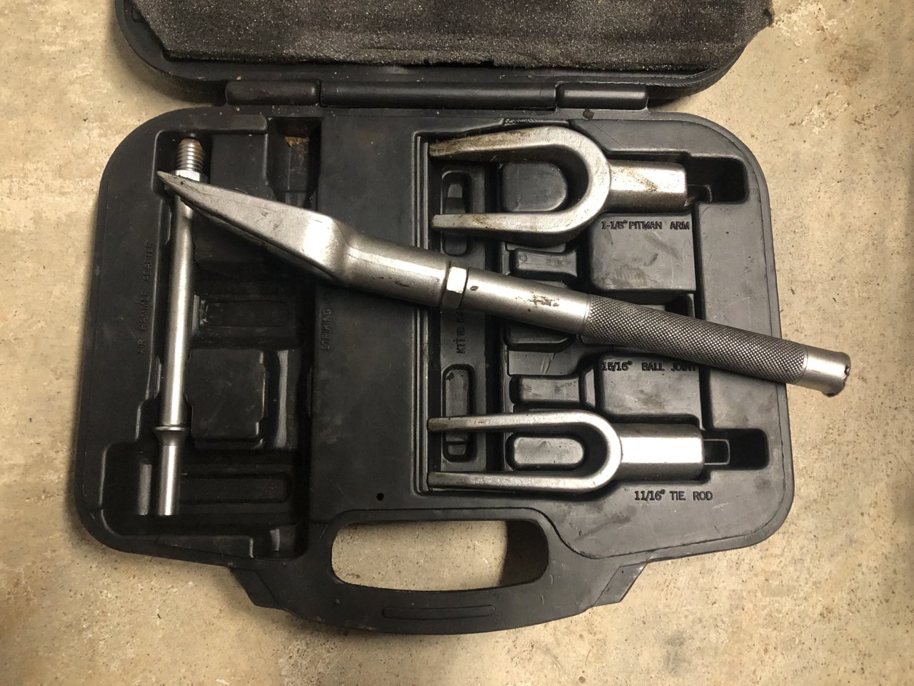

    I used a pickle fork to separate UBJ from UCA. I have a 3-fork kit that's invaluable for separating arms and joints. Unfortunately, I expected a solid tap or three on the UBJ spindle with the crown nut installed would be enough to drop it out of the UCA, but I just ended up damaging the crown nut (hence the need to run to dealership) and got nowhere. It took quite a bit of fork action to get the f'er out of there.

    Oh and @DJenerated here's my pickle fork kit, recognize what they are now? I'm obviously not separating TRE much. You can see how much that post is mushroomed, should give you an idea how much it's been pounded on separating shit over the years :rofl: The forks are swappable.

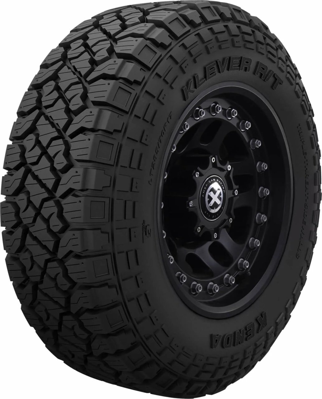

  26. Jul 23, 2023 at 12:01 PM
    FrenchToasty
    Sep 15, 2019
    #36156
    18,607
    Mo
    The SoAz….. big surprise
    Bone stock
    They did pretty good off road, but wore like shit and started dry rotting and leaking thru the tread. I’d only run them if someone gave them to me
    DJenerated and Casper421 like this.
  27. Jul 23, 2023 at 12:22 PM
    Casper421
    Casper421 Toyota RidgeTrac driver!
    Jul 12, 2017
    #8530
    4,129
    In the woods
    06 DC
    I know you run them, like them and you wheel the shit out of em but my experience was in Truckee. They absolutely suck in wet, icy and snowy conditions. I’m aware most don’t see those types of driving but I wouldn’t consider them “all terrains” if they suck when it rains out, let alone in snow. Just my personal experience. I ran destination at’s on my 4Runner for a little and they did better in those conditions. My old cooper st maxx’s did great all around, even in slush and snow. These at3’s haven’t really gotten a lot of miles and can’t say how they hold up. Hopefully that’ll change come fall.
