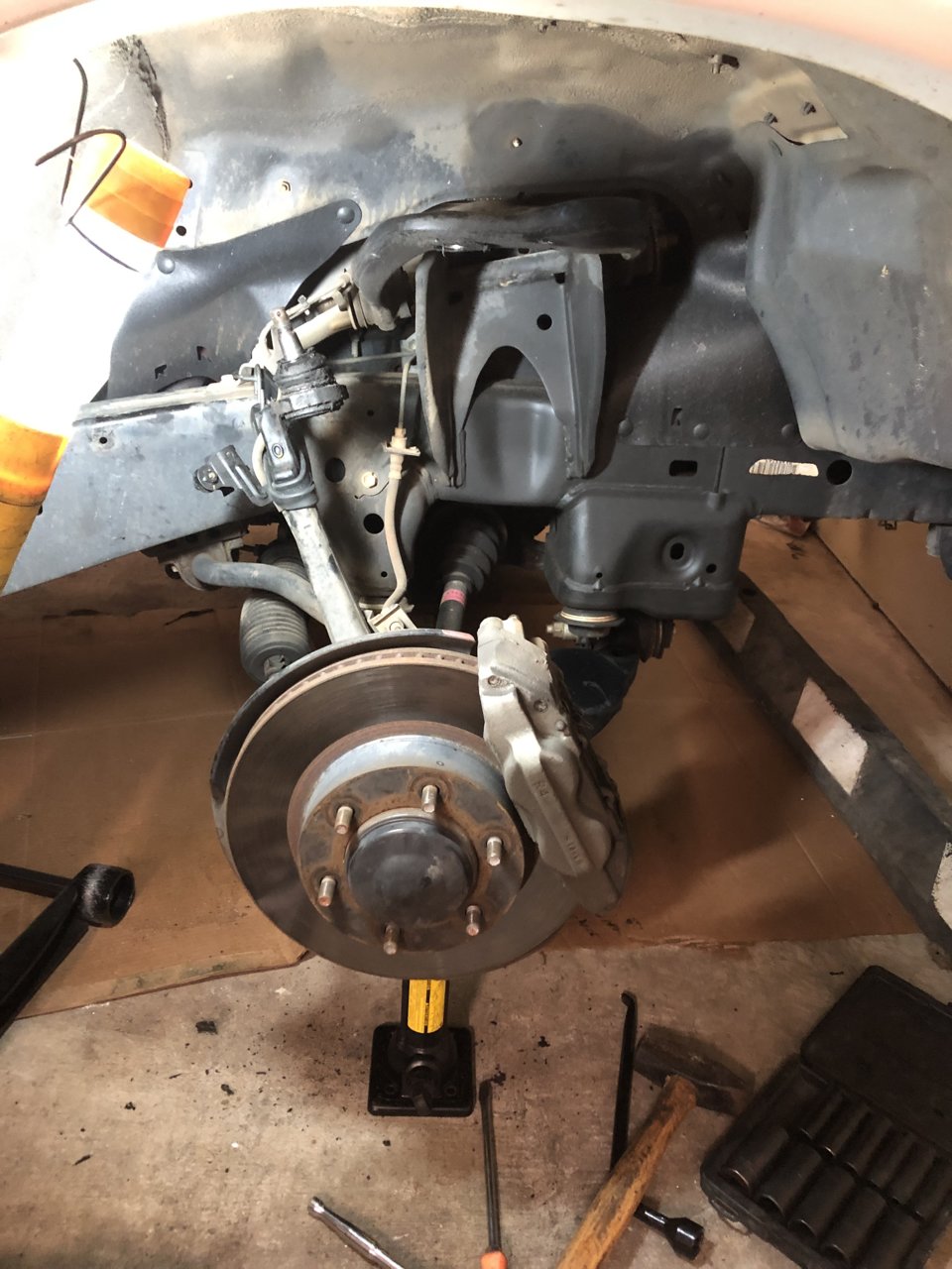

    Anyway, making progress. About to pop pass side UBJ and get the upper in. I really miss having real garage space, but love the garage is climate controlled if doors are closed. Gonna hafta pull the truck out and back into the other garage bay once this side is done just to do the driver's side. Heinous.

    Dunno man. Goddamn if I can't get this f'n balljoint out. The HF 3-in-1 kit I've used on damn near every vehicle I've owned won't bust this bastard loose. (Yes, before anyone asks, tension ring is out)
    I'm gonna hack at this bastard for another hour or two, then walk up to the LAPS and see what kits they have on-hand. If I can't get there, I'm picking up a new castle nut for it, buttoning this shit back up to fight it another day.
    Did Toyota lock these bastards in with something?

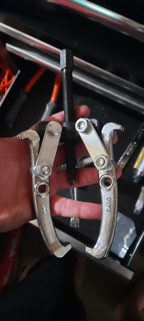

    You already button it up? I've always had success with the $15, 3 jaw puller from Bill O'Reilly.
    Edit: sorry, wrong step in my head. I've been outside in the heat wrestling a u joint all day.
    Did you take the whole knuckle off to make more room? If you aren't gonna use the bj again, get the press kit on and run a fn impact on it.

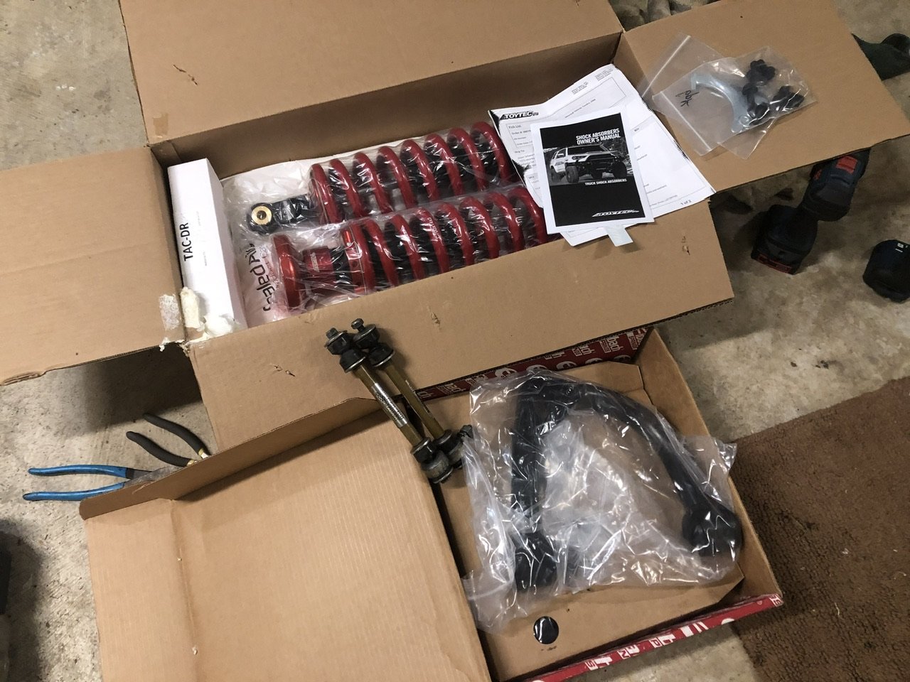

    Toytec Aluma Boss 2.0 (TTLKTUN06-P). Got a killer deal end of last year, waited for a wheel/tire decision to install, got the wheels in several weeks ago, today was the logical day to install the lift, then order tires - no kids, no wife, they're in S.FL, got the house and garage to myself. Came down with a pretty gnarly sinus infection and found a mass in my throat about a week ago, and I'm pretty sick and miserable - Murphy's law. Wasn't about to let it stop me from trying.

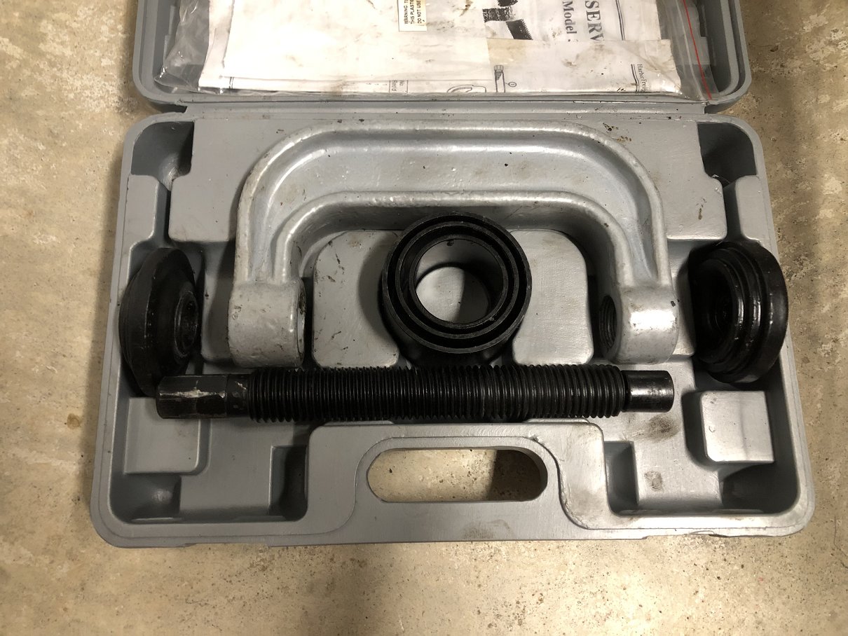

    I have the HF MA10-1 kit. Let me try to lay it out from memory...

    My HF kit is old af. I probably got it 20, 25 years ago now. I've used it no less than a couple dozen times, it's never failed. I know HF sells a new one w/3 cups and more xtras, I just never needed it. the C-clamp measures 9" tip to tip so when you factor in the threaded spindle... you need 14"+ space.
    I'm open to buying another kit if there's something guaranteed to work. I can justify up to $600 on it, because that's what I'm paying for someone else install the uppers. I'm just sad I'm having a tool failure, this was the last thing I expected. :(

    Ok, so, I feel like this is what finally worked for me. Only ended up using 2 pcs to remove, but installing the camburg uniball took another cap...I think.

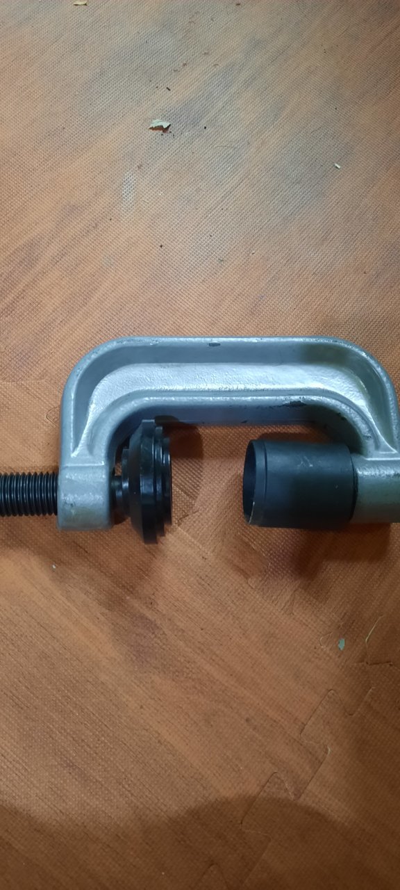

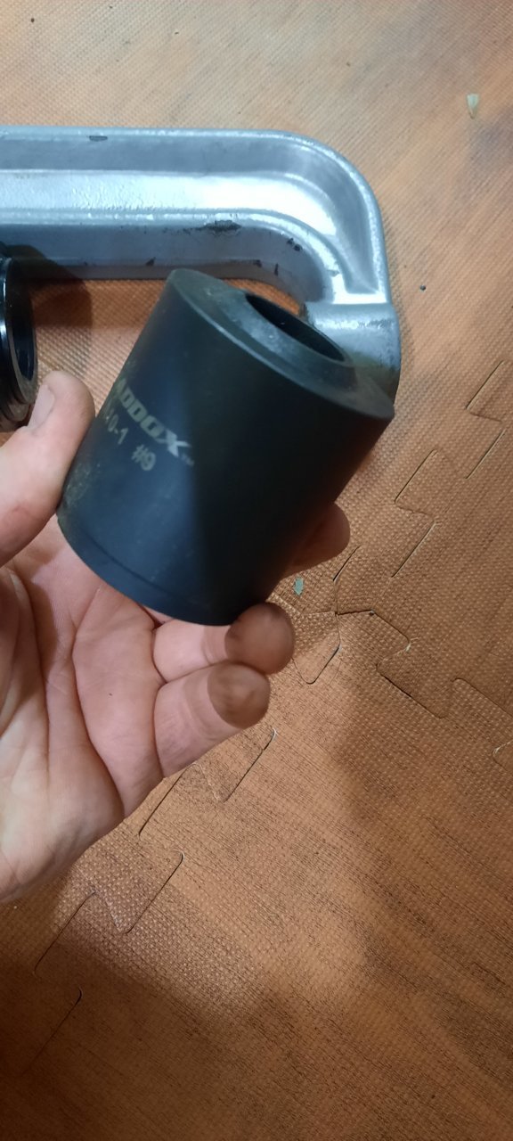

    Nope, what you see is what I got. Didn't think ahead to consider this BJ would be any different from any other I've cracked off.
    Part of the issue I'm running into is with the pucks in my kit. They're adding just enough height that it's difficult to wedge into the wheel well. I think it'd still happen with the TC cups.
  28. Jul 22, 2023 at 4:37 PM

    I tried a similar config w/mine. Your clamp definitely looks smaller than mine.

    Remove the long upper control arm bolt (maybe pop the tie rod off too), hang the caliper, disconnect the abs wire or remove the sensor and tilt the arm and spindle out of the wheel well.
