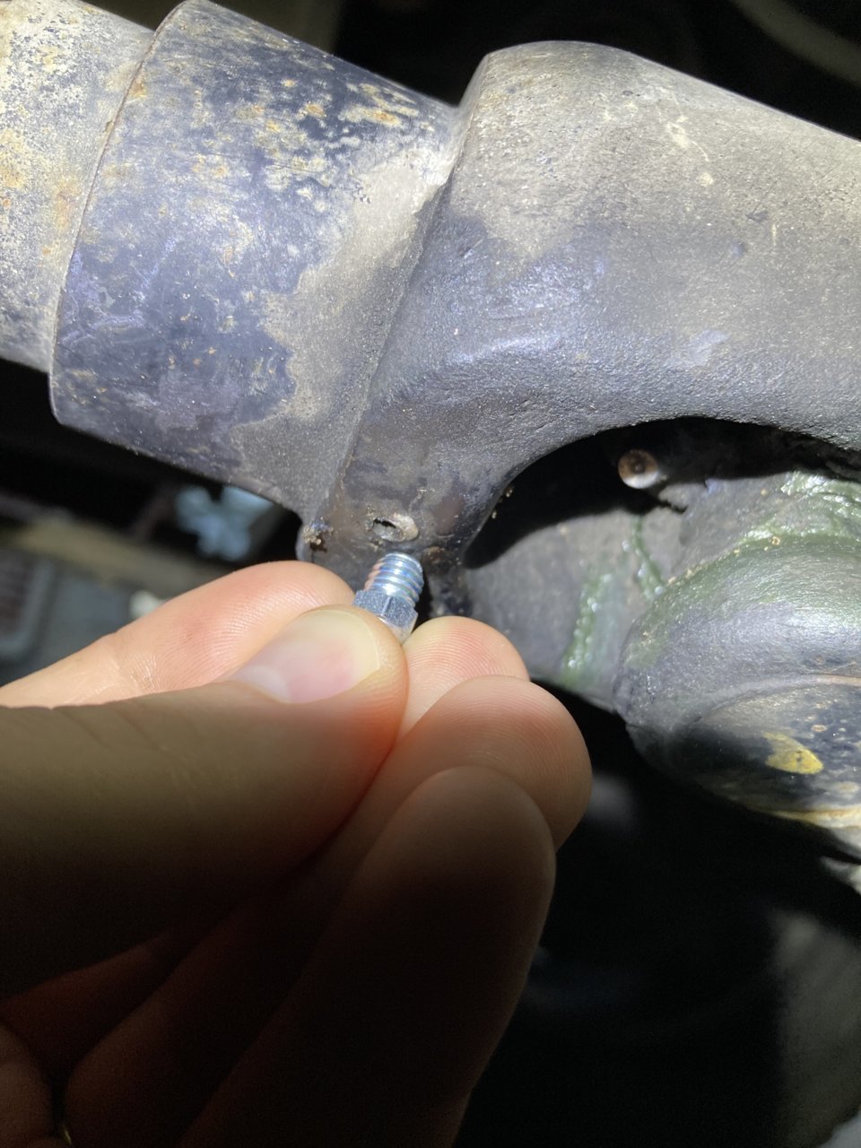

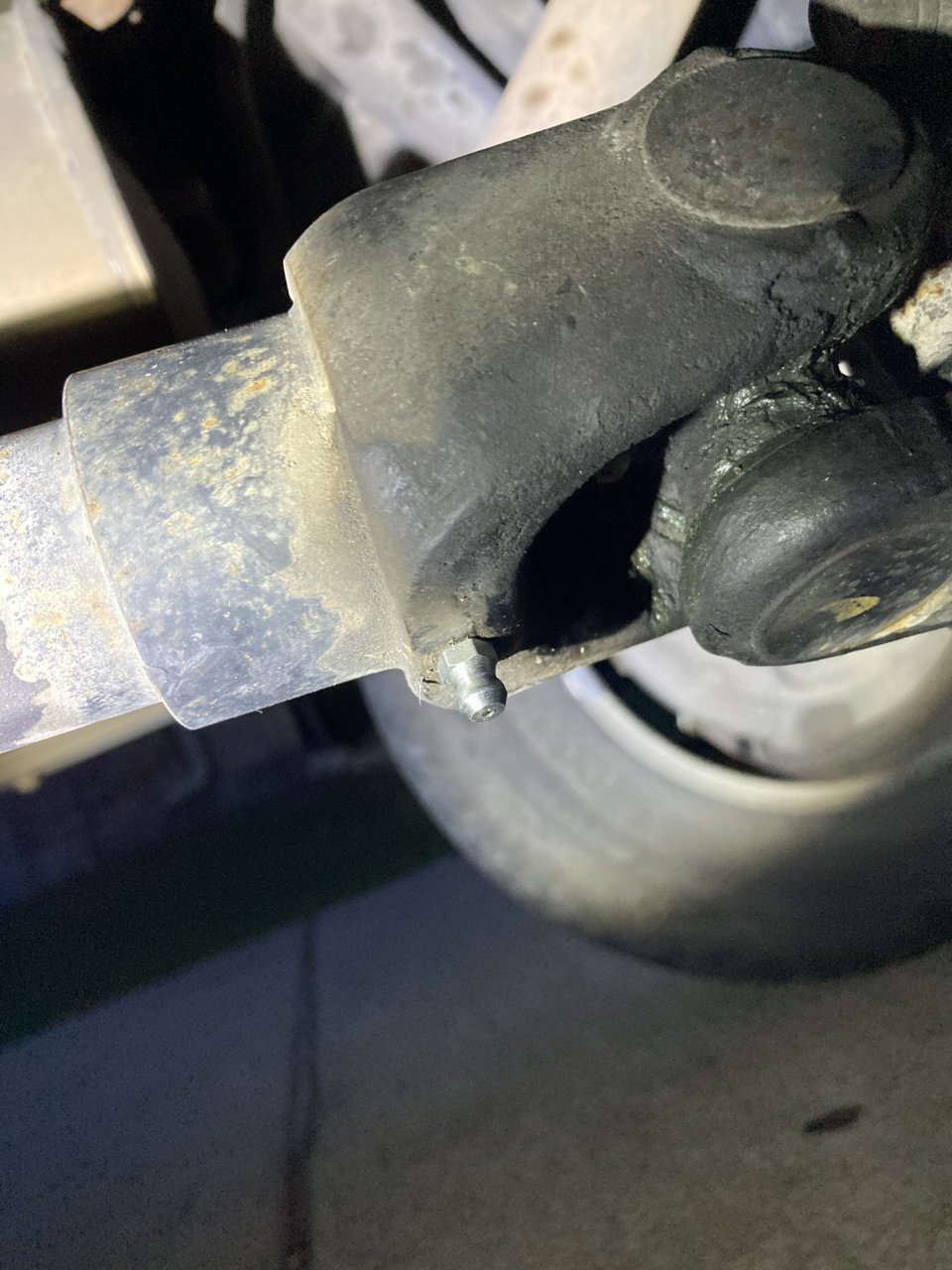

    TXTundraGuy23
    TXTundraGuy23 One piece at a time
    Apr 7, 2023
    #95139
    477
    Dallas
    2004 DC 4.7L 4WD
    6112s up front w/ 650 lb springs, 5160s in the rear, JBA UCAs, Suspension Maxx Links, ATS leafs w/ Wheeler's AAL and overload spring, Toyota Gloss Gunmetal TRD Wheels, Toyo Open Country AT3s 275/70/17
    Finally greased my driveline zerks over the weekend. All 8 done. I had to tap and install a zerk at the slip yoke. There was a hole there, but it was not threaded and was too small for a m6-1.0 zerk. Metal was crazy soft, I nearly over bored it but I think it’s fine. The front 4wd zerk was tough to get to as were the front two on the double cardan joint. So I modified the grease gun tip with a grinder as shown by others and it worked. Pics below.
    32A4D97A-DB2A-4D7E-B7A5-6E9FCD207279.jpg 32034895-42DF-482C-8479-B54B7CFDA014.jpg 8173675F-D06D-4D53-B53B-3F790E3EDBCA.jpg

  20. Jul 19, 2023 at 8:42 AM
    shifty`
    Jun 20, 2020
    #48239
    31,567
    ATL
    '06 AC Limited V8/4WD
    This is so weird to me. And there's nothing in the other side, eh? There has to be some explanation here....
    But more important, did it fix the issue?

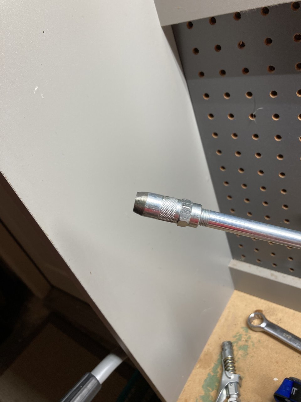

  21. Jul 19, 2023 at 8:51 AM
    metalpete
    metalpete New Member
    Jun 1, 2022
    #79032
    555
    ID
    2001 Tundra 4.7 4x4 SR5
    Toytech 2.0 Coilovers Camburg UCA's JBA headers Dynomax cat-back exhaust 90-221HD Leafs
    I might need to just do this mod myself. Been looking for a specific tip to grease those joints, but no luck so far.

  22. Jul 19, 2023 at 9:07 AM
    oscardog86
    oscardog86 New Member
    Mar 25, 2019
    #28131
    1,004
    Southern California
    2001 Toyota Tundra 4x4 V6 5VZ-FE MT
    I did the same per other peoples suggestions. Just grinded a slanted edge on one side of the grease gun tip, fits perfectly in that tough spot on the 4x4 shaft.

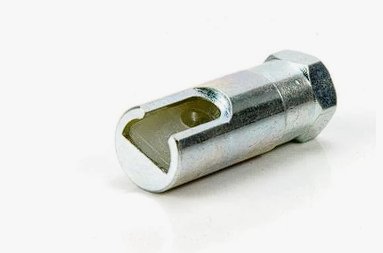

  24. Jul 19, 2023 at 10:11 AM
    shifty`
    Jun 20, 2020
    #48239
    31,567
    ATL
    I mean ... they sell these right-angle tips, which is what I use on hard-to-access fittings when it makes sense. I have an 8" flex lead on my gun and it helps get into some fun spots, even without this:
    But there's always the method a lot of other dude use, which PHM posted a couple years back
    bmf4069, DJenerated and FrenchToasty like this.
  25. Jul 19, 2023 at 10:20 AM
    metalpete
    Jun 1, 2022
    #79032
    555
    ID
    Yeah, I've seen those tips, just haven't been able to get a hold of one. Tried to order online a few times, but the orders kept getting canceled. But, from what I remember, ain't nothing wrong with a little bump and grind.

  27. Jul 19, 2023 at 11:06 AM
    TXTundraGuy23
    Apr 7, 2023
    #95139
    477
    Dallas
    2004 DC 4.7L 4WD
    I know, it’s bizarre. There was for sure nothing on the other side. He had been greasing it because there was a grease line flung all over everything under there. Maybe he had the part replaced at some point without a zerk? But the hole was for sure too small. That stuff tapped like pine. I could barely tighten the zerk without being afraid of stripping the metal out.
    Good news is it absolutely fixed the “thunk” problem.
