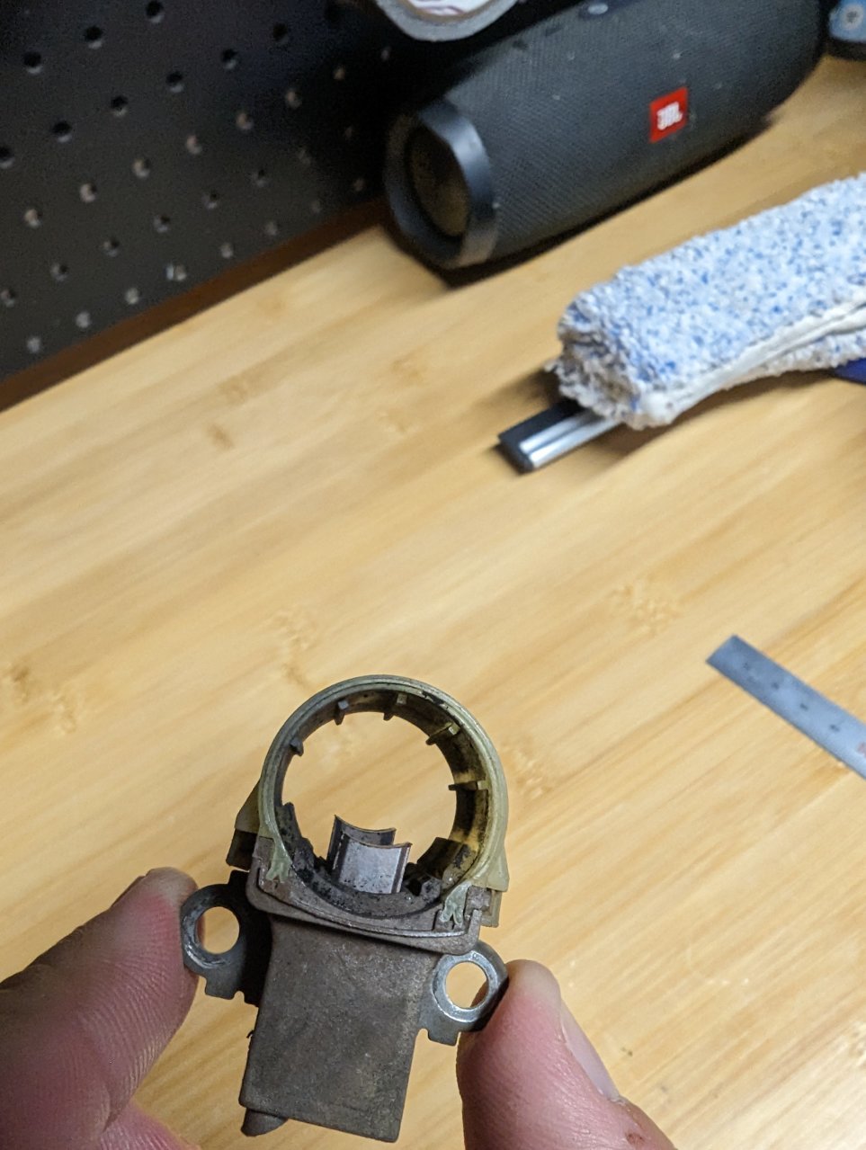

    I think I may do this since Denso is no long remanufacturing them.
    Check this out. I'd say this was due. Other than the brush what else am I supposed to replace?
  26. Jul 17, 2023 at 11:43 AM
    Festerw
    Festerw New Member
    May 7, 2017
    #7600
    3,881
    Cambridge Springs, PA
    04 Tundra DC
    Usually it's just bearings/brushes/regulator.
    shifty` likes this.
  27. Jul 17, 2023 at 1:35 PM
    shifty`
    shifty` Inside his chest they found ten thousand pencils
    Jun 20, 2020
    #48239
    30,572
    ATL
    '06 AC Limited V8/4WD
    Get the part number off the old alternator. Hit Google. Search "PART# rebuild kit" and you should be able to track down a kit. Easiest way.
