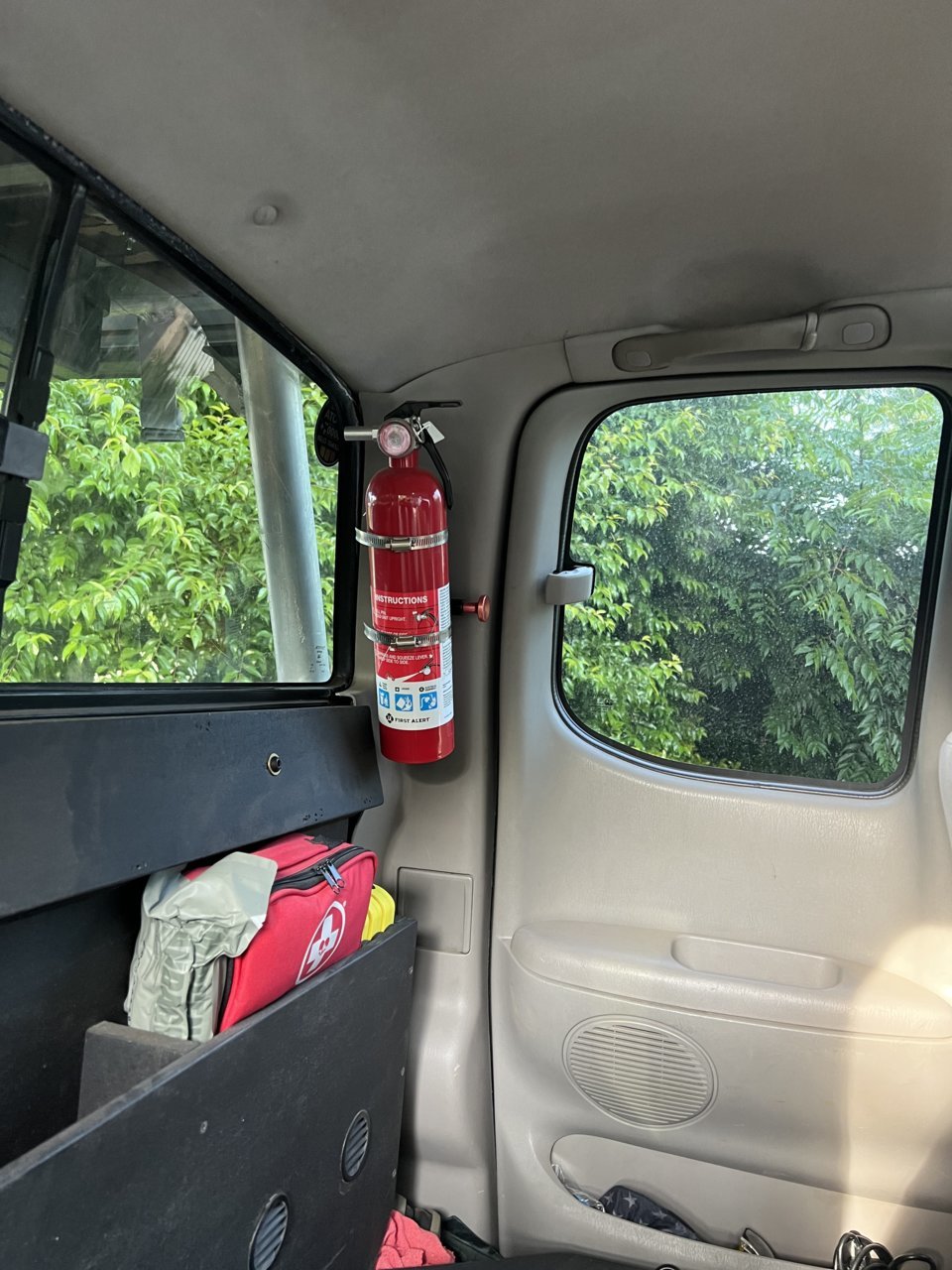

    How often do you use your rear seatbelt?7737E3A4-1100-47B9-9437-FCD1B2AC0BE6.jpg

    I like your setup. Never use the rear seatbelt. How do you have that mounted?

    For the top, same bolt used for seatbelt in same spot and took off the panel for the bottom bolt n nut. Put bottom on while panel is off then screw in original seatbelt bolt after panel is on

    Dude your rear seat delete is way nice.
    I need to step up me game. I just have to be careful with my electric rear slider window guts.

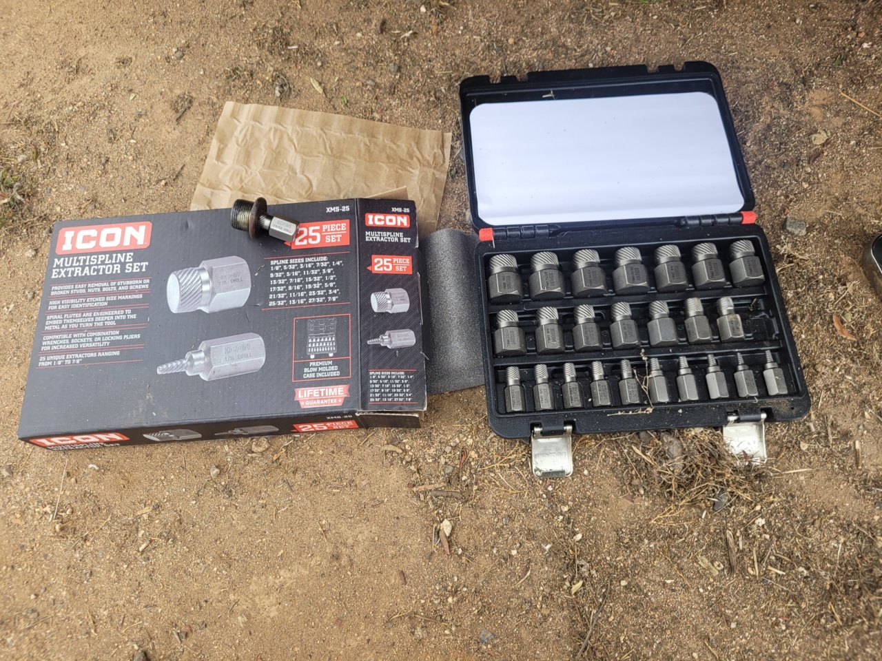

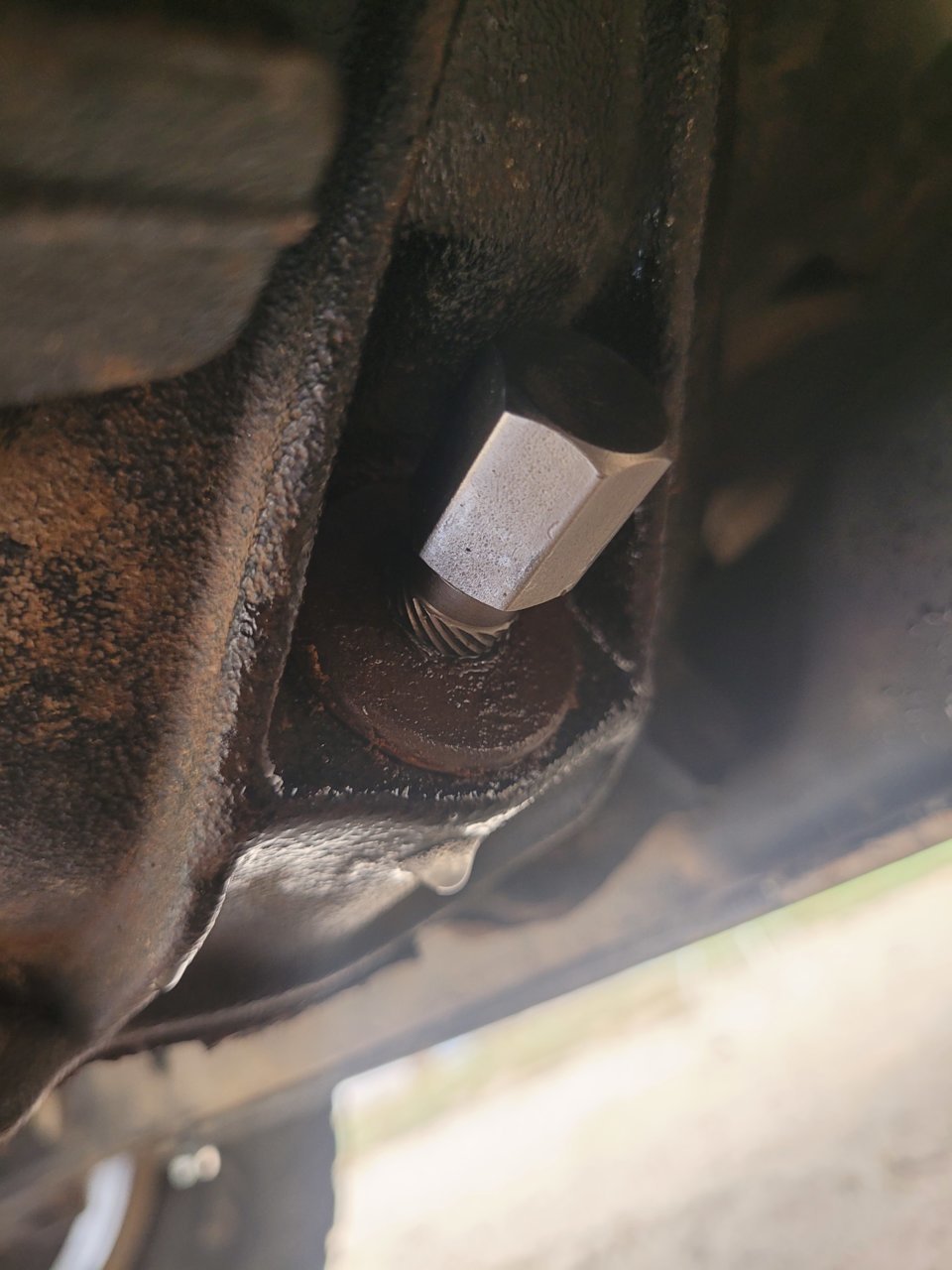

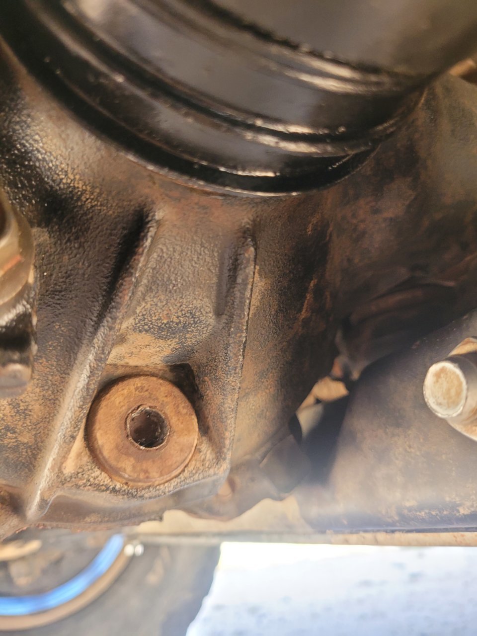

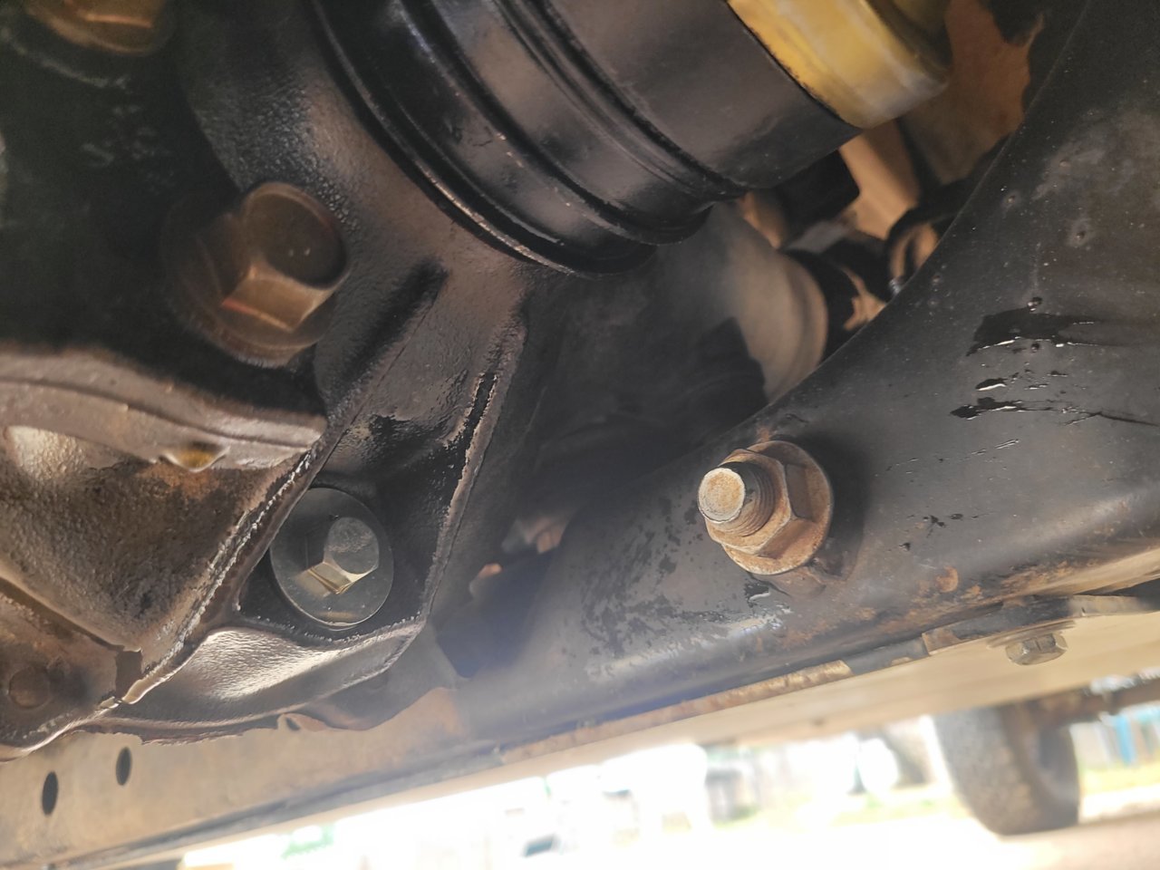

    I decided to have a second go at removing my stuck diff plug. No luck using heat, ended up stripping it out. Went to HF and picked up some easy outs, I've heard good things about the Icon brand so went with those. Hammered the sucker in, worked the breaker bar for a few minutes and it finally broke loose. Replaced it with Lexus plugs. Also picked up an air cleaner and some MAF cleaner while I was in town since I'm throwing a code.

    Were you able to get the easy out out?

    Nah, it wouldn't hold in the bench vise. Will try grinding some flat spots on the plug tomorrow, didn't feel like messing with it tonight.

    I’m surprised yours actually stuck being from South Cali. Do you have a slow leak there from the CV axle?

    Axle seals are fine, that's probably WD-40 you're seeing. I tried messing with it about a year ago, but knew it was going to strip then. Only bolt that has really given me grief on the truck
    Toyota serviced the front diff at around 75k, maybe they put it on with an impact.

    You’re probably right about the impact. haha

    Dunno about '04 but I noticed on my '06 diff plugs were allen-head for the first 6-8mm, then deeper into the plug it switches to Torx. I'm assuming this is a fail-safe in the event the allenhead gets stripped. Curious, yours weren't same?

    Not sure, I did try a T-55 per TW's advice with no luck though.

    Could also grip the remover with the vice and use a pipe wrench (or knipex) on the plug.

    Or grip the plug in the vise, spin the extractor in reverse. Or get a tap and die set, drill and tap a hole in some steel stock, then torque it down in with the extractor until the extractor comes free, then hang it on the wall as an award.

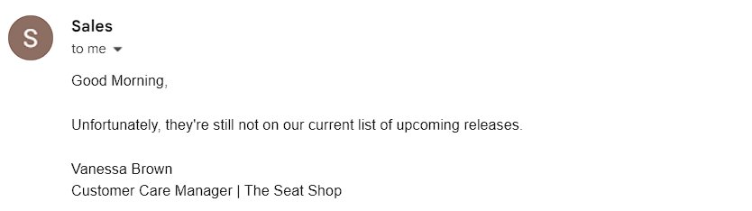

    Just reached out again today, since I can't remember wtf they said last time...
    But maybe pushing them every 6 months is the way to go about it, versus pinging them every year...

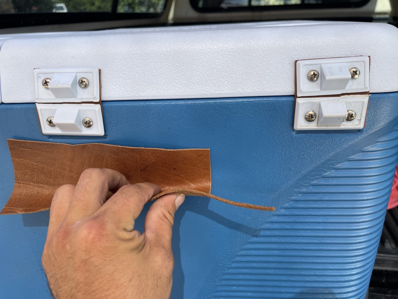

    Not quite tundra specific... but grant me this.
    Made a set of double layer leather hinges for my big cooler.
    they open all the way, but dont wanna stay open. Perfect.
    next time i go to town i'll get a bag of ice for the big cooler and a bag for the cooler i had at t2s & see which one keeps longer. Both igloos, no rubber seals, and free.

    Might check out Walmarts version of the yeti coolers while you're there. Probably the most cost effective way to save ice.

    Welp, guess I'll check back in 12 months to see if they're carrying 1st gen stuff :rofl:

    When you walk into Renaissance Fair the witch lady at the gate will be like, "sir, that cooler's a bit anachronistic don't you thi--"//sees leather hinges, girdle splits open, faints//
