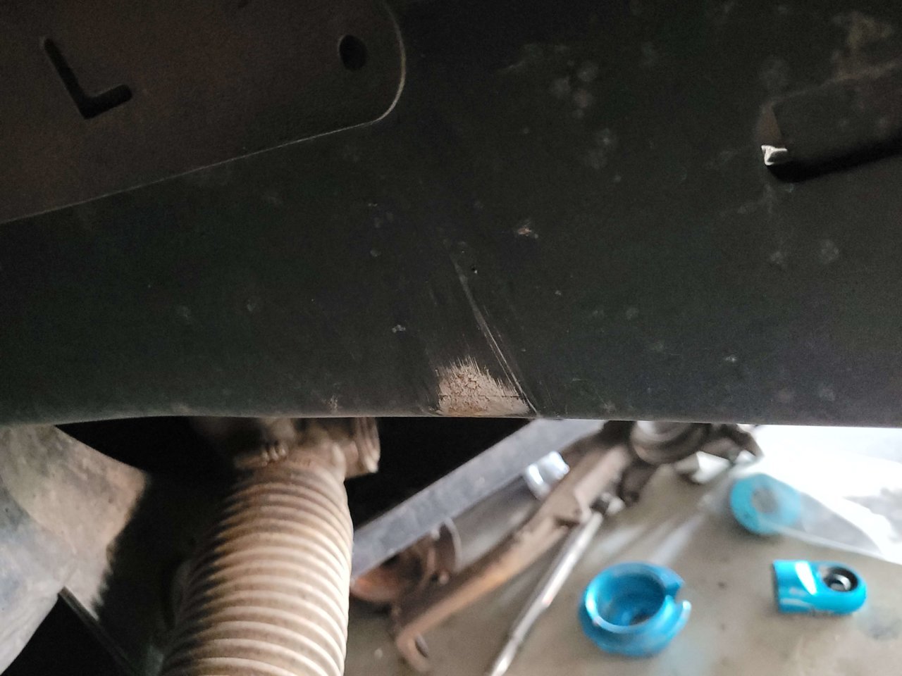

    This is my driver's side frame rub after about 5 years of 285/75/16 with 4.5" backspace and ~4.0 caster.

    Spacers. Then you'll rub the back of the wheel wells. Then you will want to adjust the caster forward. Or do some surgery

    You can try #1 although I don't know much about SPC...
    I had very minor frame rub in the same place that stopped as soon as I had a bit of wear on the tires.
    I run 3/4" steel spacers up front. Those won't come off.

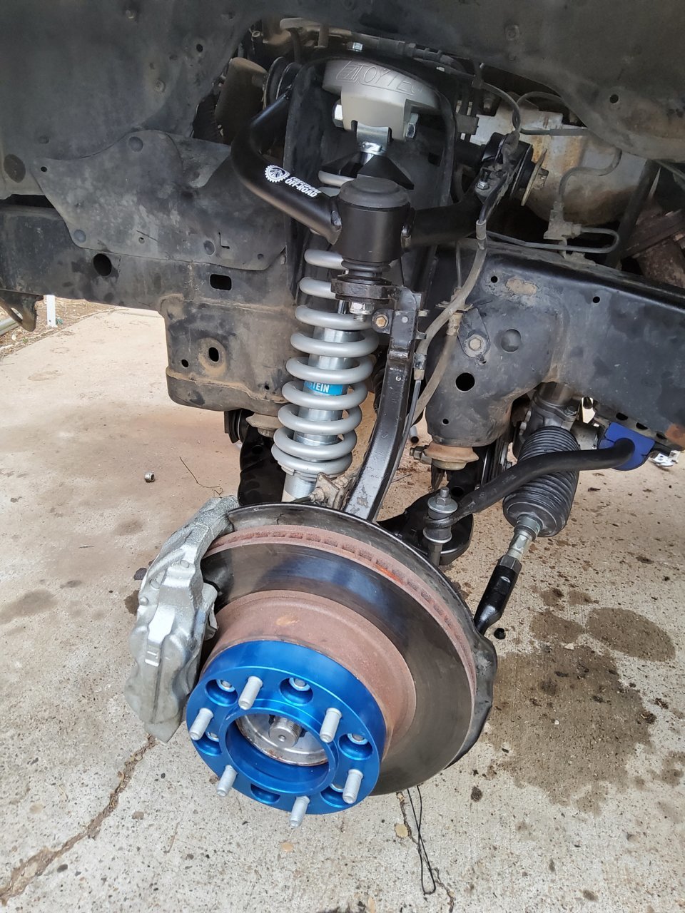

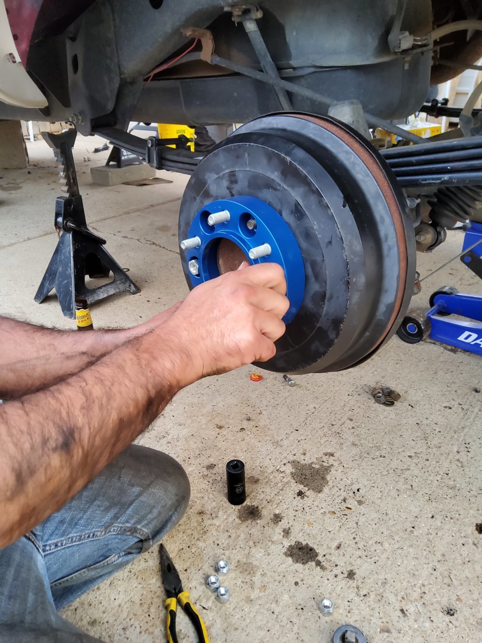

    Spacers are OK. Been over a year with mine.

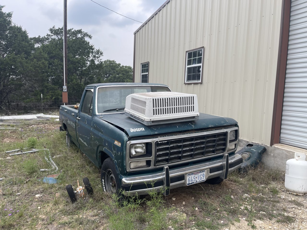

    Success!

    Hi rise!

    if i trim the buells windshield a bit & back it in, it'll fit.
    the windows work, the back glass shocks work, the latches work. Might have to seal the front window.
    interested how much its gonna DP my fuel milage.

    Now pop out the windows, scuff sand and spraypaint it black!

    Need an ac unit sticking out the back window. o_O

    Roof unit?

    Holyshit, you still have the Ferd?
