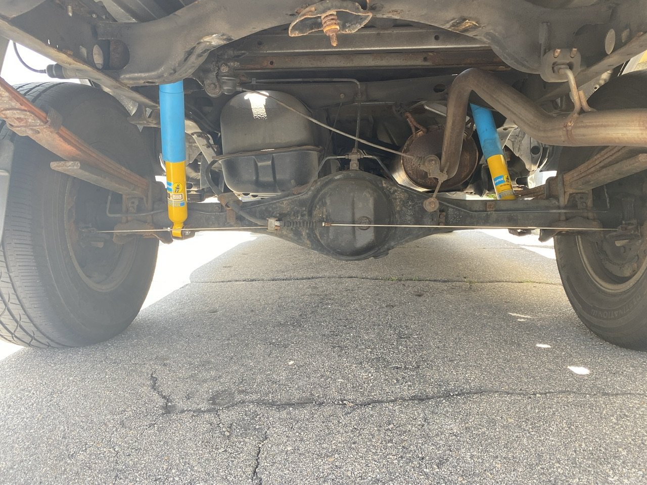

    @alb1k or maybe @Casper421 has there been a noticable difference having the shocks on the same side of the axle?
    forgot who had the rear shock relocation.

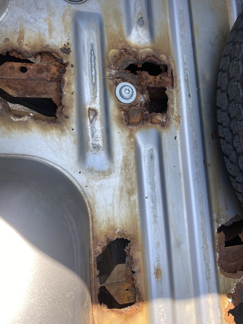

    I haven’t showed you the latest holes in the bed. I decided to take a ball peen hammer to the rust and now have quite a few gaping holes back there.

    @FrenchToasty Heres the new bed bolts and what’s left of good metal holding them onto the bed…

    Mine are both rear. I think the real difference came with the gears, not the shock placement

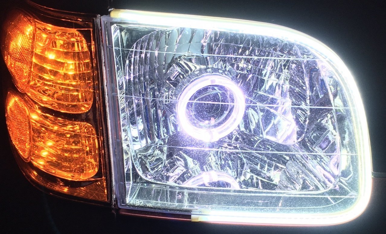

    I did build them. Those are my factory lenses retro fitted. Aftermarket plastic didn't do it for me.
    I cut the part out where I walked to the truck after turning on the camera. I'm in wpp at the moment..

    What happened to the lever for your load proportioning valve? Just decided to get rid of it?

    reduces lift of rear end - better traction maker those strategic vents in your bed floor.

    I was thinking they were some fancy undermount LED work lights.

    So the 'demon eyes' are NOT the ring of lights around the projectors in @Hi06silver new setup?

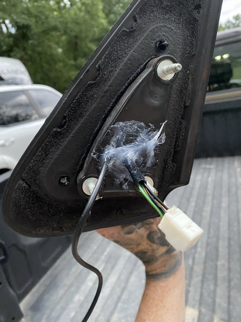

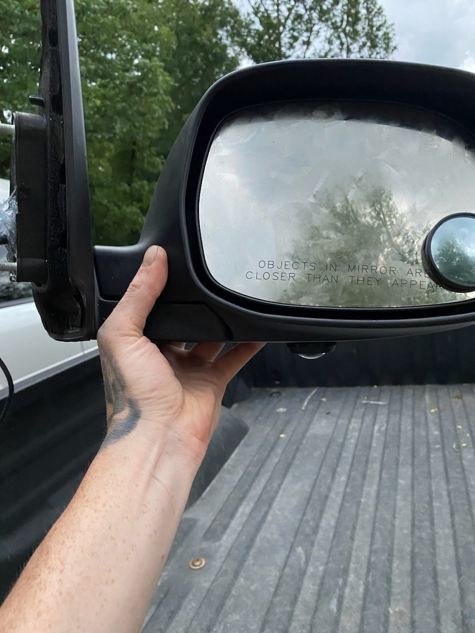

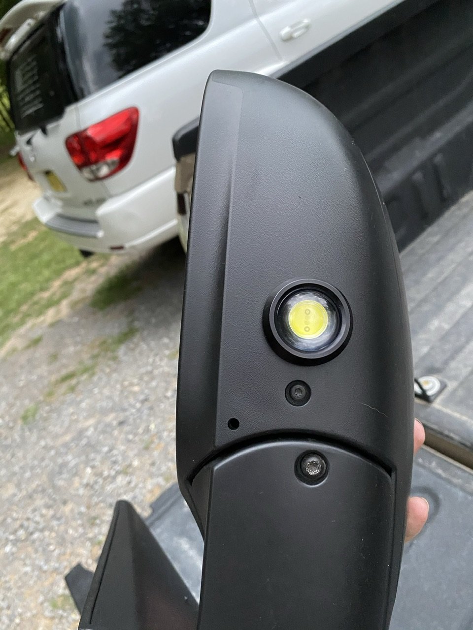

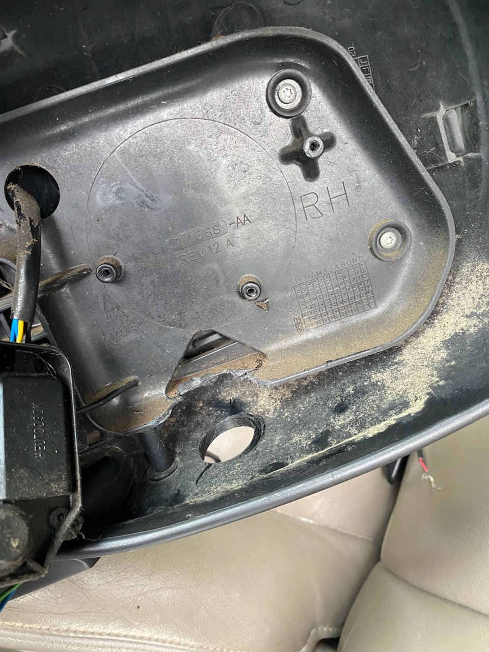

    Finally got around to finishing this project. Took me way too long :bananadead:
    where it started:
    Lights installed in the mirrors.
    action shot:
    And a video of the finished product because I’m a dork but it’s cool :anonymous:
    https://youtube.com/shorts/LK6oYXRaghU?feature=share
    Worst part was figuring out how to fish wire through the rubber seals in the door and into the cab. Feedin it through with the factory wiring was a nightmare. I ran a feeder from the overhead console (easy enough place to isolate the switched ground)down to the fuse panel as that’s where the drivers side feed comes in and then ran a feed across too the passenger side and out through the rubber grommets/ wire loom.
    I’ll be doin speakers next, mine are absolutely pitiful, I knew they sound like crap, and now I know why
