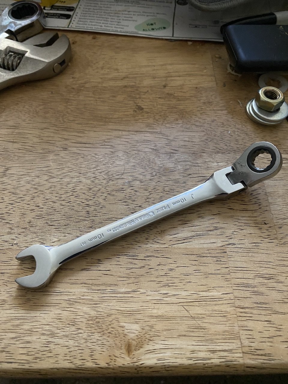

    I never realized I would need a brake bleeder wrench since I was the one typically pumping the brakes when I did it before and my dad bled them without a hose (found that out yesterday), by just letting it squirt out. haha

    What’s the issue? Why can’t you just use a box end or flare nut wrench?

    I can’t tighten the fitting with the hose on it shut due to the lip of the backplate getting in the way. I also can’t get the wrench off and over the hose to advance it (hose OD too thick).

    Slip wrench over bleeder then attach hose. You shouldn’t need that much rotation to get fluid out. I’ve never had an issue with the backing plates. Bend it out of your way for more room but remember to bend it back.

    I can only turn it about 1/8th of a turn (1 inch+) and the fluid is barely coming out. Backing plate is in pretty bad shape. Any distortion of it and it’ll come apart from the rust.

    Crack free with no hose, then lightly shut bleeder. Then add hose and use open end to open and close at an angle where you can get enough sweep.
    Do your wrenches have an offset or are they straight?

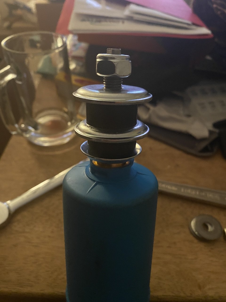

    And it works…only 2 hours, maybe less. Ready for install this weekend on round 2.

    Wrenches don’t have much of an offset which is the issue. Open end has none.

    Found the proper 10 mm wrench and it works! Forgot someone gave me a gear wrench flex head set for Christmas one year. Now I don’t need to wait till the middle of next week on a Lisle 10 mm brake wrench. Good thing too; I’ve got air in my rear brakes from the 1st go-around.

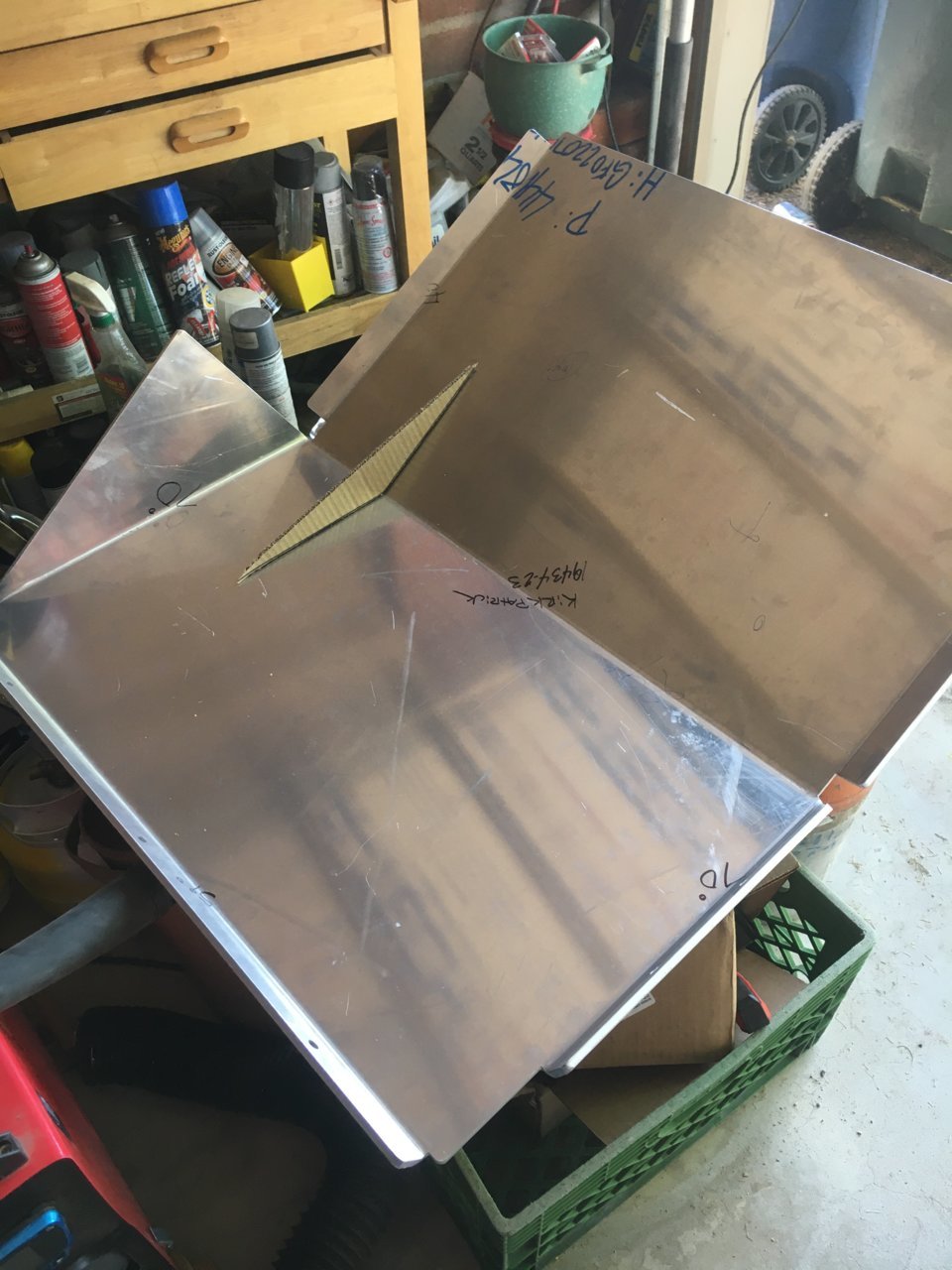

    Made some templates/ test pieces so I can gussy up my new custom skid plate.
    Ordered some center punches and hopefully have this bad boy mounted by Monday! D501EDA2-7F1C-4EF6-BEF9-F0934CF7A21C.jpg
