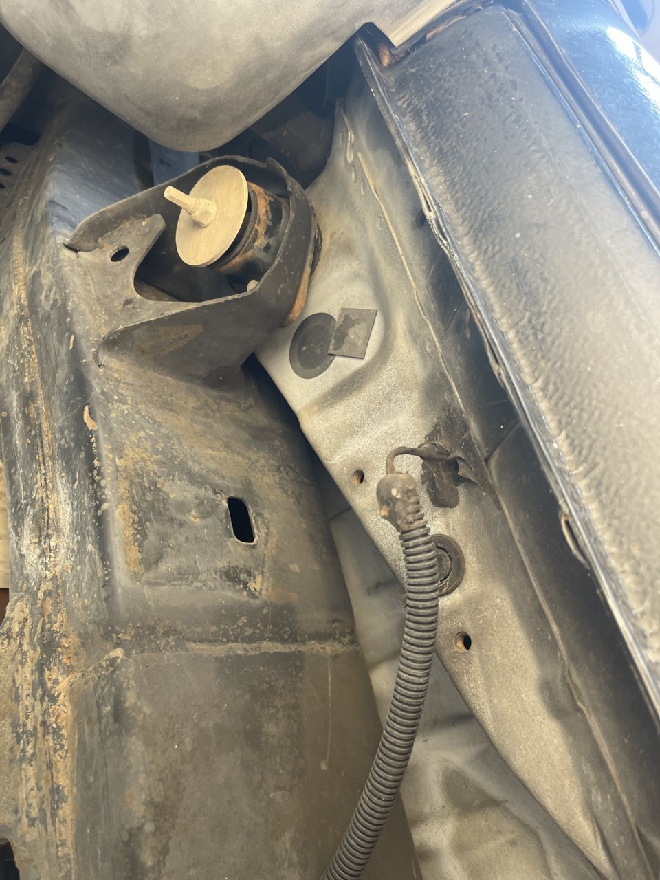

    2,797
    Dija

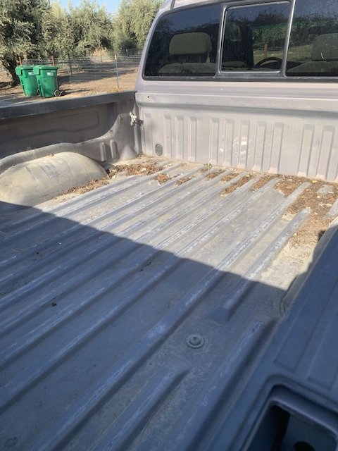

    The Lone Star State
    I need to do this. I have the same switch panel

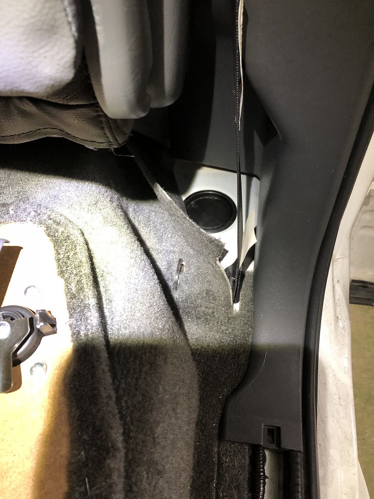

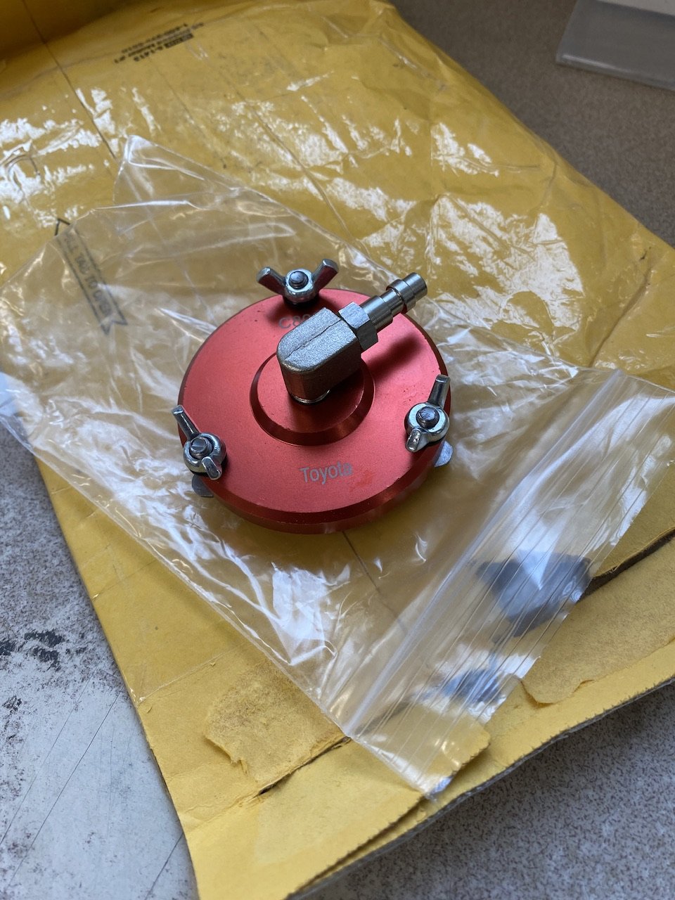

    Cedar Park, Texas
    '06 desert sand 4.0 V6
    Alumas, Alcans, TuRD Pro wheels, 285/70/17 Falken
